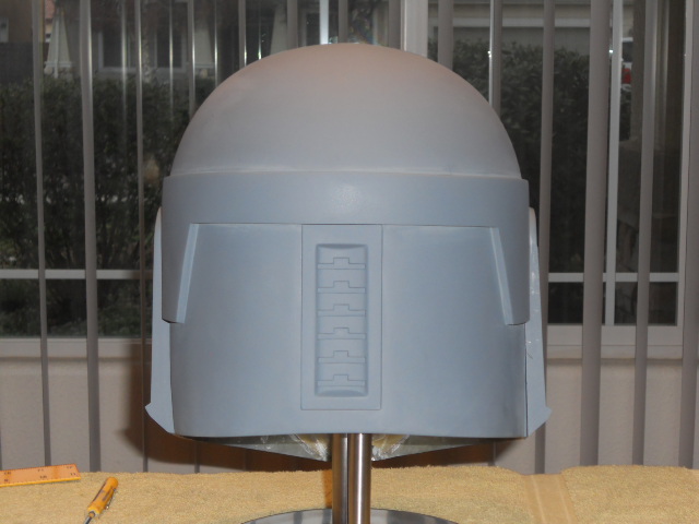

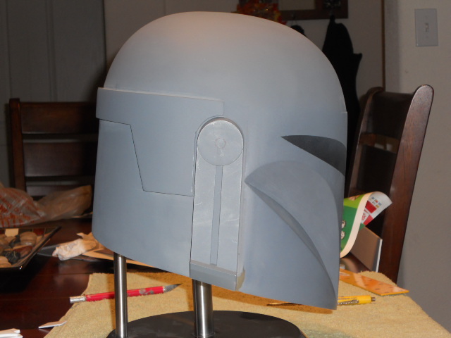

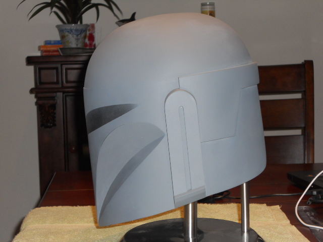

Ok, here are some better pics of it mostly assembled. With the additional hardware (hanger bolts, washers, wing nuts, u hooks), it brought the weight up to exactly 4 lbs. I used size 10-24 hanger bolts to make the cones removable for storage and transport. I went a tad larger for the removable thrusters and used 1/4-20 size hanger bolts for more stability since I figured they're likely to see a little more bumping when trooping. I also used large metal fender washers on all of the attachment parts for strength. The clean-up is minimal. I haven't done any clean-up on the main body other than trimming away the flashing when I initially pulled it out of the mold. I did take a few minutes to quickly sand flat the base areas of the resin parts, as well as took some 320 grit sandpaper to the edges to clean them up a little. Other than that, this thing is ready to be lightly scuffed with some 320 grit and it's ready for paint. :thumbsup:
