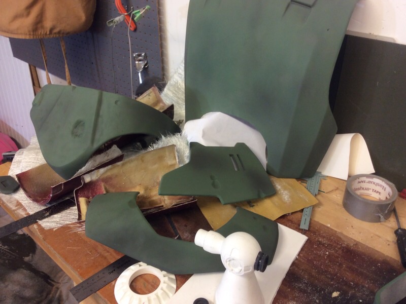

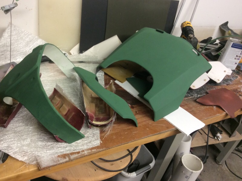

Started painting some armor today. Got the mix all mixed, ready to go. Starts raining. Since it's not my helmet (and I bought plenty of paint, I hope) if I have to redo it because of moisture in the air, then I'll put a light sanding on it and re-shoot it again. But I was just so ready to get some color on and the paint looked so good in my mixing jar, had to go ahead. Plus, I'm still trying to get my correct viscosity down. All I've heard is that you want it to look like milk. Really?! What kind of milk we talking about? My first memories as a small child are of drinking milk right out of the cooler in the milk house with my dad. We milked Jerseys with a butterfat content that made it resemble Elmer's Glue!!! And I know that isn't going through my airbrush!!! Lol. So now I'm going for tea. I feel like crap now though. I think I need to get some new elements for my respirator. Not good.
Yeah after re-examining reference images, I'm a little too Kermit and not dark enough. So, in my tradition of doing things multiple times, I'll be re-mixing and repainting!!!
Pics may change the colors a bit so I don't know how it all looks in person, but to me it almost looks like maybe you could use various weathering techniques and shading and such to get that green where you need it? Doesn't look bad!! And it went on really nice!

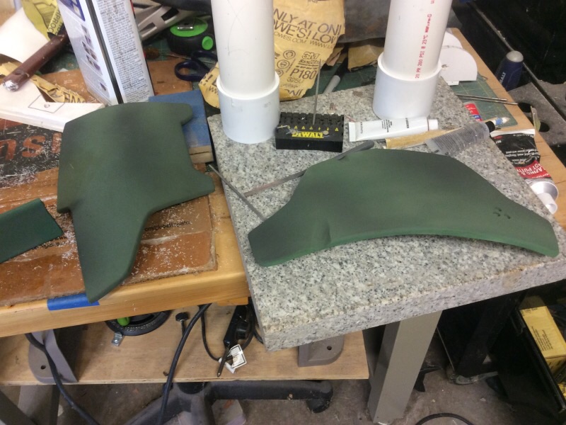

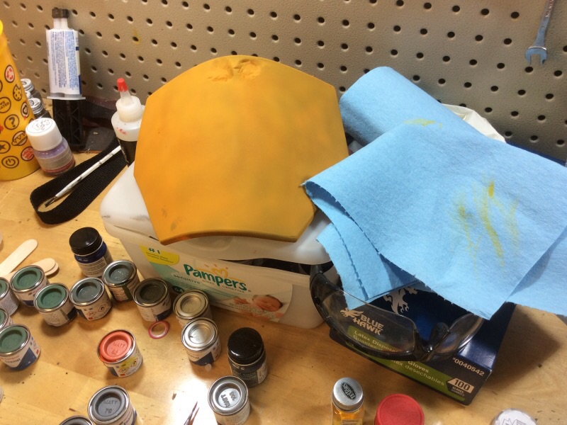

OK, on to what I can do. I started really updating on the armor. And I'm liking the way it's turning out. I have some Testor's Zinc Chromate. Looks great in the bottle. Get's really bright on the armor, loses its chromate-ness. I may see if I can weather it down or something. Worst case, I'll dull it with some grey or something.
First coat on the shoulder, custom orange yellow mix. Not sure if I like it. But, hey, first coat.
Started detailing ab plate. Really enjoying this.

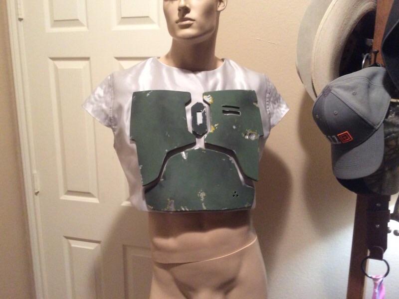

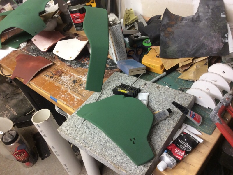

Finished weathering my armor tonight and did a test fit. Still have shoulders to do but I had a massive clog in the airbrush tip, so I have some parts soaking to soften that up.
Overall I'm pretty pleased with how the armor came out. And I think it looks good on the vest. I may have to fudge it up a bit because ths collar armor seems to be riding high. We'll see.

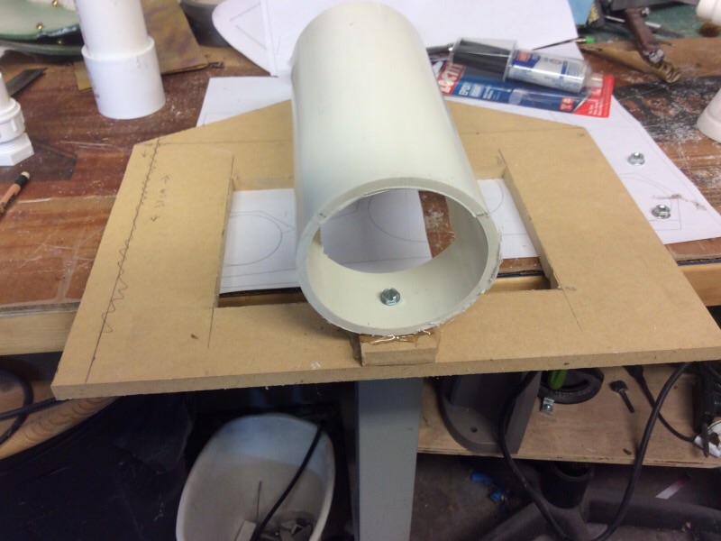

So I'm going off of reference photos and using Alan's templates, but I'm kinda winging it. I'm basically doing like I did with my EE-3 and trusting my gut. I want the JP to be a bit bigger than the 15" version so I'm kinda just taking measurements and making intense mathematical computations on the fly. (Eyeballing). Somewhere in my shop I have a protractor. It would have been very nice to have found it, I would have used it. But alas... I digress.
Started with a foundation of MDF. I wanted something strong as a frame and that I could anchor my clips to. Also, fair warning, I'm deviating a little bit from screen used on harness and attachment methods, largely to make it easier on my valet. The less griping I have to listen to the better. So I'm using some plastic buckles like you'd see on a dog collar. Click click, done.

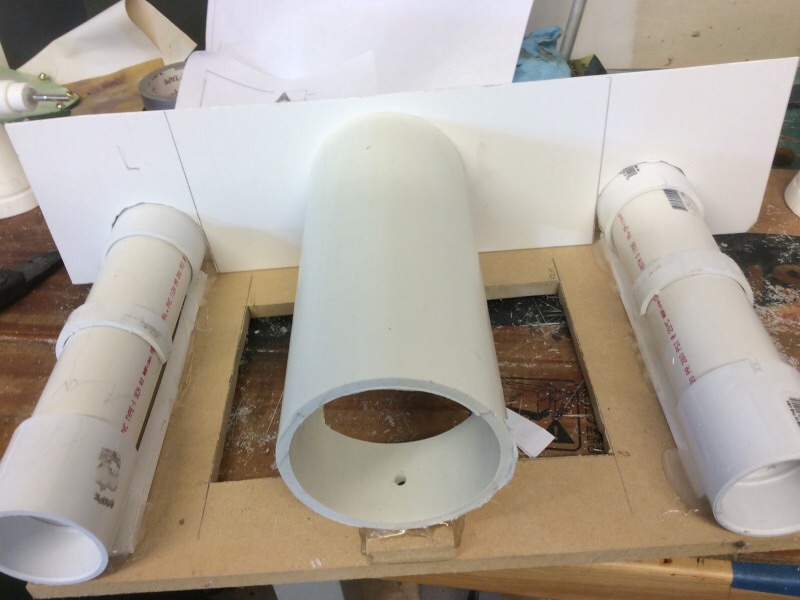

Then I tacked on the fuel tanks....

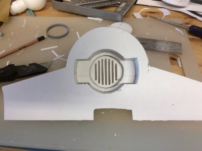

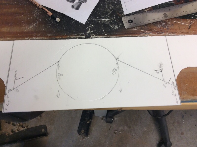

Started taking measurements, and using a piece of sintra, started making a template to cut the thicker sintra with. I'll be doubling up with two 1/4" thick pieces of Sintra for the upper "shelf".
And I put too short of bolts on the thrusters, so I'm going to have to re-engineer how I mount those in the tanks! Yay! I love doing stuff twice!

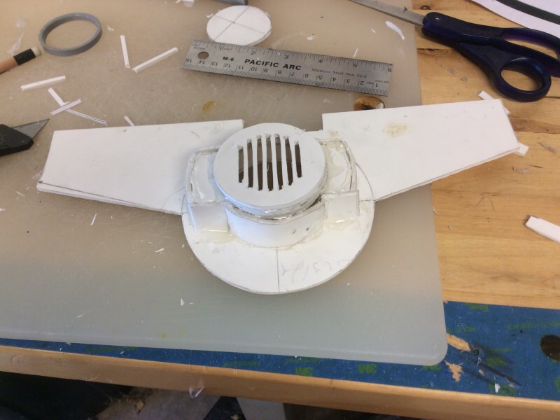

Started roughing out the exhaust vent in the bottom of the JP.
I had hoped to have this thing spackled, bondo'd and ready to paint today. Lol. I get pretty ambitious.
