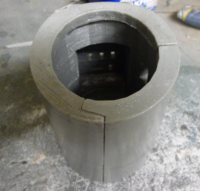

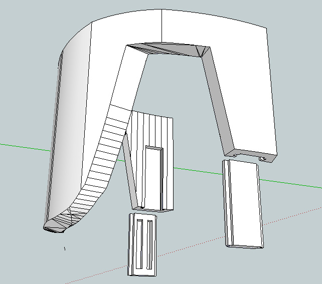

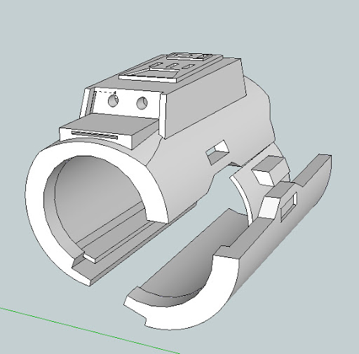

Right Gaunt Model, I oriented the opening so that it took no more than 50 degrees so it will not be visible on the outer, and rather than rely on fiddly piano hinges or velcro, I designed the latch to be printed into the gauntlet.

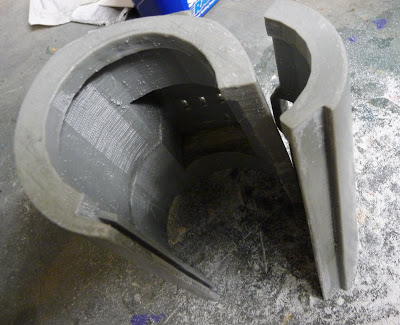

First printed prototype:
The door closes flush, and because its printed in ABS, the clip actually works to lock in the side as it looks like it should.

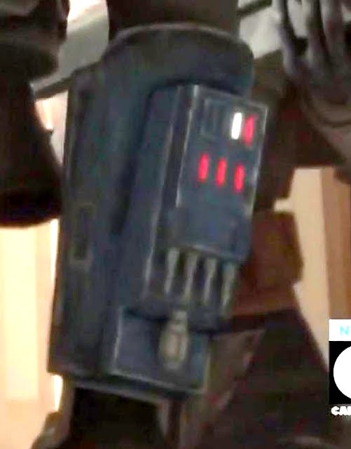

Left Gaunt Reference:
%2520HDTV%2520S05E15%25201080p%2520AVCHD-SC-SDH.mkv_snapshot_16.40_%255B2013.02.17_09.33.40%255D.jpg
%2520HDTV%2520S05E16%25201080p%2520AVCHD-SC-SDH.mkv_snapshot_14.33_%255B2013.02.17_10.04.26%255D.jpg

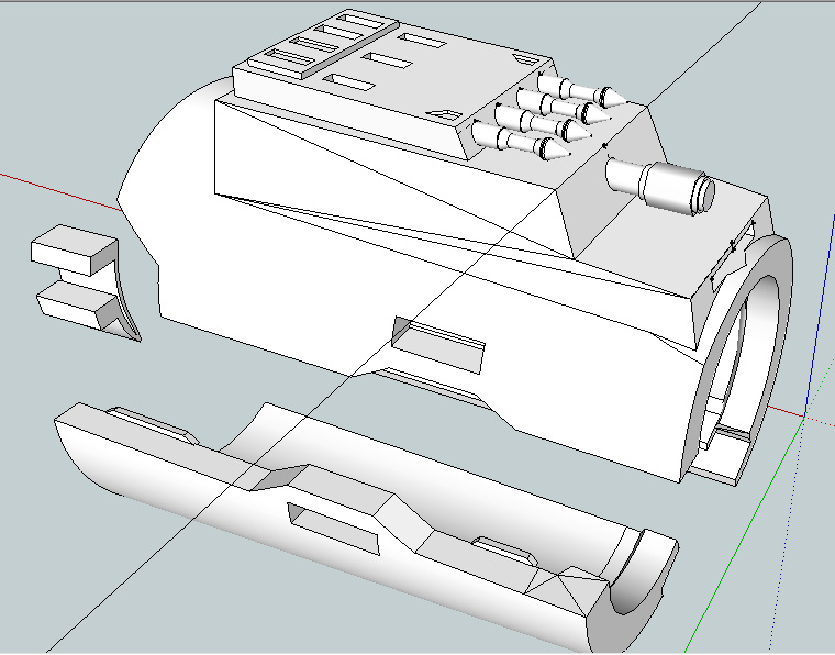

3D Model:
Printing the missiles proved a bit challenging but still doable:
Then it was a case of sanding off the print lines and painting, because they are printed in grey/silver abs, this made weathering much easier:
I have made it so the knife will retract, but have left this to be manual rather than spring loaded as to keep with our requirements.
Personally think the nozzles are a tad to big, but I can just scale it down the next time I print

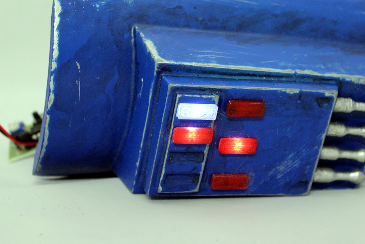

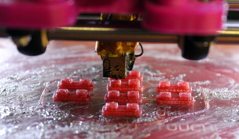

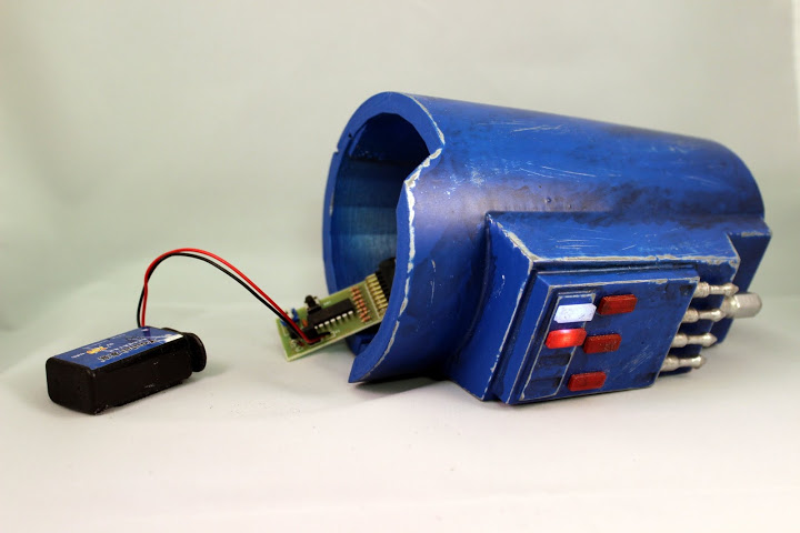

I have been trying to source transparent Red ABS filament to print buttons that light up for these gauntlets with no luck, but found a work around.
Apparently all you need is transparent filament, and using a sharpie, color it in before its fed into the extruder and melted. The ink from the sharpie will then blend into the plastic giving, in my case, a transparent red plastic needed for the red buttons.
I got a chaser circuit from ebay and the spaces you see in the buttons are design to hold the LEDs on the inside of the gauntlet. The chaser has multiple program modes including one where the main white and red remain on and the others randomise.
I think it turned out pretty good.
