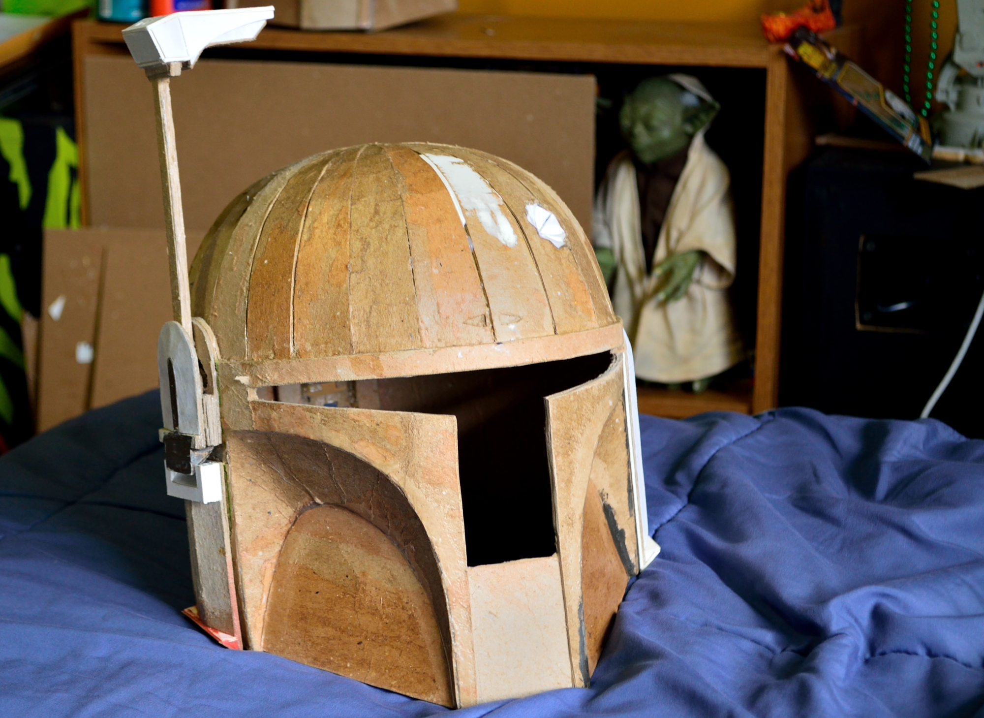

We both finally finished up all the pieces. Everything is still just put together as cardboard, and not perfected but all the parts are done!
I was impatient and took some pictures of my helmet with the pieces placed on using only a couple dabs of glue. (they are off again now to be finished) but I thought i would post those up!!

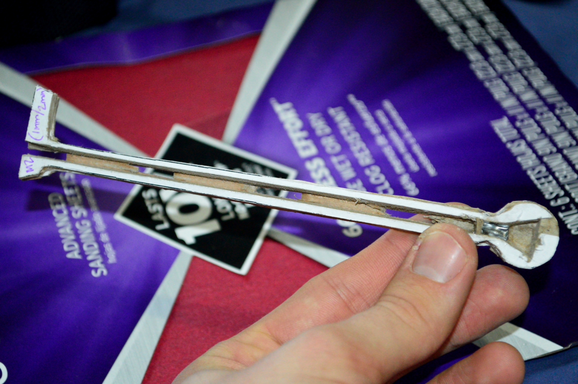

Also, here is a shot of one of the rangefinders (Sara's) before inserting the wires and fiberglassing. The hollow cuts are so that the fiberglass will be all the way through every layer of cardboard and take up the entire thickness for extra strength.

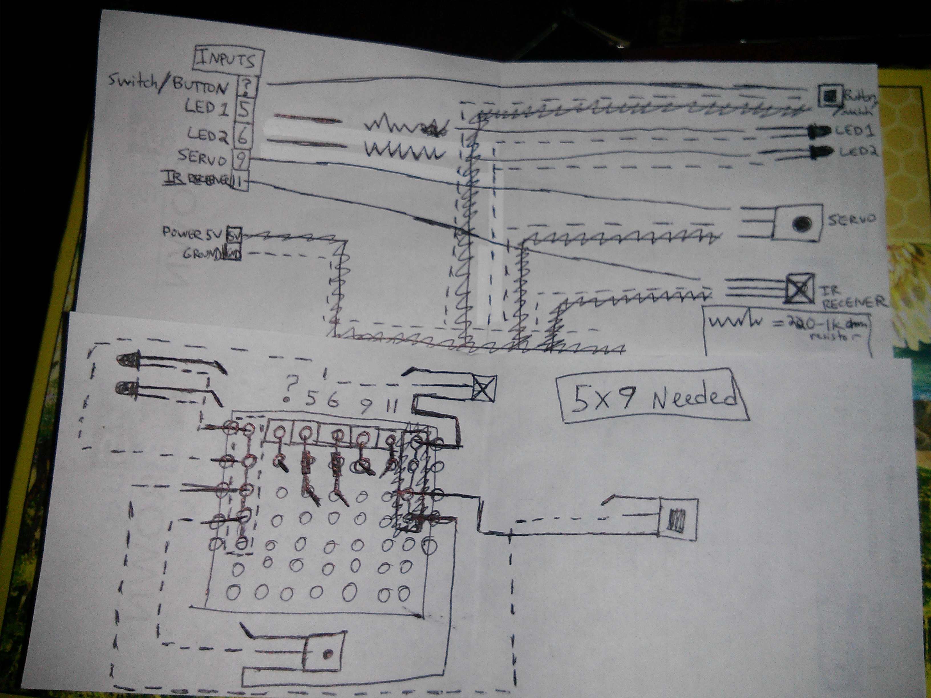

We have been working on smoothing out all the ear pieces/rangefinder, and in the mean time I have been planning the circuit board for all the helmet electronics.

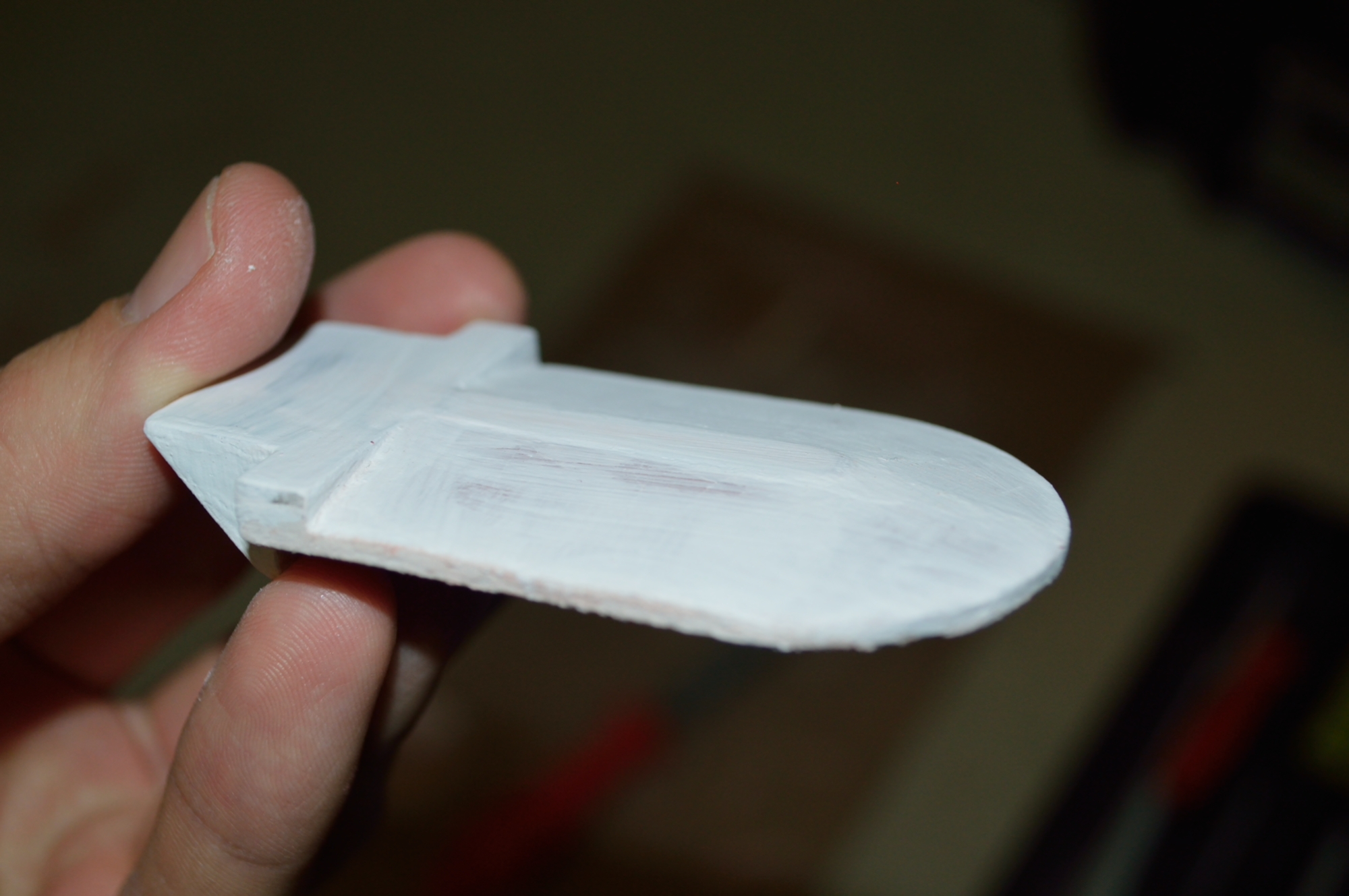

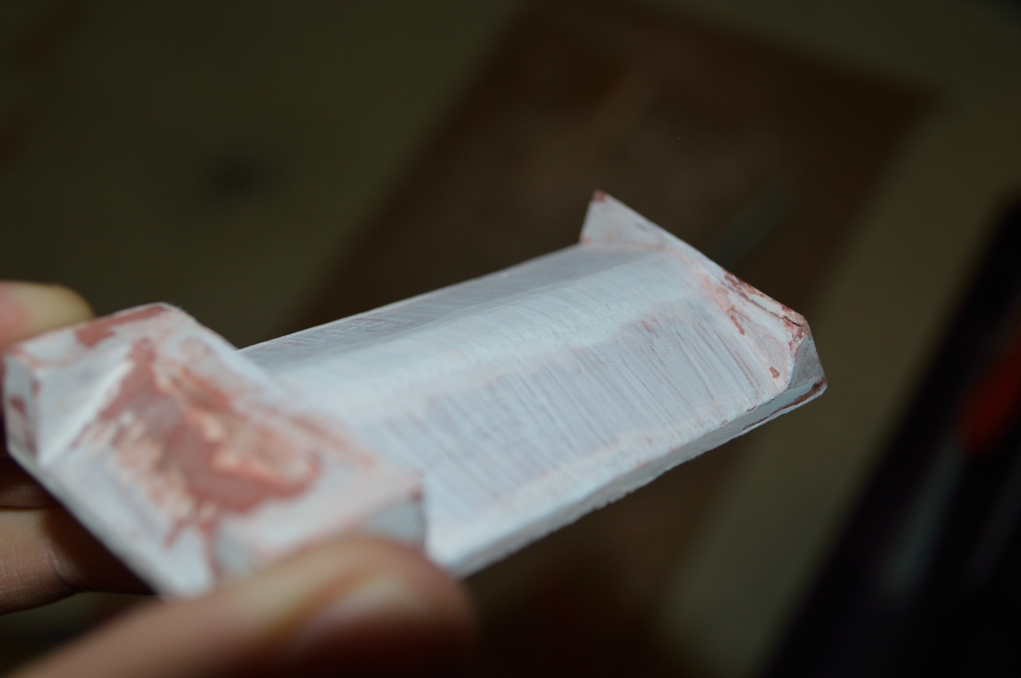

I finally had some time to take come photos and put them up so here we are:

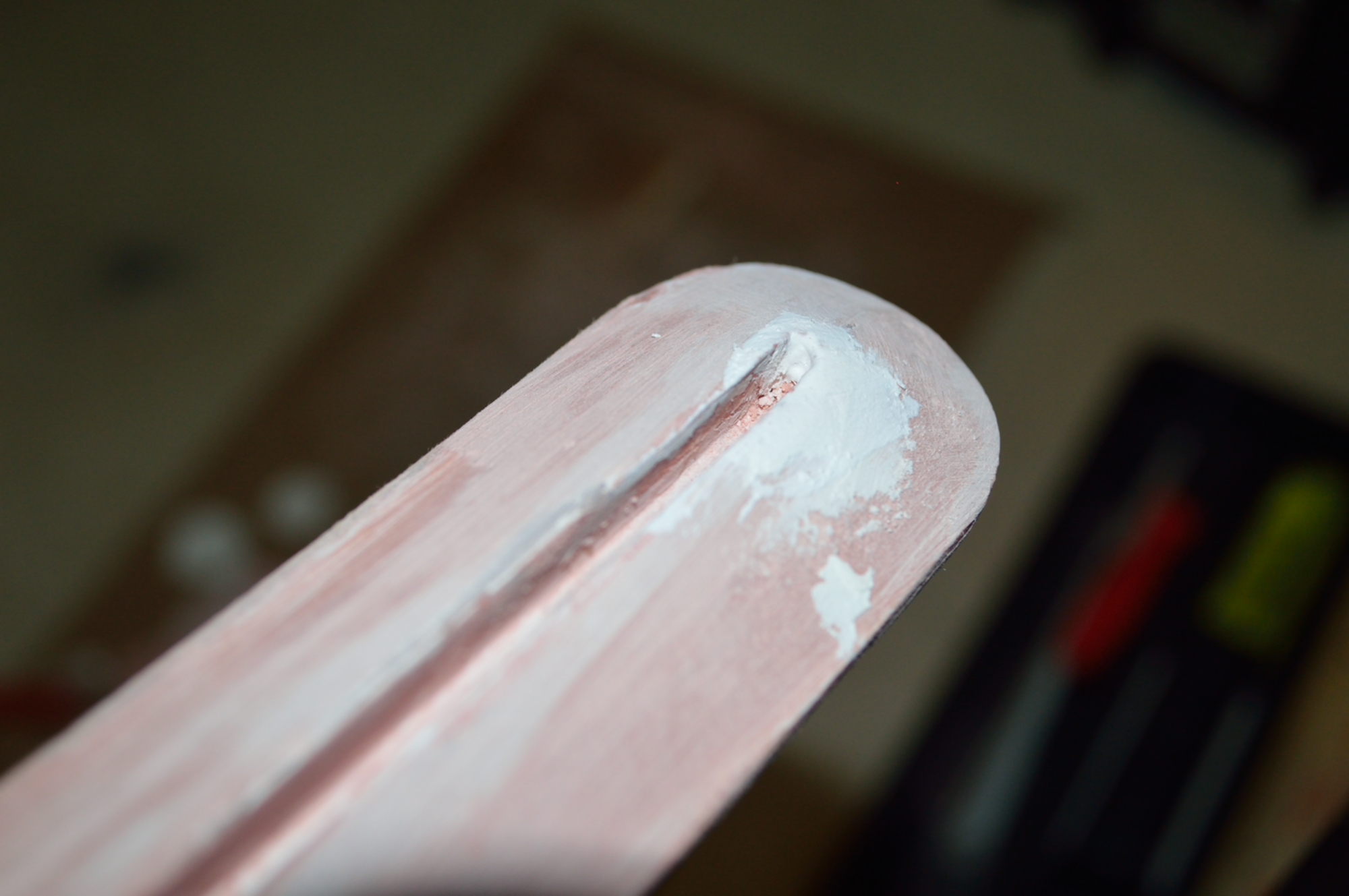

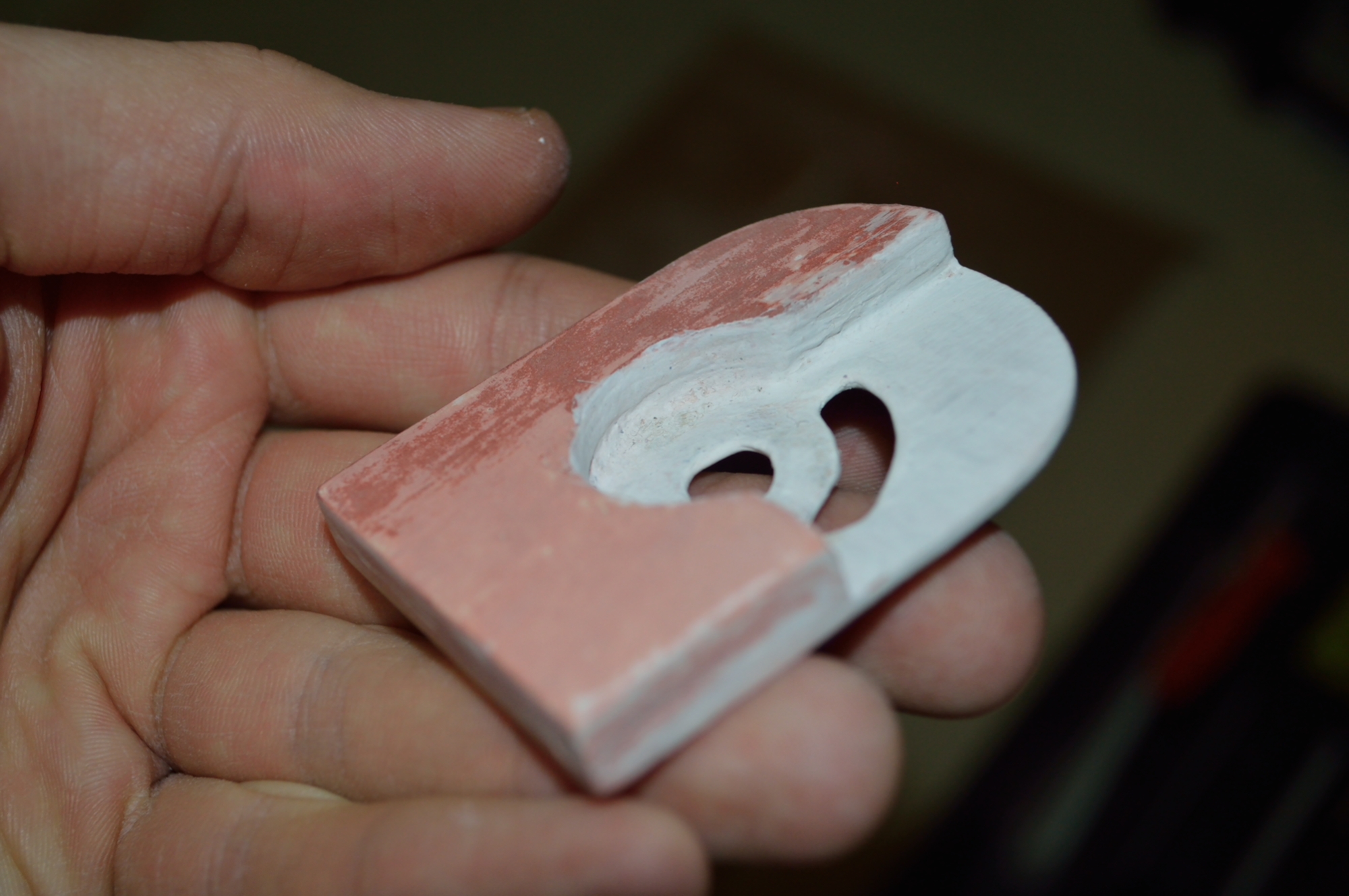

Here is my first "Finished piece" and what it looks like after plenty of thin layers of bondo followed by Gesso. It actually feels like plastic now its so smooth. Any little areas that look like bumps or rough spots are simply the result of multiple layers of primer.
Took days just for this one piece, but I like it!

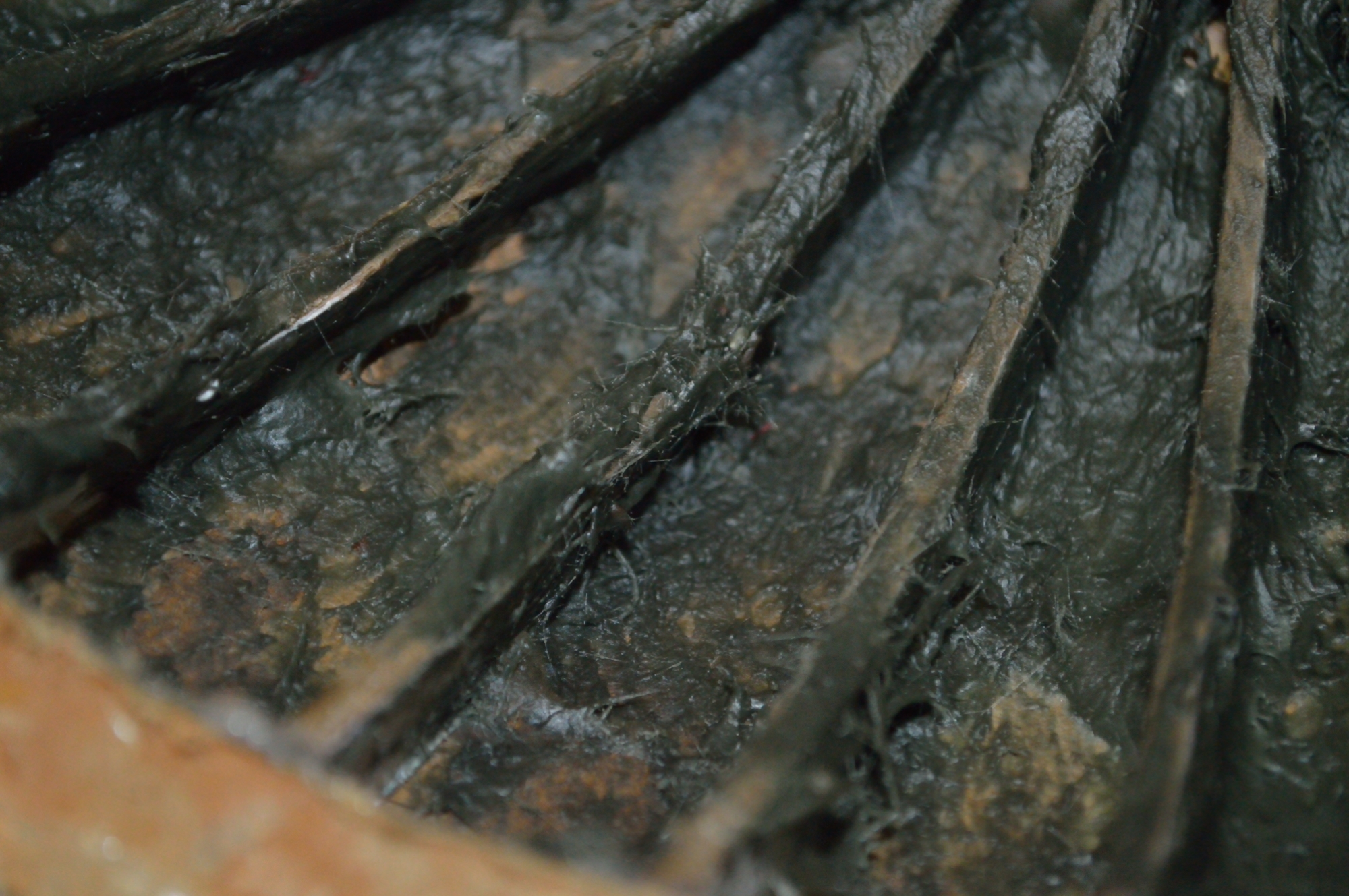

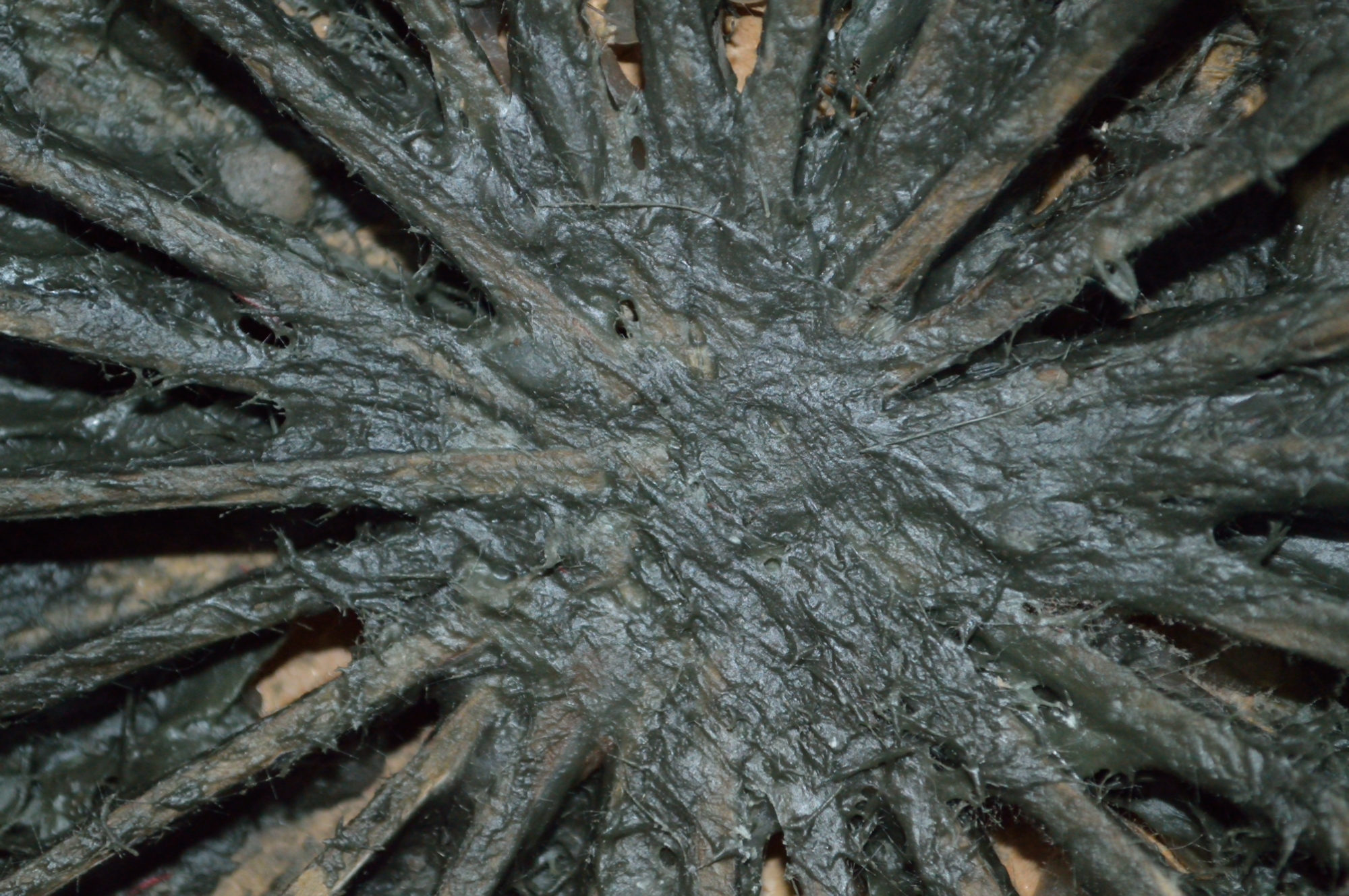

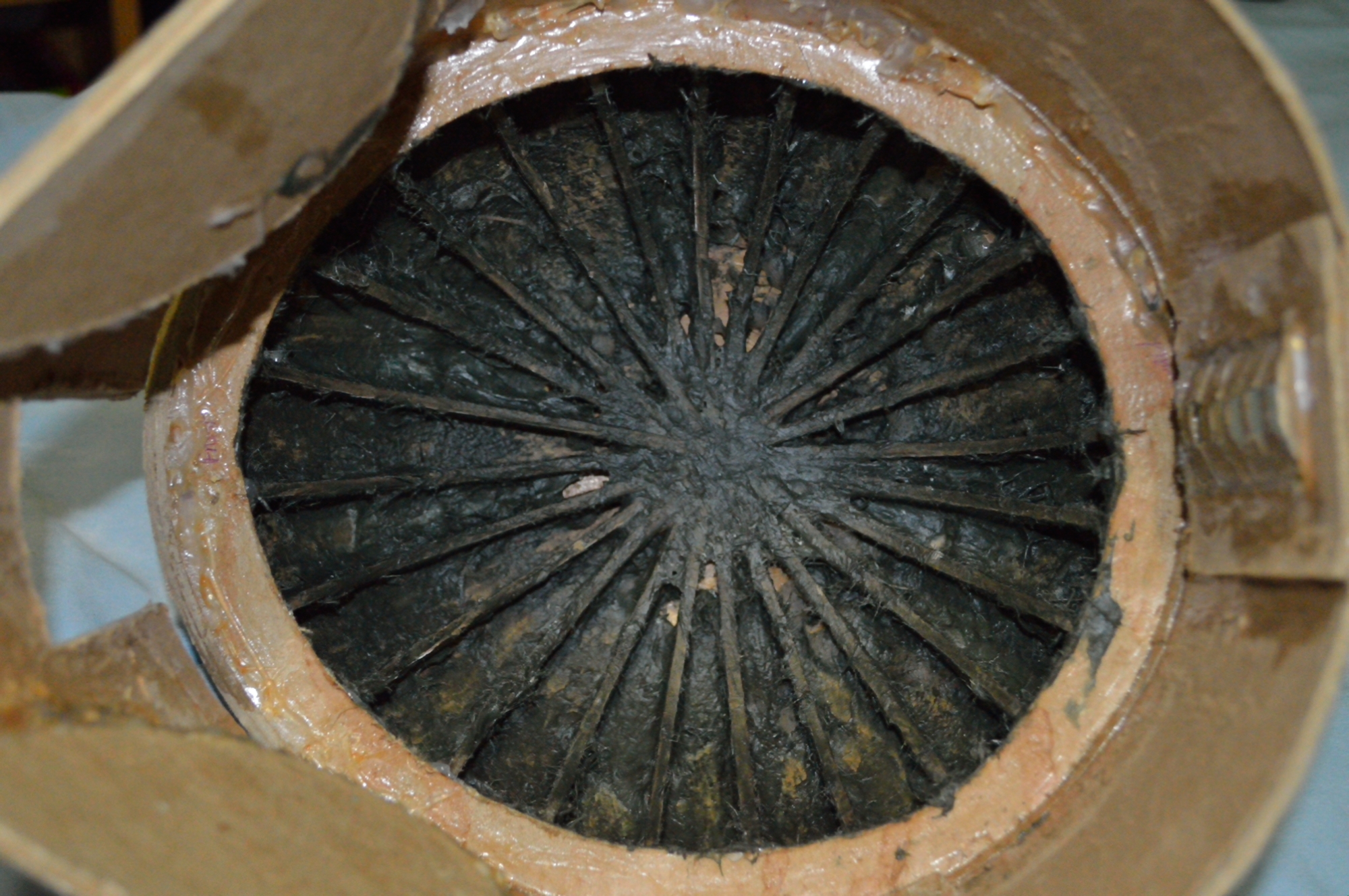

We fiberglassed the inside of our helmet domes also for added strength. We are planning to sand down the cardboard supports a bit also to save some weight. Plus with the fiberglass we shouldn't need them to be so thick anymore.
View attachment 87940View attachment 87941DSC_0087.JPGDSC_0089.JPGDSC_0090.JPGDSC_0091.JPG

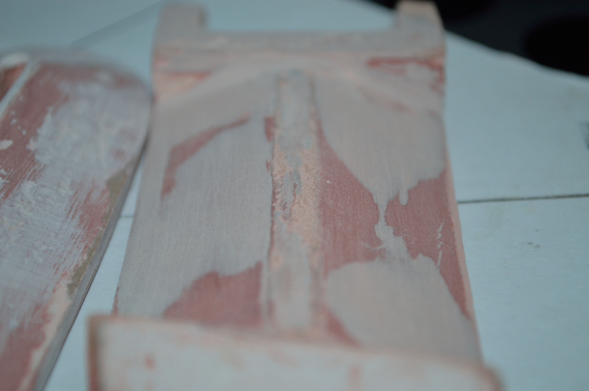

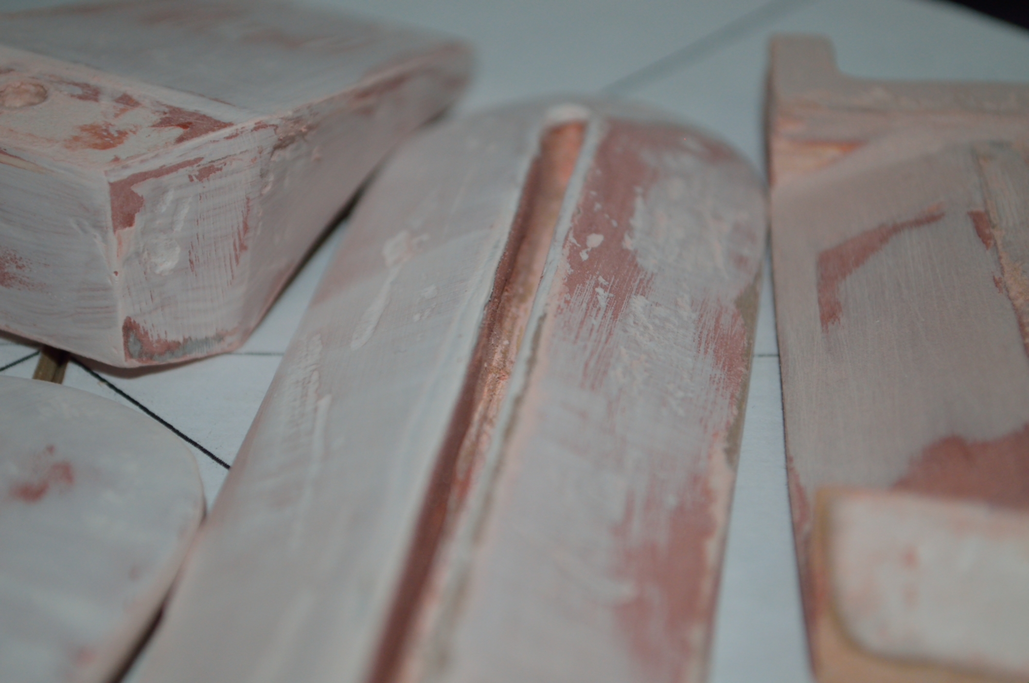

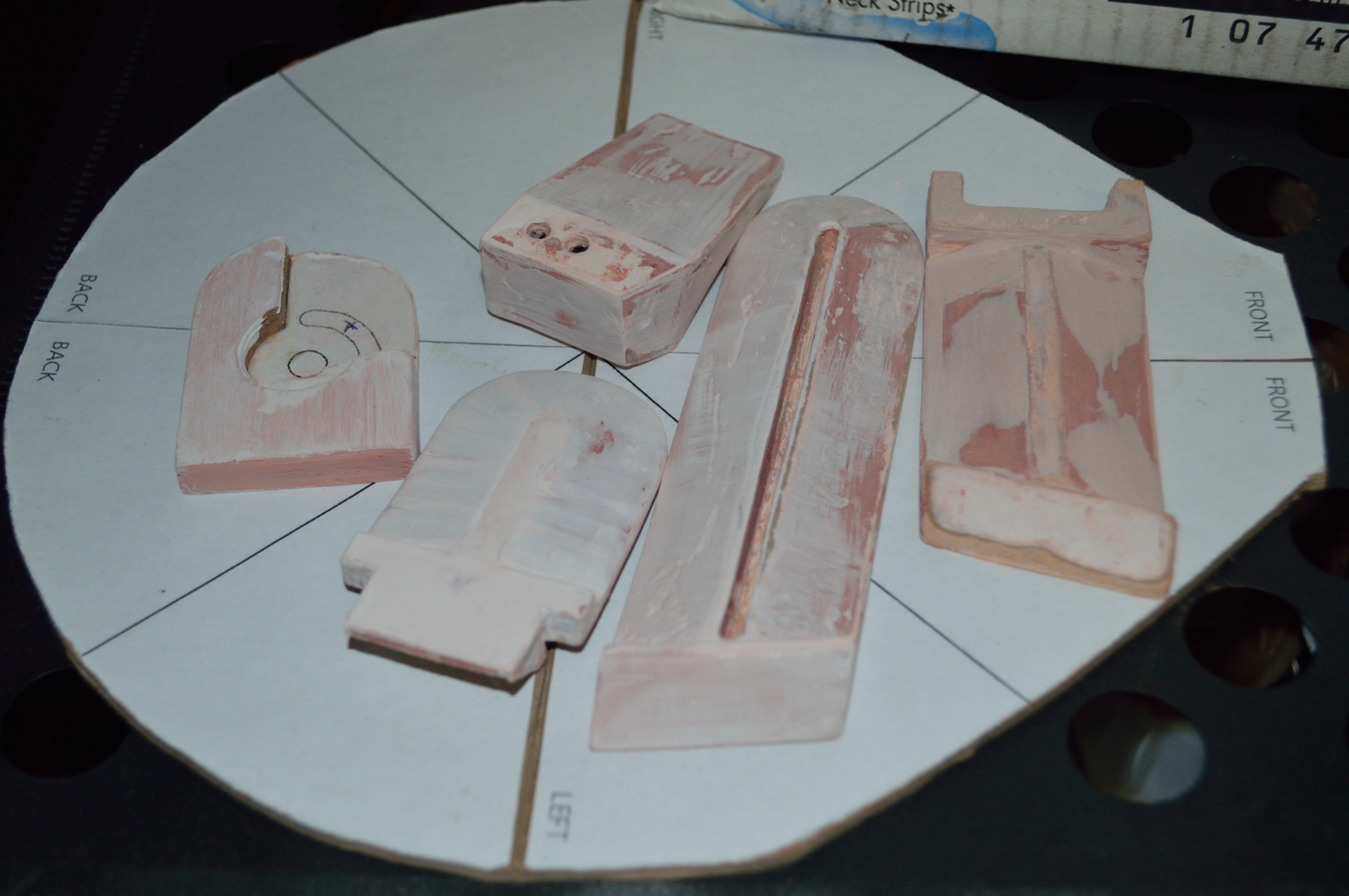

Here are all of Sara's pieces so far:
And mine:
And we started doing some fiberglass and bondo on the dome starting from the top and going downwards. As you can see we aren't too far yet, but I'd rather go slow and carefully than rush it.
So that's what I got. If anyone has any opinions or you think something is wrong or off, please let me know, we would both really appreciate it!!
