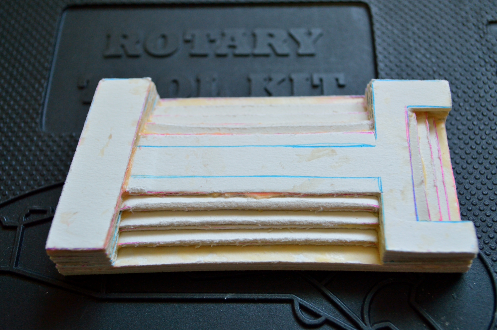

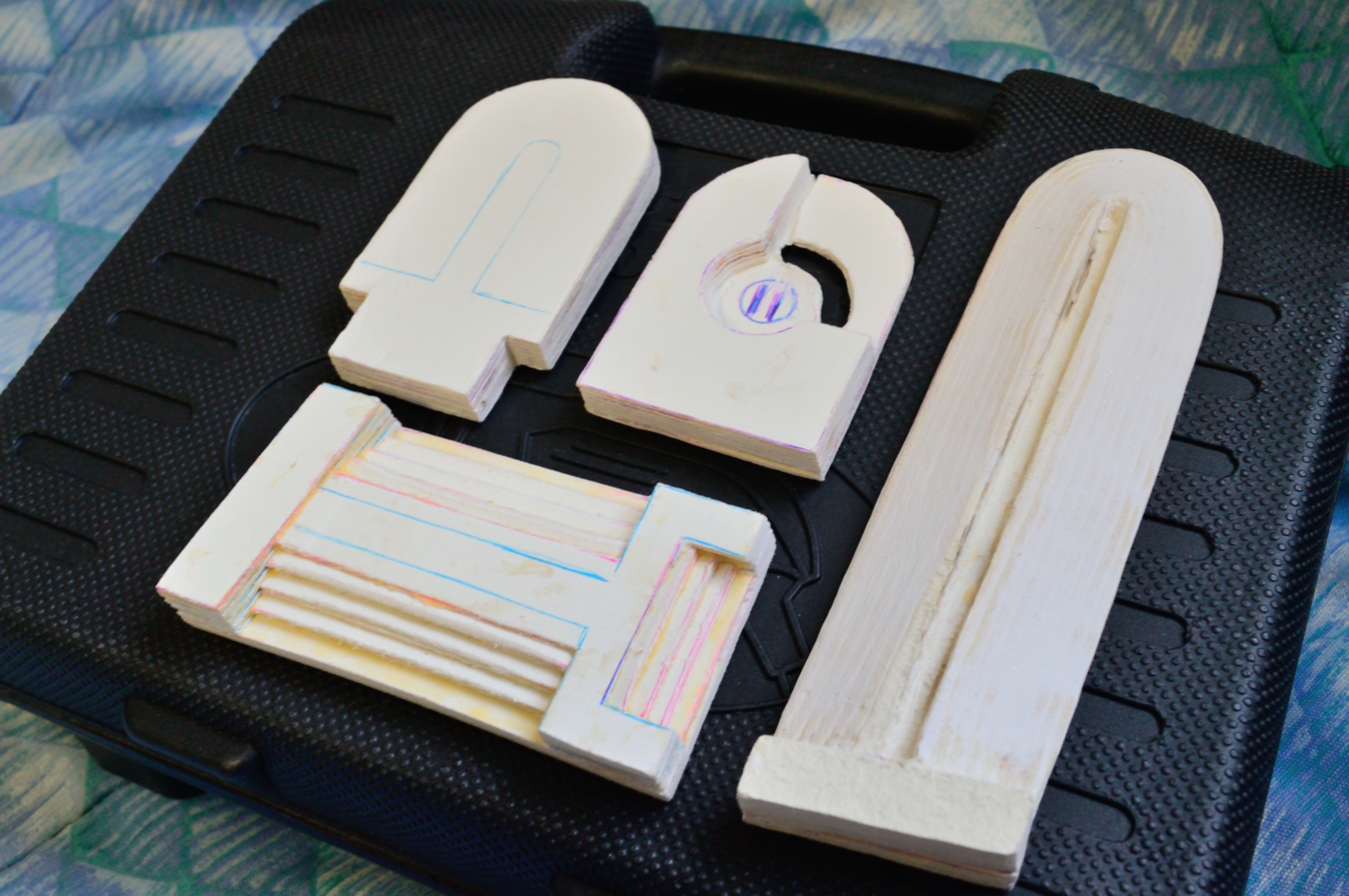

Update!! Alright so I actually started making this helmet a few years ago, and only ever got the basic thing put together and smoothed, but never did the ears, rangefinder, keyhole, dent, etc. Just recently my girlfriend decided to help me start the project back up after the helmet had been sitting on the shelf for a LONG time. We got the ears, rangefinder, keyhole (my failed attempt at one at least) very roughly put together and had started to sand and smooth out all the parts using the templates i printed out years ago and still had... That's when a "OH CRAP" moment happened, just yesterday...
First off, here are some pictures of the parts.

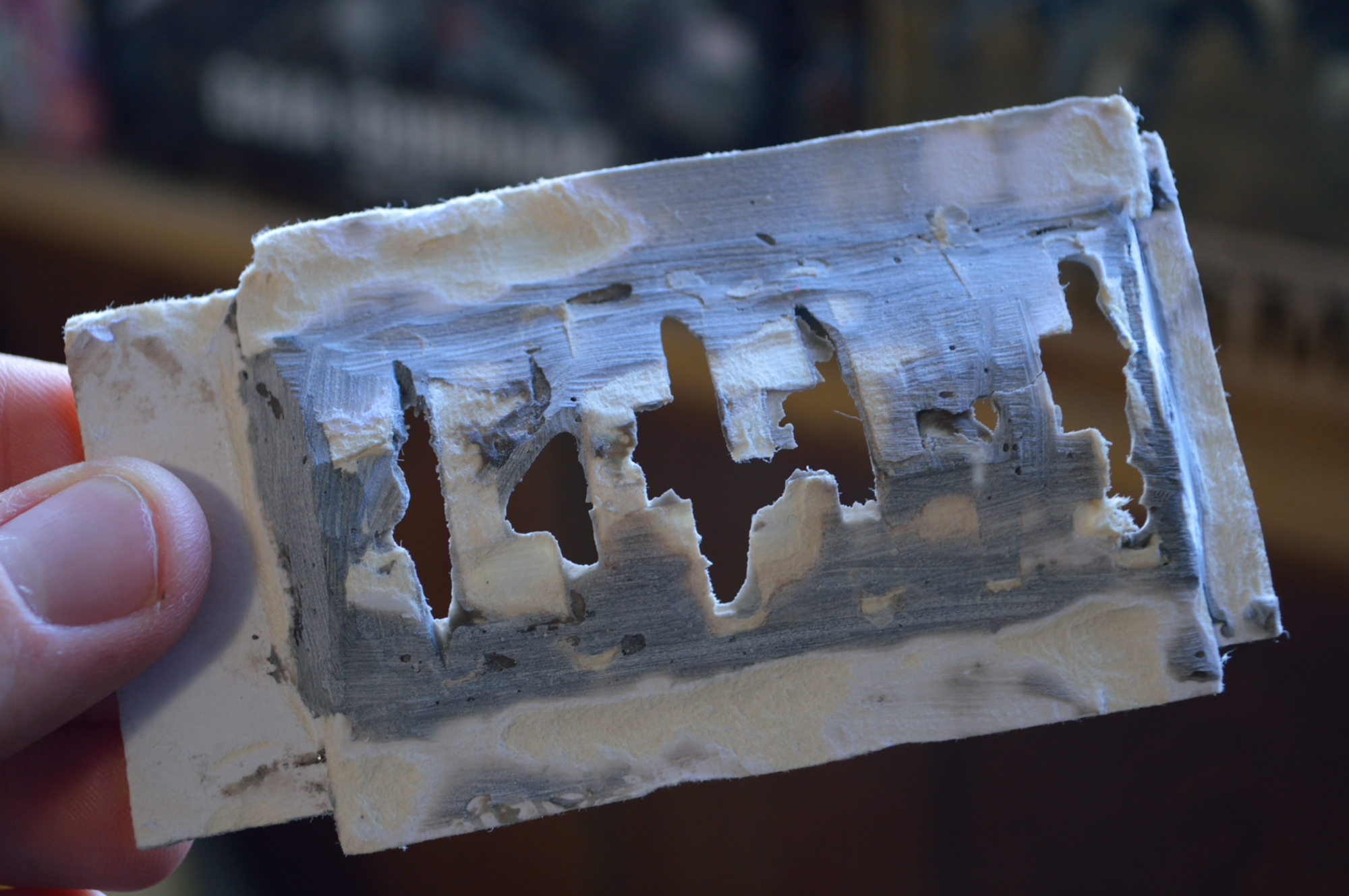

Now as you can tell, the keyhole I made was cut out very roughly. I actually had decided to try and fiberglass it and sand it back down and was going to dremel the slots to smooth perfection.. obviously I gave up and threw it away and am going to start that one over again! The rangefinder, I have no idea why I am using the quickweld to reinforce it, but I am liking the strength it has and just need to sand it down now.. The other parts are going well, and I am pretty proud of those actually.. But the "OH CRAP" moment was when I started to measure things and realized everything was way too big, literally up to 10mm too big in certain areas. SO I printed out some new templates, and realized that back in the day when I printed my templates out I let the printer software stretch them all out to fit the paper..

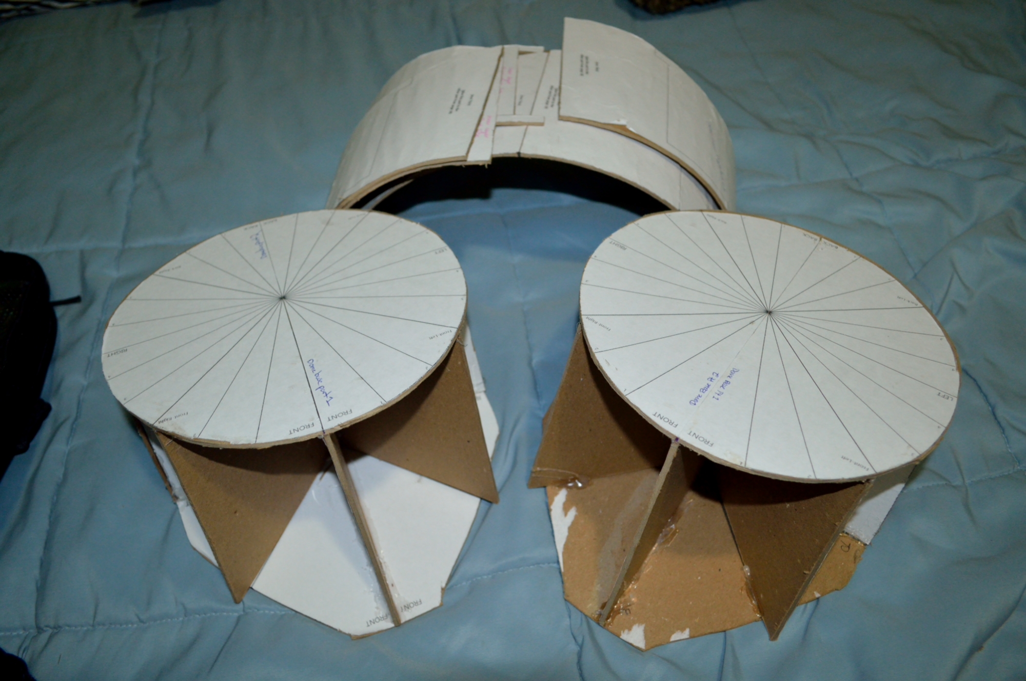

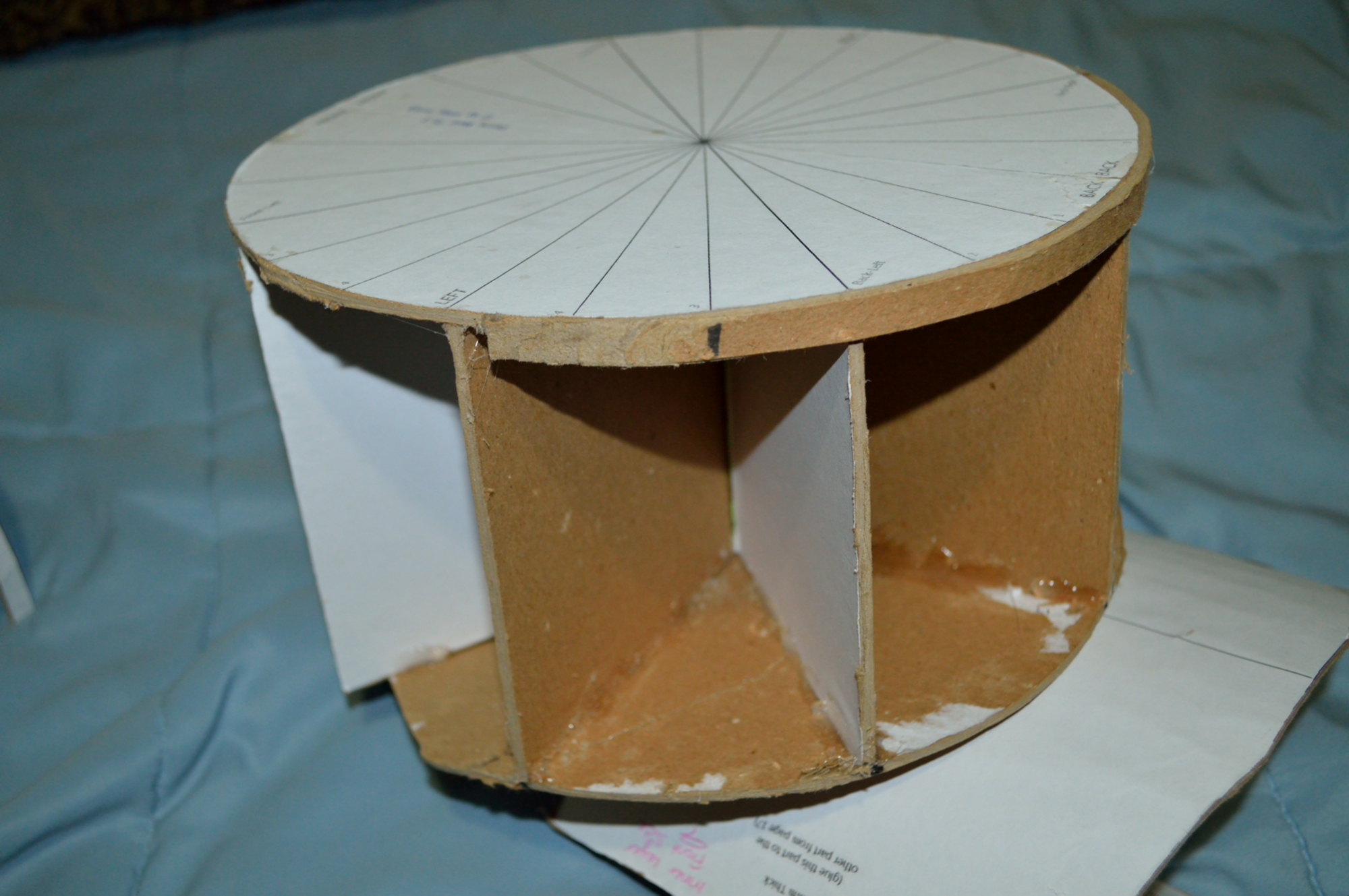

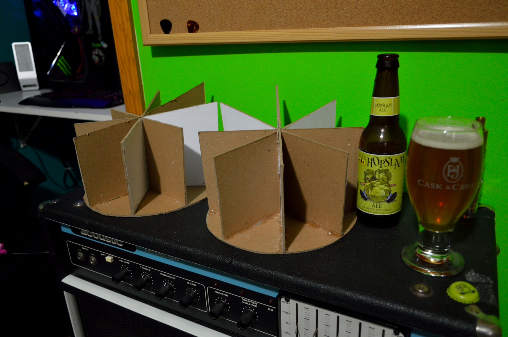

All we got done today is the supports for the base, using Rafalfett's templates. Took longer than we thought because the only 2mm thick cardboard we found is super heavy duty stuff. Not easy to cut at all. (The one on the right is mine, while the one on the left is Sara's) As of right now they look the same obviously but I feel like it's going to turn into a slight competition =p
Looking good so far though I think!

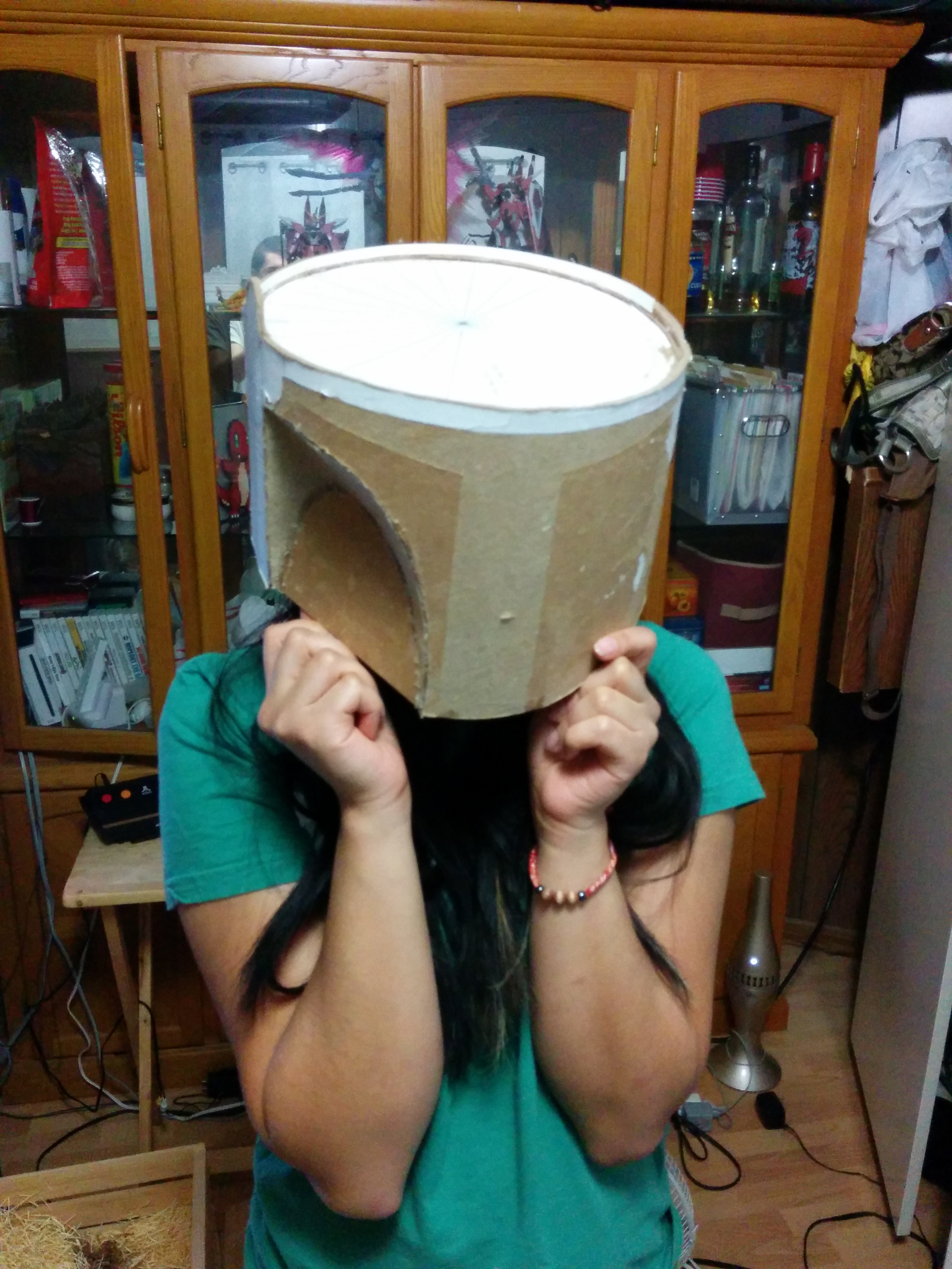

And Sara being impatient to wear her helmet ! Lol

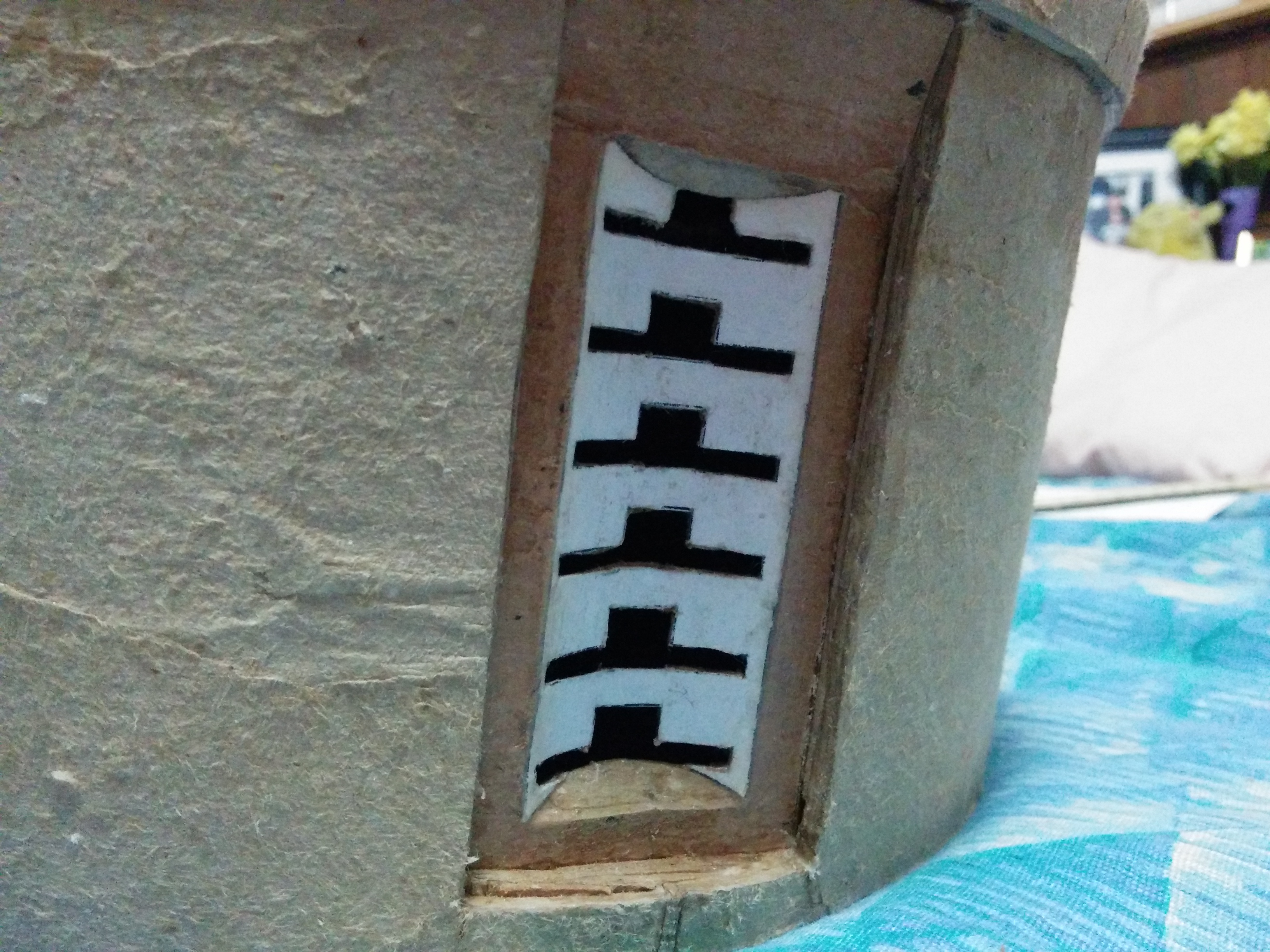

We also got our keyholes made and are in the process of reinforcing them on the back side a a tiny bit of wood glue at a time, as that seems like it will be difficult after they are actually in the helmet. Sara's keyhole looks flawless, where as mine is a little bit.. Not as flawless :p. Again hoping for opinions when I put the pictures up.

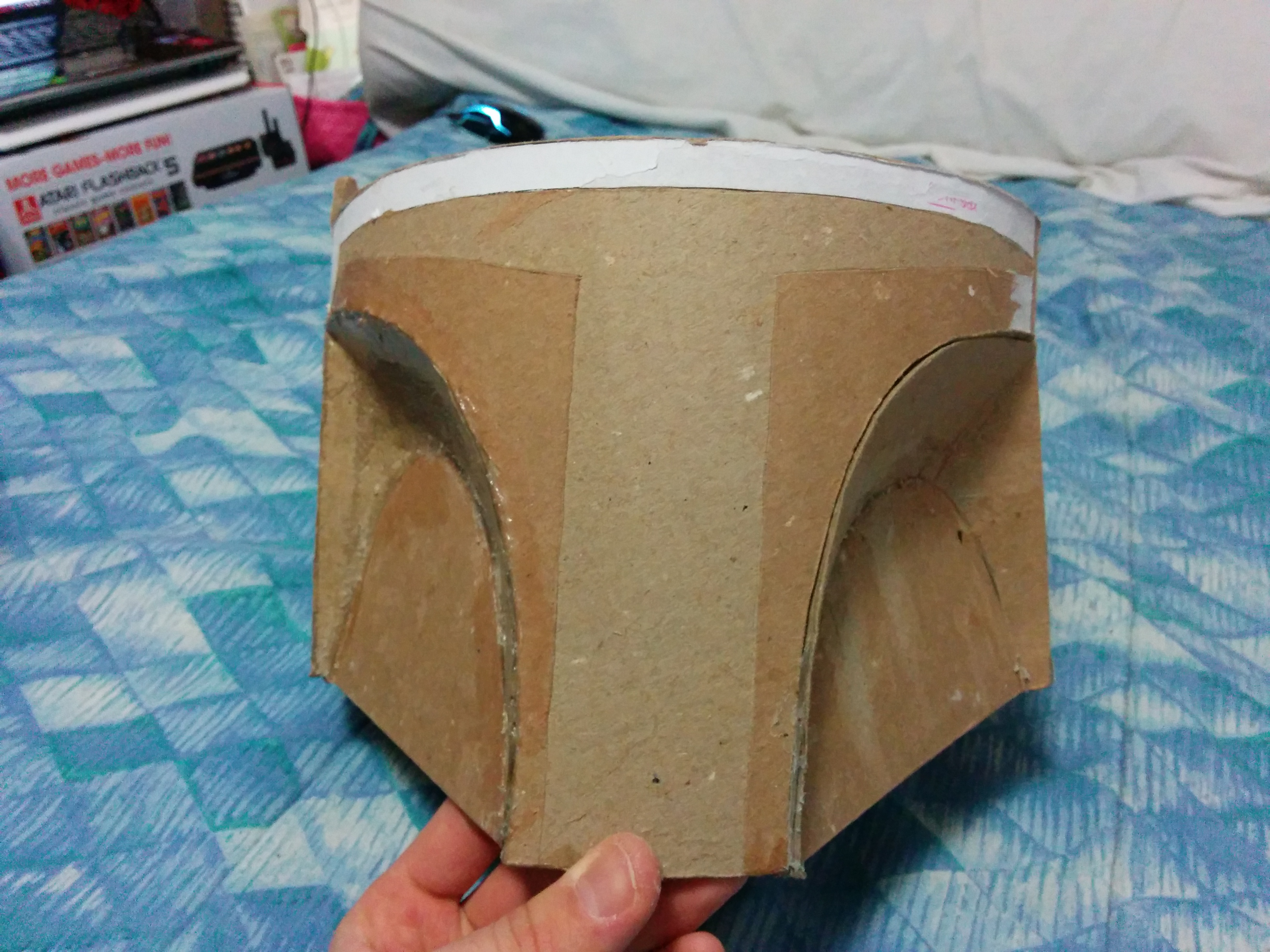

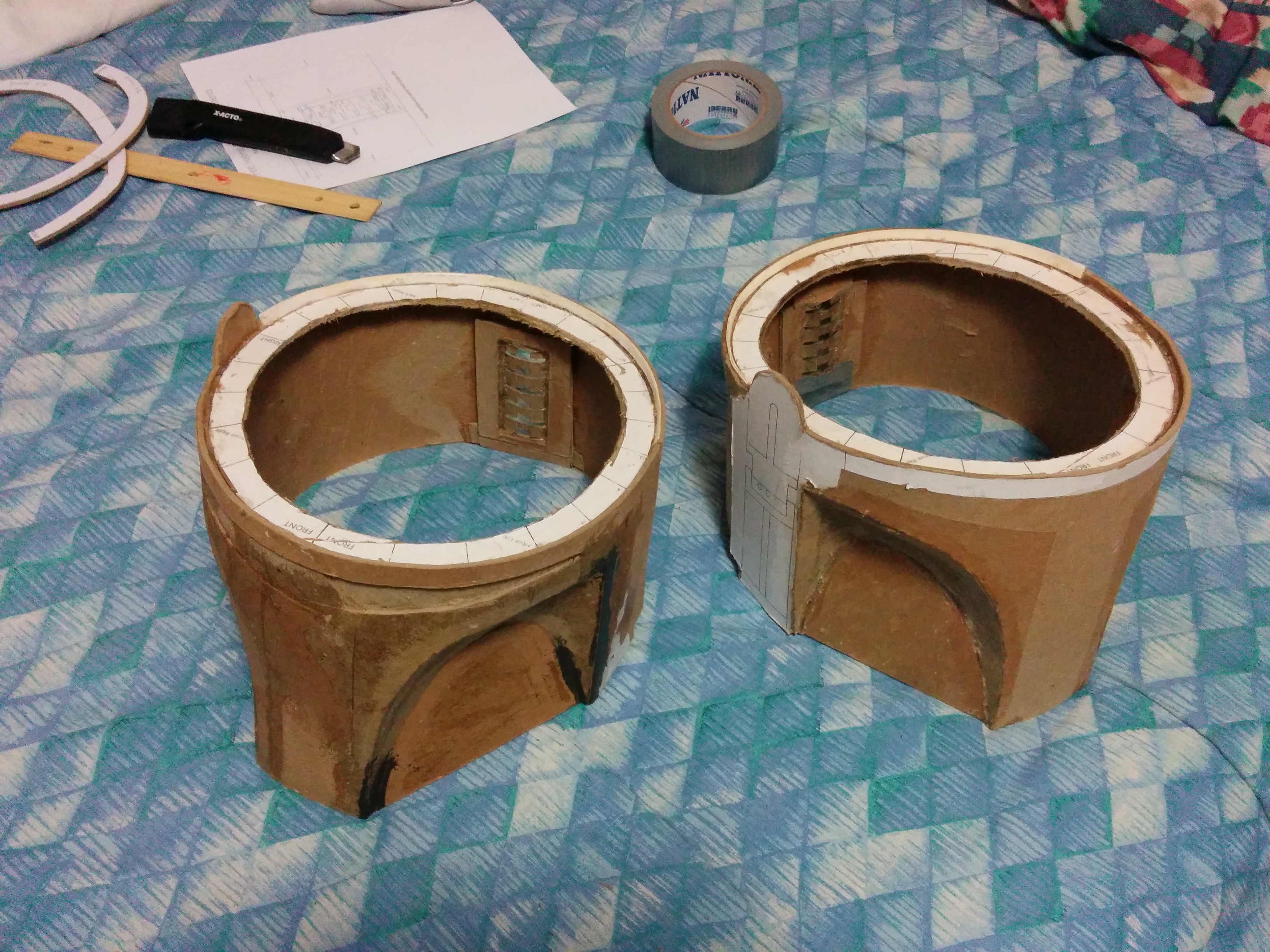

I finally have some free time to get pictures up. These are taken with a phone though so sorry about the quality =(

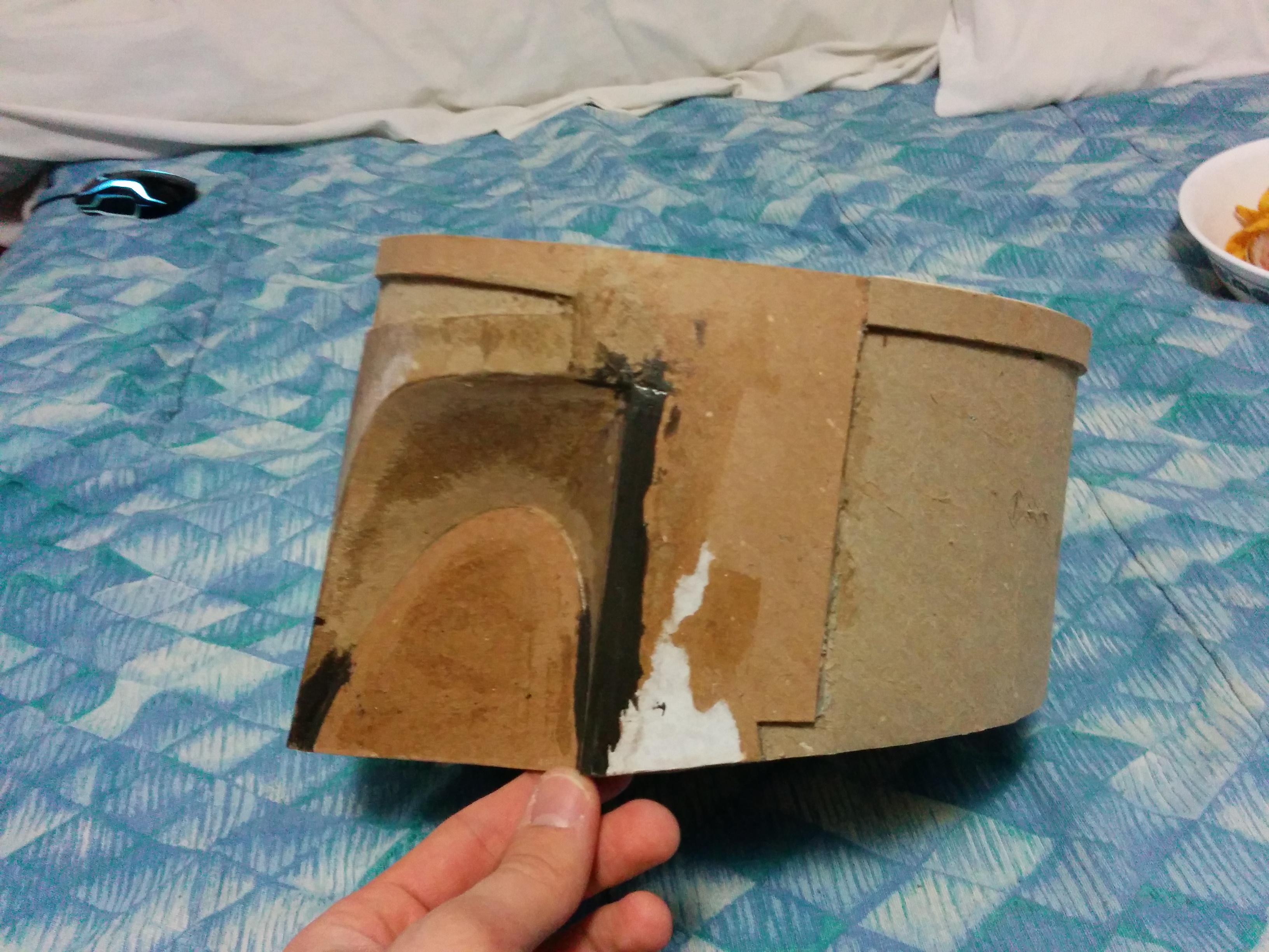

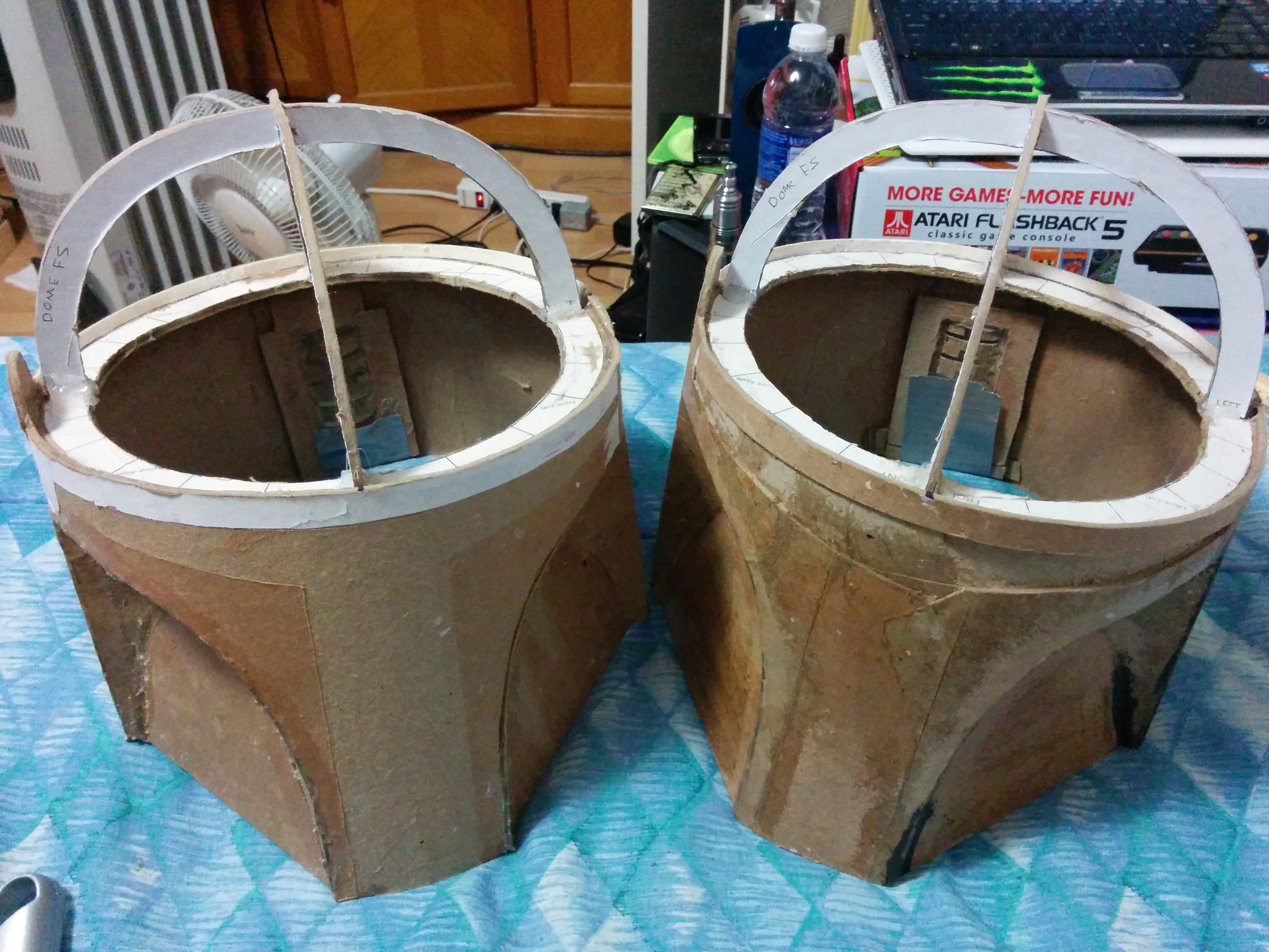

These first pictures are of my helmet after I got the second cheek in. We are trying our best but I know they are not perfect after looking at other's threads. I do reference the measurements that rafalfett posted on his thread though and nothing is more then 2-3mm off at any point, and most of it is exact.
I'm hoping that I can get some feedback on anything that may look like it needs to be redone though, anything that you guys think sanding/putty and bondo won't fix.
This is Sara's helmet after she got her second cheek in also.
As you can see her left cheek is a bit low, but when I measured the visor from the top corner to the bottom of the helmet it seems that it was actually the visor area that was 2mm too short, and the cheek that is low was actually at the correct distance from the top. This is a big one that I'm hoping for some feedback on.

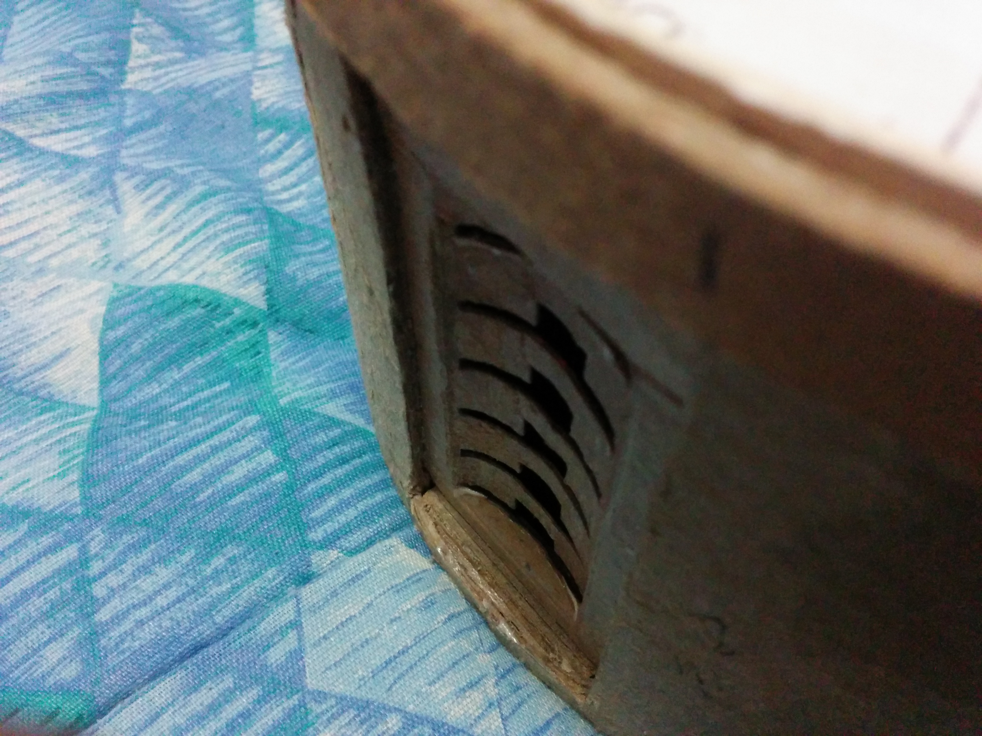

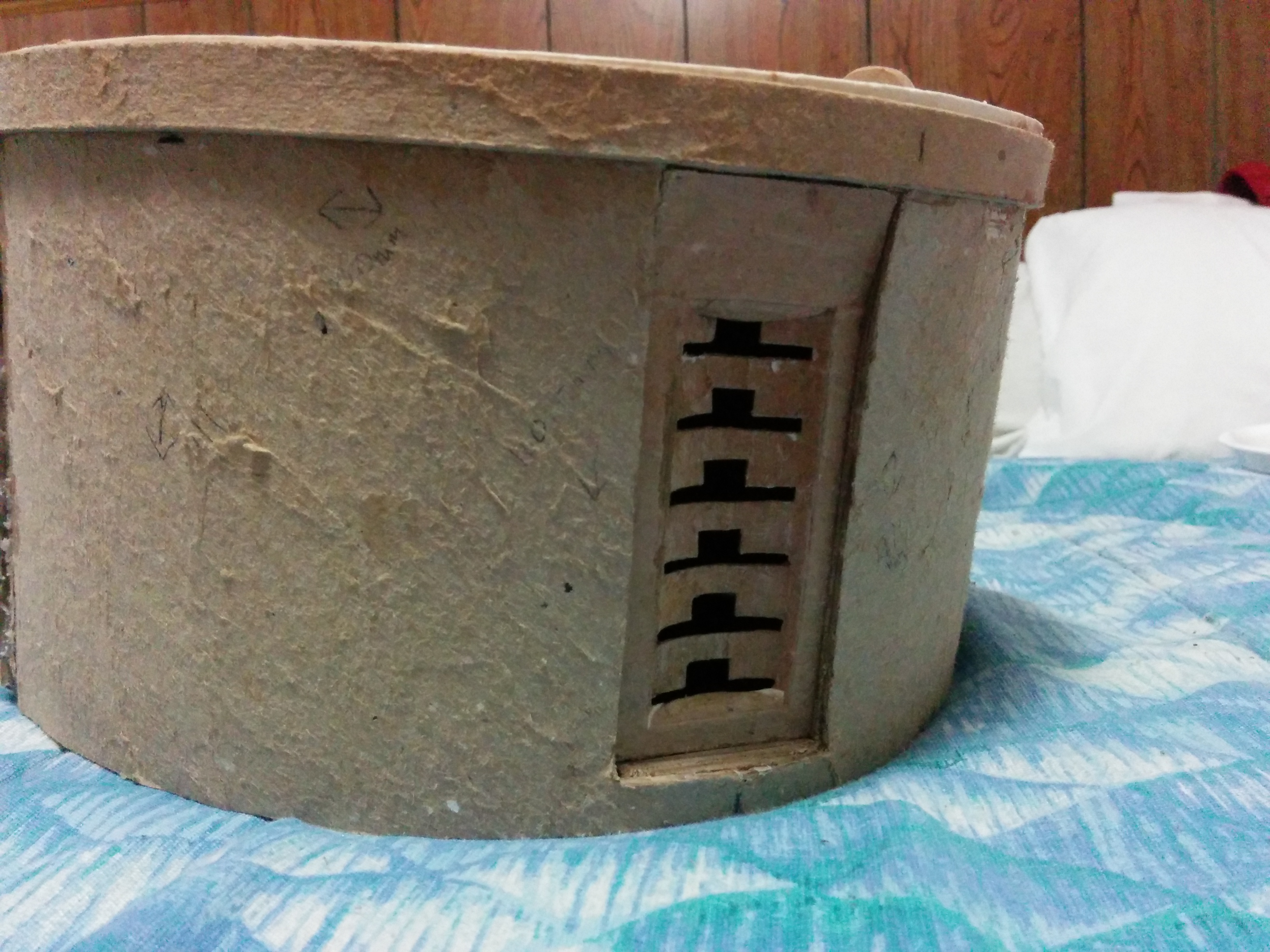

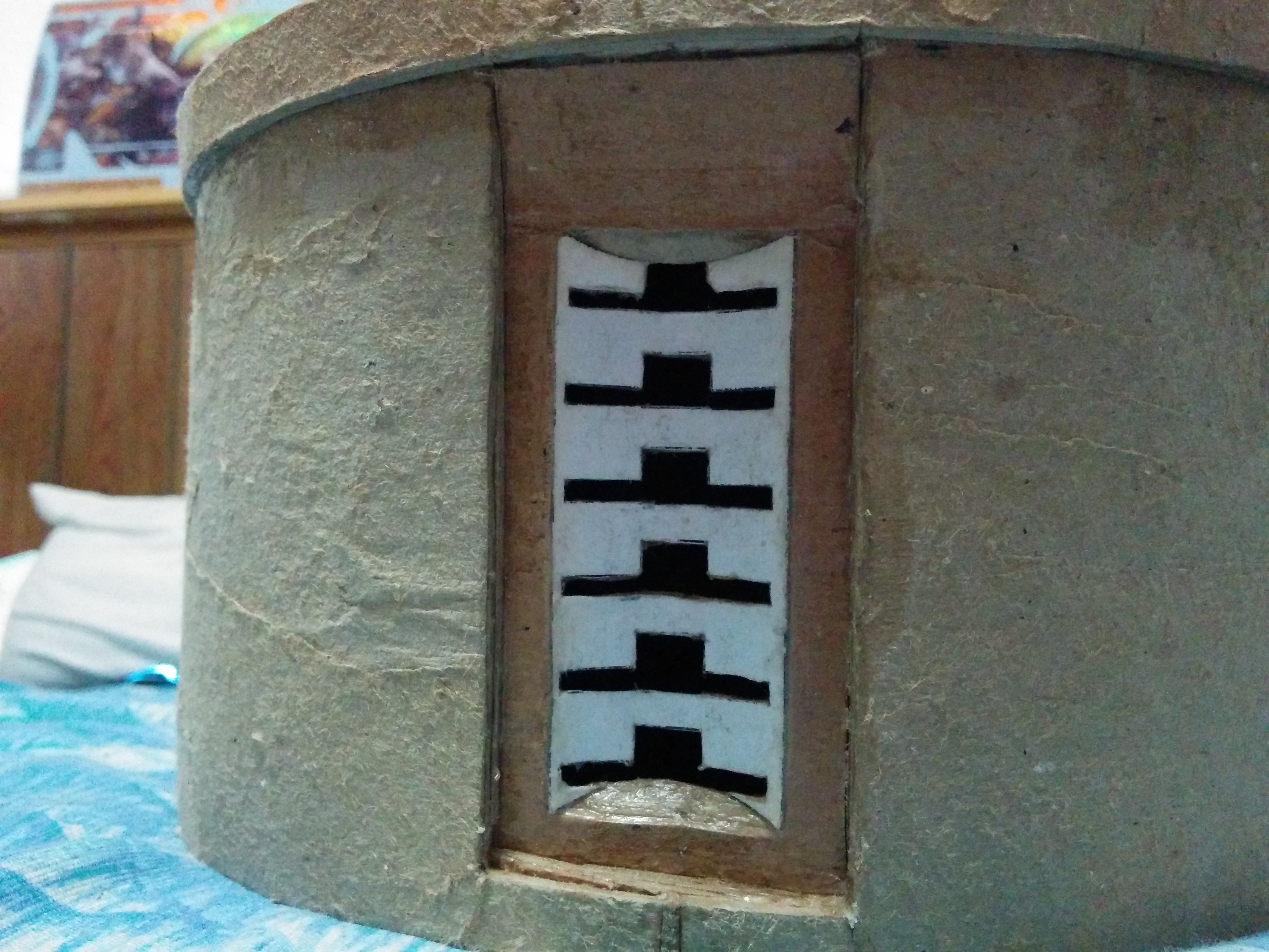

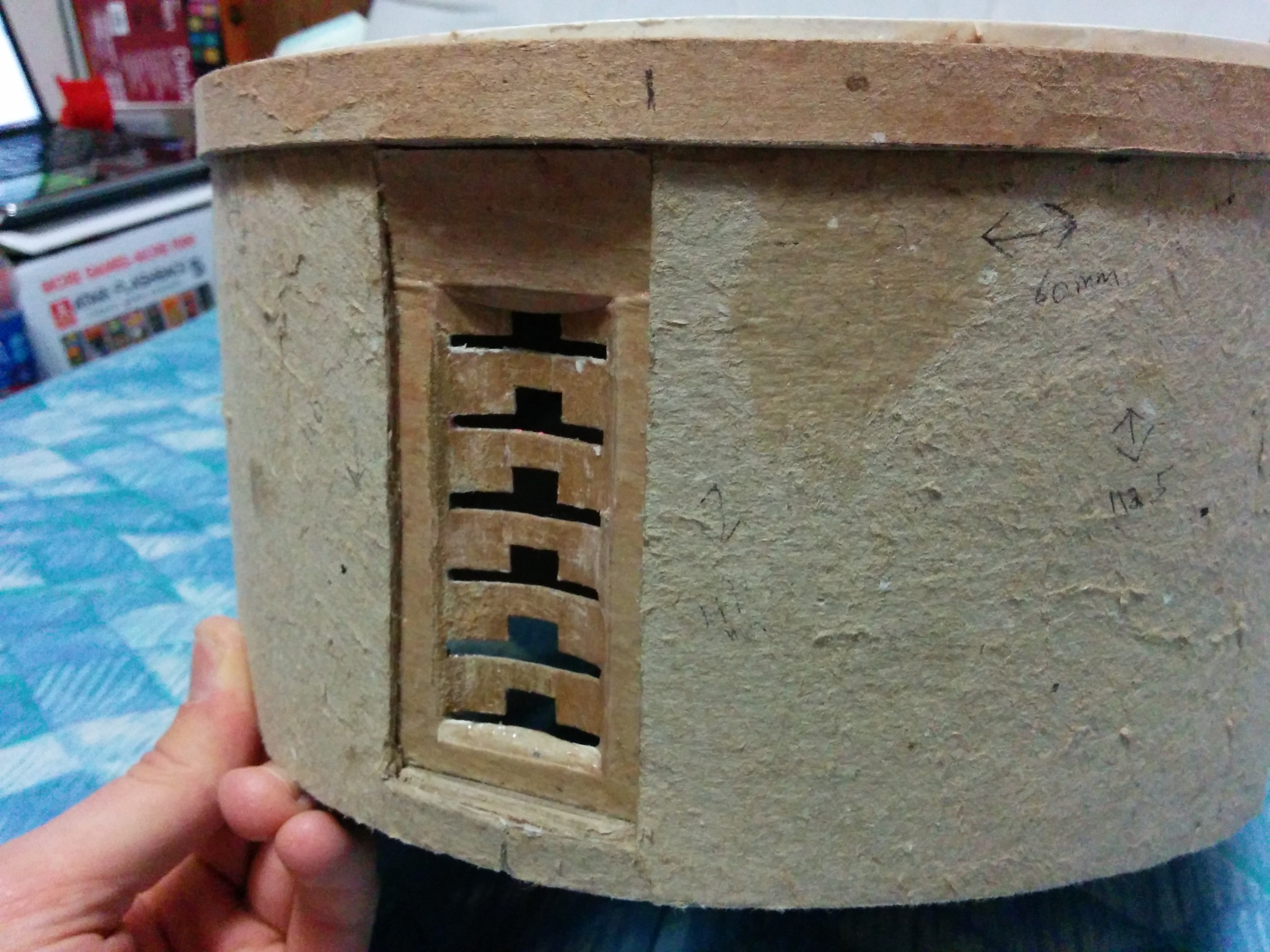

My keyhole:

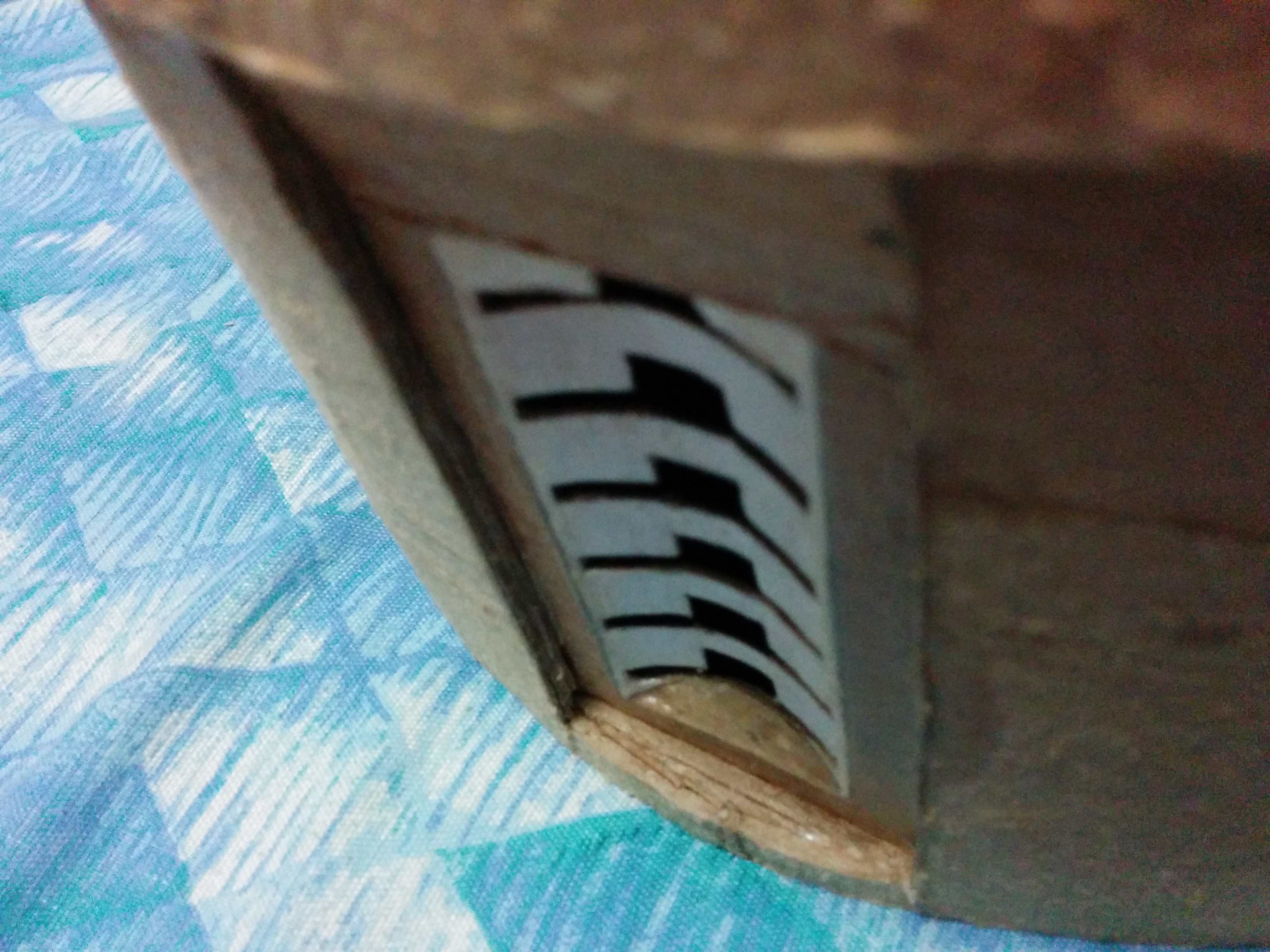

Sara's keyhole:
Our keyholes took us a lot of time because the slots kept ending up rough and the layers would peel away when the board was curved. We ended up taking our 2mm board and pretty much slicing it in half by peeling layers off until it was 1mm. That made the cutting way easier and also the board didn't peel away or get rough when curved. I realize the slots are still a little rough but we wanted to just get them put in for now, and later we are going to smooth them out more.

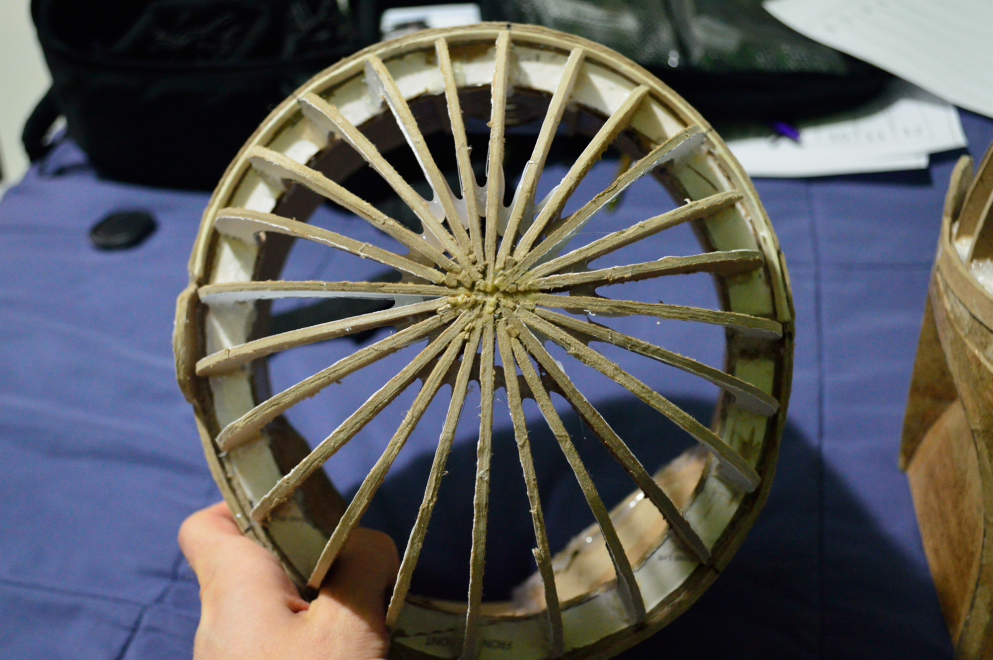

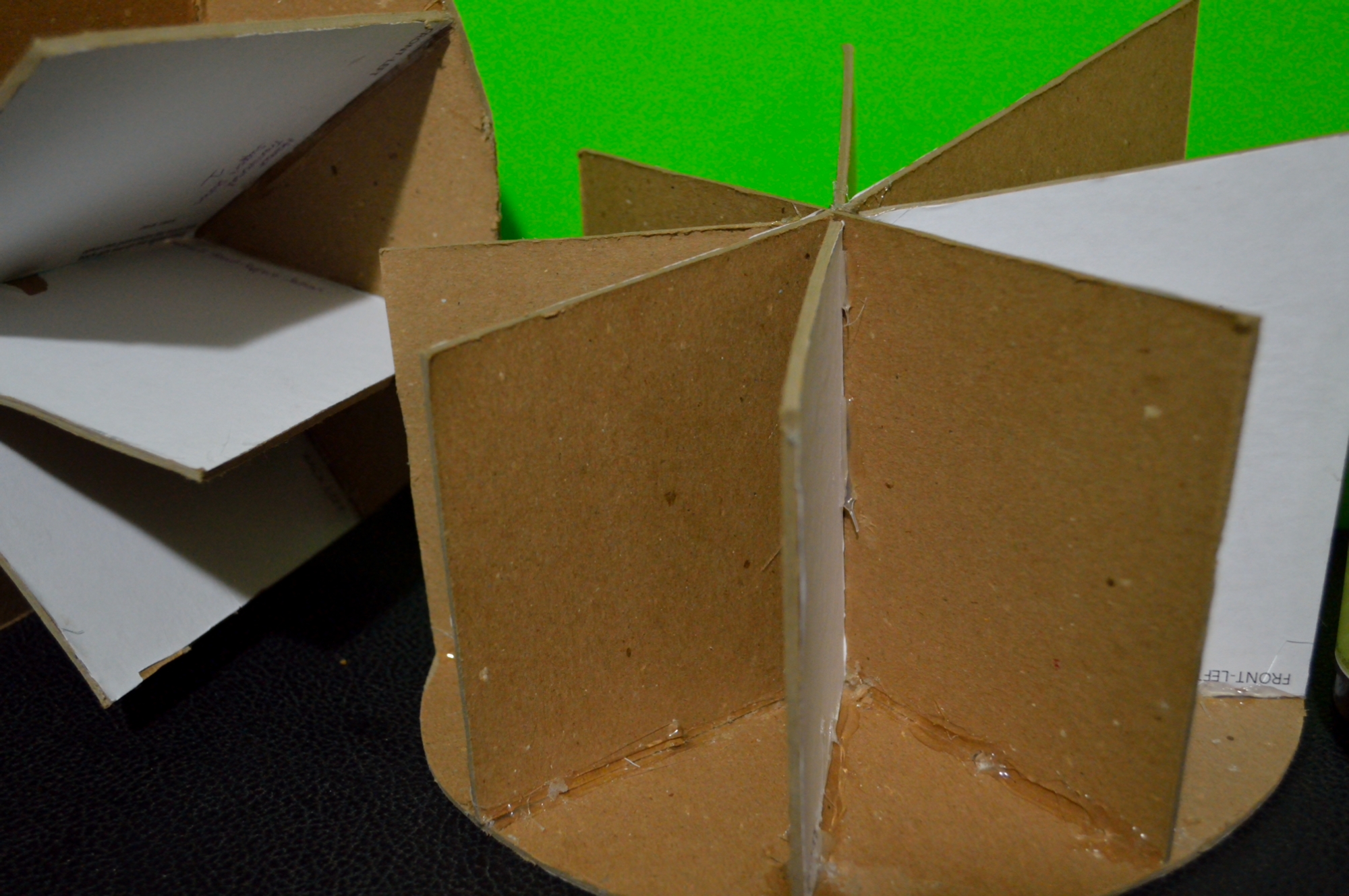

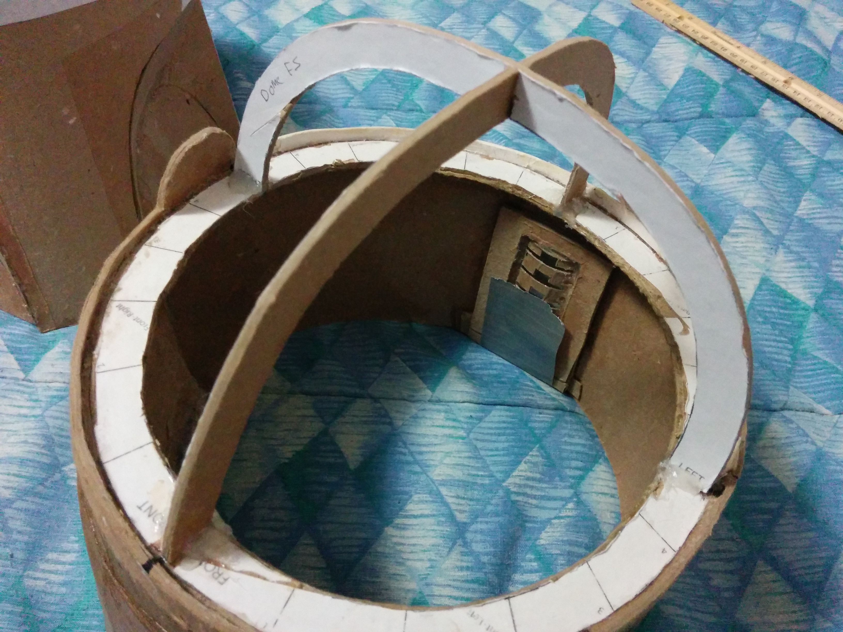

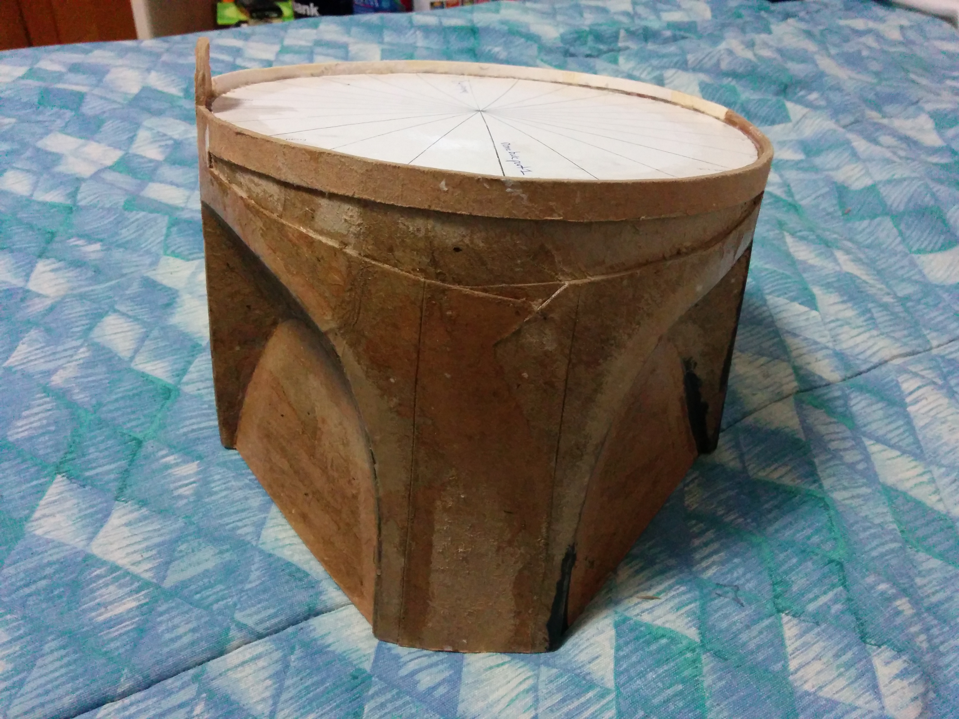

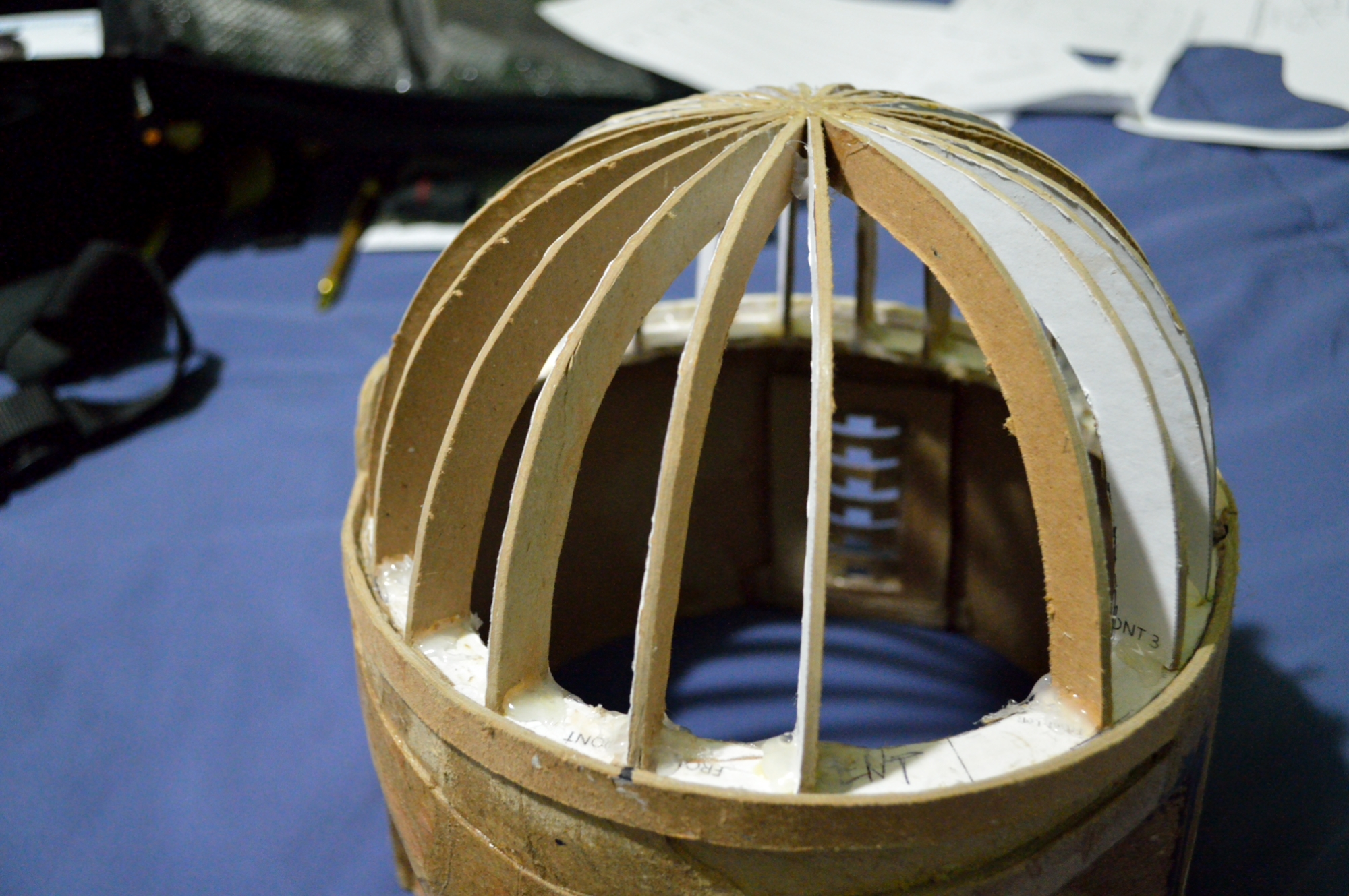

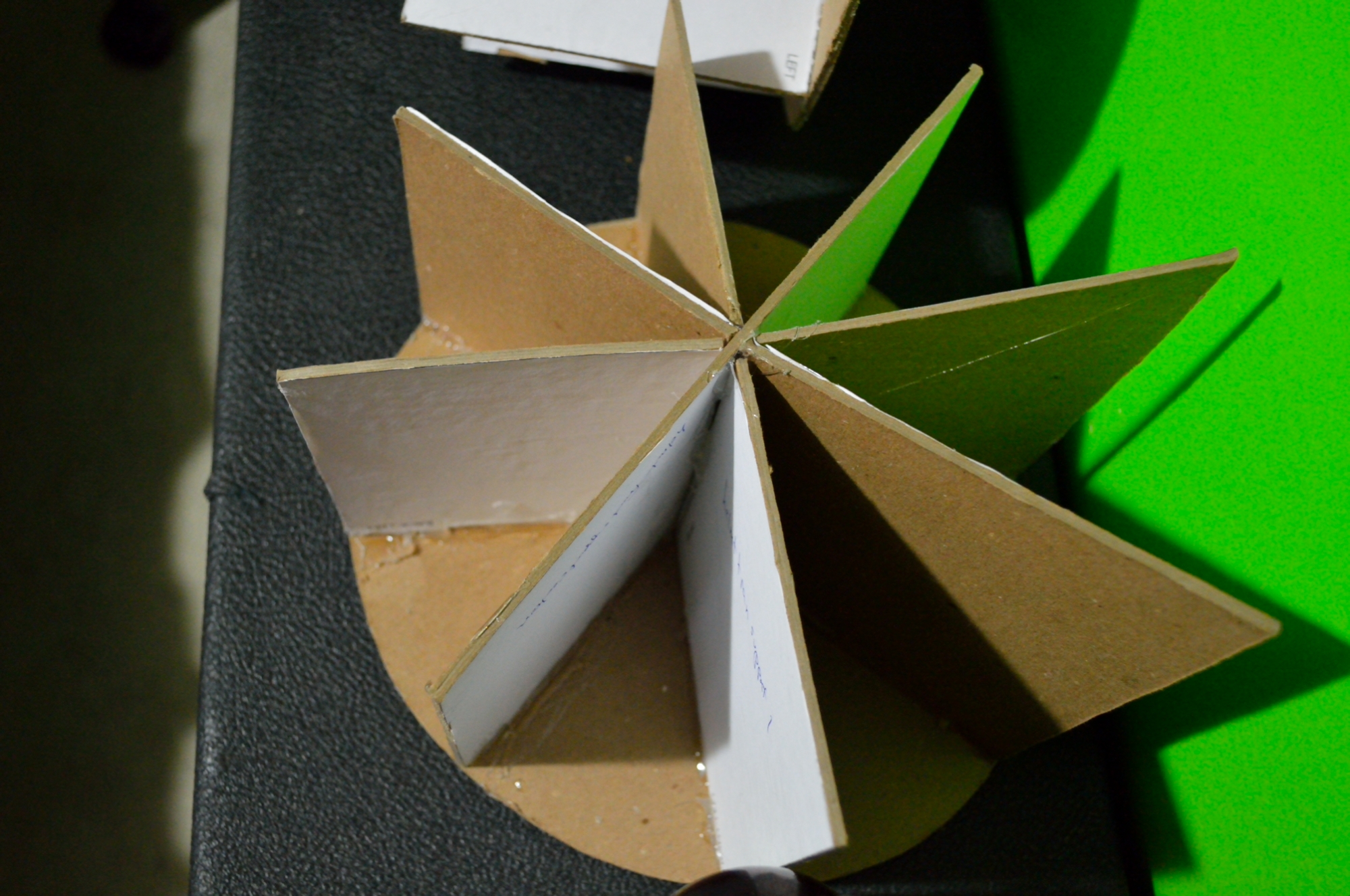

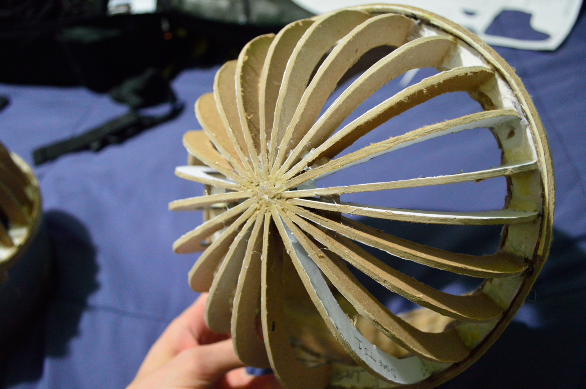

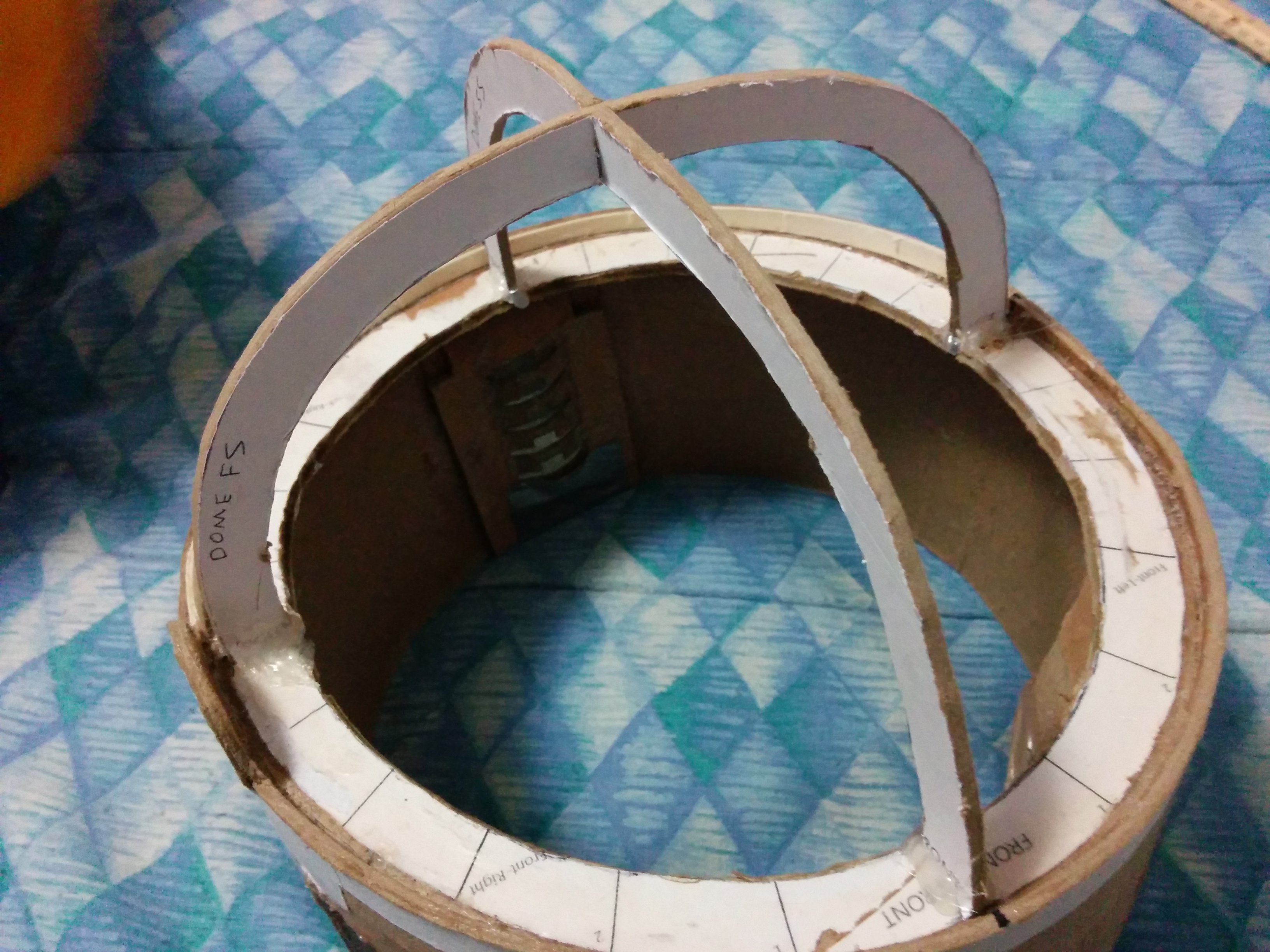

We then cut out the dome base and left a 15mm area for the supports
It was tricky trying to get the supports nice and flush/straight and exactly centered on the front/back and left/right lines but we got a couple of them on perfectly and this is where we are at now.
The way that we put the strips on was using wood glue underneath them, and when they were in place using hot glue almost as a clamp to hold them in place.
I know we could have just used hot glue, but better safe than sorry.
We are planning on putting in all of optional supports also to give us a little more precision when we get to laying down the dome strips.
Feedback is greatly appreciated!! I don't mind some constructive criticism, I know we could probably use some lol
..off to try and get the rest of those supports in! Thanks all!
I can say that both of you are doing a great job following my step-by-step guide, so there's nothing to comment so far. Keep up the awesome work!

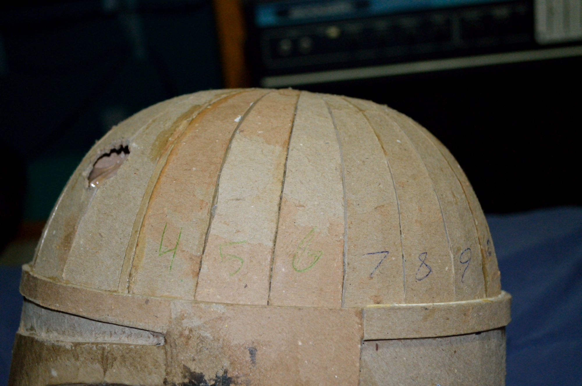

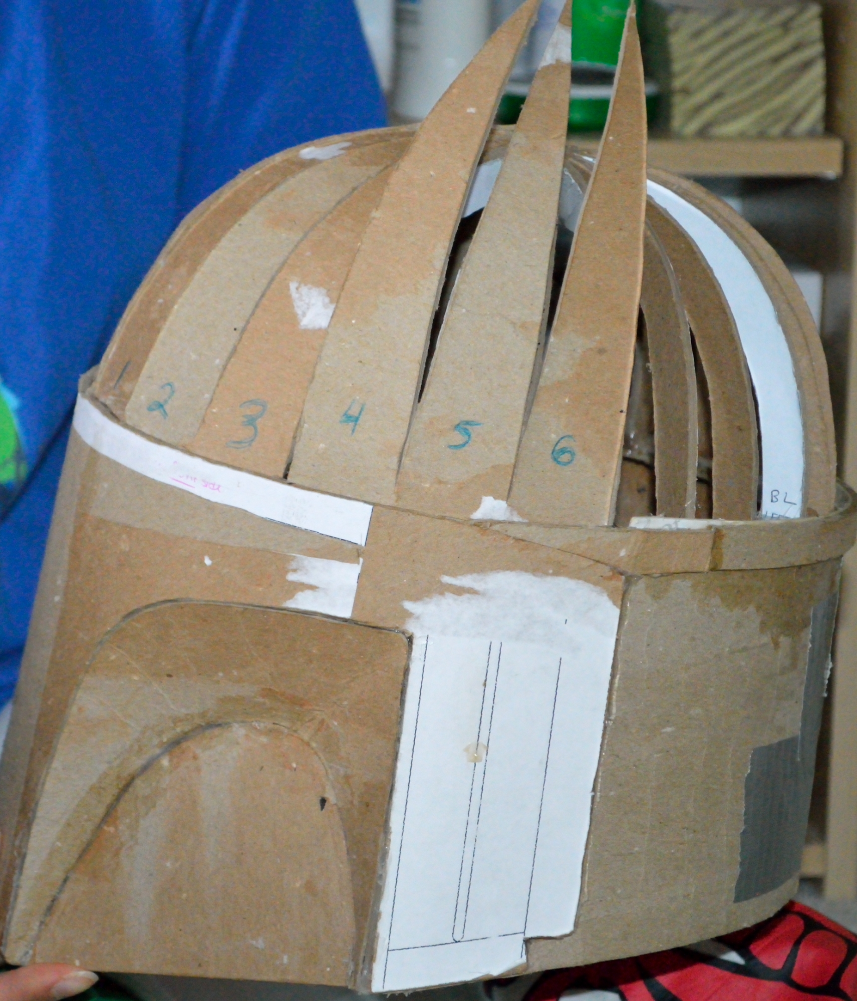

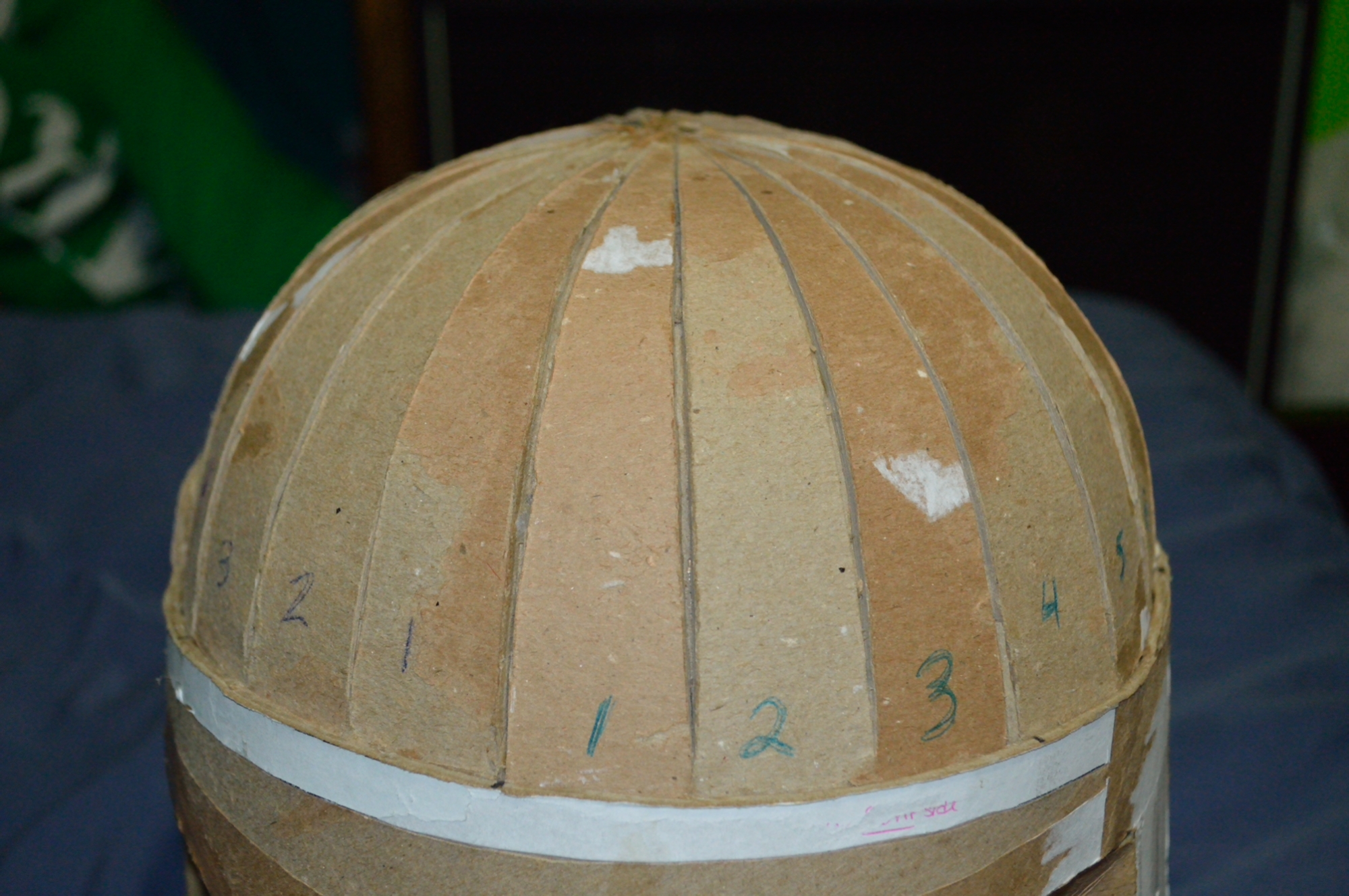

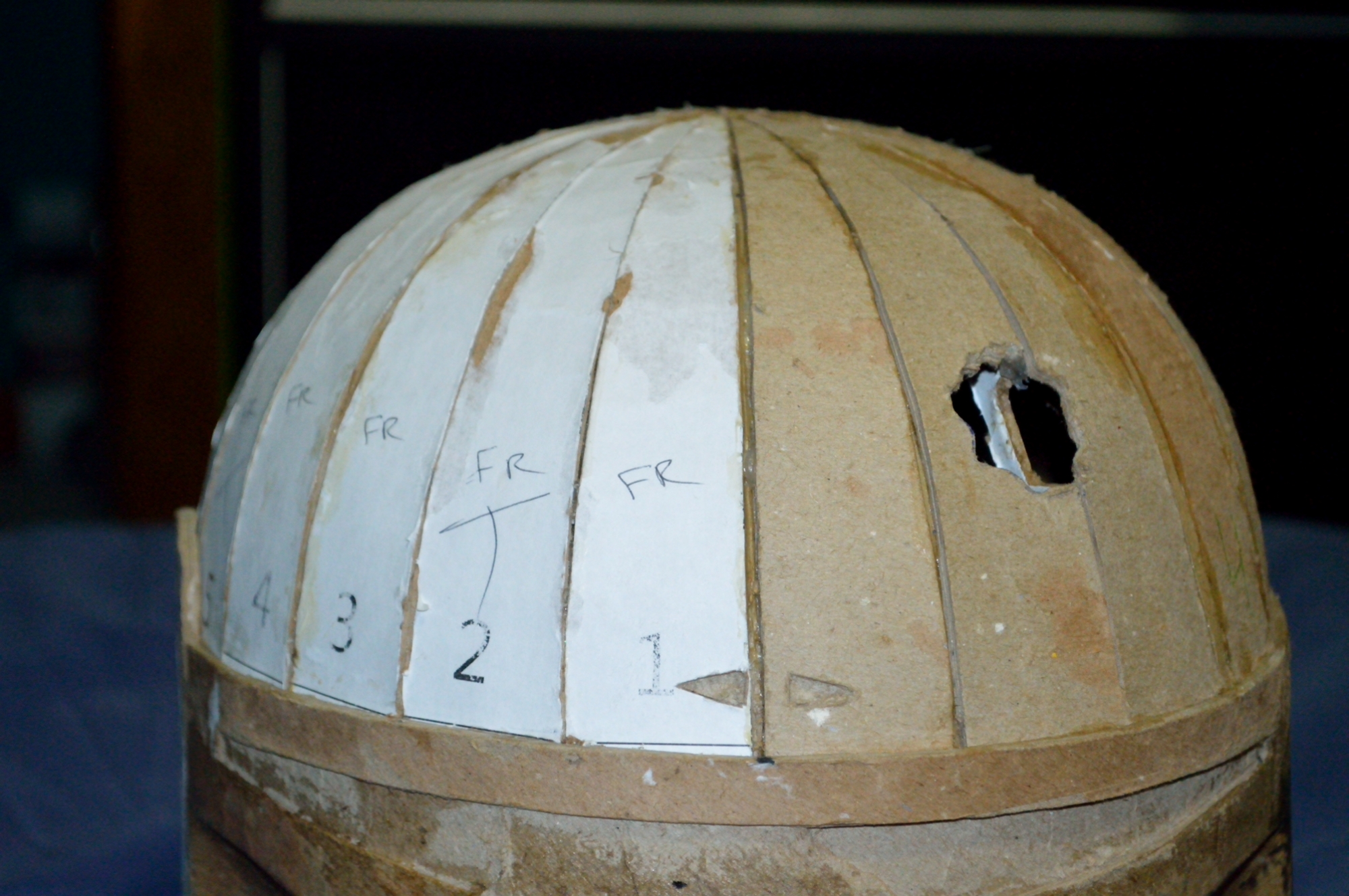

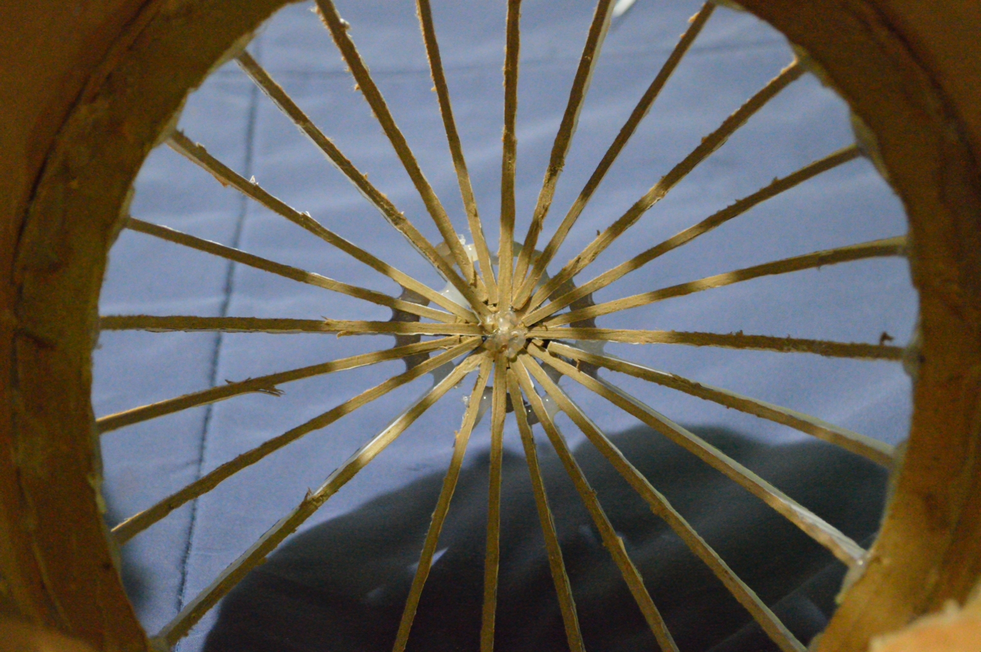

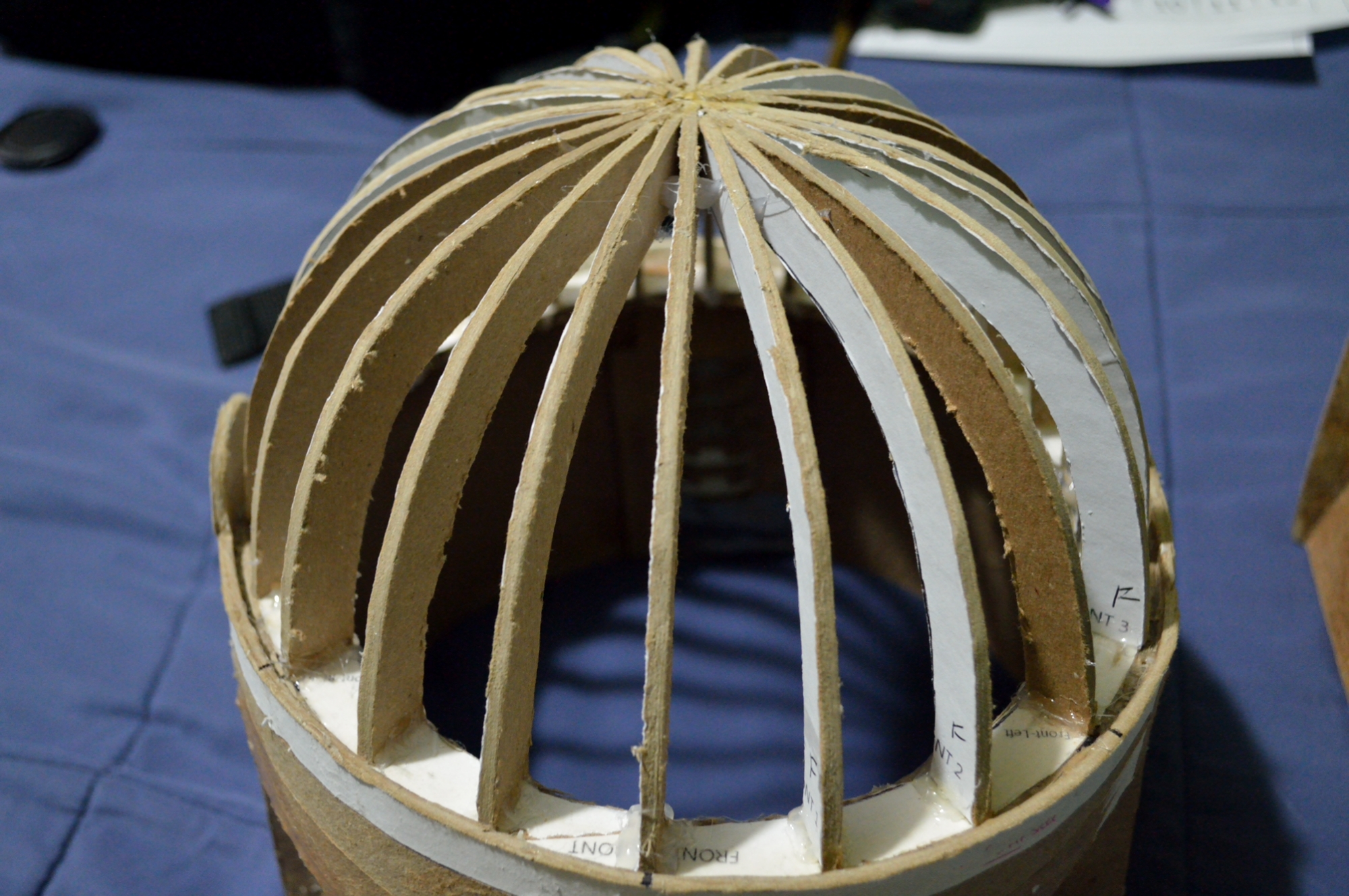

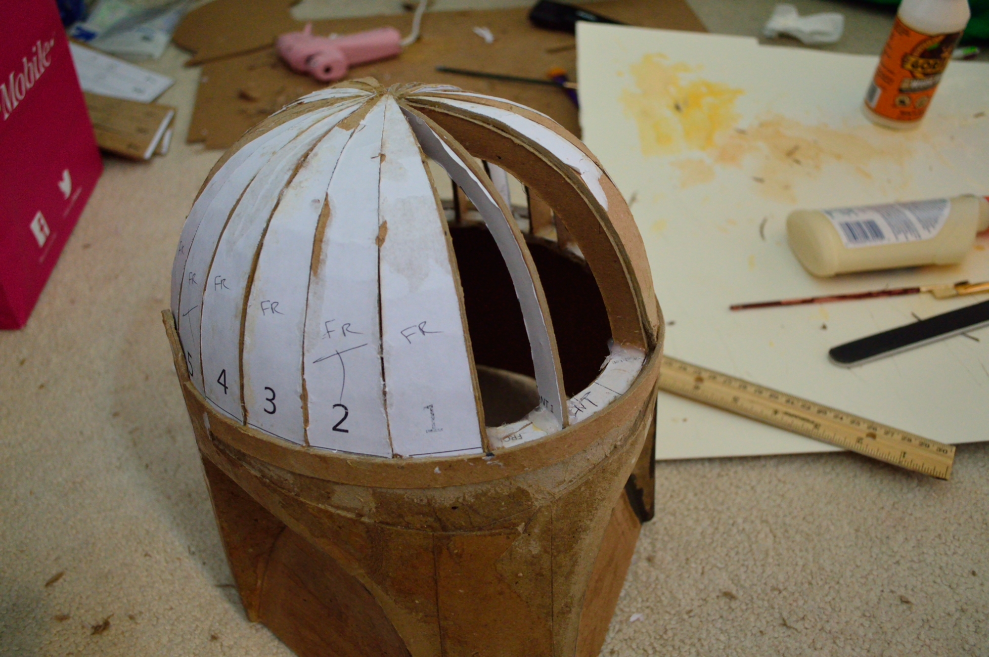

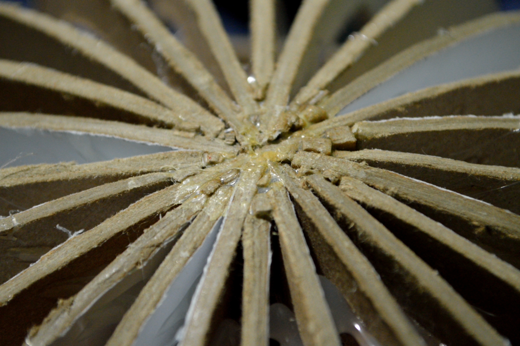

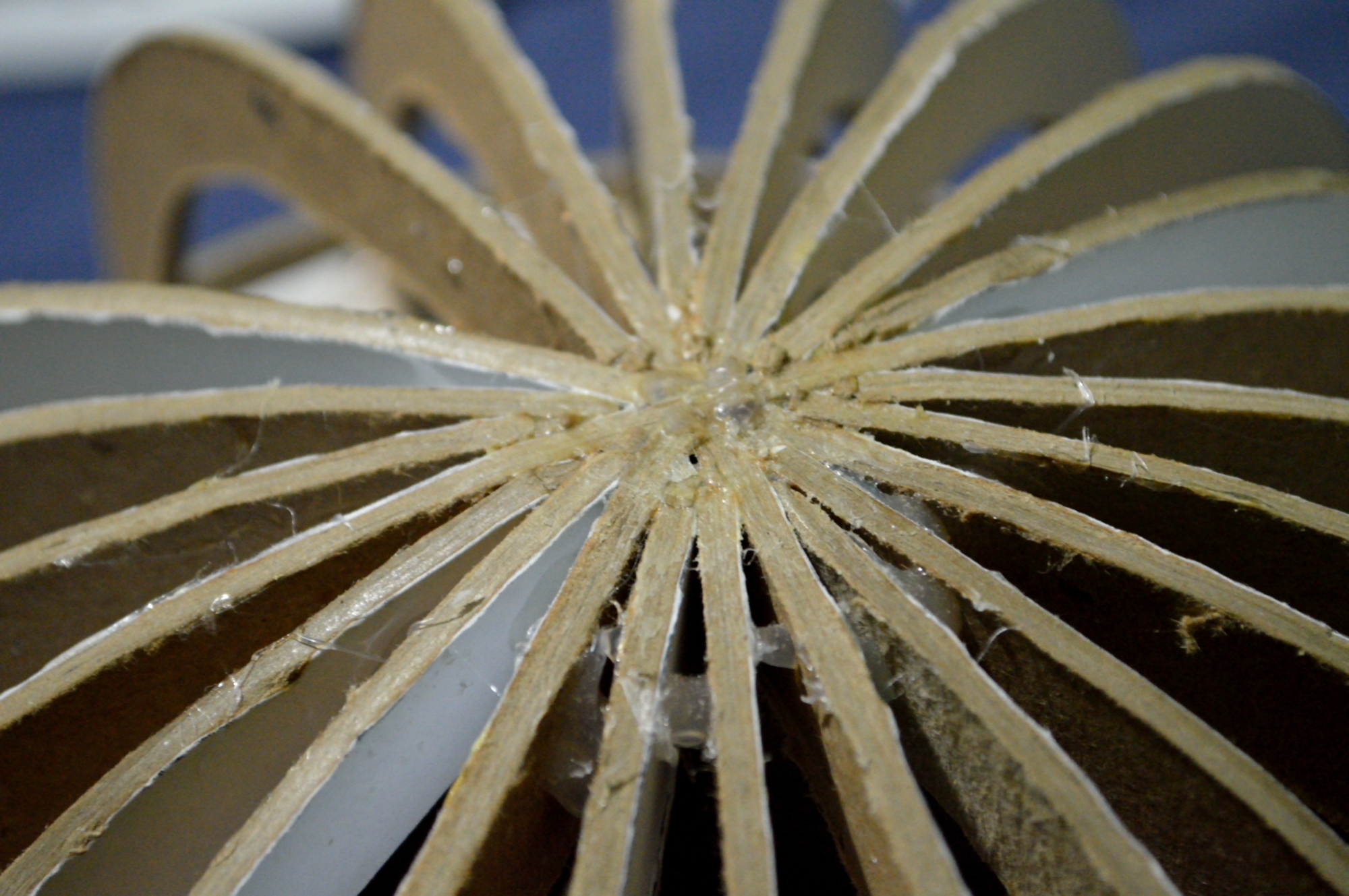

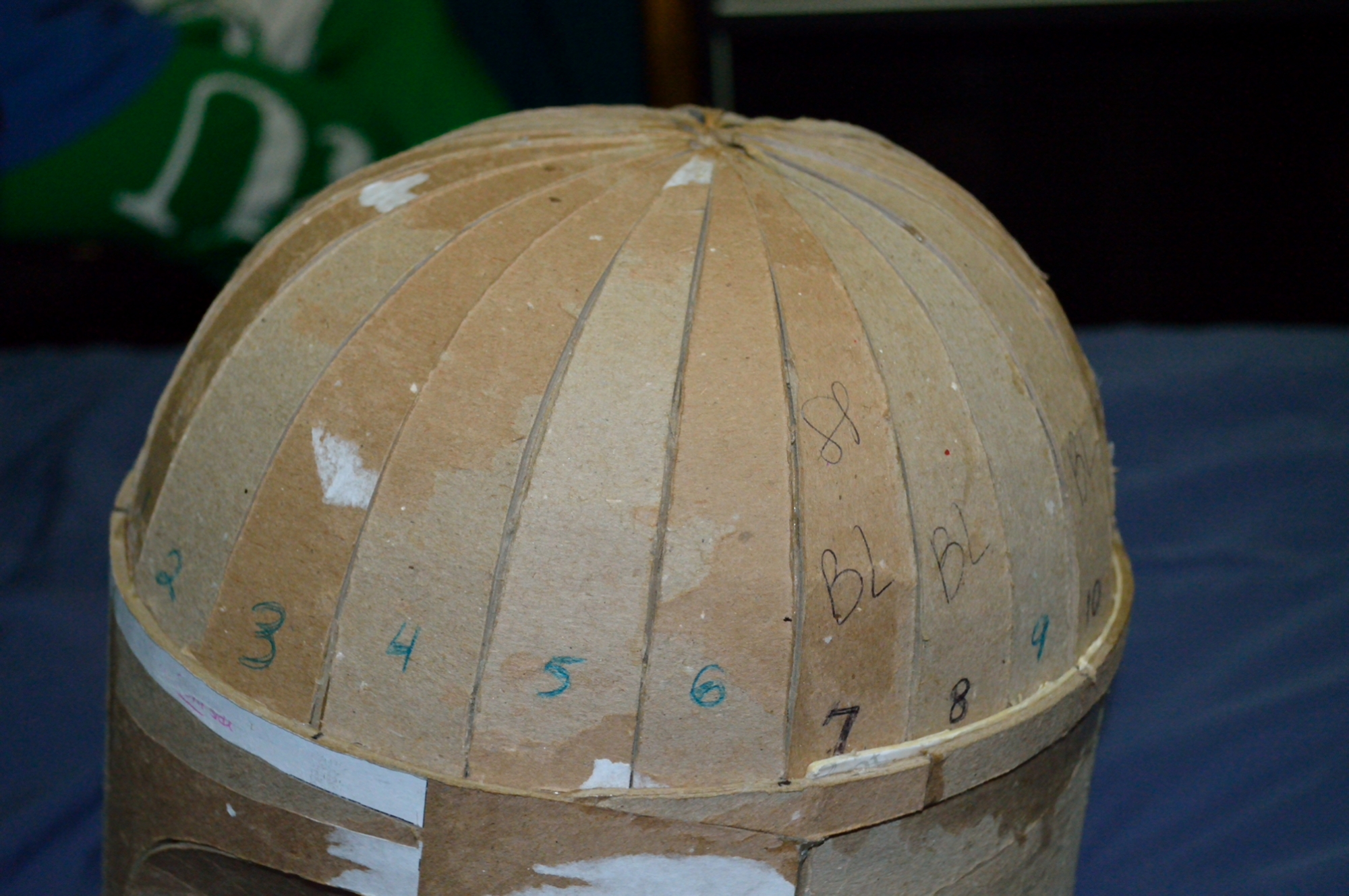

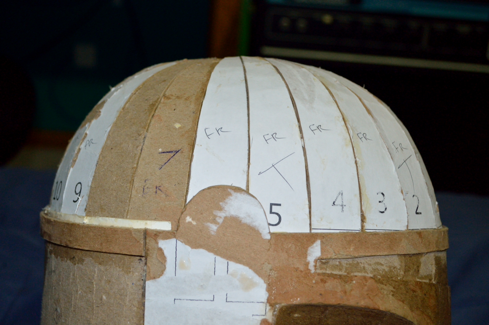

We worked on our helmets all day yesterday, and again all day today. Probably put a little over 10 hours of actual work-time into the dome. I can see now why I can't find any threads with people putting in all 12 support beams, it was intricate, frustrating, and time consuming. But it paid off big time, I could probably stand on top of my helmet it is so strong now, not that I would ever think of attempting such a feat =p
This is what they looked like with the supports put in:

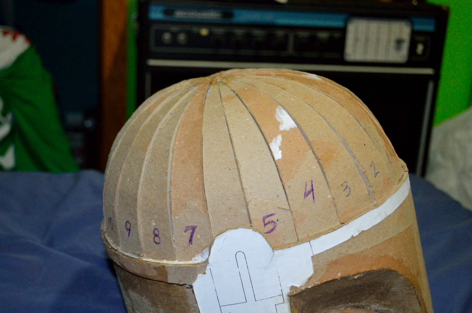

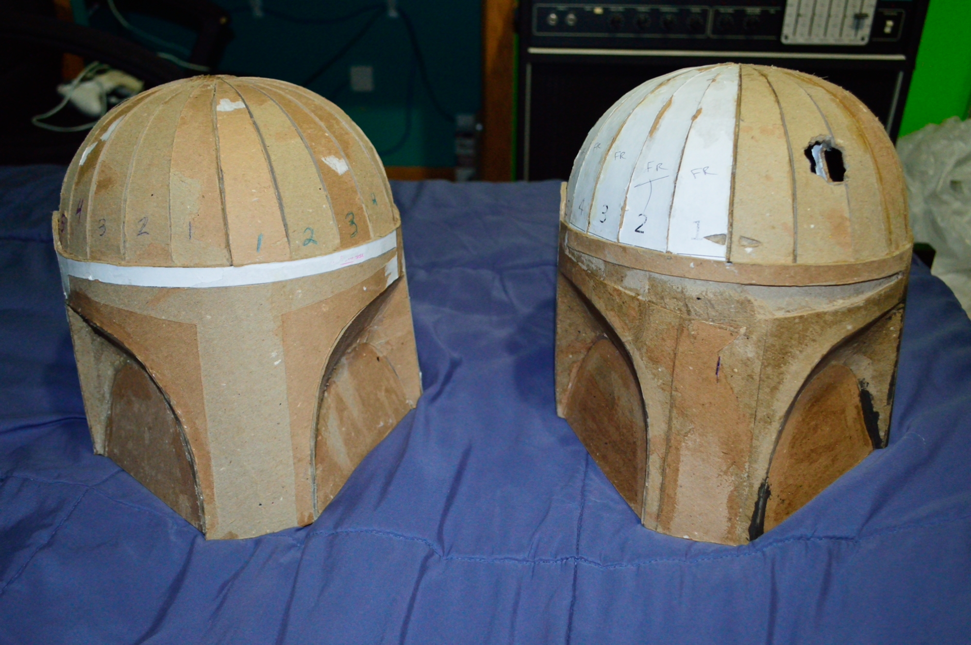

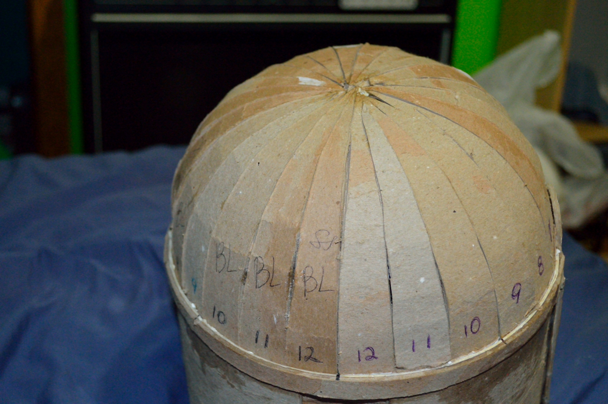

Progress..

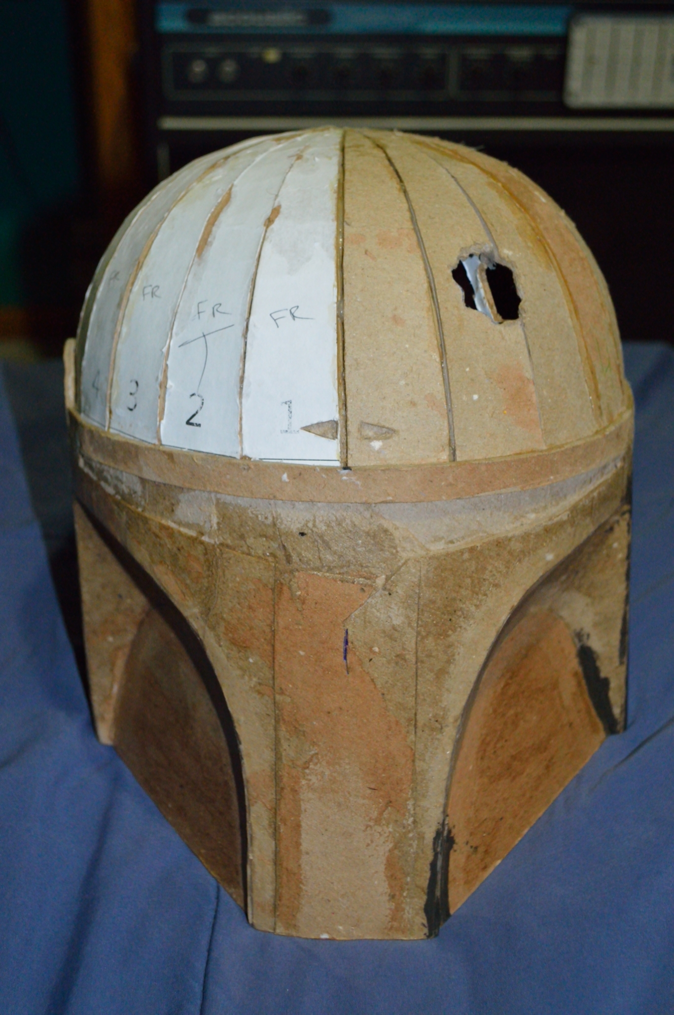

..and here are some pictures from tonight!!
Sara's Helmet -
My helmet -
Side by sides -
I'll keep updating when we start to get the ears/rangefinder going, but again I work the next few days so it may not be until the weekend. We are both getting really excited though!

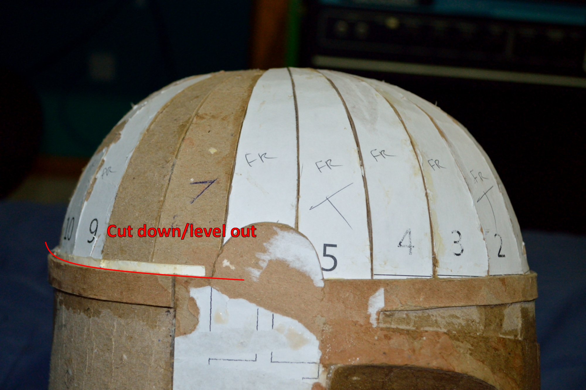

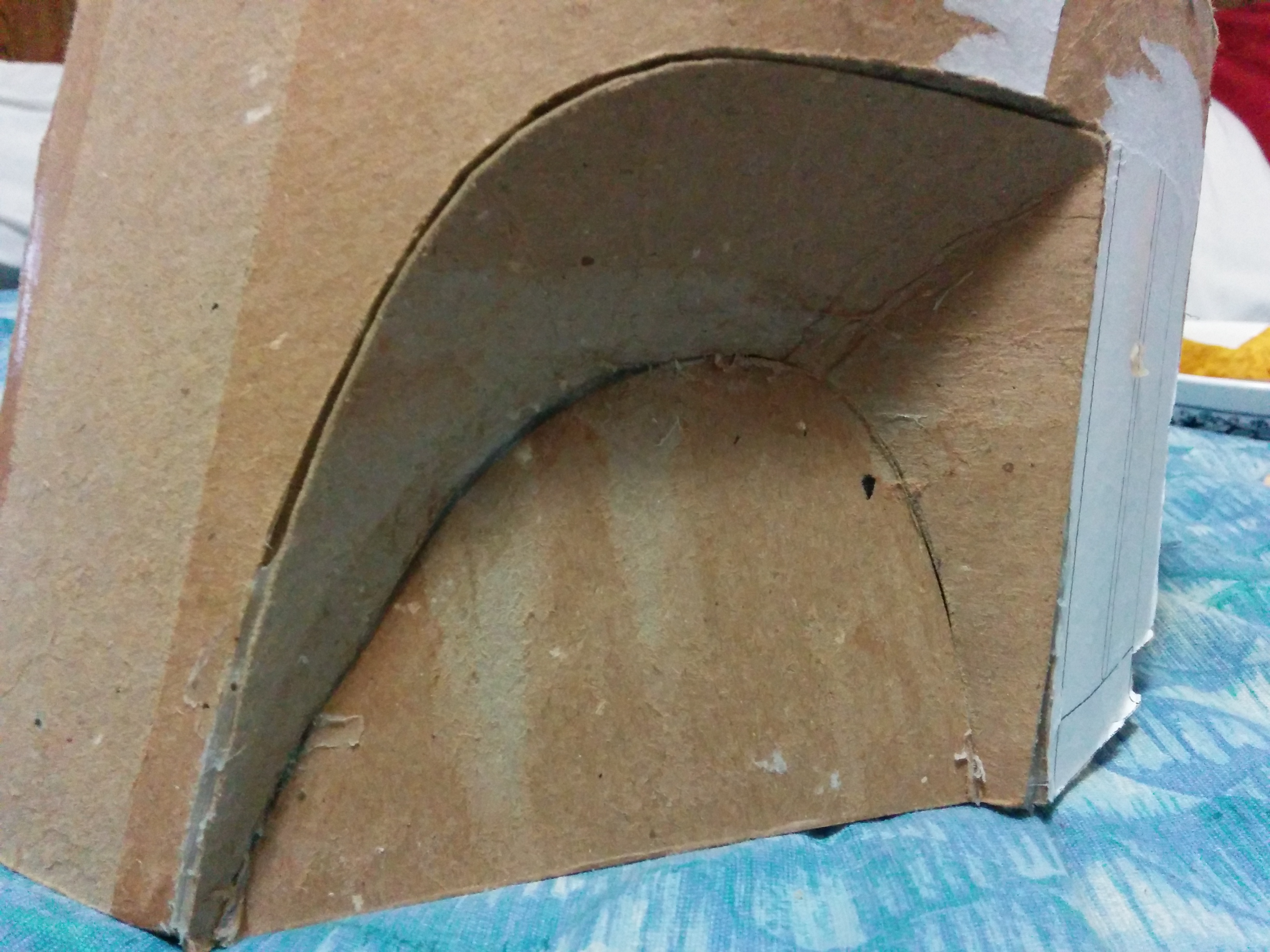

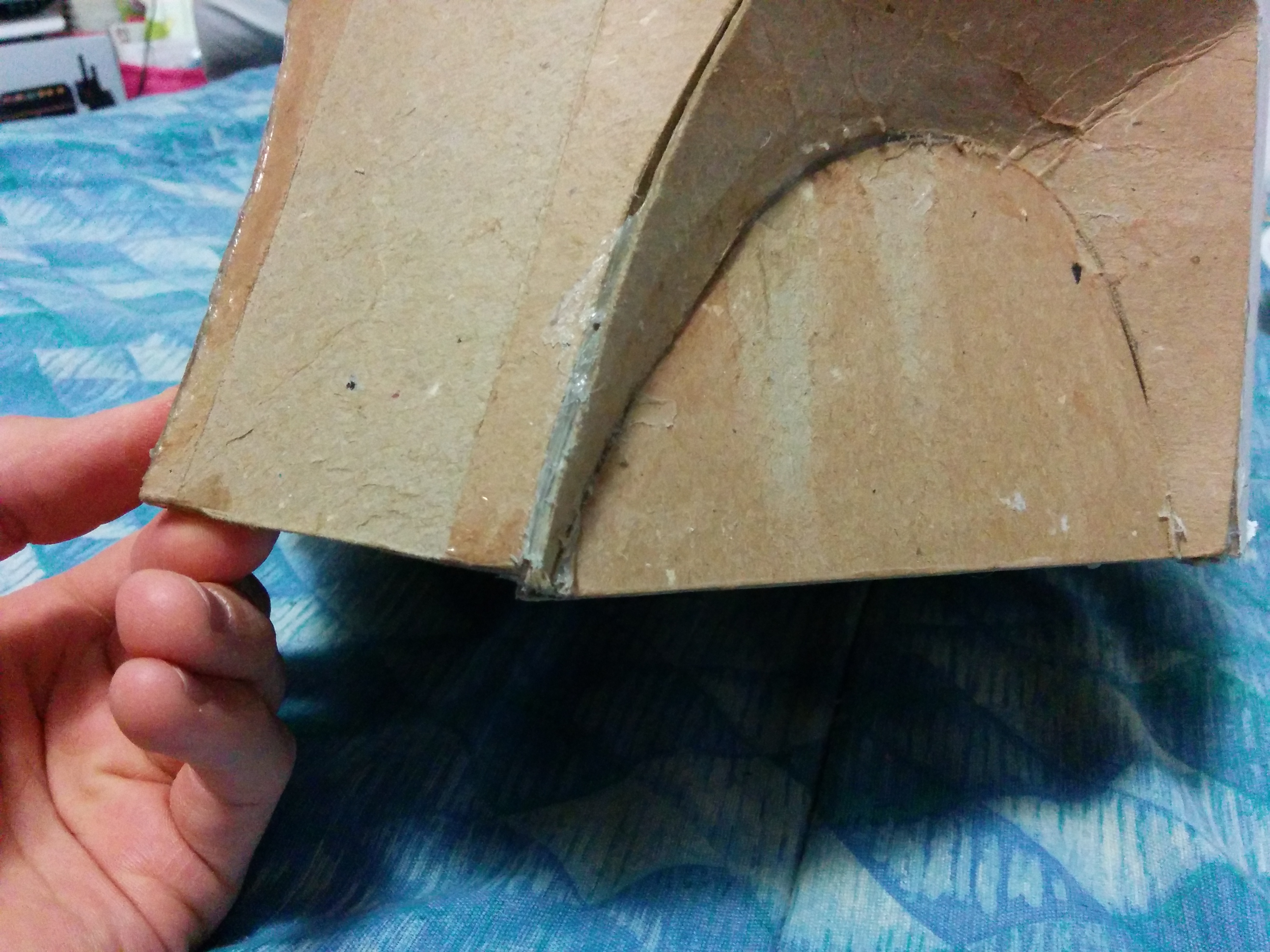

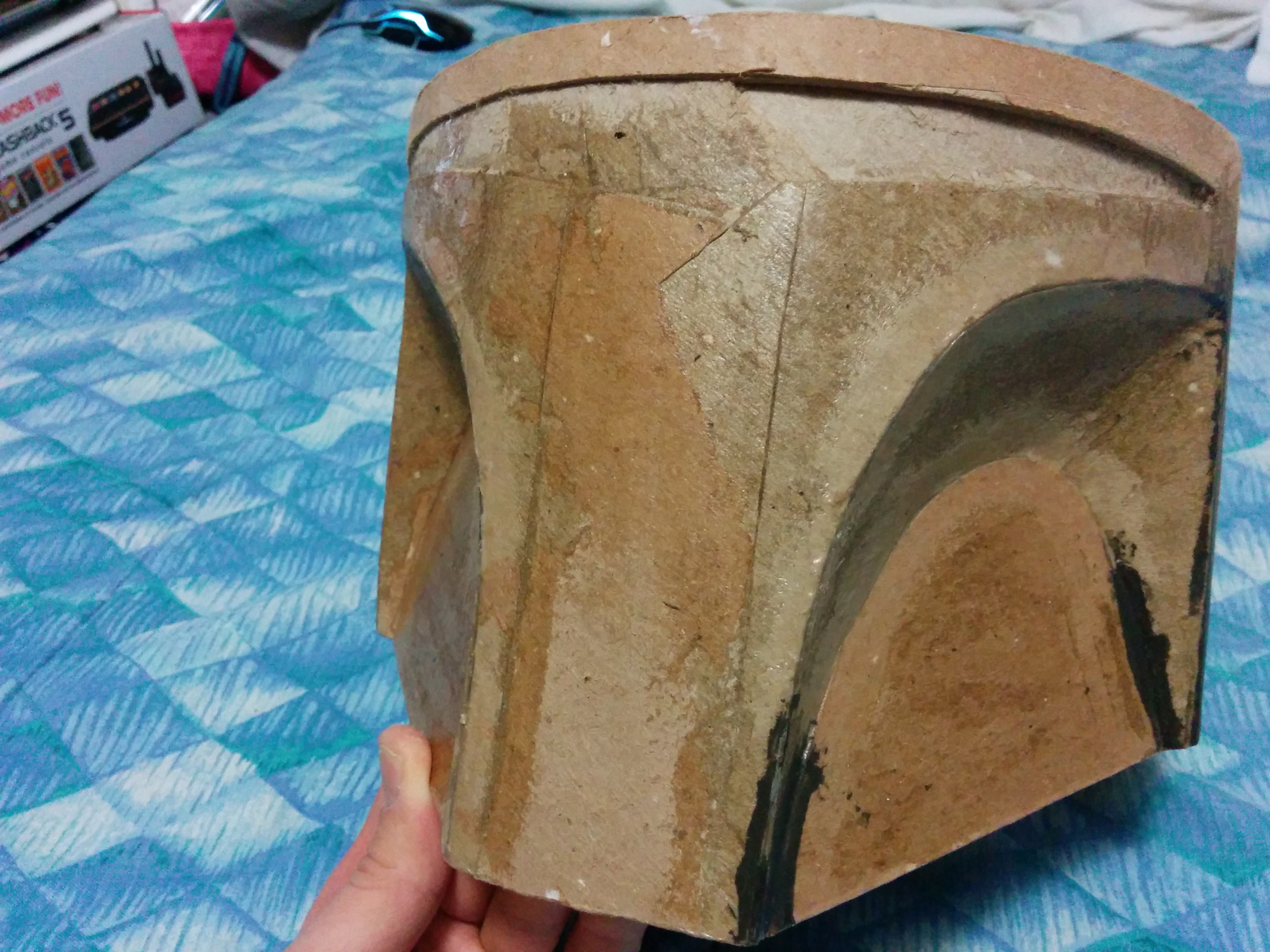

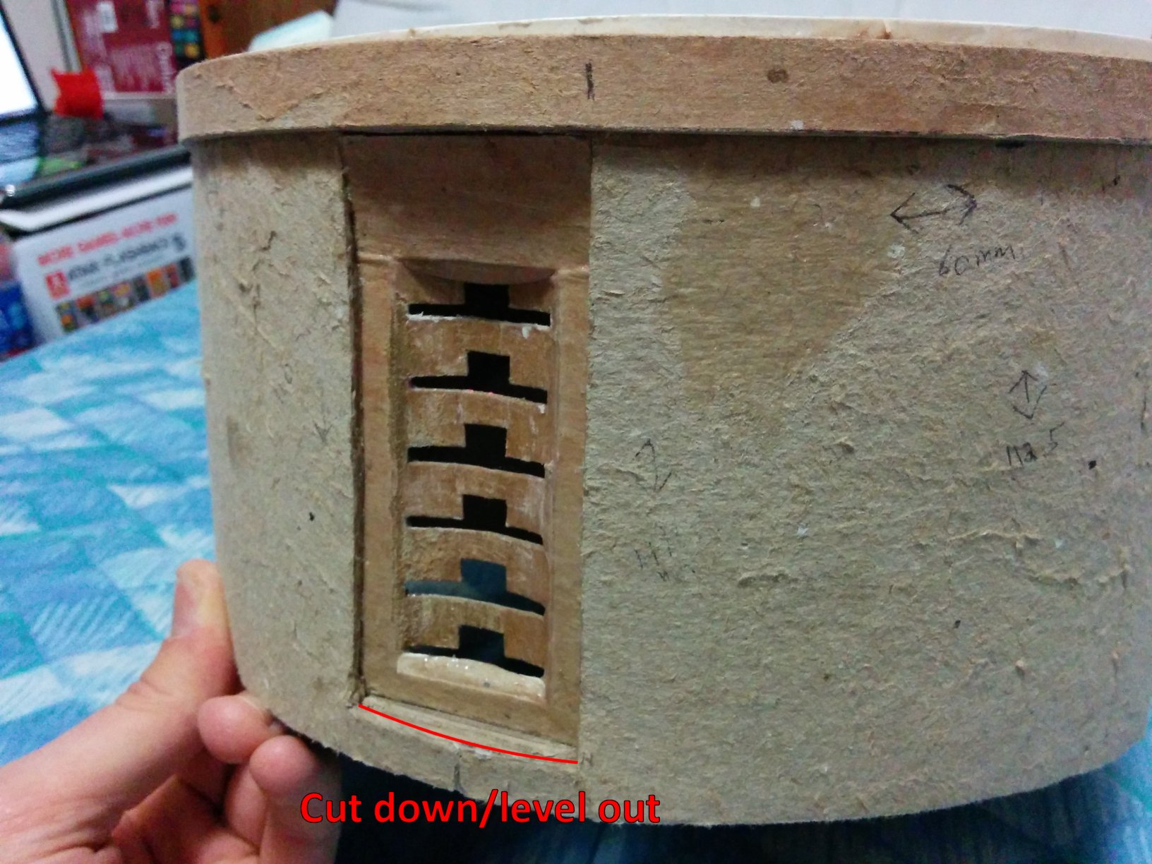

Oh my... Both helmets looks more than great! May I suggest to use a thinner cardboard for the dent, as this is a small part and once glued in place, it will be a sturdy part of the helmet. Also you can level the dome back strip and the rear keyhole lower part (only the pieces that sticks out on your build):
View attachment 86161 View attachment 86162
Thank you!! I'll level those out as soon as I get a chance =) Also, for the dent are you talking about the slices that are put into the hole? I could peel the cardboard in half to make it close to 1mm, do you think that would work better?
