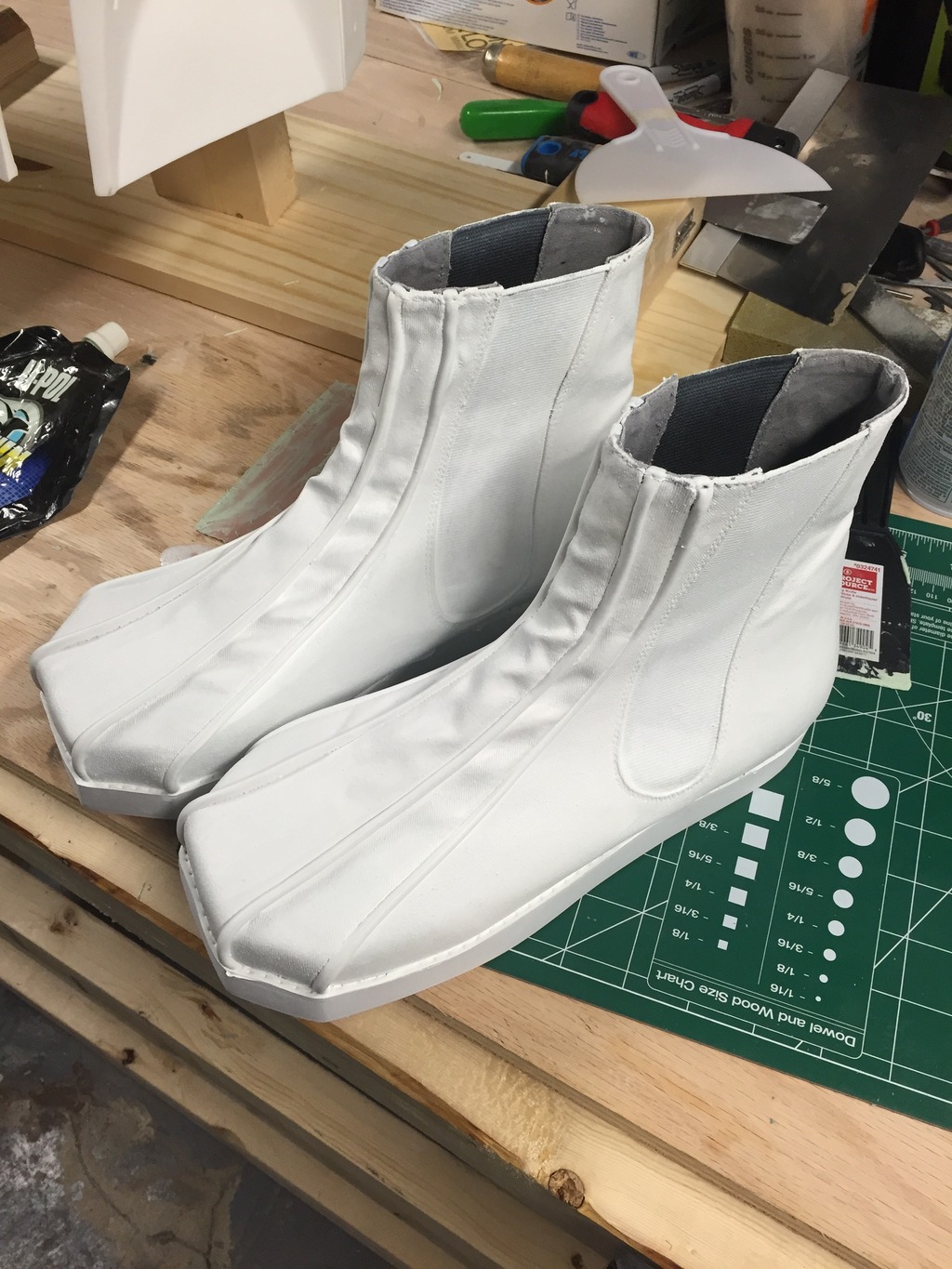

Been a bit distracted getting my replica Vektor pistols ready for sale but I am back at the Fett today. Should have the helmets ready for primer by the end of the day and the boots turned out pretty nice
They are MOW boots. First I used Kilz2 Latex primer. It was having a hard time covering the black elastic so I tried white Plasti Dip which worked pretty well.
I'd be worried about it cracking off the elastic, I have those boots also and you have to stretch them pretty good to get them on.
So is the whole boot plastic dipped now?
Lynn
It stretches with the paint and kinda closes itself again. Aside from covering the area with another piece of fabric it will just have to do. And I sprayed a light coat of Plasti Dip on the whole boot and it looks really nice. Just have to touch up a couple small spots where I had it taped up.

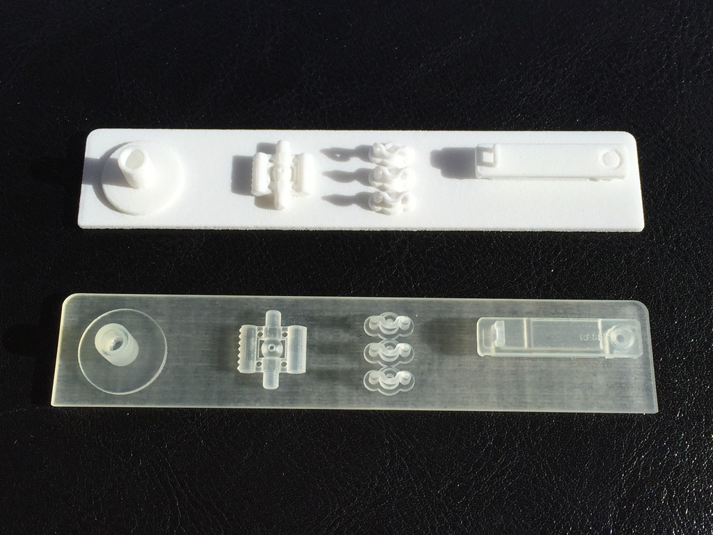

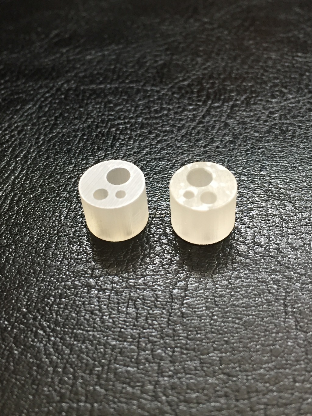

More sanding of the helmets this weekend. Also got a new 3D printed side plate for the Uzi. The white one is the basic material print and the clear one is the one I just got Frosted Extreme Detail. The details on the clear one are impressive for such a small piece. I also got 3D printed Borden connectors

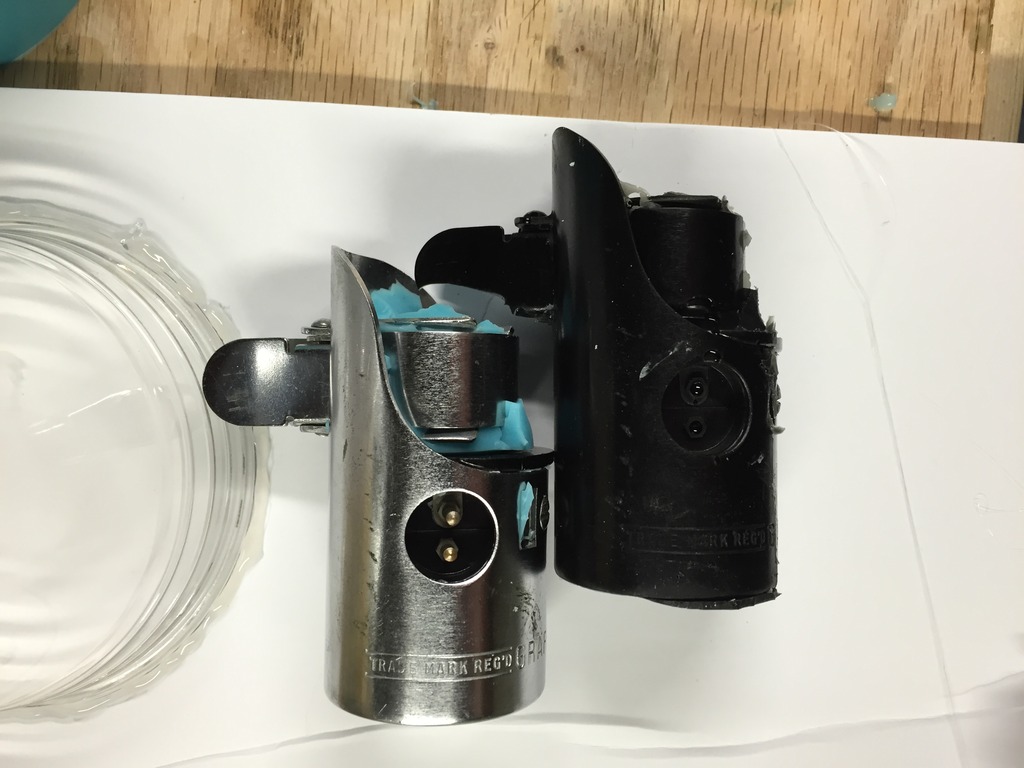

A big part of my build has been getting as many found parts as I can and learning how to cast stuff etc. I want to be able to make a complete sling gun and here is the start of it. Was pouring something else at the same time and learned that my pour hole on this mold is too small or needs a seperate vent. The detail is pretty amazing in what did come out.

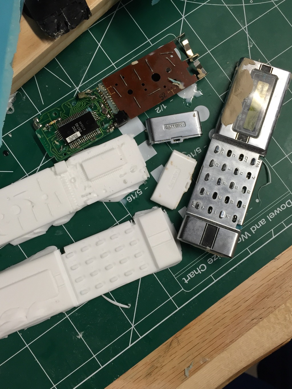

In addition to getting my towel earlier in the week , I tried to make a mold for the front Graflex part on the Uzi. I decided to try it with this stubby Graflex since it would waste less material. I made it a single piece mold which I knew may not work well given the complexity of the part. It isn't perfect but was a good practice run for the real Graflex which I think I will be able to recreate with a 2 piece mold.
