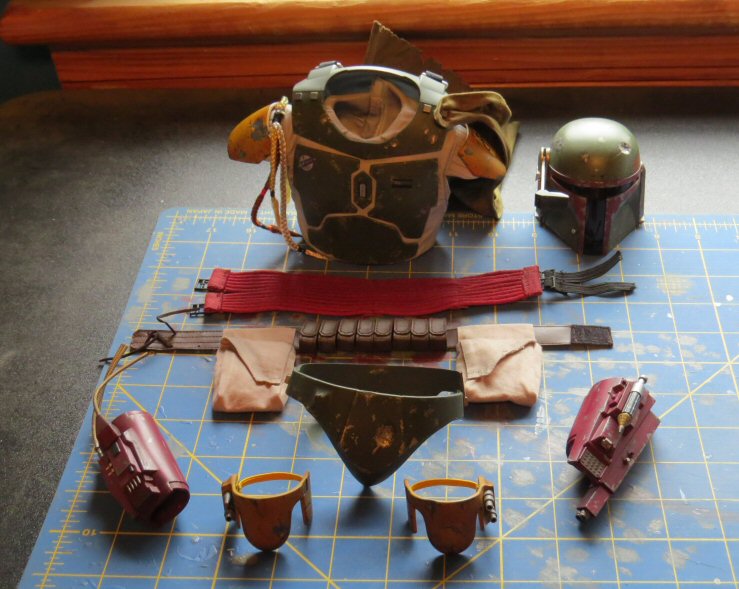

Here are all the major parts removed.

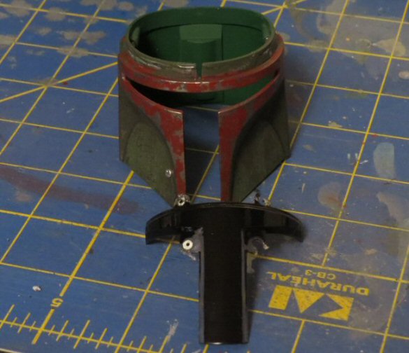

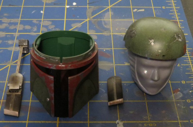

The helmet. . . ah, the helmet. It's quite a piece of engineering for an action figure. :)
The dome can be removed from the lower part. There's a rim that it fits on, with a bit of glue. With some
pressure from the inside, the dome pops off. The ears are also glued onto the sides. Some fiddling with
that slim screwdriver got them off fairly easily.
But the visor is actually a separate piece as well! There are four small pins inside the face of the helmet, with
a molded tab that slots over each pin. With a sharp sprue cutter and some finagling with the screwdriver, I got
the visor to come out. This will make painting so much easier!

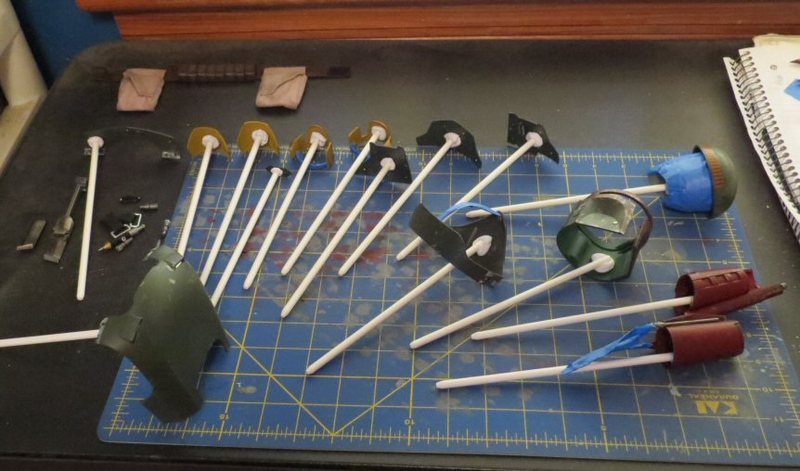

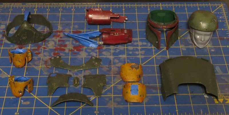

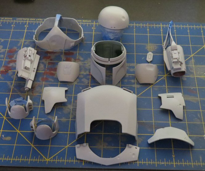

Here are all the "major" parts ready for painting. I'll be repainting some of the smaller parts as well, such as the knee darts
and the gauntlet rocket. But I won't be priming those.
To protect the markings on the chest and shoulder, I cut tiny strips of masking tape to protect them. I have a circle
cutting template, and a 3/8-inch circle covered the chest emblem nicely. I'll just retouch the parts that extend outside
the circle later. On the shoulder, it's hard to see here, but the "horns" of the Mythosaur skull that extend beyond the
white rectangle are protected with some masking fluid.
Oh, I also discovered that the two small black "windows" for the chest readout are also a separate piece! It's glued on
the inside of the left chest plate, so off it came. Again, making painting easier.
The cod/kidney combo and the knees have masking tape applied to cover the elastic. I taped off the 3 hoses on the right gaunt, too.
I got some long paper baking sticks and some "craft tack" to make painting sticks for easier handling of the small parts.
Primed! I used Tamiya fine surface primer in gray. This stuff sprays like silk! It's by far the best, smoothest primer
I've ever used. It's available in gray or white. A little pricier than Rusto or Krylon primer, but it's outstanding.
So that's it, all finished! I'll reassemble the figure later. No. . . wait, I think I missed a few steps. :lol:
When the primer is fully cured I'll start laying down the base colors.
Merry Christmas, TDH! :)
Hope your holiday is bounty-ful!

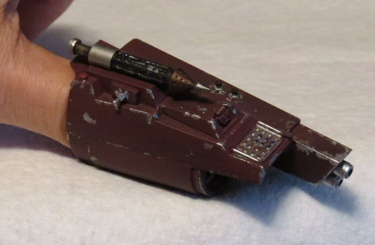

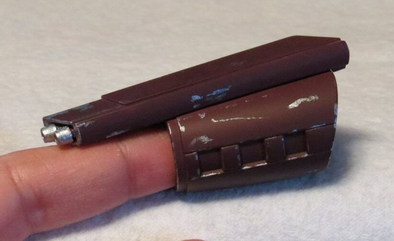

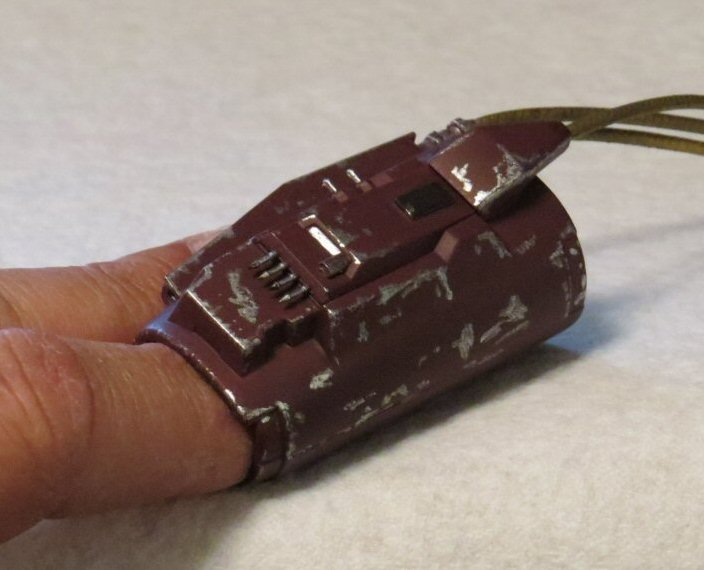

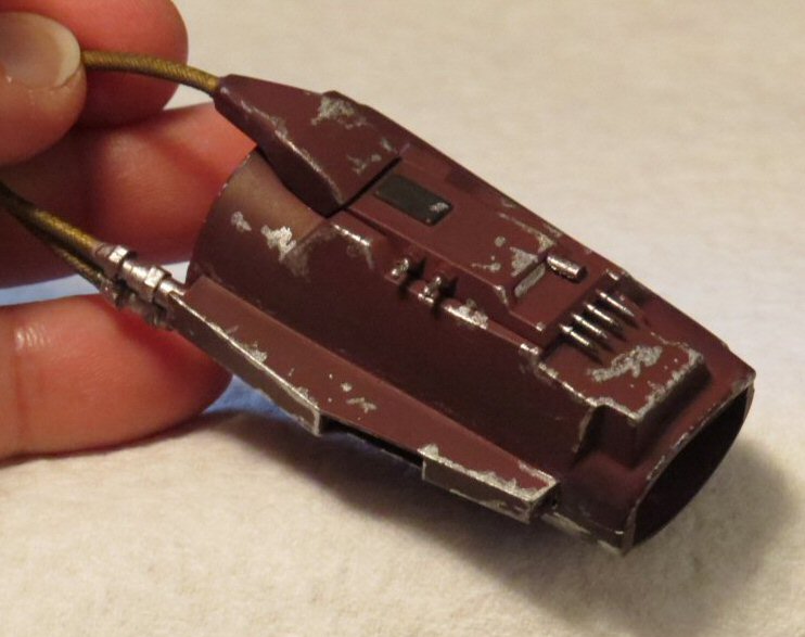

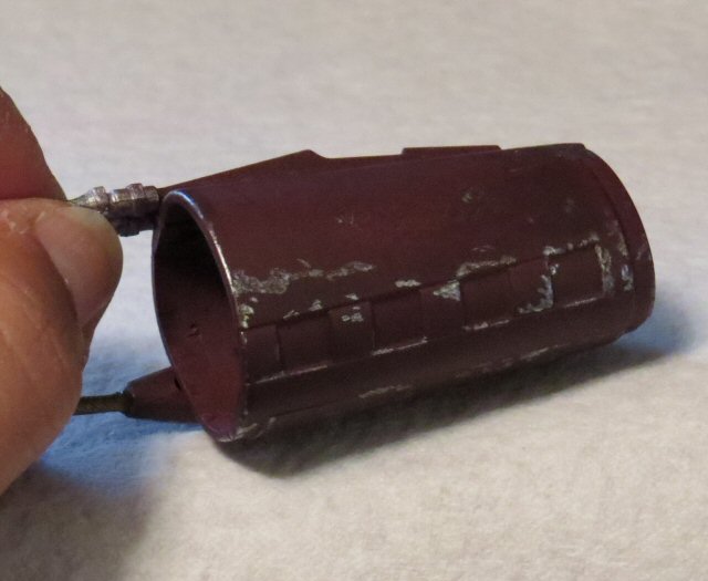

What could be better on a holiday than doing some tiny detail painting! I completed the first piece on the
Hot Toys repaint--the right gauntlet. I began by airbrushing a base coat of Polly Scale Wisconsin Central
Maroon. When that was dry I did some "spot washing" with some very thinned down Tamiya flat black.
The detailing was done using a terrific acrylic silver I was fortunate to find in some old stock at a local
hobby shop: Polly Scale Piston Silver. It mimics the characteristics of the enamel Bright Silver very well.

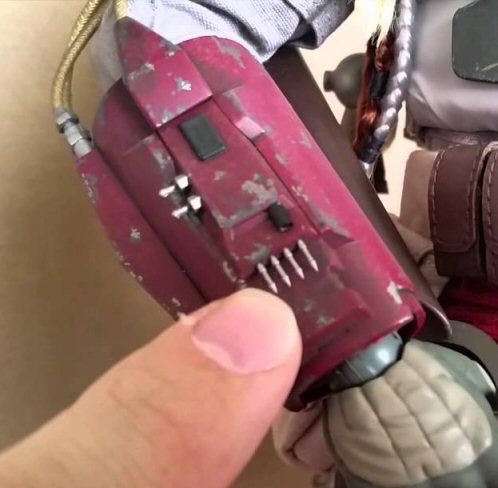

For comparison purposes, here's a stock shot that I found on the web.
Here's the repainted gauntlet. I used some MoM photos for reference.
A lower angle.
A couple of shots of the opposite side.
This was a lot of fun! :) I'll be working on the left gaunt next. Hope everyone has an excellent Christmas weekend!

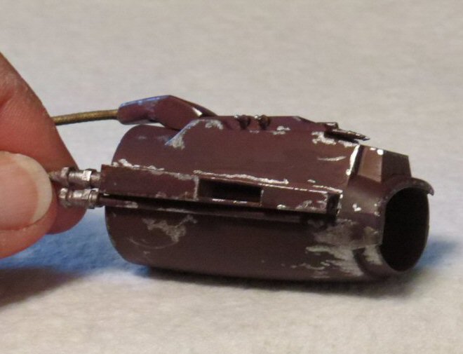

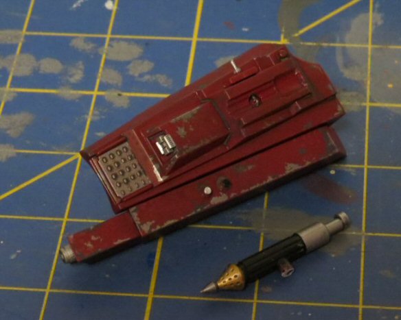

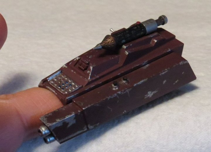

Here's the latest Hot Toys progress. I finished up the left gauntlet. A few views are below.
As you can see, the rocket has been reinstalled--but not before some of its own alterations. The nose piece came from
Hot Toys done in a brassy gold color. I repainted it with some copper and gave it a wash with flat black. I also washed
the narrower part of the silver section at the rear. Some small silver chips on the black portions finished it off. It's just
pressed into place. No glue required.
I used a brighter red to paint the "lamp" at the rear of this side of the gauntlet. I also painted the red and blue keys
on the MQ-1 pad at the front. It may not show up here, as they are TINY!

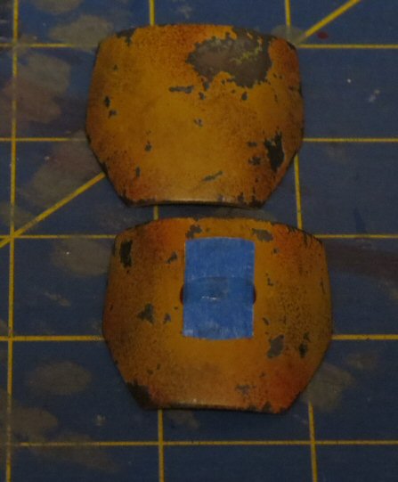

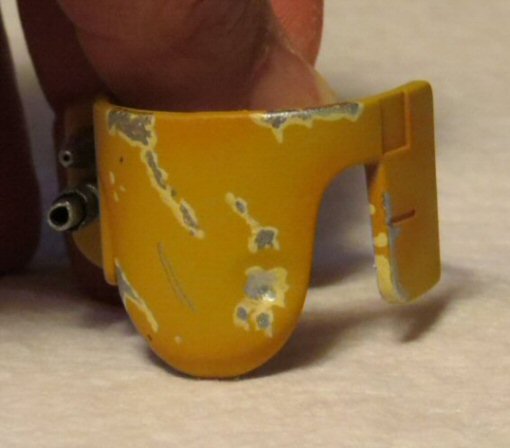

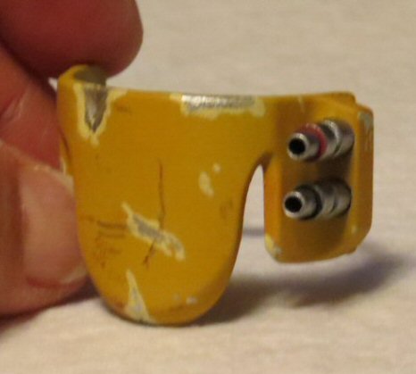

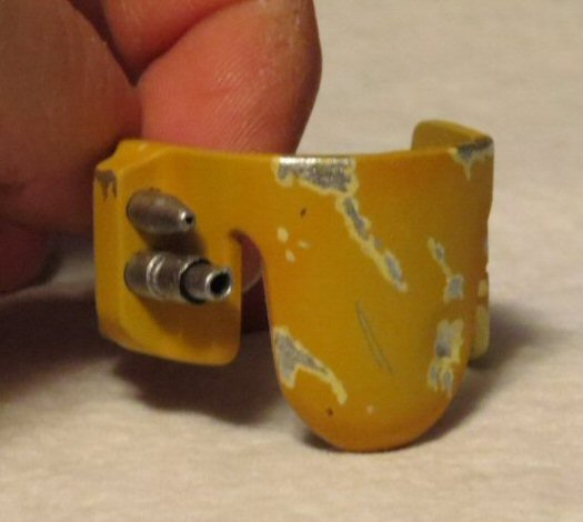

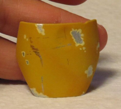

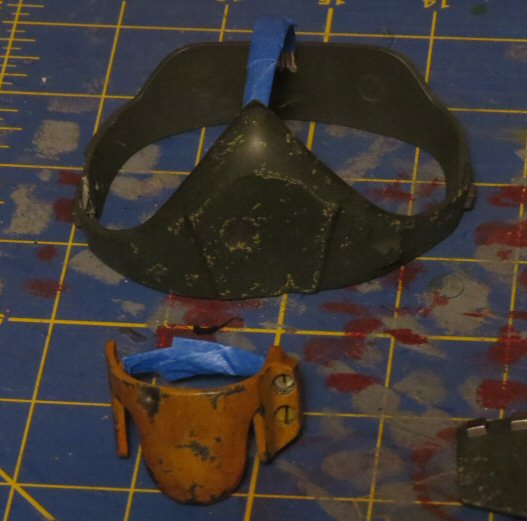

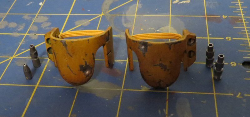

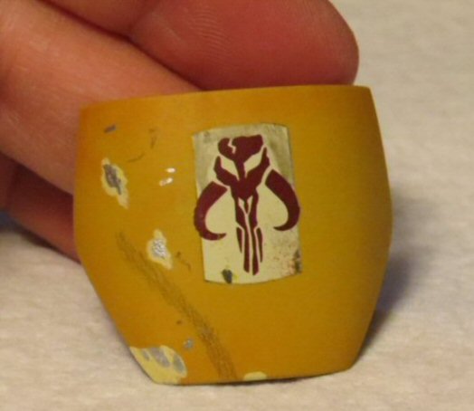

I moved on to the shoulder bells and knee armor next. These were given a base coat with UP Armour Yellow, then the
contrasting shades were added using pastel powders in a couple of different shades. Here's the right shoulder.
The small smudges on the shoulders and knees were added with very sharp umber and dark red colored pencils.

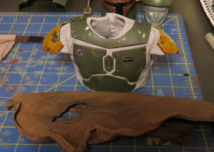

Here's the left shoulder. It may look like it's only half complete. That's because in all of my dozens of reference
photos, I can't find a single one that shows the right side of this piece! It's always covered by the cape. If anyone
has any decent shots of this shoulder bell, I'd really appreciate seeing them!
The darker smudges on the logo were left over from the factory paint app. Trying to figure out the best way to
"erase" them without having to totally repaint the white portions. . .

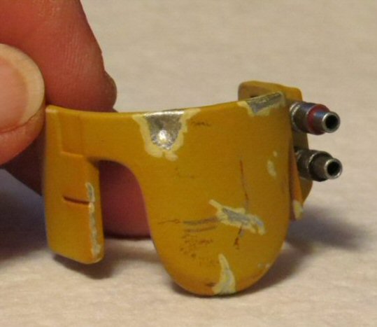

The knees are below. As with the shoulders, all the pale yellow and silver damage was done by hand using an 18/0 brush.
Working at 1/4 scale is making me realize that I probably need a new pair of glasses. :lol:
Note that I also painted the red and black rings on the knee dart launchers.

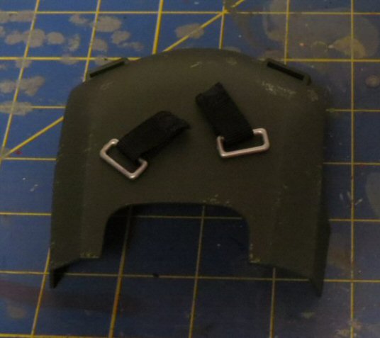

Next up is the green armor. I've already laid down a base coat of a slightly lighter green. I'll be airbrushing the US Medium Green
in a similar fashion to the way I do the rear panels on my ESB helmets. First a medium coat, then darkening certain areas as per
the reference pics. More to come!
