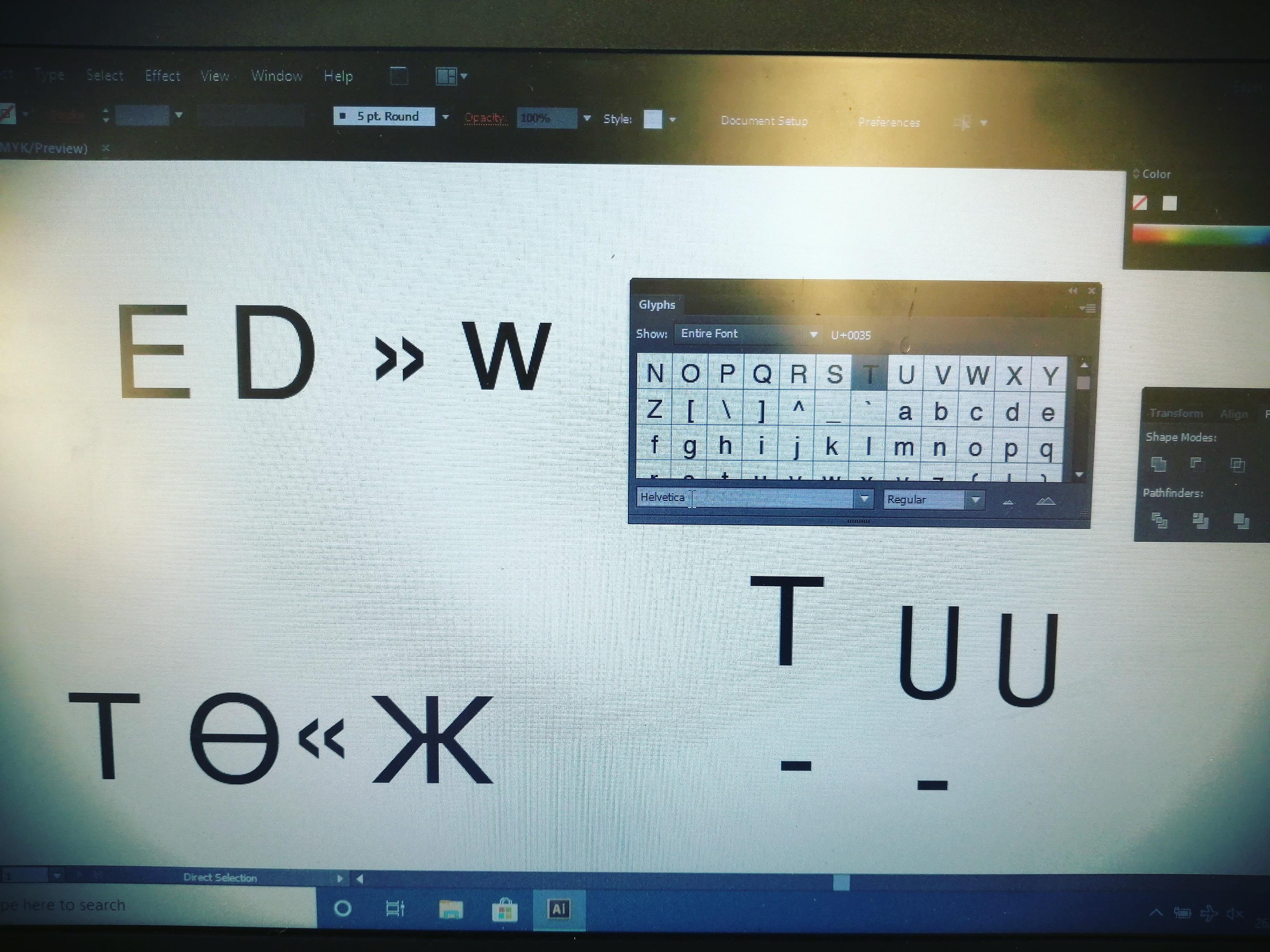

Using Adobe Illustrator I typed in a capital D , E , W , T . U's 2 minus symbols and a couple of Glyphs (One looks like 2 K's joined together) . The more I looked at this glypth tho the more I thought although it looked right it wasn't and the one in the image looked like a capital K back to back ,

I reversed the E and trimmed the horizontal parts and joined it together to the D , and did the same with the W's and the K's , turned a U 180° turned the chevrons round and cut the T's down and rotated them and ended up with this.
