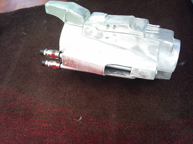

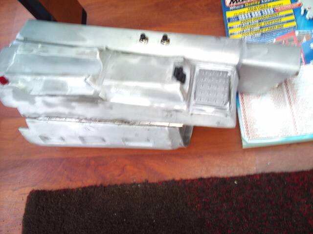

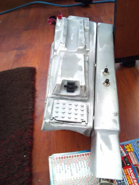

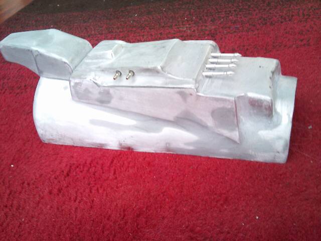

Ok have been a bit pre occupied recently so have put a bit more effort in to near completion of gauntlets all bar painting
Cheers dmount , well gaunts fininished bar painting ! Next ally bucket or ally jetpack :wacko Come on guys what do you think ?
The gauntlets look great, I mean really awesome!. I see your missing part, not a hard fix though:D How have you connected the parts together? have you used epoxy stick, or soldered/weld seams?
Cheers fettwho, nearly all of the above :lol:. I used bonding sealer for the main and aruldite steel epoxy for more fiddly bits followed by finishing with alu filler . My nephew has just given me a mig welder so if i do another set i shall weld the majority . The sealer was the best non weld option as i found the epoxy showed signs of cracking under stress . Can i say Wizards templates are excellent if you're looking to make you own

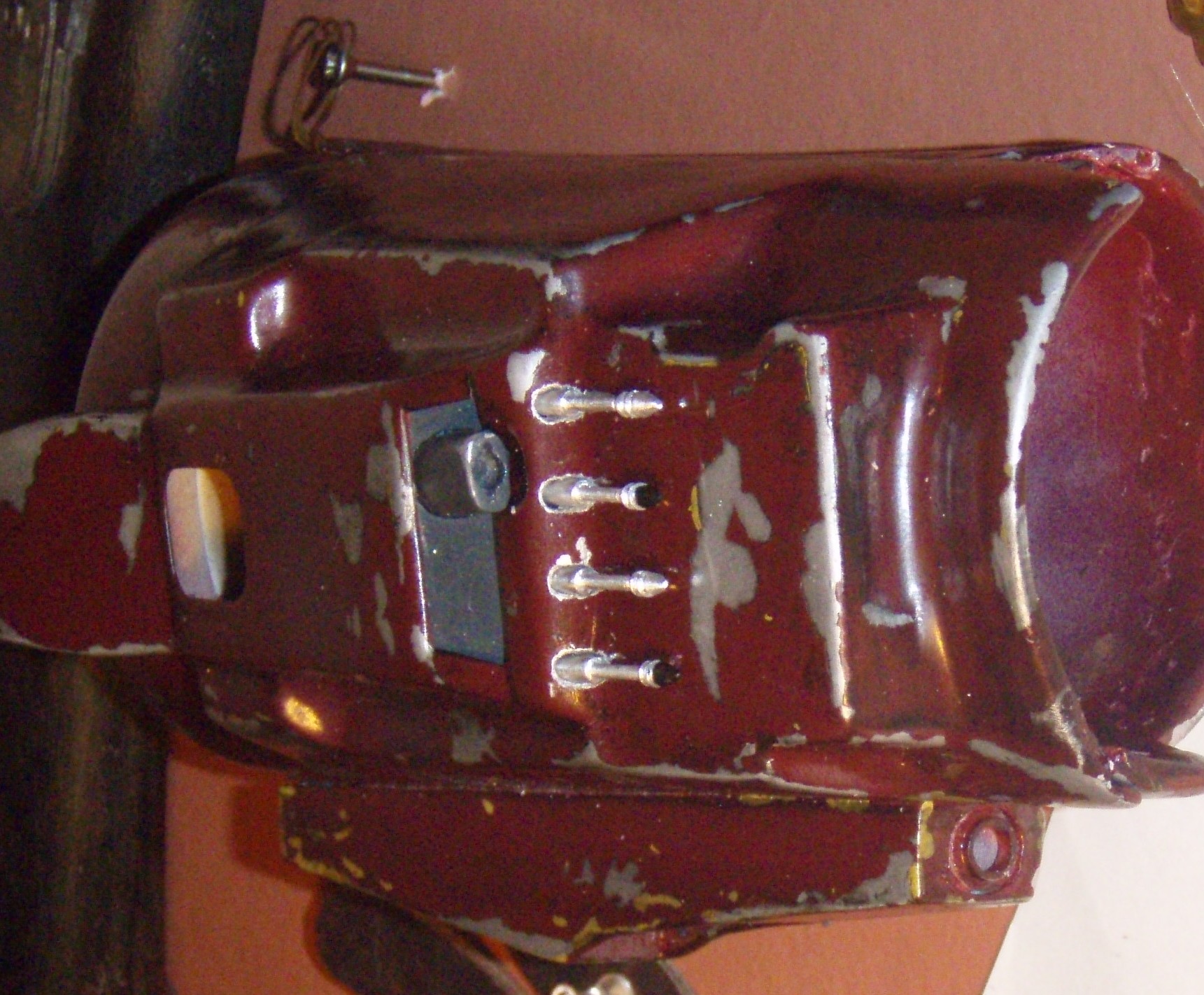

The part your missing I made from a craft knife handle ( the round aluminum ones ). I crushed and filed the ends and drilled the center. also filed each side to even it up, and it really looks the part.
Photo added to show, sorry not very close shot, will dig them out and take better photo if needed. ( unless you manage to source one:D )
Its an old Rufkin set that I have modified.... I really should start a thread for them...

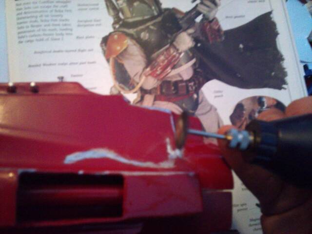

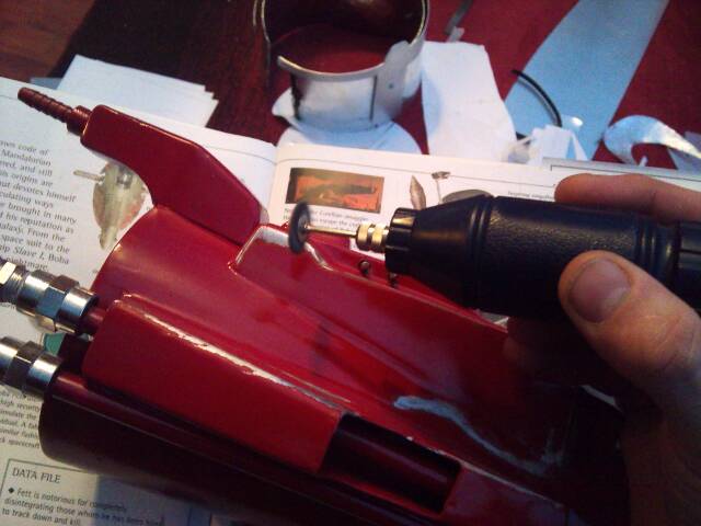

Gaunts in paint , going about it a little differently as fully painted first then adding damage . Being ally thought it will give the real feel .
