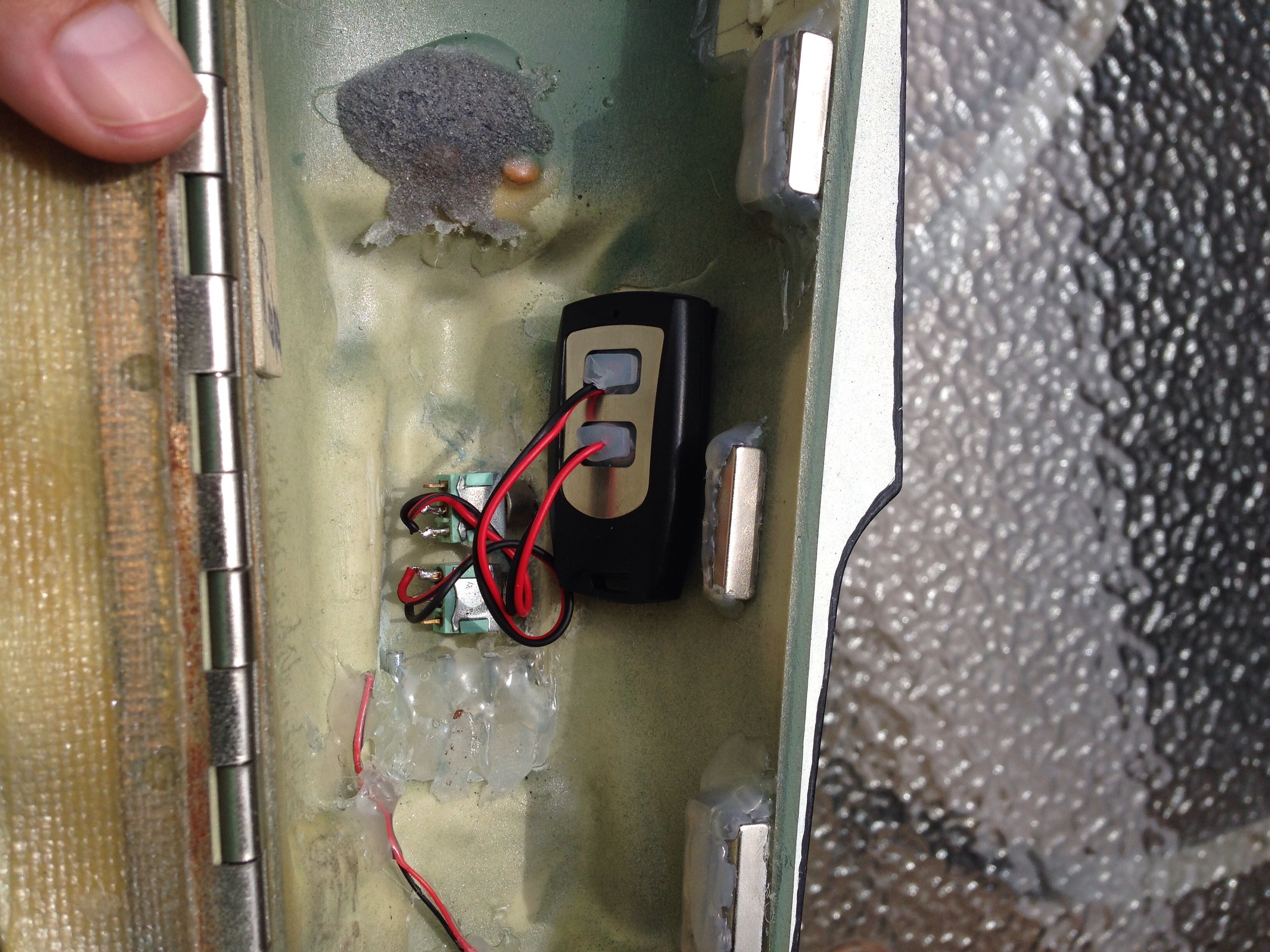

No worries. I'm sure I will have one when your ready. The switches will have shrink tubing on them in the final version, but since this is still the mock up I didn't worry about it.

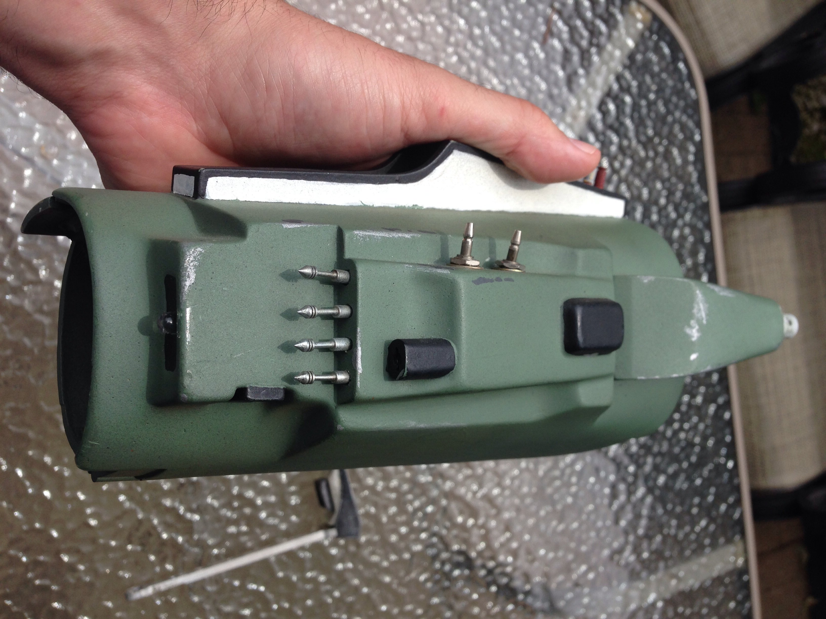

Is it possible to get the buttons for the left gauntlet as well just in case I need to move it to the left side? Those two black ones? I can pay you the extra for them.
Can you post a pic of the buttons you are talking about DP? I'm not sure I now which ones you mean.
