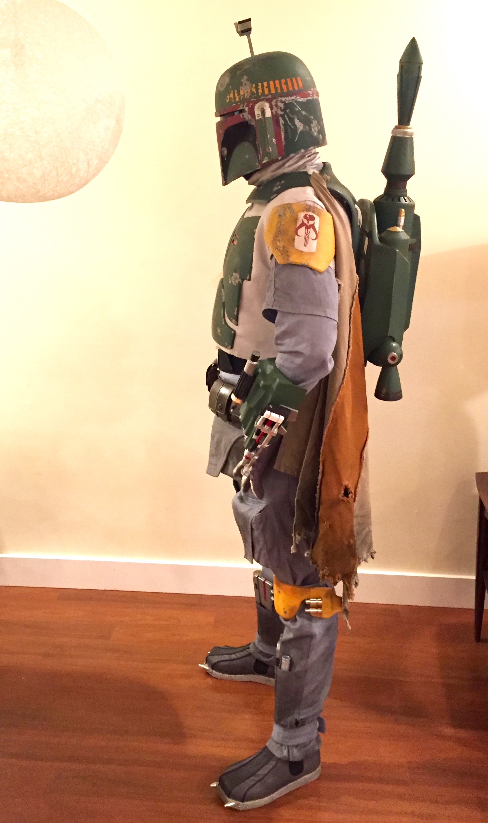

So, after re-attaching the gauntlet rocket, I did a fitting tonight.
I still need to attach the cables/cords to the back of the flamethrower and the gauntlet, but that's the last item on my to-do list before the photo shoot for my 501st submission pics.

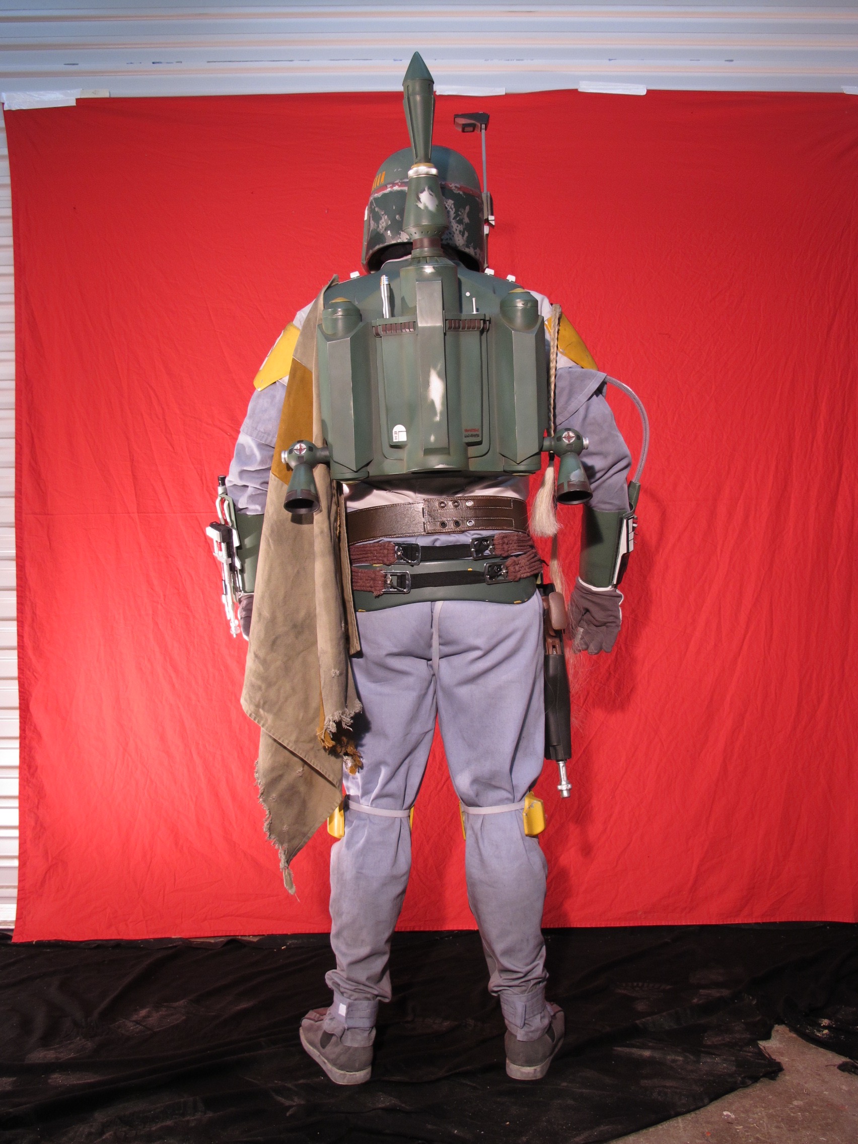

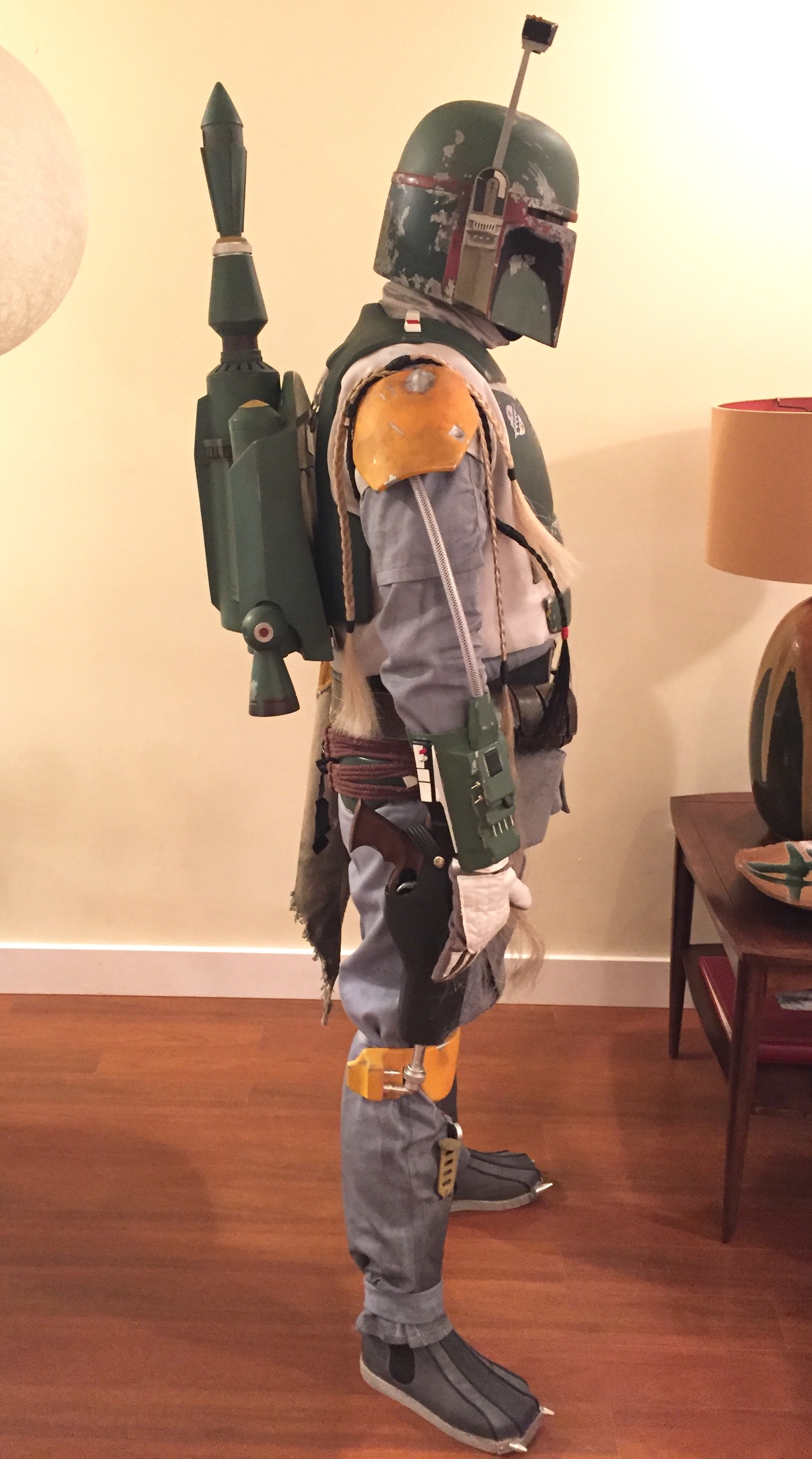

So, here are the pics from tonight. I tried adjust them a bit for the lighting, but you can see how everything fits and goes together.
Photo 2015-11-09, 6 51 33 PM.jpgPhoto 2015-11-09, 6 52 01 PM.jpgPhoto 2015-11-09, 6 52 20 PM.jpgPhoto 2015-11-09, 6 52 42 PM.jpgPhoto 2015-11-09, 6 53 07 PM.jpg

What do you think? What do i need to improve/tweak/change to get certified (or beyond)? What should I adjust? Let me know. Thanks
looking good dude :-)
only things i'd say to adjust...
-dirty up the flight suit some more, weather the sleeves and have the back match the front and hit those ankle straps as well.
-weather the vest a just a bit, seems pretty new looking
-dirty up the soles of the boots and spikes a bit.
-weather the thong and knee armor straps, (left knee strap not as much as the other two straps)
-heat mold the knee armor to fit your knees a bit better.
-bring your jetpack up an inch or two, a little too much white strapping showing from the back
-tuck the gauntlet hose into the short sleeve of the flight suit, not just under the armor.
-looks like that right pocket is a bit stuffed under the ammo belt. they should sit at the same length
-your snap pockets on the ammo belt are out of sequence. the set of pockets on your left, the first pocket should have the snap. also, that same side should have the 4 pouches and 3 on the other.
-on the back of the ammo belt, there should only be 2 grommets for ESB rather than 6. not sure how strict your GML will be but the CRL calls for only 2 on the back.
-try to set the cape so it falls seam-side in so that the sewn together fabrics don't look so, sewn together [emoji16][emoji16][emoji16]
honestly i think you did a great job. feels good doesn't it? just a couple easy adjustments and you shouldn't have any issues. good luck bro!

Nicely done!!!
I agree with Jeremy's suggestions, but I think you're good for your photos this weekend. There will always be little things to tweak here and there. All the best with your submission!

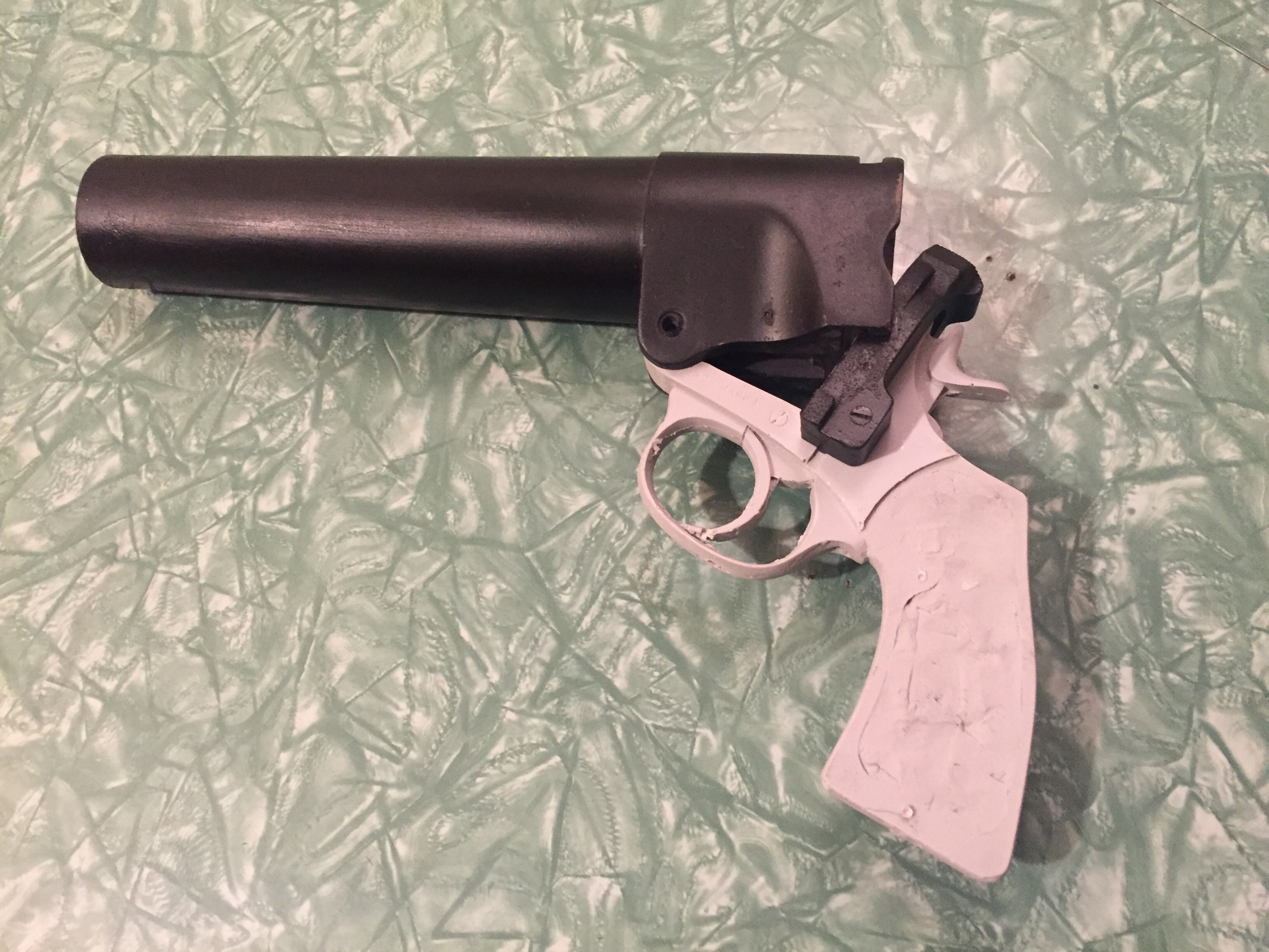

I'm much overdue on an update to this thread. I've been working on my MLS EE-3 and I'm almost done, so I wanted to share my progress to date.
I had first bought the kit about a year ago. I was slowly working on it and making some progress.
I completed the stock and had painted a number of the other pieces.
It was about then that I decided that I wanted to add lights and sound. I took the electronics out of a Hasbro ROTJ EE-3 that I had repainted and was using temporarily.
This is what it looks like extracted from the toy blaster.

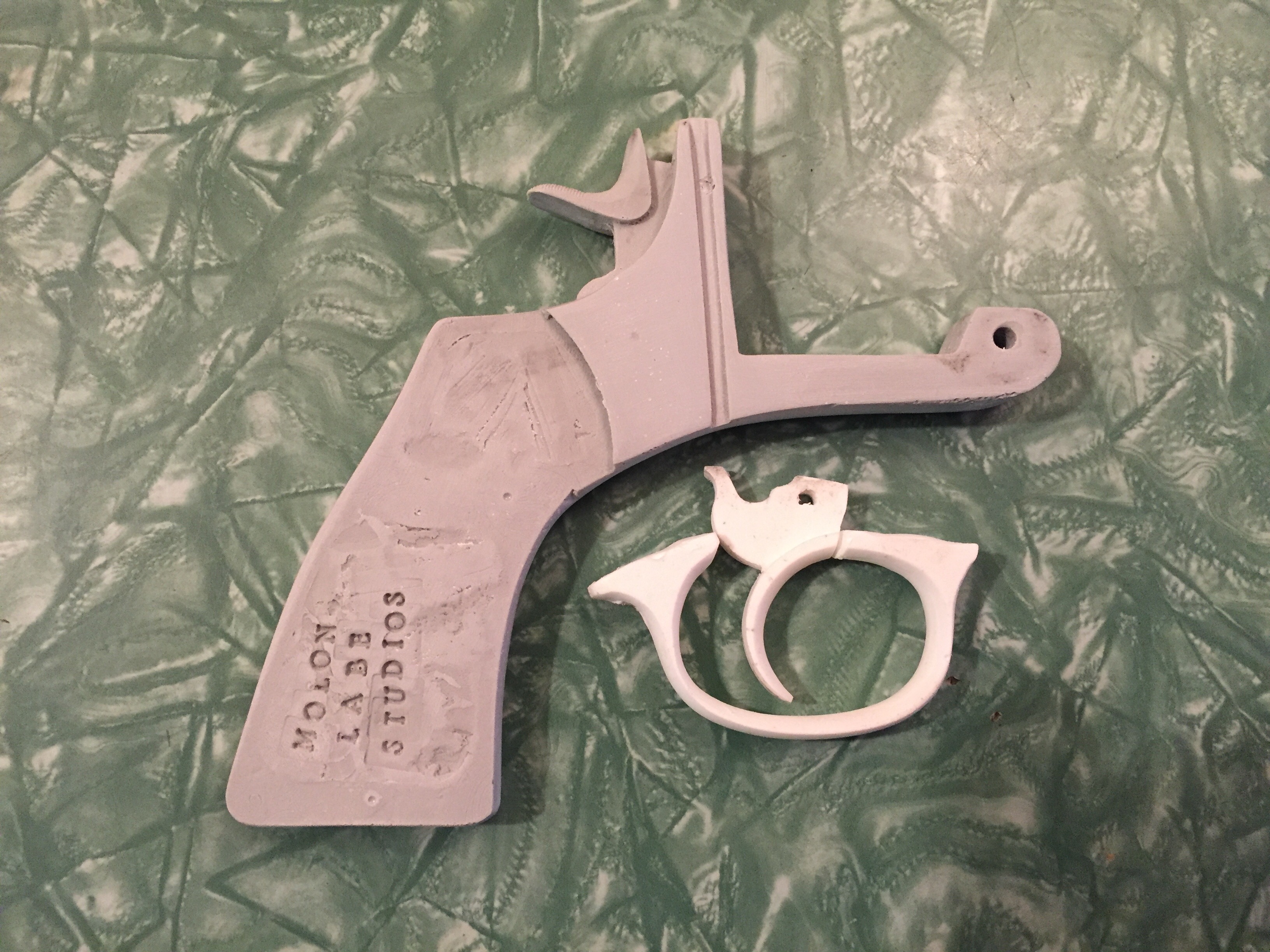

I knew i wanted my blaster to open like the flare gun and was trying to sort out how I was going make that work, when this happened. Doh.
This actually worked out for the best because when i ordered a replacement part, Matt included a separate trigger and trigger guard from an older cast.

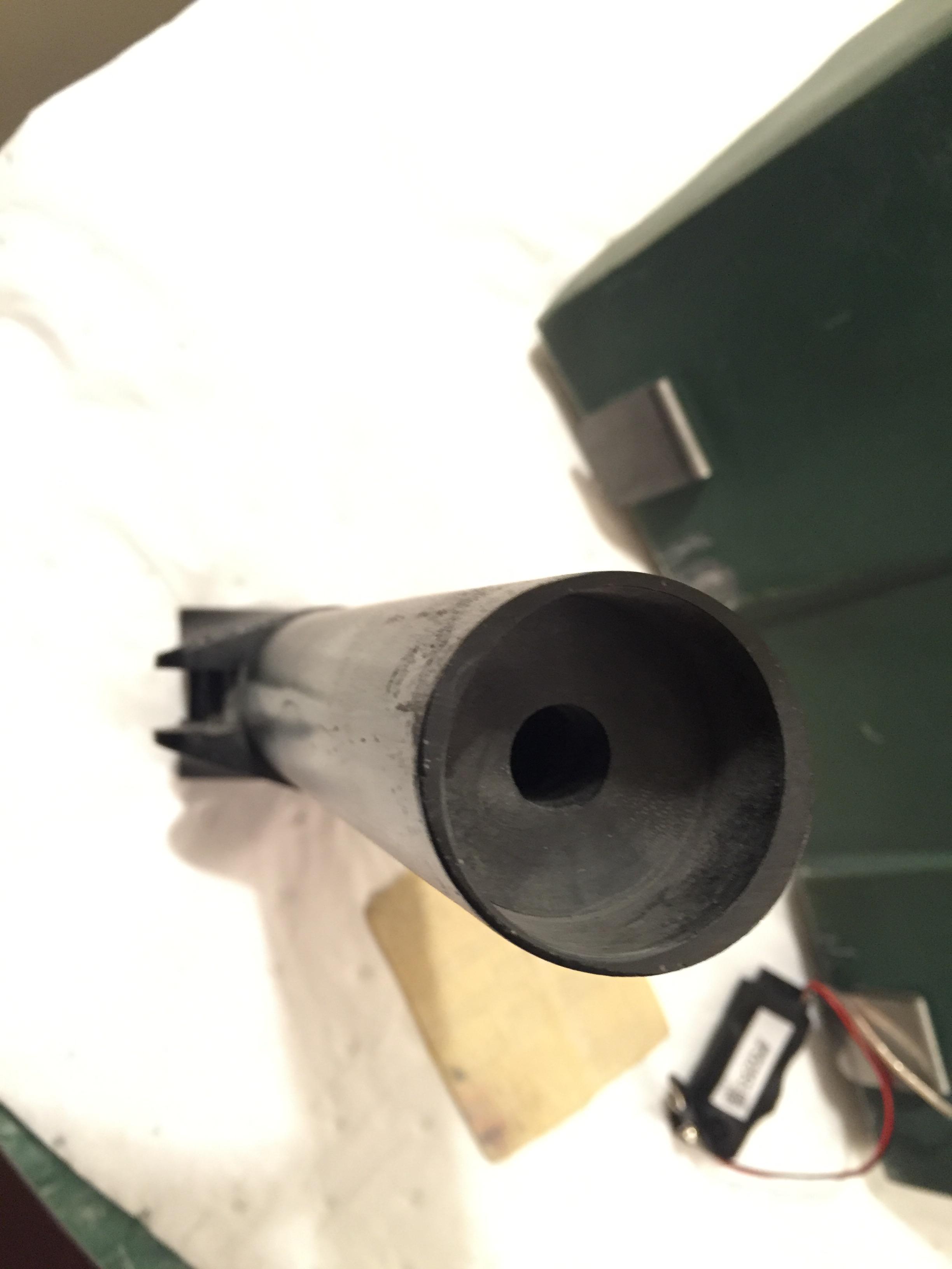

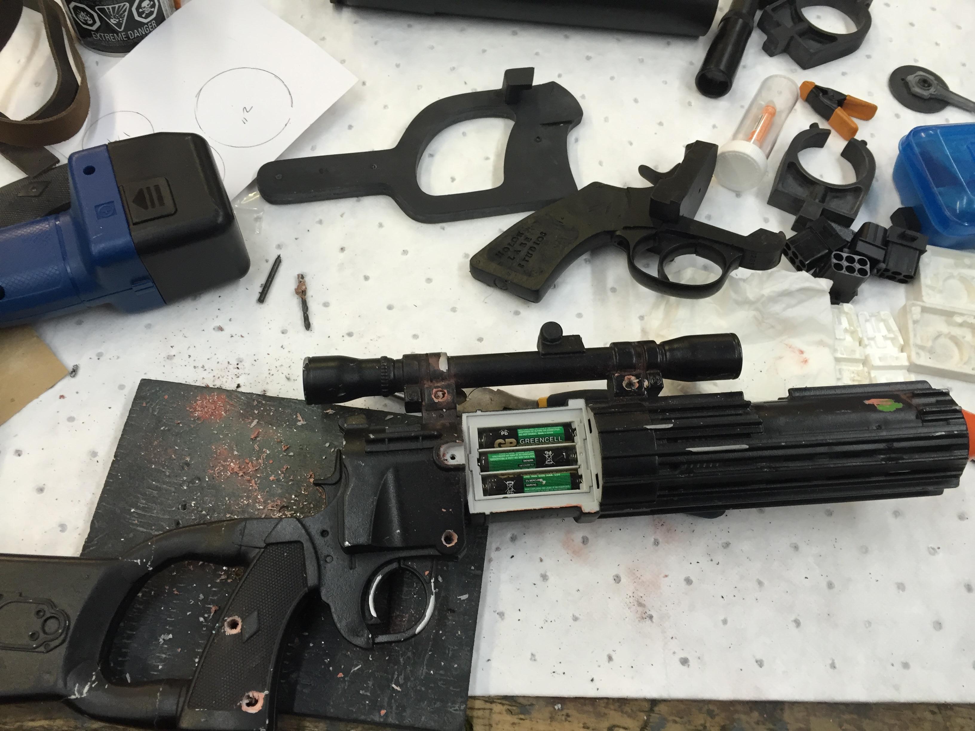

I started by drilling out the solid resin barrel.
I also dremelled out the receiver with the initial plan of placing the electronic board in there and somehow figuring out how to make it fire.

The work continued. I drilled out a hole so I could open the blaster like a flare gun. I wanted to be able to access the electronics and batteries at any point.
So, the next challenge was to figure out how to make a functioning trigger.

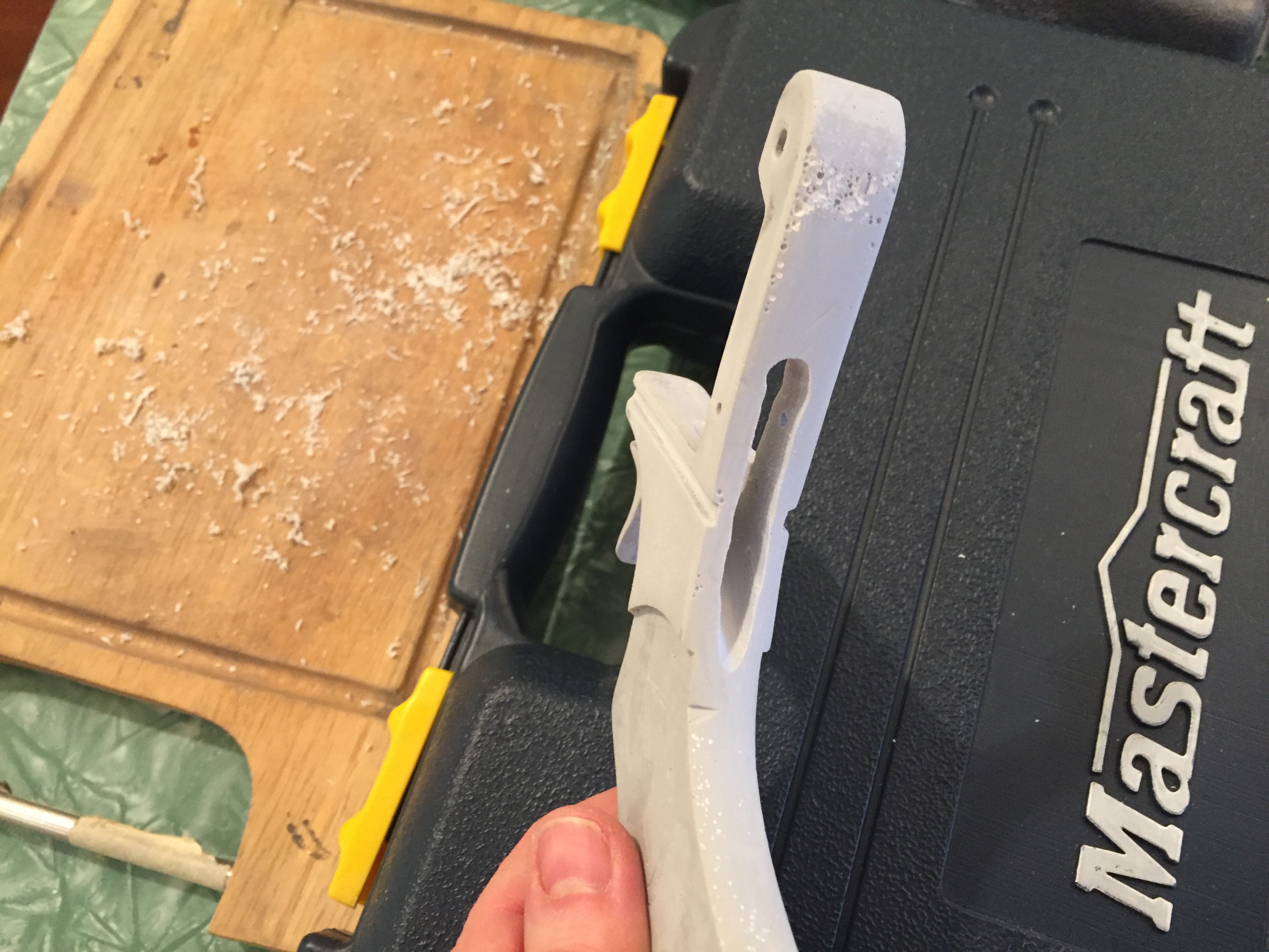

I needed to hollow out the area I circled in this pic. I used a drill and a dremel. I also used the dremel to cut off the existing trigger and guard.
Here's a pic from below.
And, here is a pic from the top. I needed to make enough clearance for the shape of the trigger. I drilled a hole for the pin and just used a dremel bit to test it out. It worked, but I still had no idea how the trigger was going hit the button on the board.
At this point, my plan was to put the board in the receiver (and somehow trigger it) and run wires and the batteries down the barrel with the speaker and light (with diffuser) in the chromed tube at the end of the barrel. However, there were two immediate issues. First, the three AAA batteries in the holder from the Hasbro blaster wouldn't fit anywhere in my new blaster and, second, the original light diffuser was longer than the chrome tube. I've never tried anything electrical like this before. Fortunately, I had some help from my local garrison and my Mando Merc buddy Dennis had some ideas and some skills. He created a battery holder where the batteries sat end to end and they would fit down the barrel! You can see the size comparison.
I also just used the dremel to trim down the diffuser so it would fit in the chromed tube. Here is a pic of the cut down diffuser and the original Hasbro speaker. I would just used the smaller piece on the right side.
