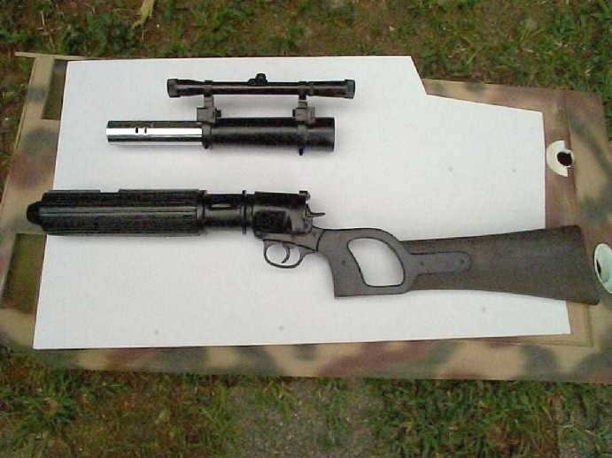

The blaster I will get like this: (pls dont mind the ESB barrel)
Thanks for your advice

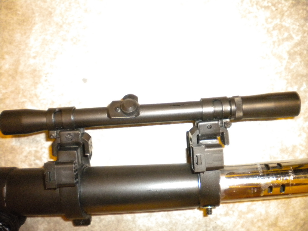

That is almost the exact scope I have, same scope rings etc, mine is a Tasco. I found it is 1/4 inch shorter in the body and 1/4 inch longer overall than my resin scope copy of the ASI.
Problem that I have is that overall that 1/4 inch turns into 1/2 inch when the scope gets mounted so my rear scope ring sits forward of the optimal position on the barrel.
I think it looks odd on mine. In the photo the mount on the left needs to go forward (more to the left) to suit the scope rings
Wow, Thanks for the comparison pics!
I think I can live with that scope till I get something more accurate in the future...

Thanks mate! That's the scope, barrel, gun & stock sorted. Just need the mounts! :D Although, normal scope mounts won't hold the scope high enough off the top of the barrel. What mounts are they that you have got?
Yes sorta...you need to add that adjustment nob, and the mounts...the mounts are the same but there are blocks they mount to on the blaster its different...the rings on the scope are the same Stormrider is working on his brackets for this now :)
