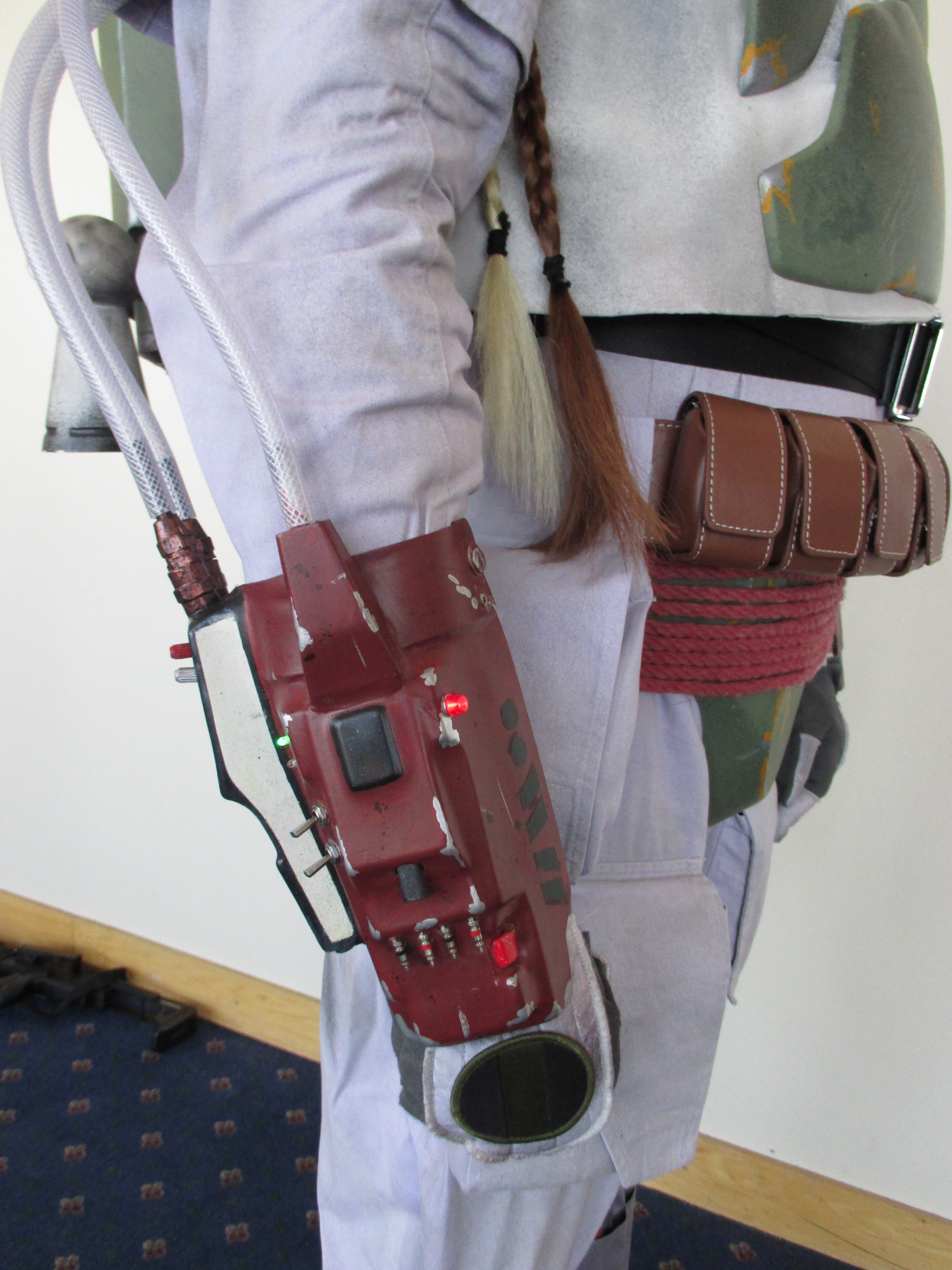

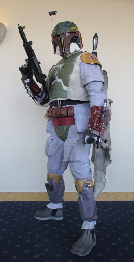

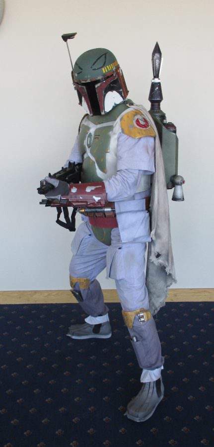

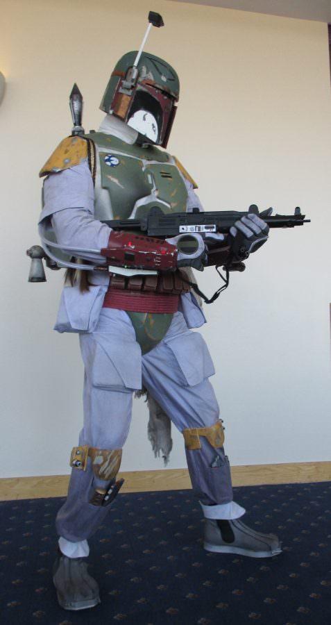

For my Mandalorian Protector mine started as bright white. I mixed the gray for the overall color, I did an almost black dye for leg bottoms where I dipped the legs up to the knees or so to get that dark leg bottom look, and I did the rest with spray paint.
The vest was done with mostly spray paint as you can see in this pic.
I have darkened things a little bit since this, but not much.
