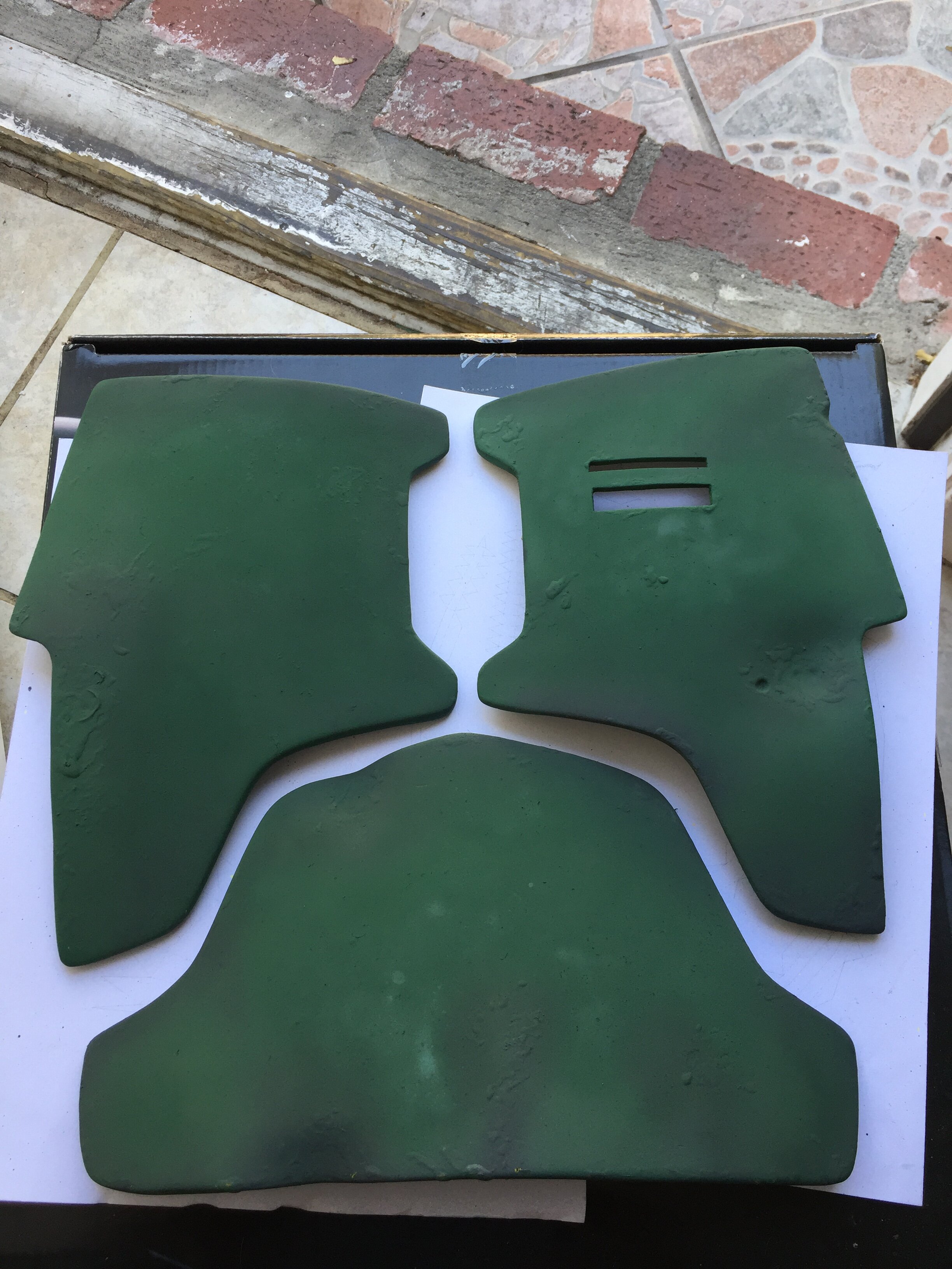

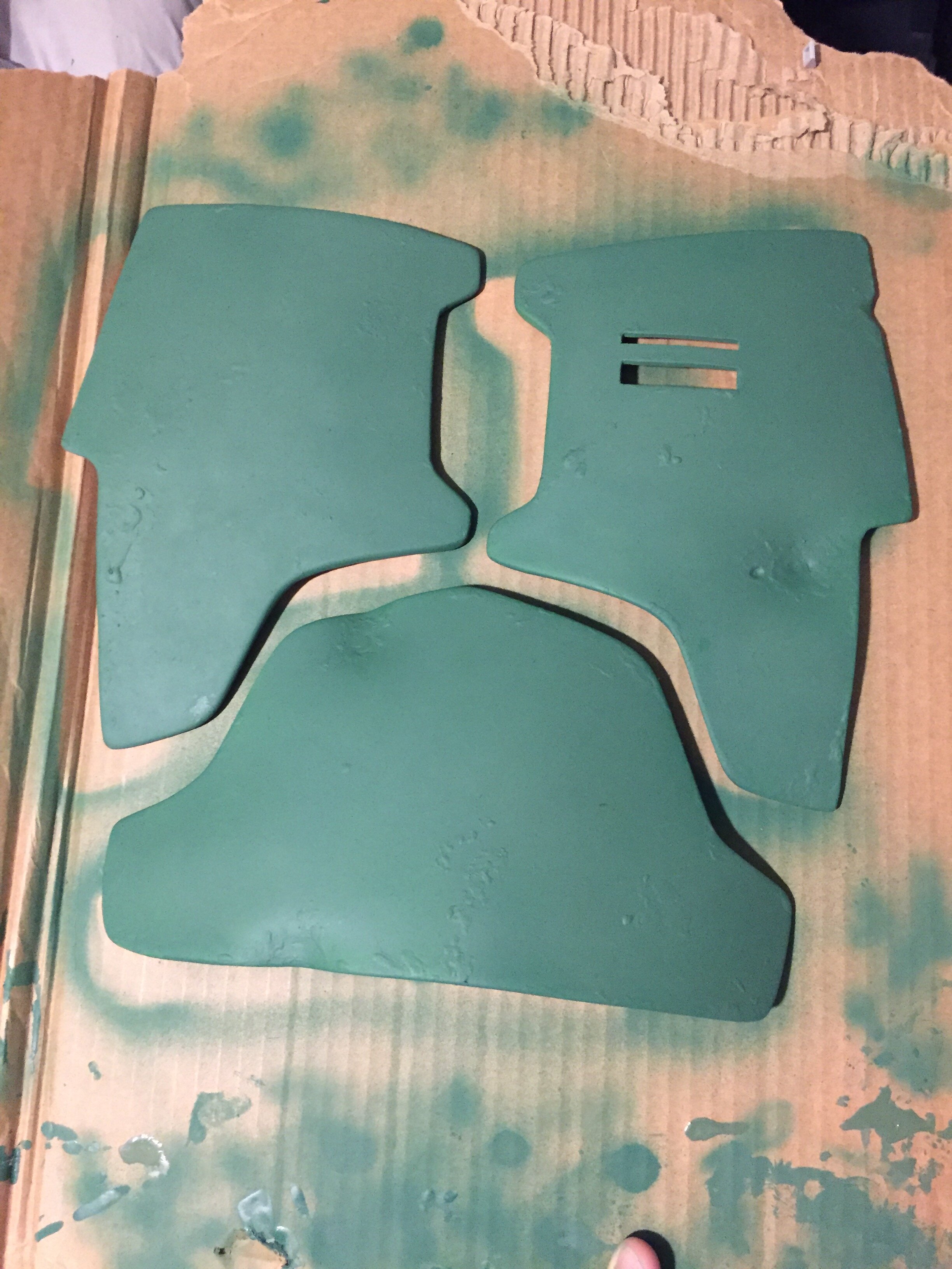

I just got a new airbrush and I finished all the layers! I'm now done with the green and will go on to do the shades (if anybody know what color to use that'd be super helpfull)
My problem now is that I think the green is too bright compared to the movies...
here are some pictures

I'm going to add the shading, I'm thinking about mixing my green with some black, then misting it exactly like the one on this picture.
I'm still not sure about my green though, it's a 76/78 mix but doesn't look like the one from the guide I've been following.

it is a 76/78 mix, don't be afraid to go more grey (panzer green) than you think.
The grey (panzer green) for the shades you mean or the base color? I remixed the 76/78 and got something I liked a lot more: let me know what you think (It was taken inside at night with the flash on my phone so I should get a better idea tomorrow but I'm liking it more)

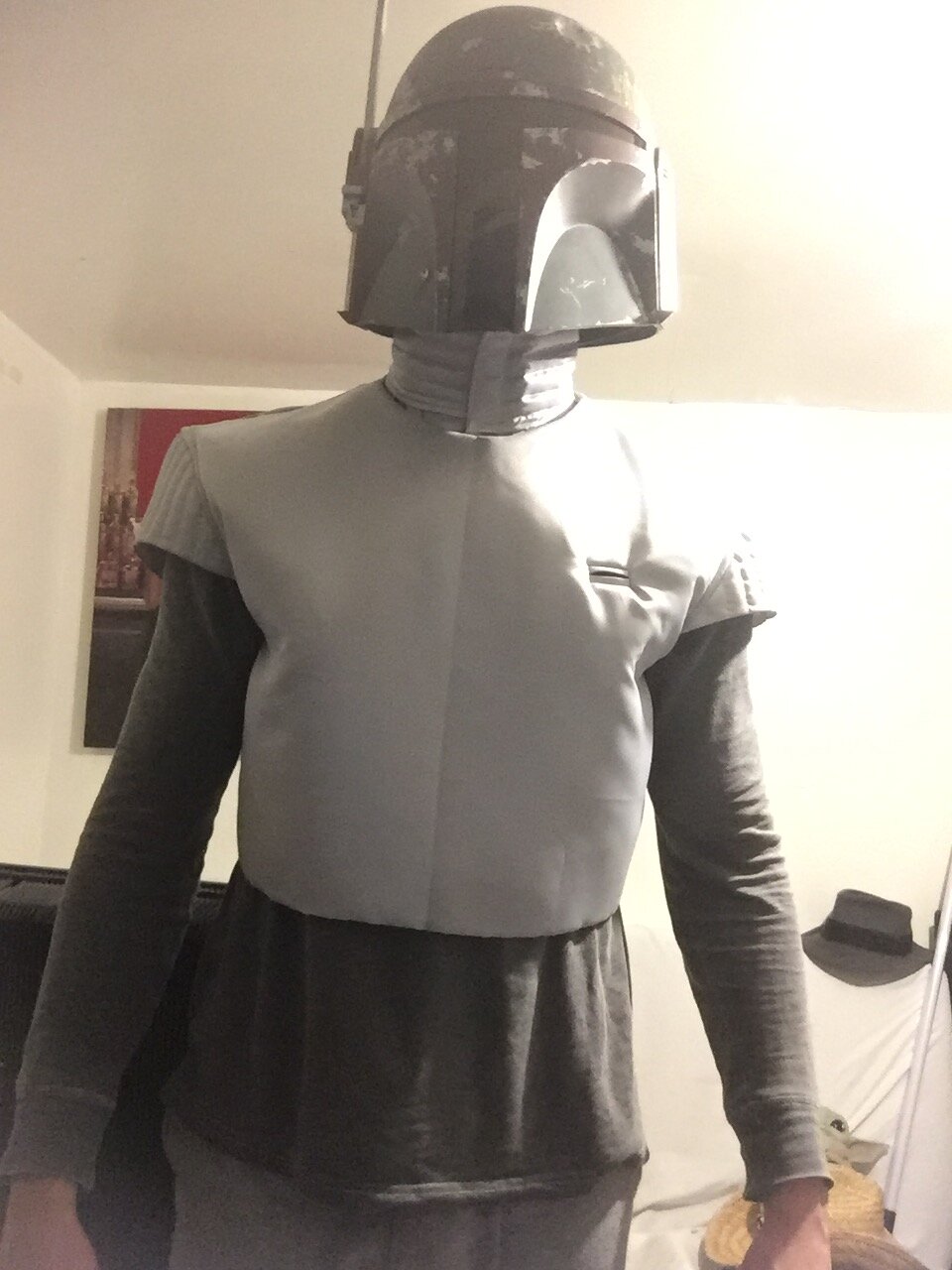

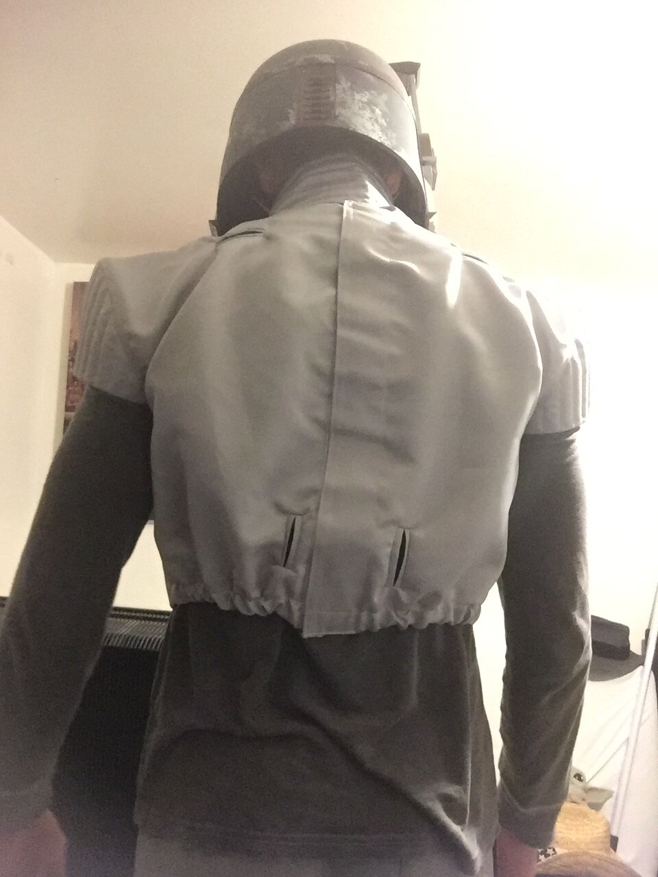

Update: Received the Flak vest but I'm not sure about it: the shoulders are too wide and the back seems the be weird (I have a small waist so it looks like they just put an elastic instead of actually tailoring it.)
Let me know why you think
I think your impression is correct...they did not properly tailor it to you. And is there a seam down the front or just a crease? Because there shouldn’t be a seam there.
It's a crease, the problem is that I would have to return it only to get a refund... Then go through the hassle of finding another vest, have it tailor made again and wait to receive it. Do you think it can be saved? Maybe I can get the back tailored to my size but it would move the positioning of the holes. Do the shoulders look bad to you, know that I will have a flightsuit underneath (probably thicker).
I am also wondering if with the back plate it would still be a problem...
A good tailor should be able to bring those shoulders in
