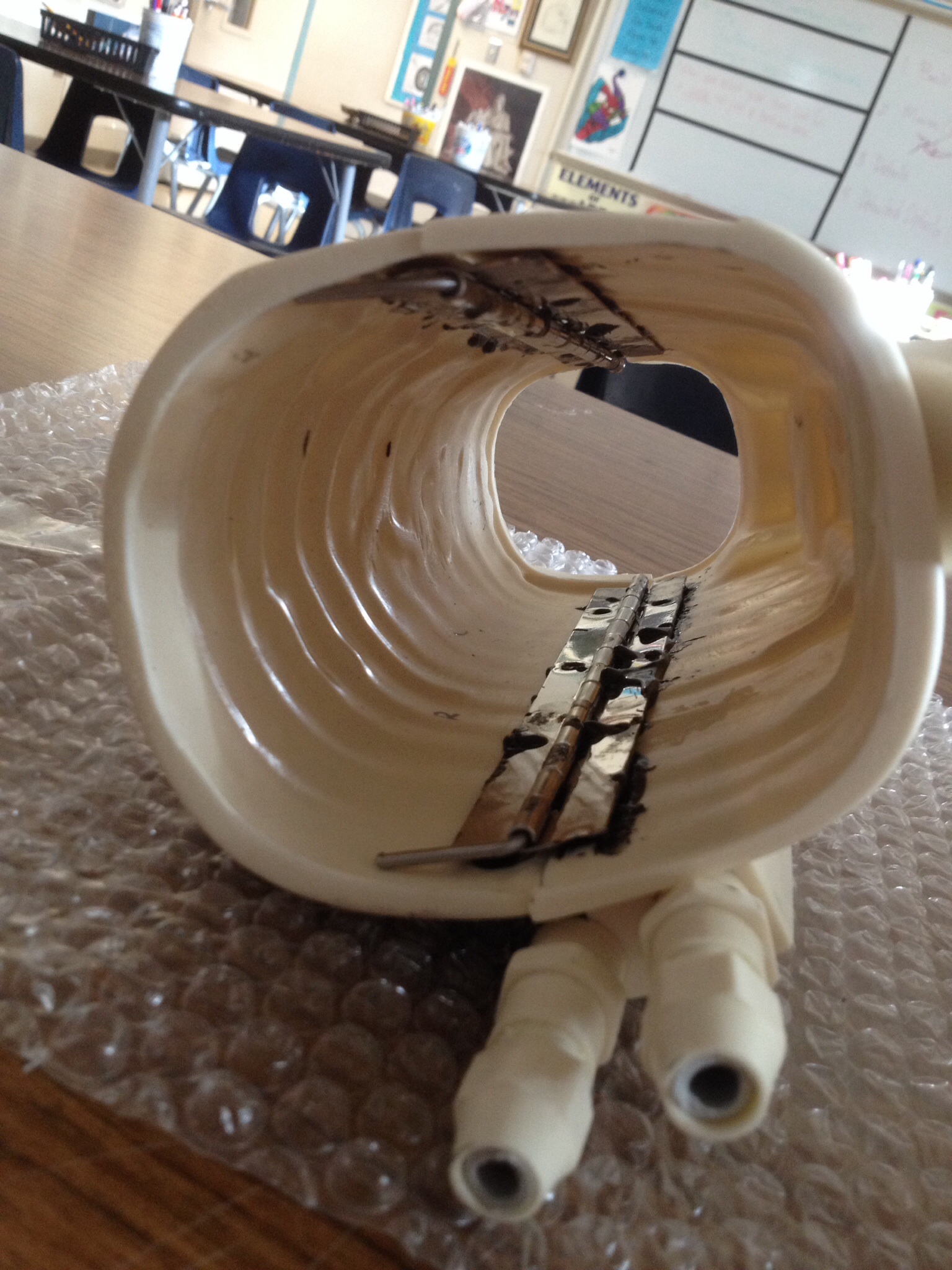

Did the double hinge method. Both sides of my gaunts have the hinges on the inside and I remove the hinge to open them, just like real armor. You need a "squire" to help put the pins in them but they are solid. I really like it and the side look clean with no hinge visible. Pics soon

Here is a pic
Double pin... Hmmmm... Is your kindergarten class room doubling as a Mandalorian armor construction factory? Hahahahaha are you going to reinforce those bad boys? (Fiberglass/Urethane?)
It's my art room, lol and yes the kids have gotten see various stages of my build as part of a recycled art project, costuming project, painting, and it's just cool lol. No reinforcement and I love the double pin personally.
I like the method. Never thought about that. Bet you could still put them on by yourself without too much trouble.
