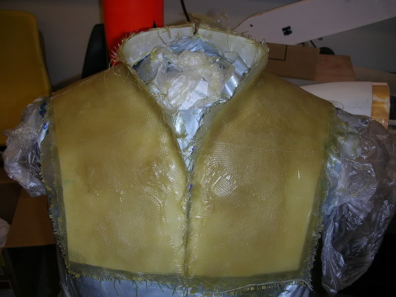

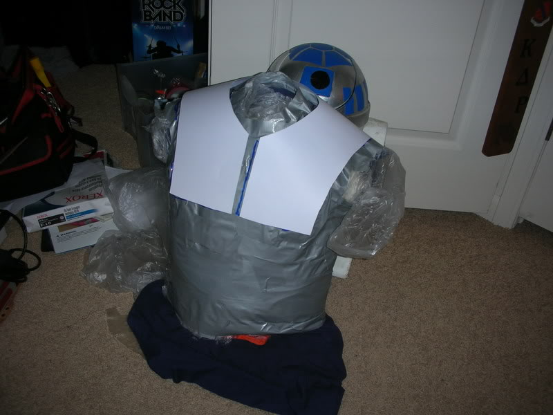

I was going to make my armor out of Sintra, but after I saw your armor I decided to put away my hatred of fiberglass and try it your way. After making a manaquin of ductape I took some paper and poster board and made a template. the collar is glued on the poster board, and I plan on glassing it later tonight after I go belt hunting.

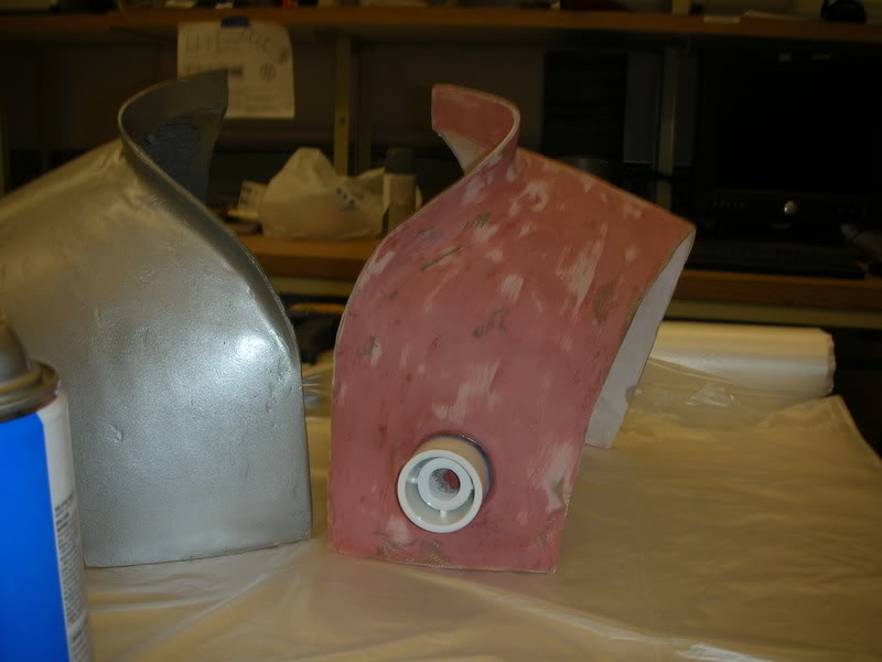

The plan is to make a restraining bolt ( I still don't get why he is wearing one) out of bottle cap and a PVC coupler. I used a similar teqniue to make one of the vents on my old proton pack.

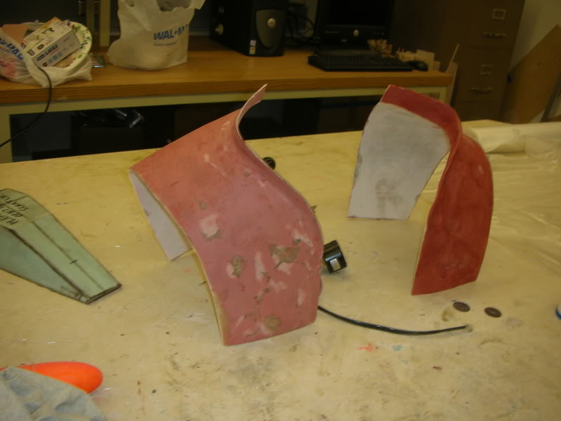

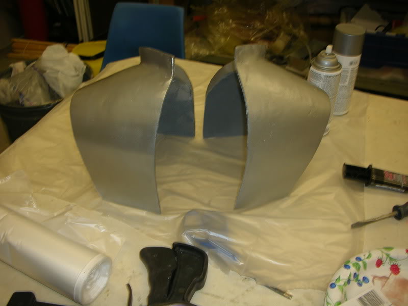

So last night I started to get busy on the armor and probably killed a few brain cells in the proccess. I fiberglassed over the poster borad with a $10 container of resin and 1.5 packs of fiberglass cloth, so this little piece has 12 sq ft of glass cloth on it. Today I trimmed it, bondoed it, glazed it and painted it. Here are some of the high lights:
Tonight after I shower and eat I plan on finishing the restraining bolt (anyone else see the irony of a restraining bolt on the main character in The Force Unleashed?) and adding some grime with back spray paint and charchol. Tomorrow Ill add the straps and then if everything looks good I'll see about getting the haircut.:rolleyes
looks good dude! did you mirror the template patterns or make seperate temps?
I made one template for one shoulder and mirrored it, althought the collar I had to have fun matching since I glued it on before I traced the other half.
Ill be trying to put straps on in a little bit, so expect a "finished" product this evening.
