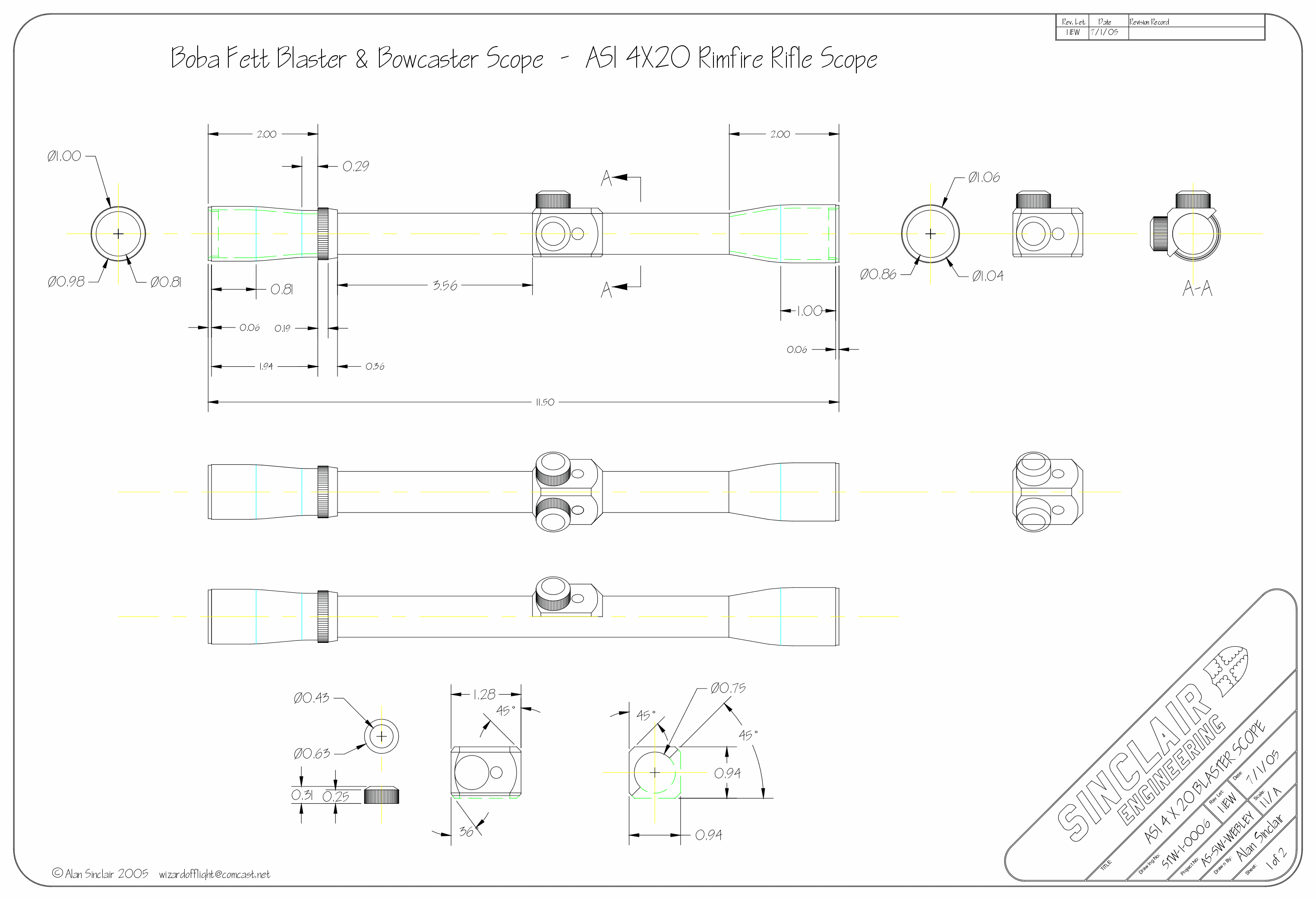

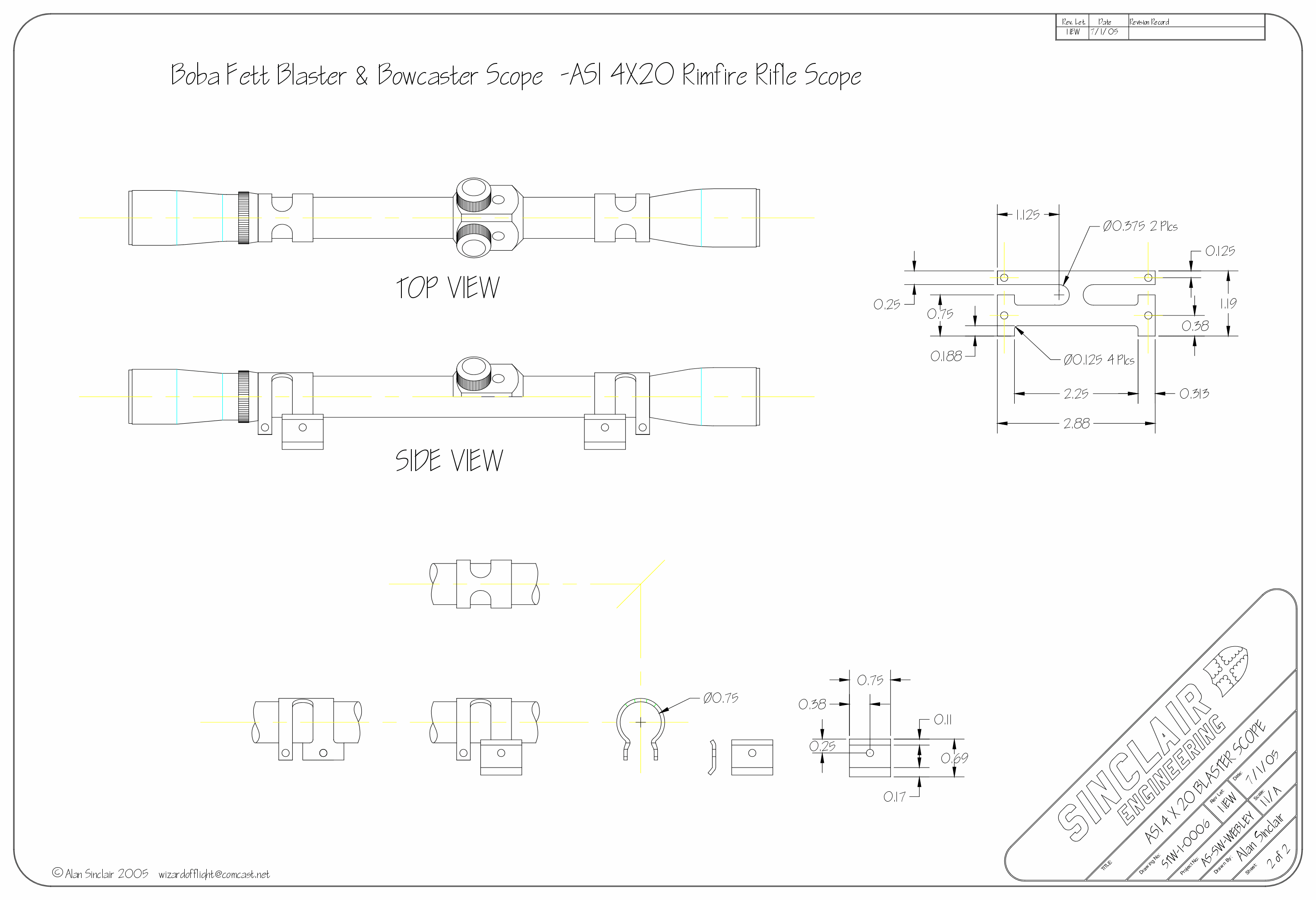

One of my first projects was to create drawings of most of the Scopes & mounts of the various SW blasters, including Boba's Scope and rings. The Dent's own Art Andrews created a web page to showcase them, but that was a couple of servers ago so I am not sure if it still exisits, I have attached the Boba Scope files.
Alan
P.S. My other Blaster Scope drawings
Han Solo GK Scope
Han Solo Std Scope
M-19 Scope
M-38 Scope
MG-15 Enfield Scope
MG-15 Snooper Scope
ROTJ E-11 Scope
Single Point Scope

What about the scope rings? You did the mounts already, but the rings would be great too!
Alan
Han Solo GK Scope
Han Solo Std Scope
M-19 Scope
M-38 Scope
MG-15 Enfield Scope
MG-15 Snooper Scope
ROTJ E-11 Scope
Single Point Scope
Strange, we'll try this with out the ZIP.
Alan
I can't seem to open your file... :cry
