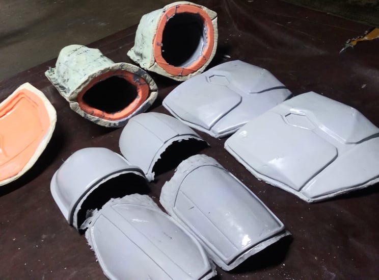

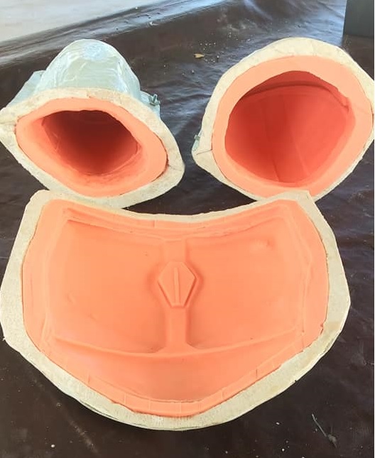

I just finished the third silicone mold now just waiting the urethane resin 300 arrive to start making pull outs. thank you for waiting .

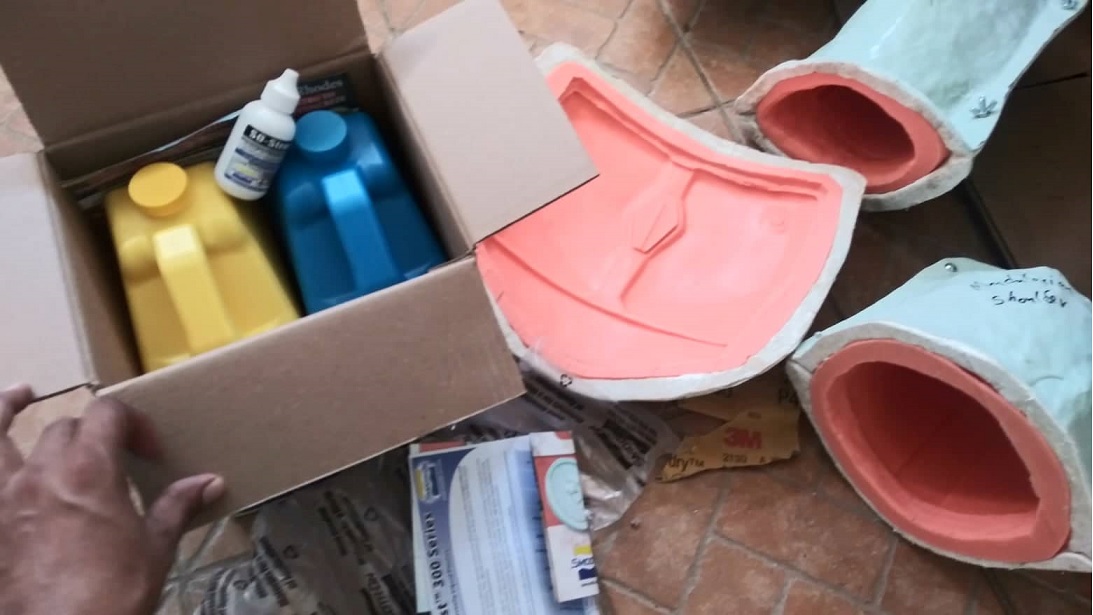

two set done tomorrow we will continue my friend is making the pull outs we will try to sent as soon as possible this week is hard cause holydays; we will try.

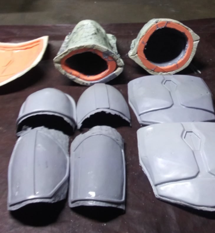

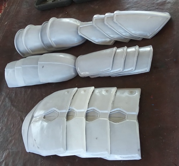

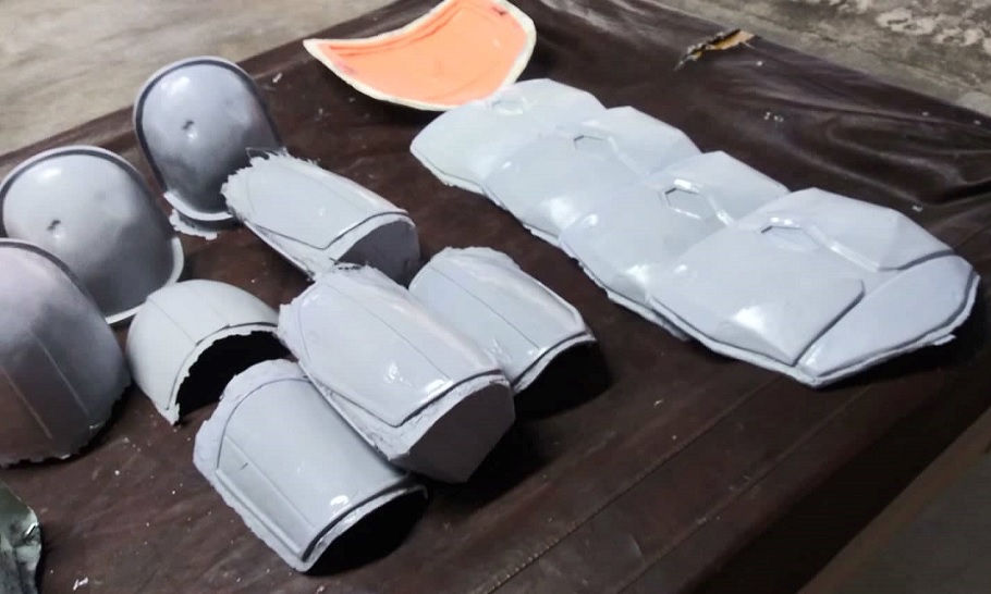

Ever tried the Onyx resin before? I've grown to be a big fan of it, really great properties for slushing and the fast cure version shaves a lot of cure time off for much faster production. Higher melting temp makes it much more warp resistant too. And if you choose to offer cold-casts of these the black naturally helps that too. Only problem is it's hardness can make it brittle when thin, but looks like you're casting these very thickly.
ready for shipping and still waiting for more urethane resine. all the armor are made 300 urethane resine is stronger (I decide not vaccum form)
