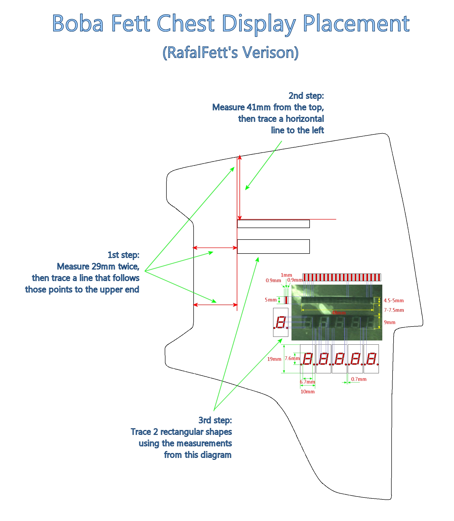

I looked thru them and didnt see what im looking for. Im looking for roughly how far from top edge and left edge of where to cut out openings to install display. If there even is a specific measurment
Here are the measurements for the chest light cut out:

Yes perfect. Do you charge for your services were these located on this forum somewhere if not what about the 2 switches for right gauntlet and are those gauntlet darts the same for esb version. Thanks for your help
Some of these images are scattered in different threads and weren't posted in a template thread. The position of the darts is more or less the same on all gauntlets. The right gauntlet switches position is not in the same place on all gauntlets.
