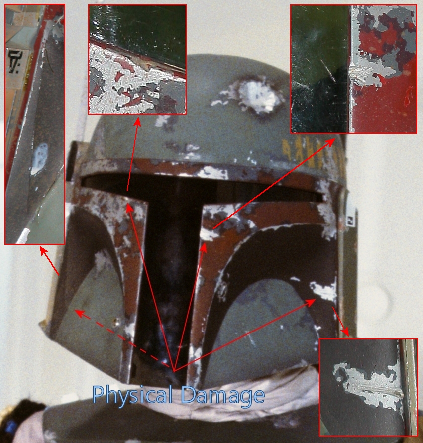

  • Right now, I’m struggling to find good photos of what the physical damage (in all the areas) is supposed to look like......I have the reference photo on TDH that has the arrows edited into it, found in the templates thread, but it’s not the best quality. I’m currently going through more paintups to find other examples, and using Welsh Warrior screenshots as a guide. He mentions on his video about placing the ‘holes in the right place’......I presume the physical damage has deeper crevices in some places, but I can’t seem to find good references. Q: Can anyone point me in the right direction?

Here is an image of the physical damage. thanks to Rafalfett for the image :)
Thanks, Lou....that's one of the photos that has confused me, though. I'm struggling to see what the 2 photos on the left are showing. The two on the right, I think I'm comfortable with. Would someone be able to photoshop an arrow or color in the damaged area(s)?
Also, in Welsh Warrior's video, he shows some chips along the bottom edges, and nothing along the earpiece. I'm afraid I'm looking at incorrect references for ESB.

The pic on the left is referring to the hairline fracture on the inner cheek.
- - - Updated - - -
The other pic on the left shows the chip out of the edge of the top edge of the lower mandible, right under the visor.
What armydad said is correct. i know of the chips your talking about along the bottom of the cheek but this is the only reference i have for Physical damage. I think Raf made this image either before that damage was realized to be there, or its post filming damage. It was however incorporated on the FPH2 ESB helmet...Rubio did a nice review of that helmet and i think his photos show that particular damage, so that would be the next best thing to use a reference.
Also that image above is 100% the ESB helmet. there is only one ESB hero helmet, and the paint damage is unmistakable. Also, keep in mind the helmet had more damage on it by the time the ROTJ SE scenes were filmed (which is also the condition on the touring suit fro MOM and the other past tours) The current condition of the ESB hero helmet has more damage on it than it did during the ROTJ SE as well.
Have I identified the correct areas, specifically that hairline fracture on the inner cheek? I don't see that one in your photo.
Yep, that's them. I didn't put the hair line one on my helmet, there's some silver damage that starts the "line" on raff's stencil, I was happy with that. So mine only has the two chips on the mandibles and the gouge on the other cheek.
