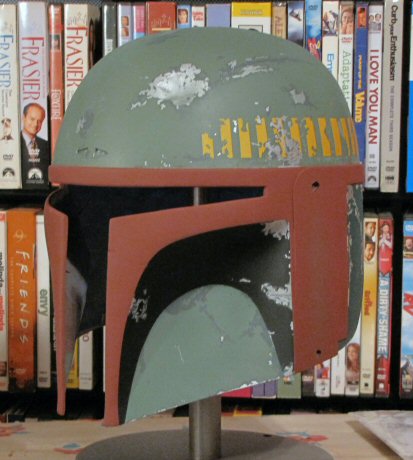

UPDATE: June 8, 2013

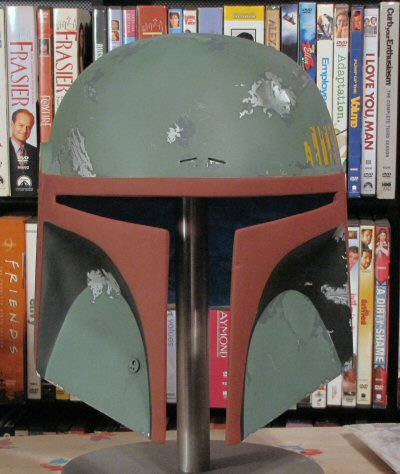

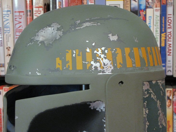

Today's session ends all the "basic" painting on the dome. :)
I finished the network of silver and gray damage in between the killstripes.
I also did the fade below the stripes. It's always been my theory that this
is masking tape residue. I don't have any facts to back this up, it just has that look.
To do the fade, I use very watered down PollyScale Concrete with a size 0 brush.
I apply it in several passes, letting the color develop slowly with each application.
It's basically a pale beige wash that's strategically applied, rather than covering
an entire surface. It has a very subtle appearance, but it is on the screen used
helmet, so it goes on my replicas. :thumbsup:

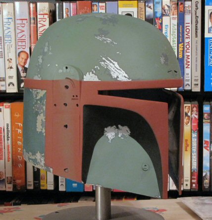

UPDATE: June 9, 2013
The sea of green has been parted! Let there be red.
Got the base coat down on the mandibles earlier. Now it's really starting to take
on the Fett look.
This stage involves the most complex masking of the entire project. It actually takes
longer to mask everything off than it does to airbrush the mandibles! But that's how
it goes.
Tomorrow I'll begin adding the gray/silver/maroonish damage areas to the red sections.
I'll begin with the keyslot section, then work my way around until everything behind the
ear platforms is done. The front of the mandibles will be last.

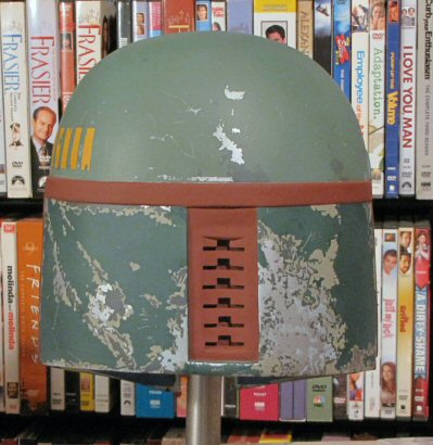

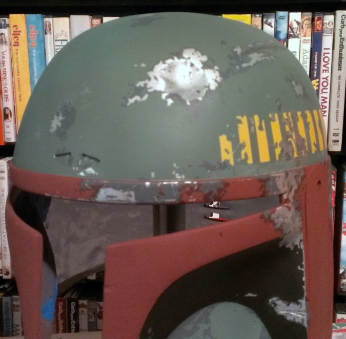

UPDATE: June 10, 2013
The detailing continues. I've started the damage on the red areas with the keyslot section.
Still using my SP Lark Dk Gray and silver, but also add some PRR Maroon to set off the gray.
This process will continue around the "hat band" and onto the mandibles. Every day gets
a little bit closer now. :thumbsup:

UPDATE: June 11, 2013
Moving onto the hatband now. I've got the central portion done. There's a lot
of fairly intricate stuff going on in this relatively small section of the helmet.
From here, I'll keep working outward toward both ear platforms. If everything goes OK, I should
have all the detailing behind the ears done by Friday. :) Then, it's on to the front!

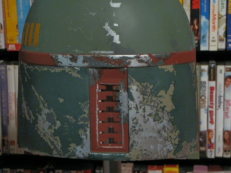

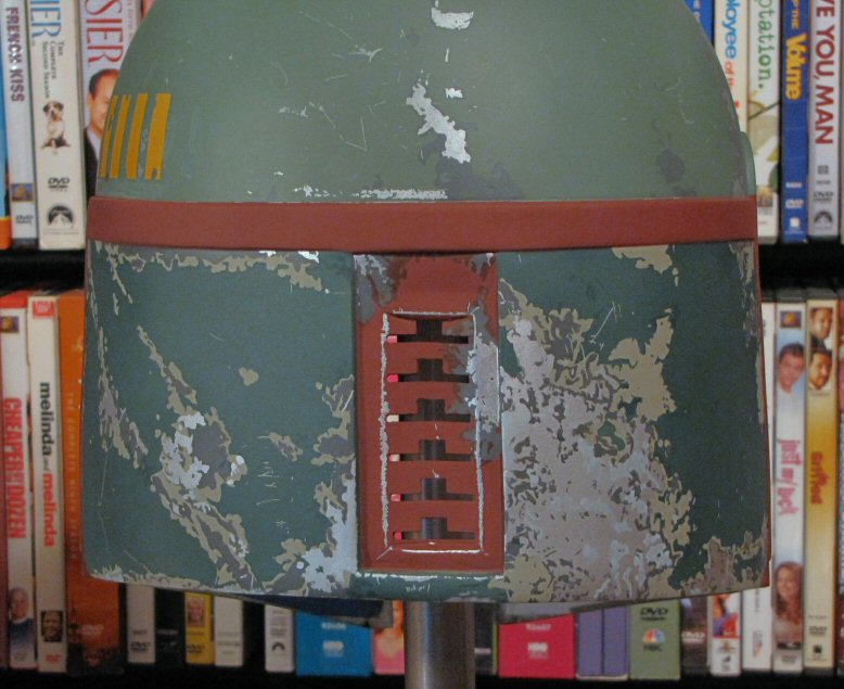

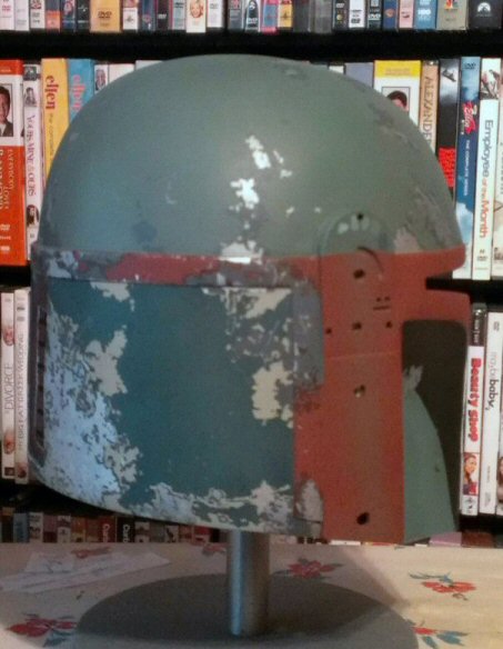

UPDATE: June 15, 2013
Still using my phone cam. . . so pics are kind of hit or miss. :(
Making lots of progress thanks to the weekend. I've gotten everything behind the ear
platforms done, and I've moved on to the front of the mandibles. I started at the left
corner of the visor.
Lots of detail crammed into that little corner! I also started moving across the "eyebrow" section
above the visor cutout. I'm halfway across the front at this point.
I'll continue across the eyebrow area and then that will leave the mandibles themselves.
Scott had requested that I install one of Mojo's replica Borden connectors, too. I'll be
drilling out the molded-in Borden at some point and installing the crisp, beautiful brass one. :thumbsup:
