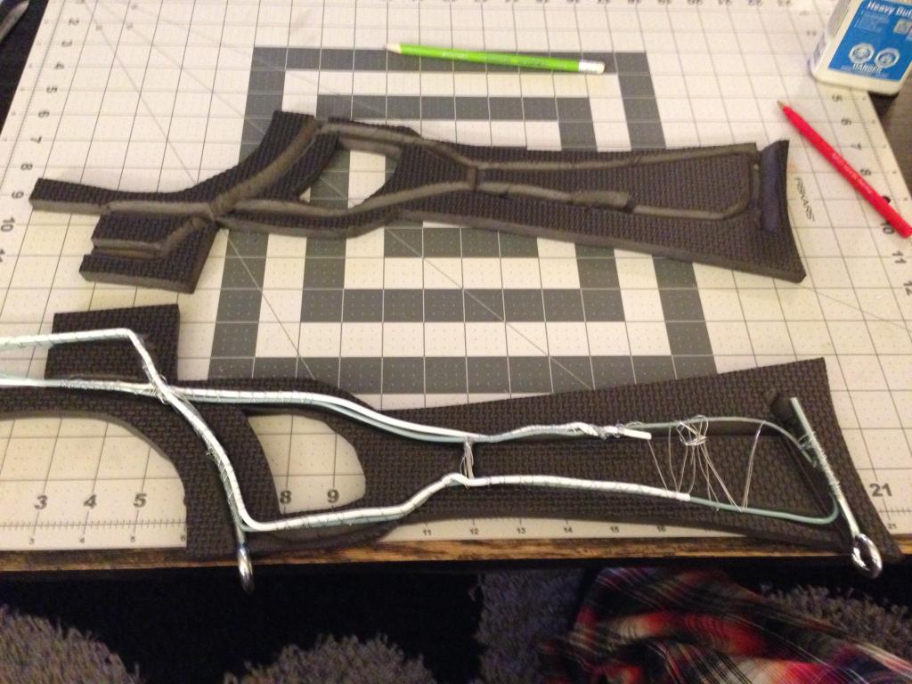

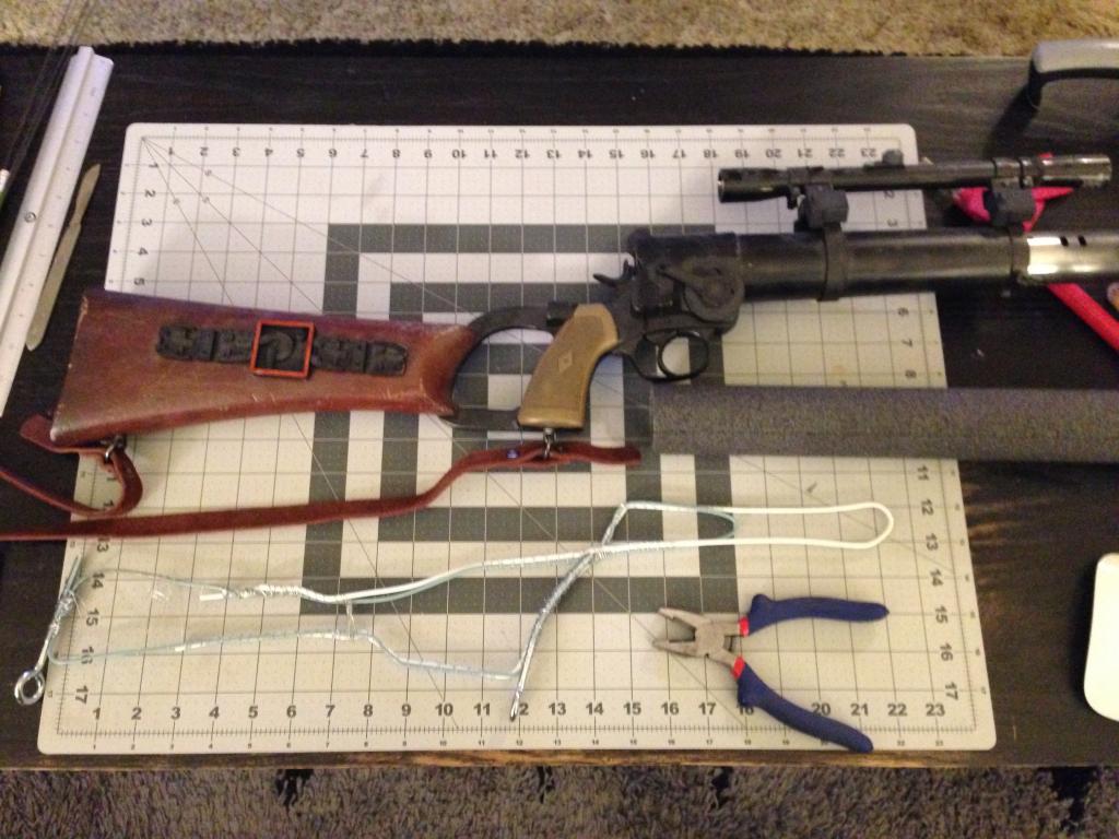

I started with a wire frame made out of a couple wire coat hangers and some floral wire. 10 minutes of bending and 20 minutes of securing with floral wire yielded this.
I traced out my Sidewinder EE3 onto a piece of 1/2" EVA foam floor mat. I cut it out, then traced and cut out its mirror image. I carved a trench for the wire frame to sit inside on both halves of the foam. I then used contact cement to glue the two halves together.

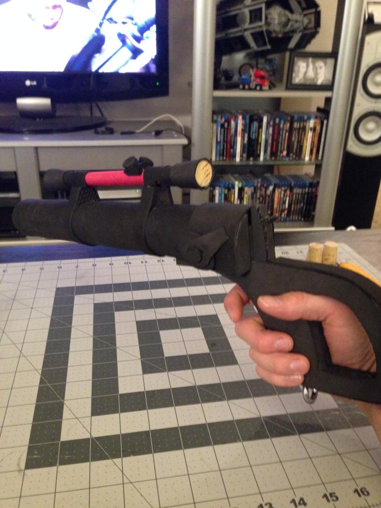

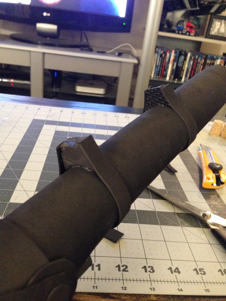

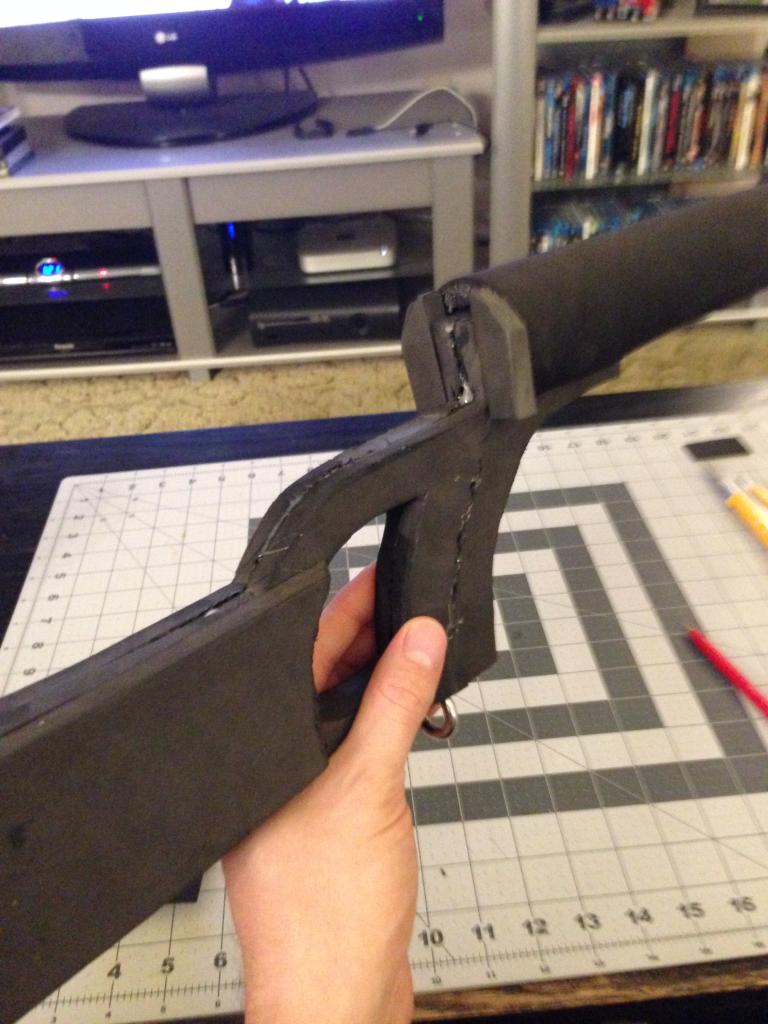

As the two halves dried and glued together, I took a piece of 2" pipe insulation foam… you non-Canucks know what that is, right?
I wrapped it in a sheet of 3mm craft foam, then cut it to fit onto the barrel shaped wire frame at the front of the gun. After a little trimming, it fit just fine. I added a couple foam blocks to the rear to simulate the breech block's rear wall.
