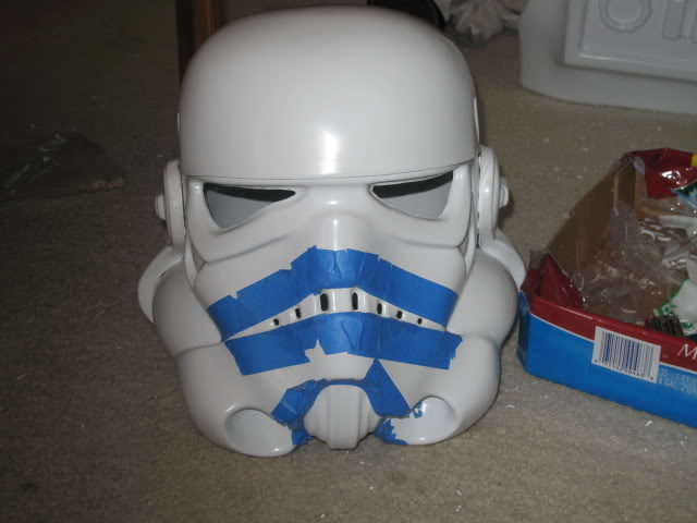

I was wondering what color # testors i could use to paint the frown and the buttons on the abdomen. if i can get better paint some where else. like home depot or walmart and such, a recommendation would be nice
any and all help is greatly appreciated
also, finals are a pain in the you know where :cry
I did some research before I repainted my MR CE Stormie bucket, and I guess the most widely "accepted" gray is Humbrol #5 (Admiralty Gray) followed very closely by Testors #1138.
The Testors is probably much easier to find. At least it was for me! :)

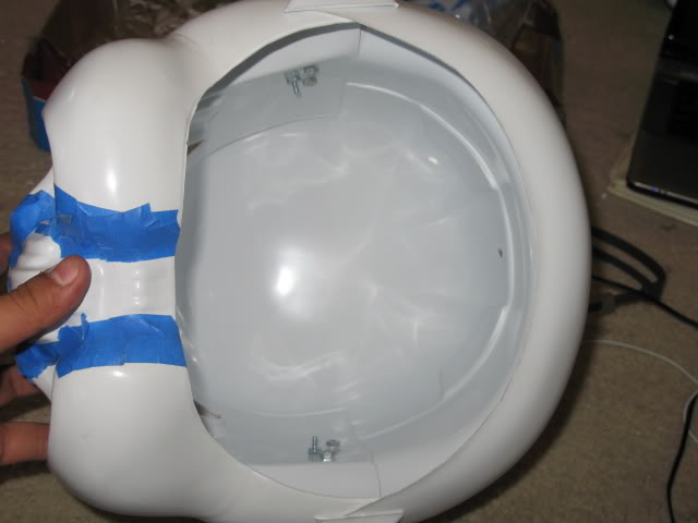

So, I finished the helmet, but i have a problem
The helmet is way too small for me, i mean, i can corkscrew it on and thats hard enough.
So what can i cut from the bottom, can someone do some fancy photoshoping/ms painting to show me whats ok.
thanks again.
thanks again.
Yeah, a lot of people have that problem with the AP bucket, myself included. The most that I've seen just put it on sideways, but you can trim it back. I suggest you go here and look around. http://forum.whitearmor.net/index.php? You'll find much more archived information on the subject than you would here. :thumbsup: :cheers

Did you get the trim done on the neck? I would suggest you take a little more off the front (if you have not already done so). It's 100% normal to put your bucket on sideways.
corkscrewing the helmet on is how most folks do it. i shaved a *tiny* bit out from under the chin on mine to make it more pleasant... less than 1/4". i wouldn't want to go any further for fear of looking like the new rubies stormie.
well, the circumference of my head is about 62 centimeters, lol. =[
But I shaved a bit all around and it fits if i corkscrew it on and shove it down, haha.
