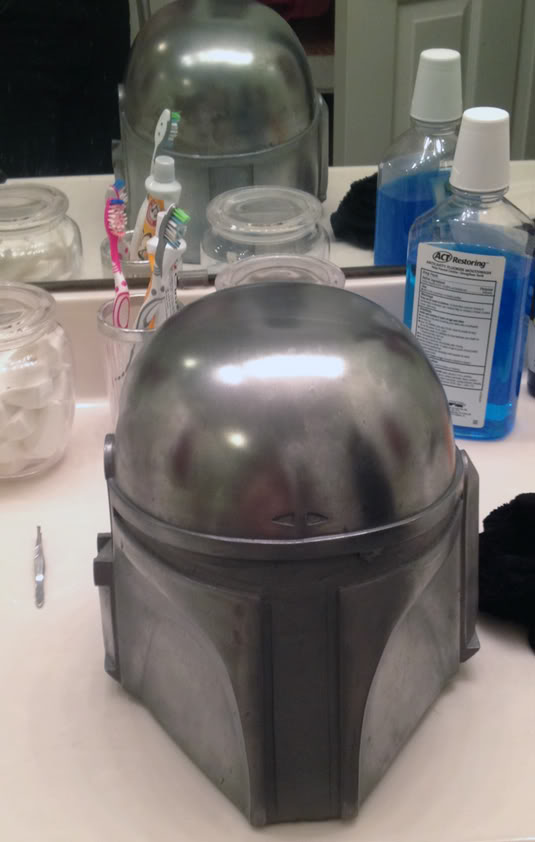

Got a helmet from Asok, and started working on getting it smooth and polished. I'm going to cut the visor out after I finish getting all the rough spots out of the cheeks...didn't want the added pressure to crack them. But, it's coming along slowly but surely.

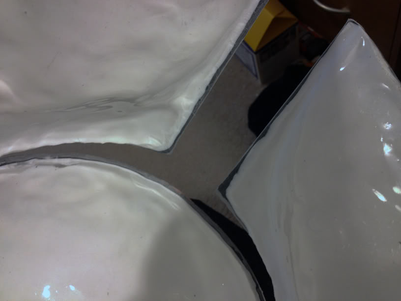

Ok, question for you guys...what's the best way to even out the inside of the helmet to fit the visor? I've tried using a sanding wheel on a Dremel tool that has the flex extension, but I'm not able to get a great angle on it.
What I have learned, and I'm sure others with more knowledge will chime in, but you don't want a completely flush and full seal. None will be close enough and at the right angle to see any small gaps between the visor and the helmet. These small gaps will also help with ventilation and the prevention of fogging on the lense. Just use your dremmel to get a "good enough for government work" lip for the visor to sit in.
Cool, thanks for the suggestion! The biggest issue is how thick it is around the upper lip of the "T" section. I bought a carbide cutting tool for the Dremel, and it worked great for the mandible area. Still having problems reaching the upper and lower areas of the wide part.
Anyone have any other suggestions?
That looks good to me. There are some angles that are just about impossible to get to. I have tried everything I know to do and you just can't reach everywhere easily.
The visor will be able to sit flush with the edge that you have there. One thing I have done around the visor area is to use some bondo glazing putty to smooth everthing out, then I hit it with primer and hand sand it to finish it out. The glazing putty is the stuff that comes in a tube and it is easy to work with.

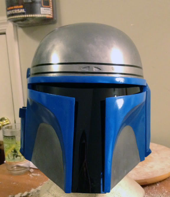

I've cut and trimmed the visor, still need to mount it. (hence it sagging on one side) And, mount the ear cap and weather it and I will call this part done.

Awesome, thanks for that! I've been hitting it some more today trying to get the visor to sit well before I mount it. I think I need to trim a little of the visor some more too.
