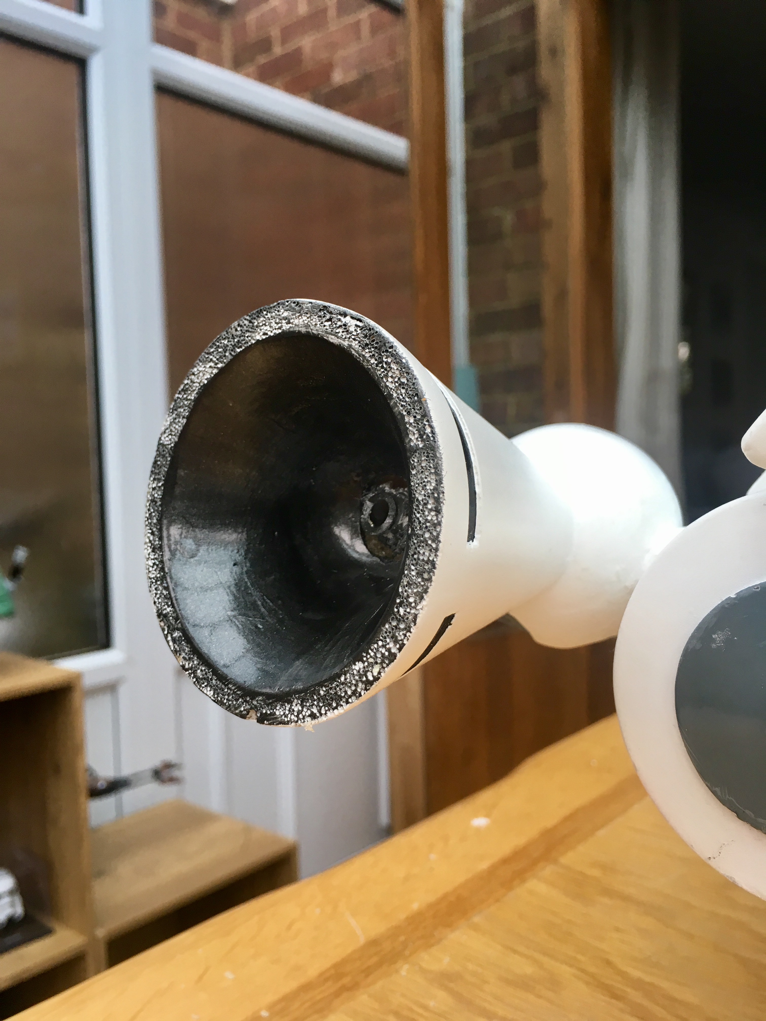

I am using an unit designed for the RC car world. It runs off 7.4v power and 100% pure vegetable glycerin ( same as used in ECigs ).

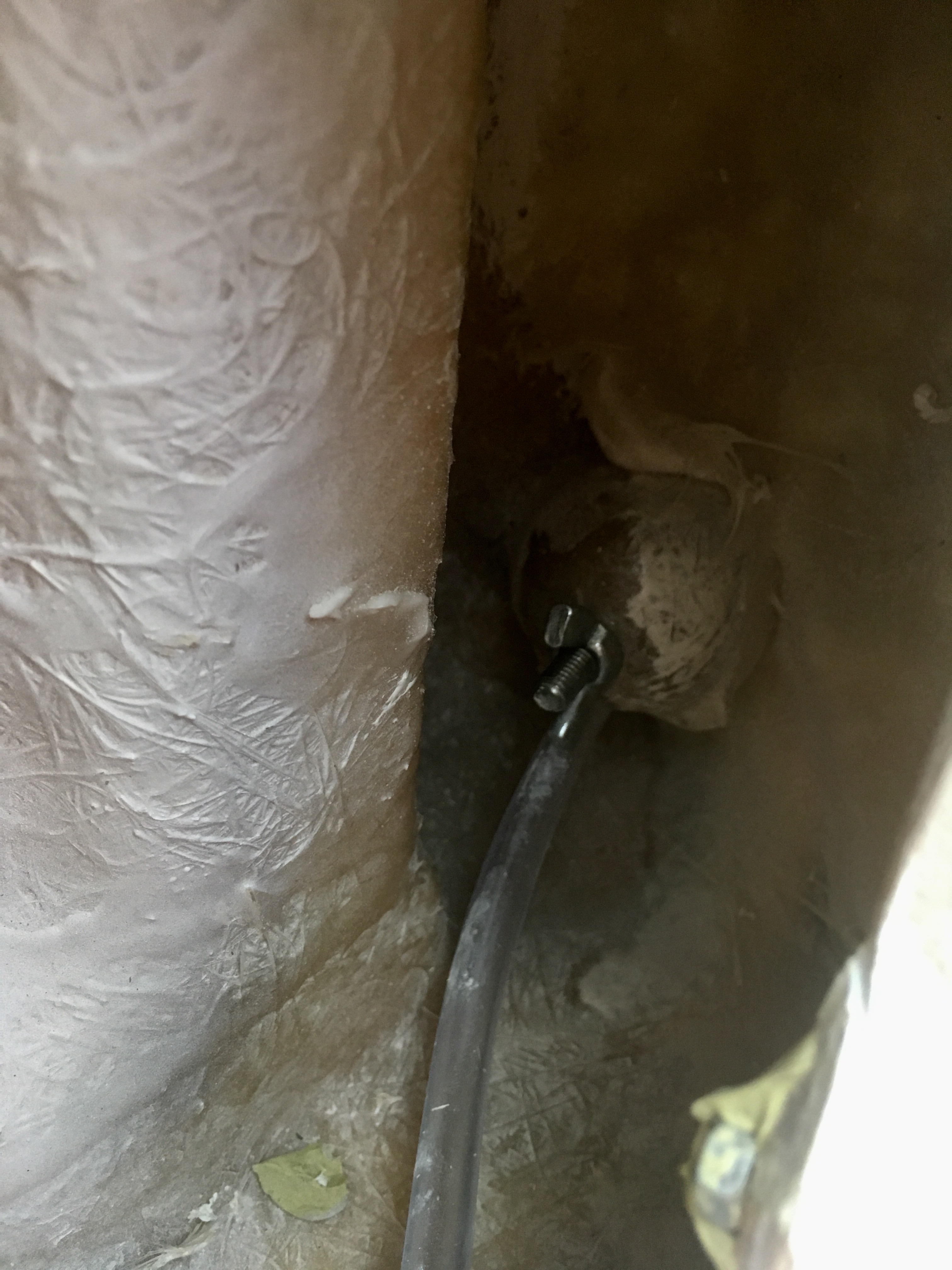

Its all self contained and I've run two Silicone hoses that run through the exhaust nozzles.

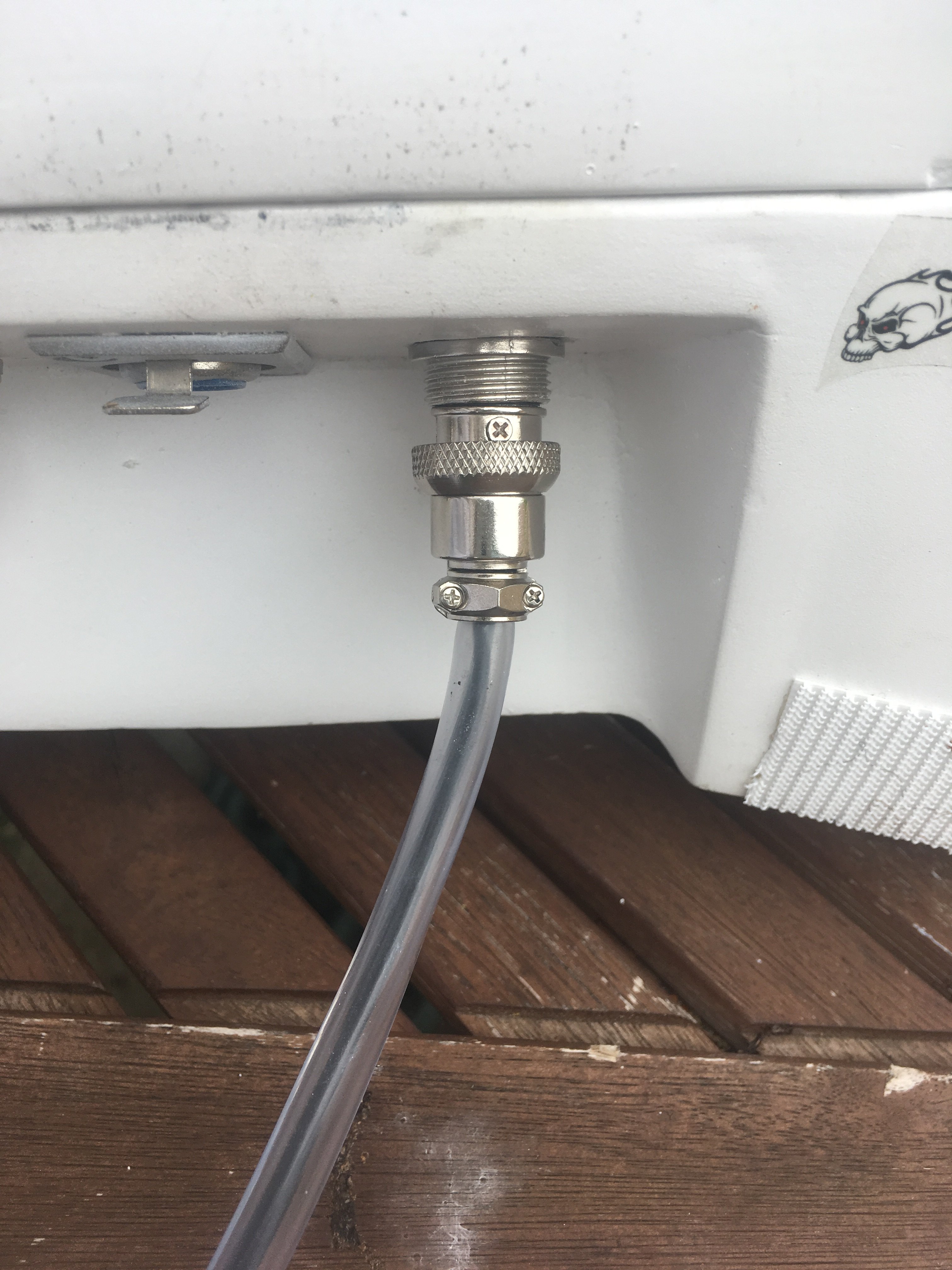

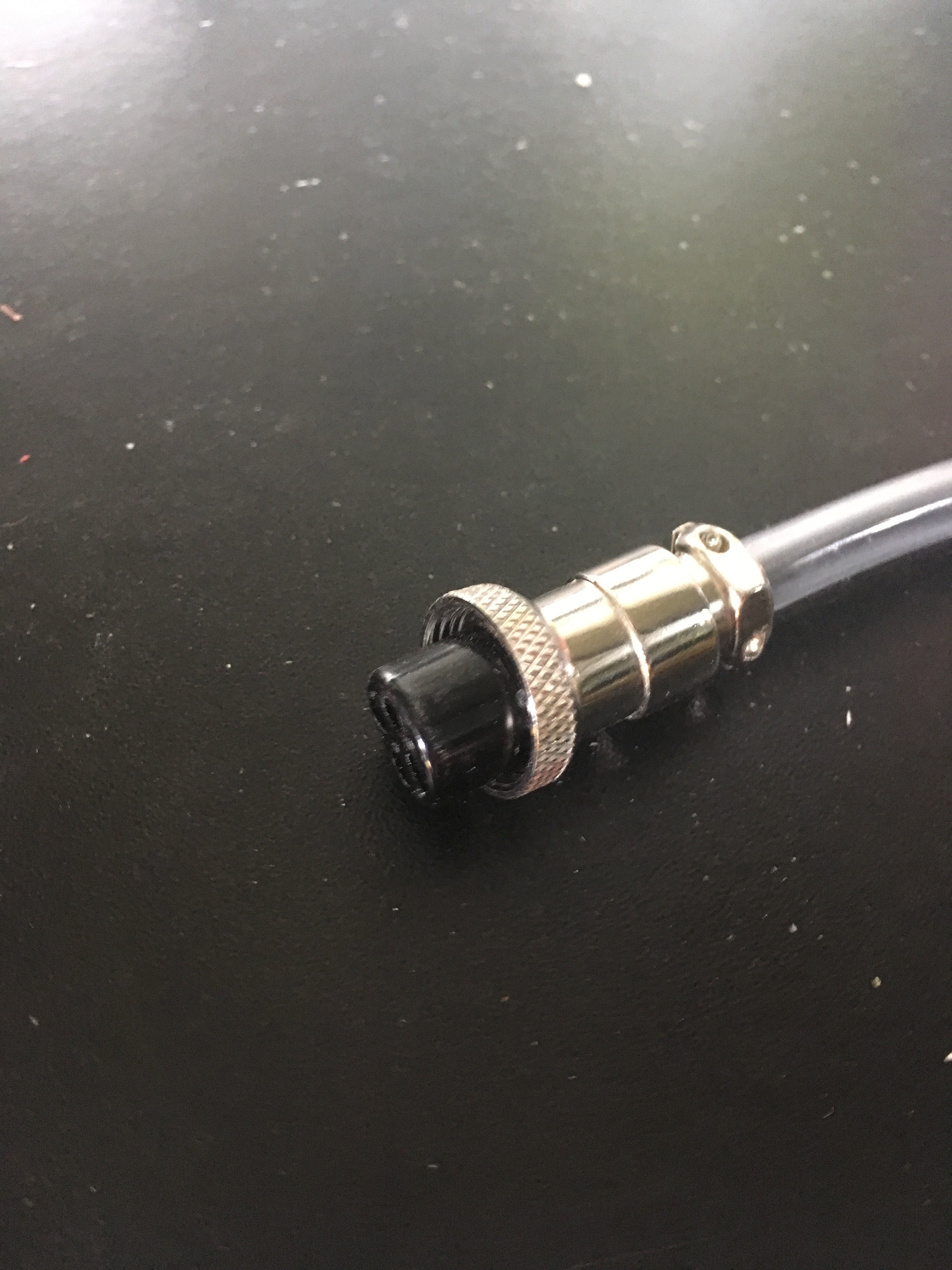

The switch is wired through the gauntlet hose, to the momentary push to make non latching toggle switch in the gauntlet. I connect it via a locking DIN plug flush mounted next to the other greeblies in the base of the jetpack.

The unit runs off two 2.5ml squirts into each port where the hoses attach. Since the below pics were taken I've secured two plastic nozzles into the unit to make attaching / detaching the hoses easier.

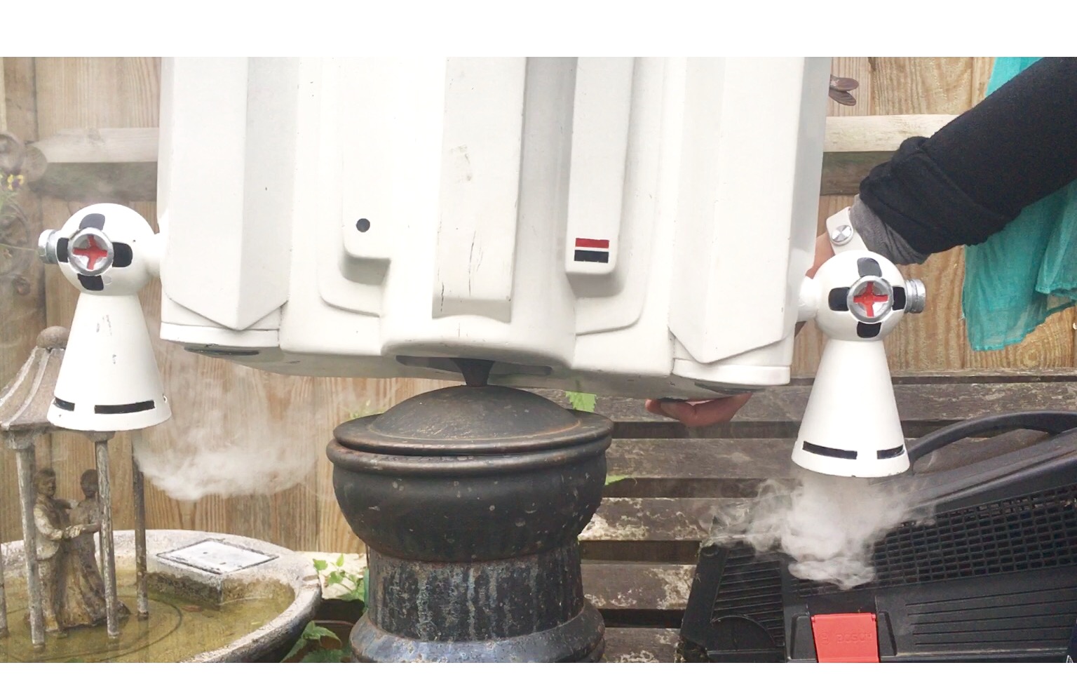

Its actually 5ml, 2.5ml into each port. That will last almost two days trooping, dependant on how much I use it. I try not to set it off in too smaller space as it's quite a full plume and a little burnt smell.
I run it in about 15-20 second bursts and that is pretty much all you need to get a good cloud and people noticing ;)
The first few spurts take a few goes to get it going but once the inner mesh is hot, and there is risidual smoke in the pack / lines it's pretty much instant mate.
