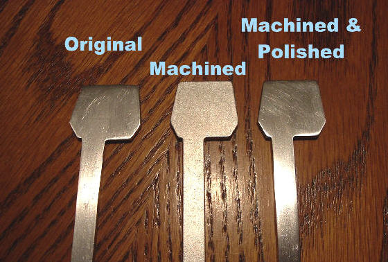

I got the stalks back from the Machine shop today. I didn't really like them at first, but when I got home from work, I put a little sandpaper to them. I sanded with a heavy grit a little, then a finer grit, and finally polished it off with some steel wool. Looks a lot better.
