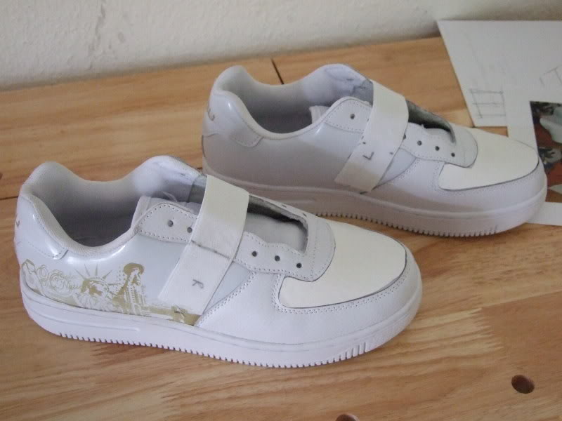

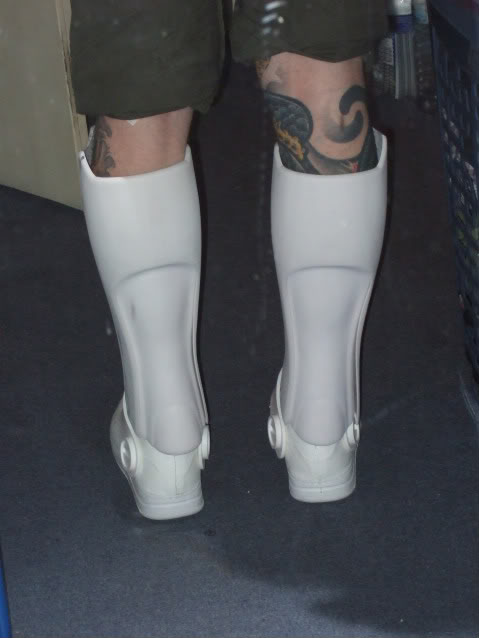

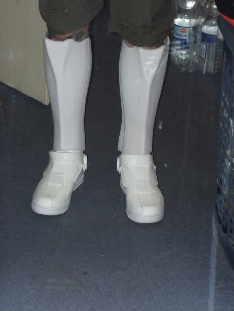

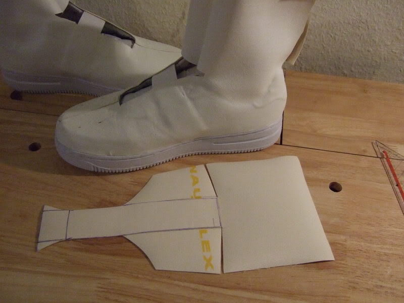

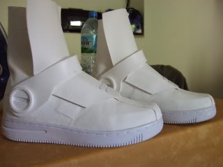

i build up the shoes by myself, as base i`m using Fubu "Skyline" sneakers with the preferred sole!!
and that`s what they look today ( but not wheathered at this point )

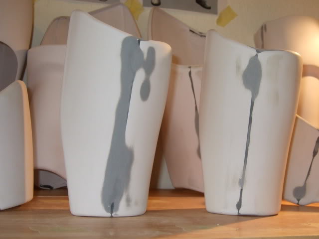

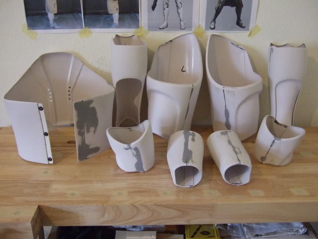

most of the parts are glued together and rough sanded
to fill up the gaps i`m usin a 2 compound carbumper repairglue, so the need of a lot bondo is not necessary!!:D
today i`m doing a little test fist of my calves after heating them up to fit in the spoons!!

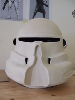

and last but not least my beehive (which needs a little more work on it )

this week i have fine sanded most of the parts and they are ready now to get primed!!

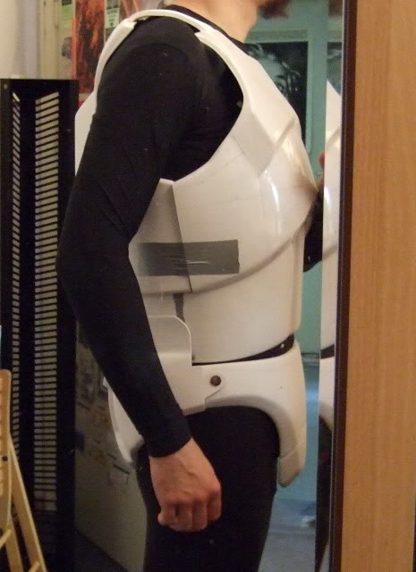

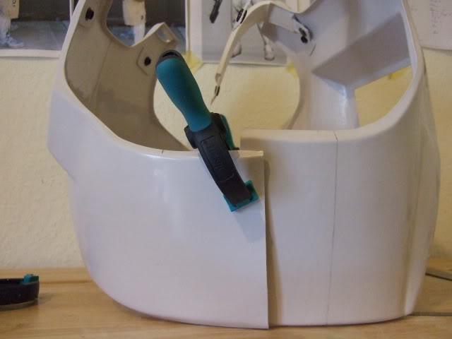

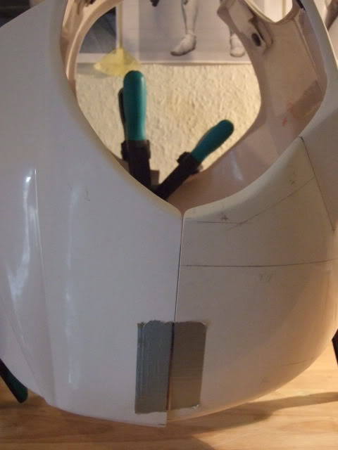

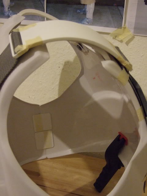

i worked on the connection of the chest and backpiece, but found out that the back was a little bigger on the curvature than the chest, so i had to cut both pieces to fit my size and ironed a new edge in the back and chest under the arm!!
( before cutting )
( after cutting and ironing the new edges )

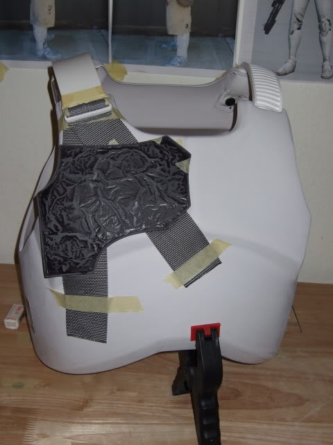

test fitting the pieces
today i begin to make a rough measurement where i have to fix the magnets
on the inside tho hold the chestplate and shoulderstrap-attachment!!

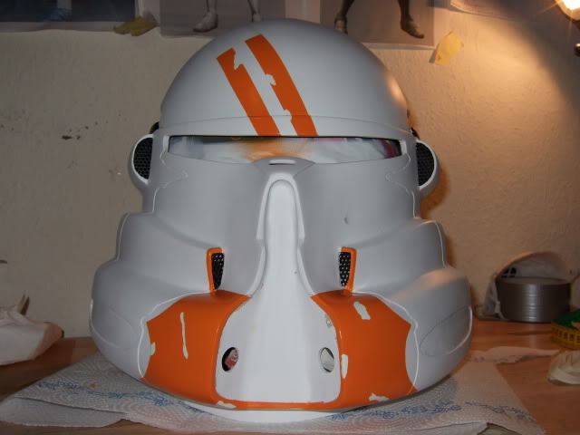

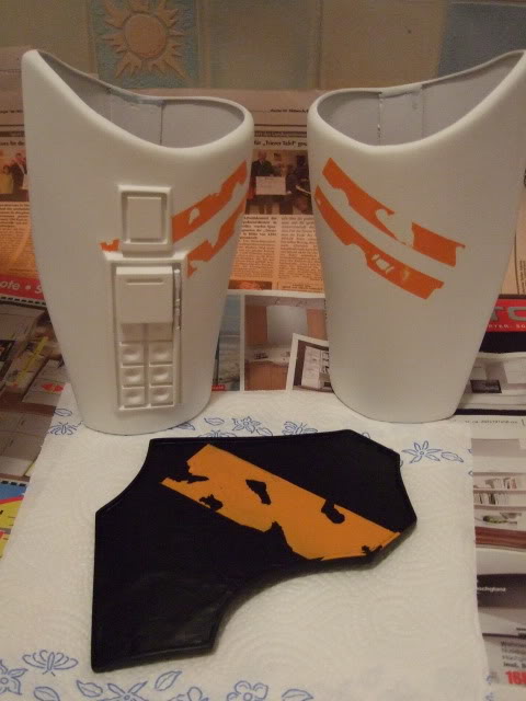

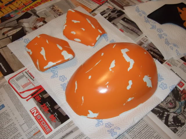

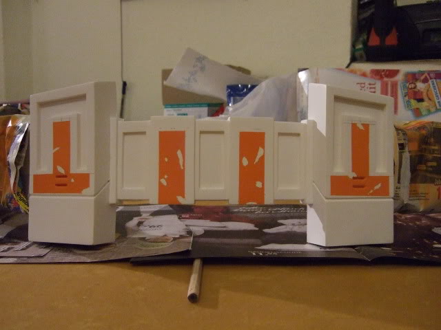

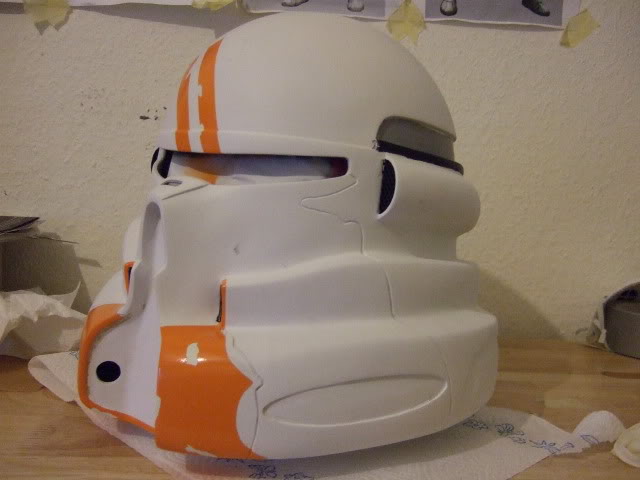

this week i finished the painting on my armor so here are the pics, but beware of all the orange you would see...:lol:
and here is my bucket...
next step will be add the greeblies on the bucket and do some small paint repairs and then begin working on the outside strapsystem!!
