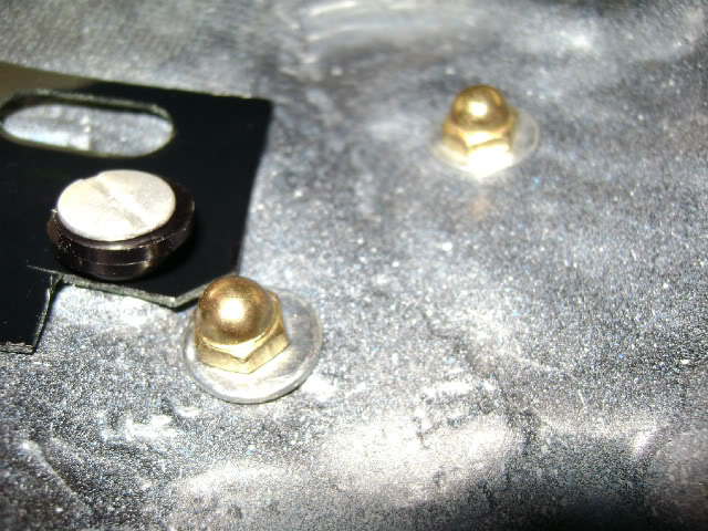

next i eyeball line it up on the helmet and use the screws to scratch into the paint where i'll need to drill. i think i used a 1/4" bit, i drilled out the spots i scratched with the screws. line the holes up with the screws and see if it sets right in. if it does, AWESOME!!! if it doesn't, then get your dremel out again and use that bit i suggested to bore out the hole a little bit in the direction you need it to go to get the screw sitting in there right.
then once the ear sits all nice and pretty you attach it on the inside with a #10 washer and a 6-32 acorn nut (my preference is for the brass, but you can get them in stainless).

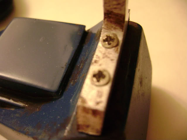

now to attach the rf to the stalk. i like to make sure it's not going anywhere, so i attach it with hardware, and using screws is screen accurate.
so i accomplish this with a couple of really tiny screws. i want to say 5-64 x 1/2, but i can't remember exactly (i'll update this information soon, since i'll have to get some more to finish all these helmets i'm working on). you'll also have to get a set of dremel drill bits and a keyless chuck, because the standard collet that comes with most dremels can't squeeze down on such small bits. i don't remember what the number is on this particular set of bits is but it has drill bits from 1/32" through 1/8".

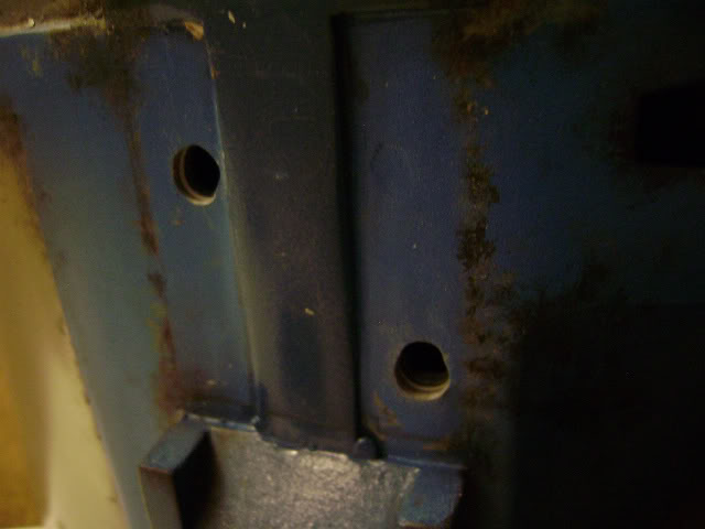

so i put the stalk in this tiny vice that i have, though if you don't have access to that you can use a pair of vice grips or slip jaw pliers and a friend to hold it steady (if you have to do it that way, make sure you're on a surface you can drill into. now drill two holes through the cross beam of the stalk, one kind of in the armpit and one a little further out. to help with seating of the screws you're going to want to get a larger bit out (7/64" or 1/8" even) and drill into the holes just a little bit so that the head can seat into the stalk. that'll help out later on when you have to grind the heads flush.
once you have those holes set you're going to line it up on your rf top where you want it to sit. hold the stalk in place and use the drill bit to mark the spots on the rf for the screws to go into. if you want you can drill into the rf through the stalk so the angle of the holes match up perfectly.
then take your little screws and slowly screw them into place, take your time with it though because they'll be cutting new threads for themselves so i highly recommend buying an extra screw just for that purpose of cutting threads. once the threads are cut take the screw out put a little dab of ca glue on the holes of the rf itself and a little dab on each screw too and get them back in there. once the glue sets those screws aren't coming back out. and finally, get your dremel out with a grinding wheel and try to grind the heads of the screws flush.
