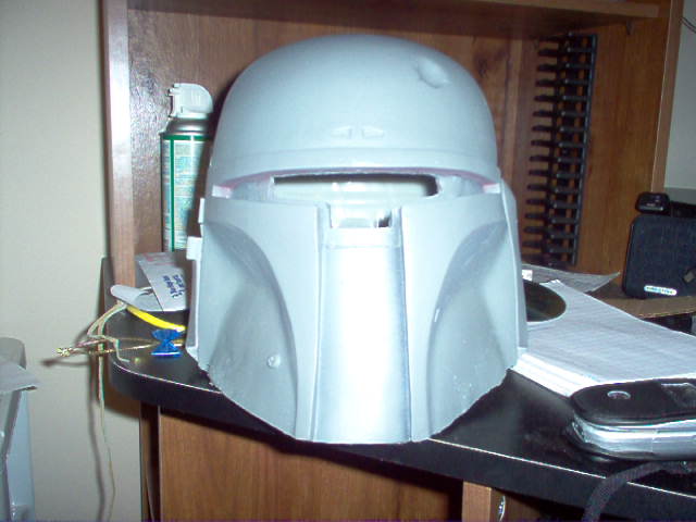

just revitilizing this section, as I am going into hard work on the helmet soon.. like.. now. as soon as i move my "work station" to the basement. heres a new starter pic, its had some minor reshaping since i first got it, hot water and towels, and it stayed like that for months until i found it again from the move (towells inside LOL) now.. time to get some 14 gauge wire and round this puppy out... and flare the sides.. and straighten the cheeks.. and bowlling ball the dome.. hehe...

Kissker vbmenu_register("postmenu_81163", true); - I returned your PM. That's not looking too bad. If you install the hoop in the back you can get it to flare properly.
Also remember, when you put the visor in you can use it to help hold the helmet in shape. Just be careful when gluing it in, and not get it all over the visor.

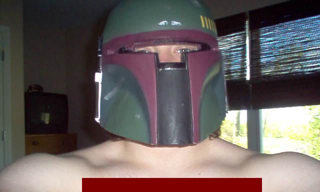

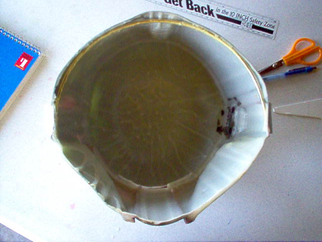

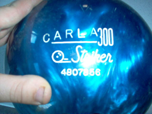

heres some updated pics of my helmet first is its shape after i slammed a bowlling ball in it.. surprisingly accurate from pics.. watch..
and yes... i plastic welded the wire in there to help its shape.. next up is rounding the dome.. wich i have an idea for using only water and gravity! (did it once already, look at last picture.. isnt it nice how more rounded it is?) gimme input!
Doing good mine was shaped with a kind of plastic peice. Looking good i'd say same type of helmet as slade even. :) :thumbsup:

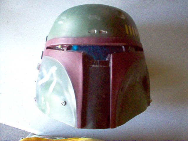

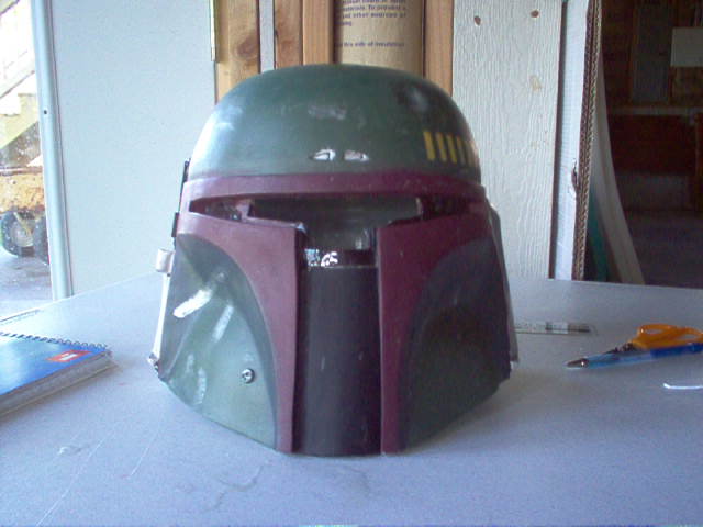

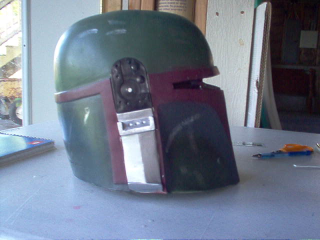

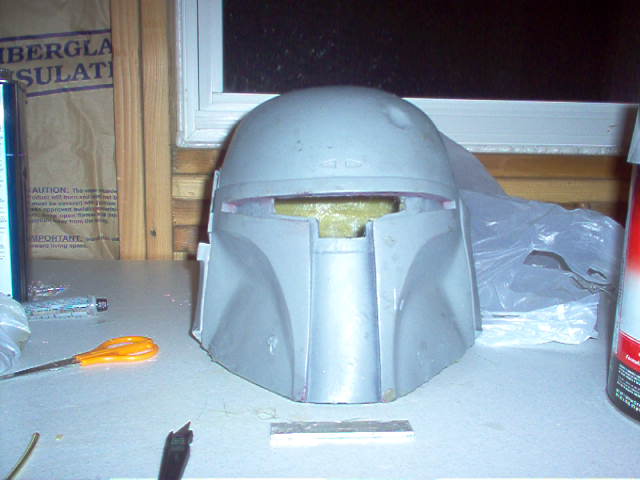

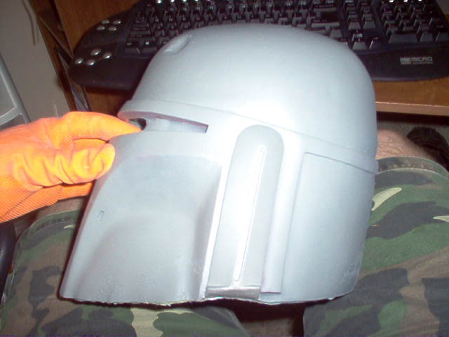

so what you all think? grey primer(got sick of rubiescolor) ntell me what you think of the shape... fiber glassing soon
cant really see it in the pics.. but i need to work the dome some more.. theres a "lump" i just found.. so back to boiling water first.
It's coming along well for a Rubies. I still think you need to cut out the front and put a real visor in though.

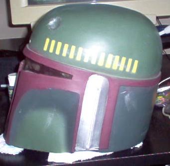

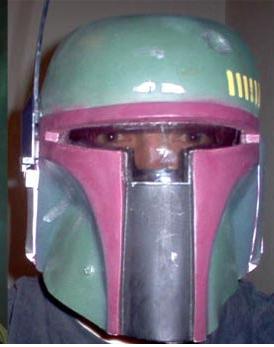

Hey guys,just signed up after seeing this thread as when I got my DP 97 I aslso was terribly dissappointed.
so I got to work on making it some where half decent,this is all I did..
First I cut that silly visor out and replaced it with some clear plastic sheet covered in car window tinting stuff and evo sticked it in!! (the t shape was just trial and error using card to get it right)
Then I simply just painted on the scatches and stuff using acrylic paint as mentioned above somewhere,I also hair driered it into shape and that was that...hope this is of some use to you :)

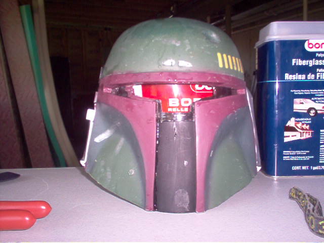

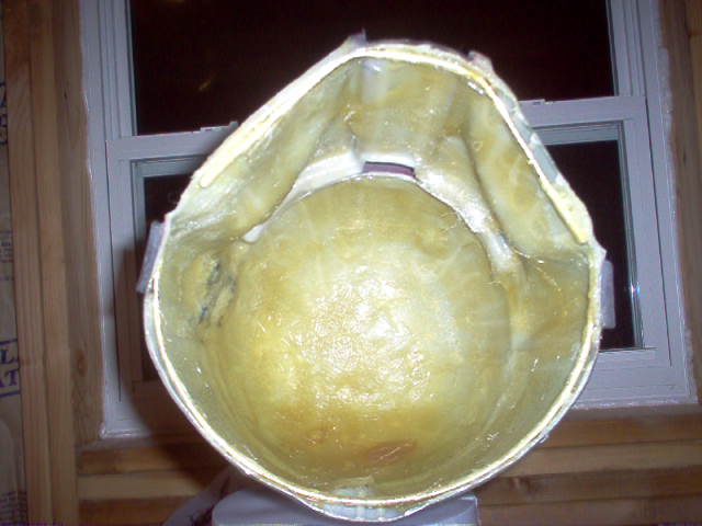

ok guys.. its terrible, iknow, but heres pictures after I mutilated my helmet and fiberglassed the inside... ugg.... so much work to do now.

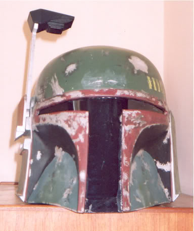

this pic isnt up to date but it shows comparison, on the left we have the real boba, and the right is almost up to date (i cut out more of the T)

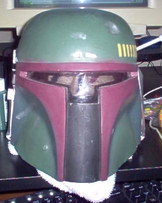

Oh yea, heres a pic to show how far its come, this is straight outta its box! ::shudders:: god it was one ugly bucket.
Wow! I am amazied at how far you have taken that thing. It looks wayyyy better now! Keep up the GOOD work!!
