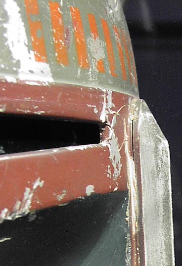

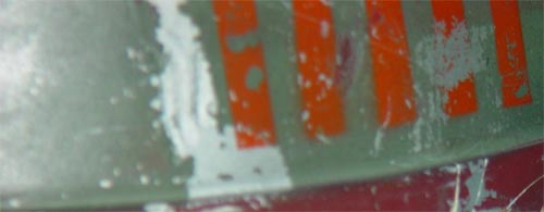

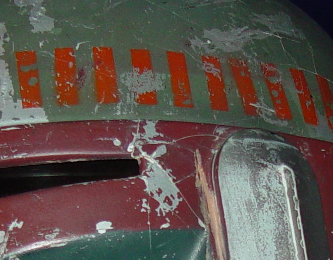

That stripe actually has a red hue to it that the orange gets close to but not quite accurate. I was at Hobby Town USA the other day and was going through there paints to find new colors to dirty my helmet with and found a great redish orange but I for the life of me cant recall the color name. Go to your local hobby superstore that has a good paint selection and in the brand that you are using, look in there section for something that maches that closely... worst case senerio you can mix that with the orange. But be carefle not to mix different brands. You can get strange results.

The ROTJ stripes always looked like an orange red to me.
