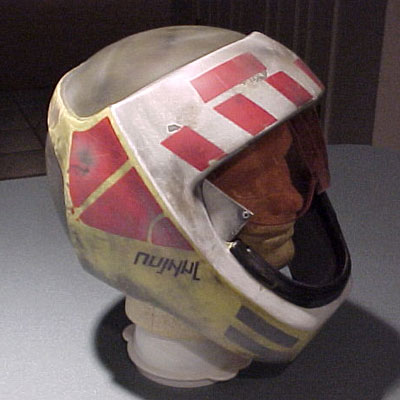

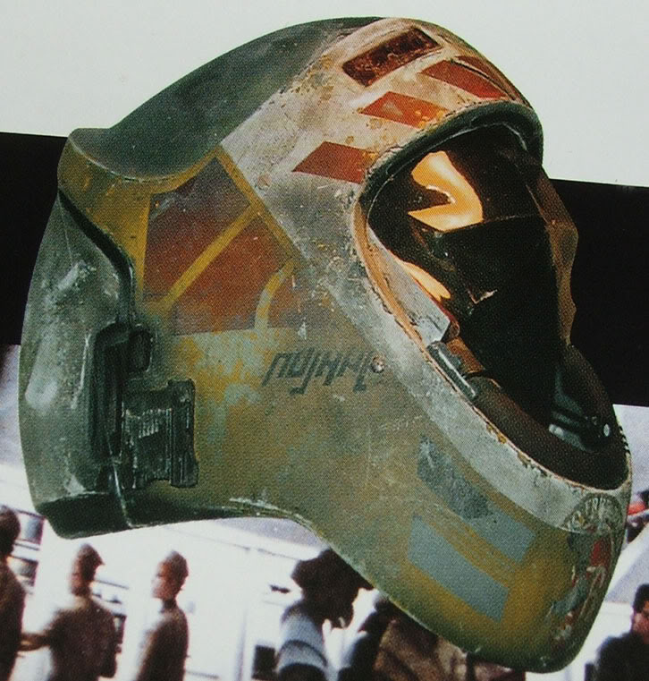

TD2253, yes that's the one! Here's a larger pic of the source helmet from ROTJ.
Desloc, not sure why they made new types of helmets for ROTJ. Maybe they just had a bigger budget. :confused

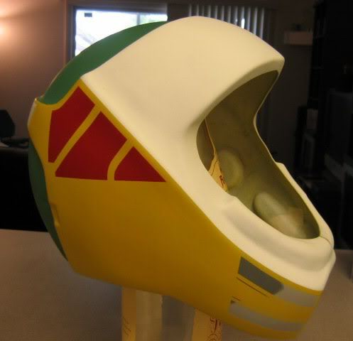

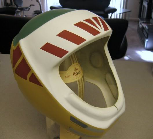

UPDATE #2: Feb 13th

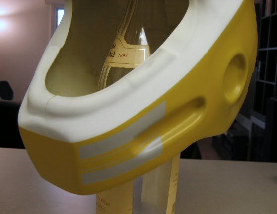

Started some of the markings. First ones are the gray stripes along the jaw line. If you look at the pic I just posted of the real helmet, you can see on the right side there's a section that's darker gray. I added some darker gray while everything was still masked off.
The real helmet is extremely dirty. Once I get all my base colors on, I'll go back and add all the weathering and scorching and chipping. You know, the fun stuff! :D

UPDATE #3: Feb 13th
OK, I can't stop. . . :lol:
I added the first set of red markings to the right 'temple' area. I'm hitting these areas with primer first so I'll get an even red tone no matter what color is beneath it. I'm using Floquil Caboose Red for my markings.
Please keep in mind that as I'm doing this paint job, it's necessary to slightly alter the shape/positions of some of these markings, as the proportions of the RA kit are slightly different than the screen-used helmet. I'm trying to keep the overall proportions/spacing of the markings as close as I can.
Next will be the red stripes over the forehead area.

Ben, nope, not doing any helmet stands. ;) That's an Asbach bottle from when I was stationed in Germany. It's my "change jar" now. :lol:

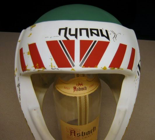

UPDATE #4: Feb 13th
Whew! OK, this will be it for today. I got the forehead stripes on. Again, I masked everything off, then hit it with Tamiya primer, waited a while, then sprayed on the Floquil Caboose Red.
Tomorrow I'll start on the weird script on different parts of the helmet, then the basic painting will be done! :D I've already primered the greeblies. They'll receive their basic color coat (very dark gray) then they'll be attached for the weathering phase.

The only thing I would point out is the gray stripes are a bit long comapred to the original. But it still looks awesome.
What are you going to do about the chin? Looks like the original had some sort of patch or logo on it.

Well, as I said in an above post:
And as far as the chin goes. . . wait till tomorrow! ;)

UPDATE: Feb 14th
OK, these pics show work I did from last night through a little while ago. I meant to take some in between pics, but I was just having too much fun.

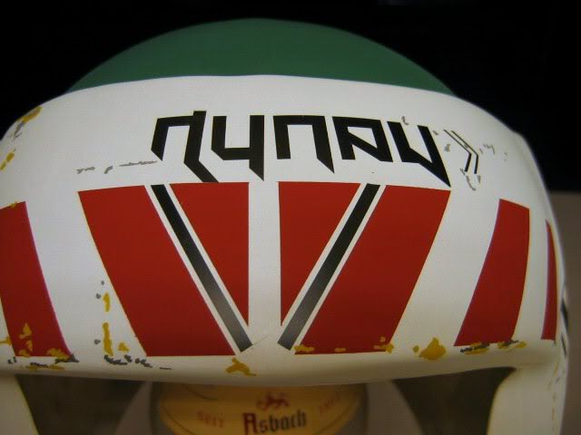

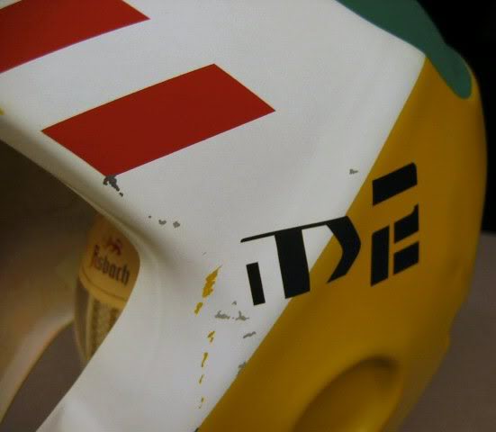

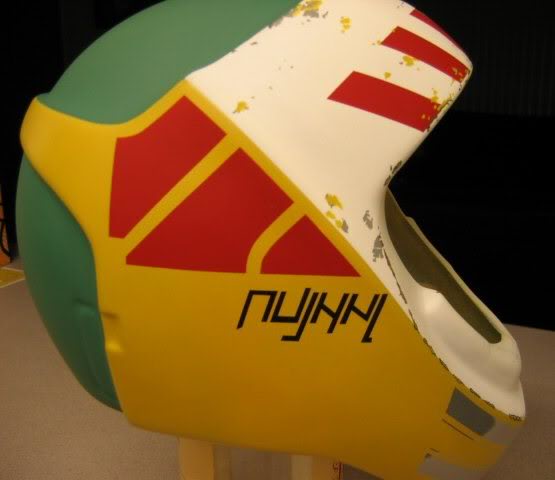

I had some left over black vinyl from another project, and I used it to make the "Aurabesh" script and symbols that are seen on the helmet. On the left temple, it's just a couple of strange geometric symbols.

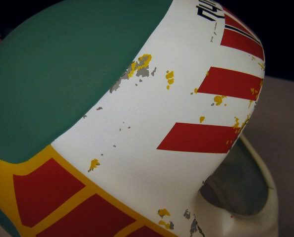

Here's a closer shot showing some of the chipping. I'm using good ol' Zinc Chrom. Yellow and Reefer Gray. Some areas have a darker gray and for that I'm using SP Lark Dark Gray.
On the right temple, there's some script. Again, I hand cut some black vinyl and laid it on.
Here's some of the chipping done above that area. Once the weathering is completed, it won't look so stark against the bare white.

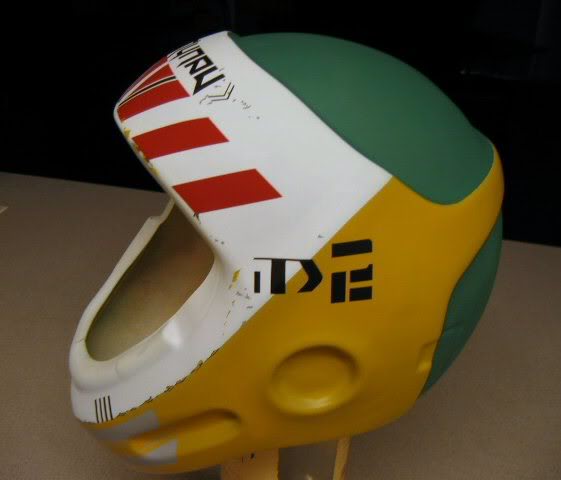

Across the forehead there's more script. Just to its right (as you're wearing the helmet) there will be a raised dark red rectangle. I'll make that out of some sheet styrene and glue it on once it's painted.
I also used black vinyl to make the thin black stripes in between the red stripes. More chipping here.

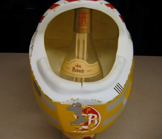

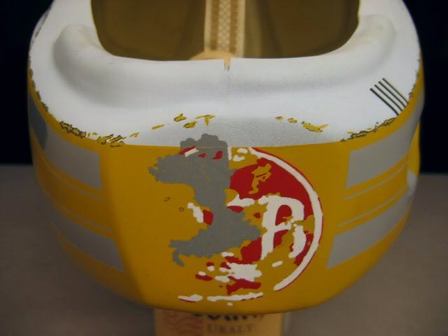

On the chin of the screen used helmet are the remnants of a sticker. From what I've read it's a "Radio Free Bolinas" sticker that came from an old pirate radio station in Bolinas, CA. I've seen a graphic of the complete sticker, and there's a big white "RFB" on a red background with Radio Free Bolinas in a curve around the top. On some photos of the real helmet it's plainly visible. I used one of these pics to trace a stencil and just painted it on there.
It will still get some more weathering and some color variation. I'm not sure if I want to add the "Radio Free Bolinas" lettering around the top or not. . . with all the other script on there, it sort of seems odd to add wording that's so clearly readable. I may do it, I may not. So there! :lol:
Closer view.
This is a fun helmet to paint!
