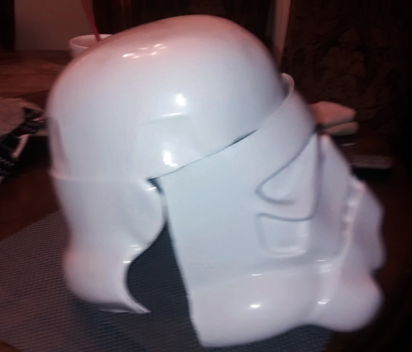

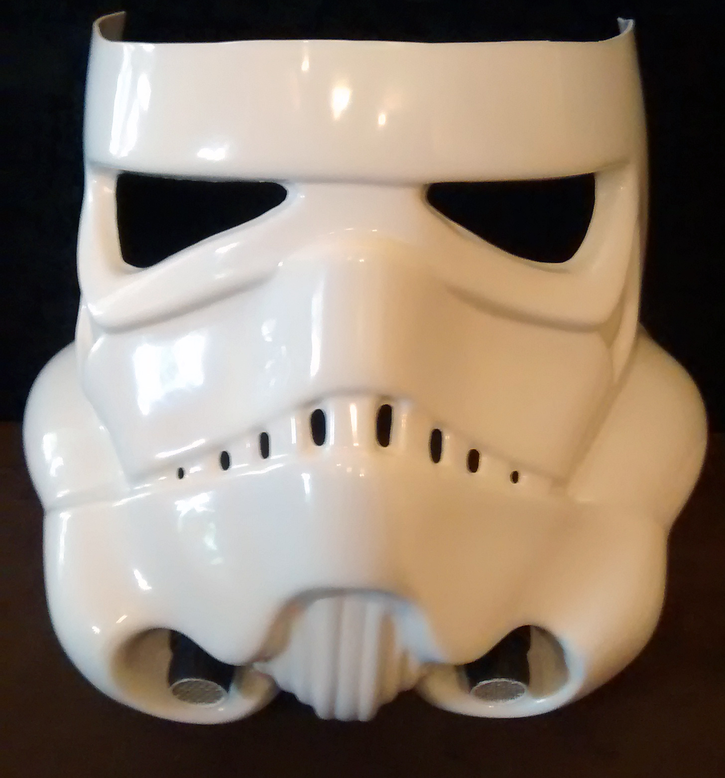

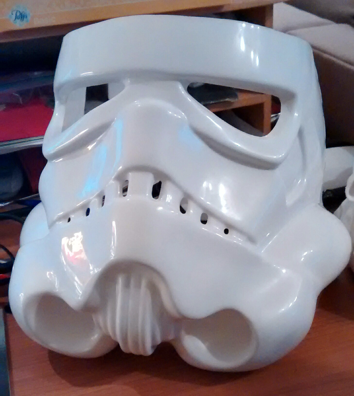

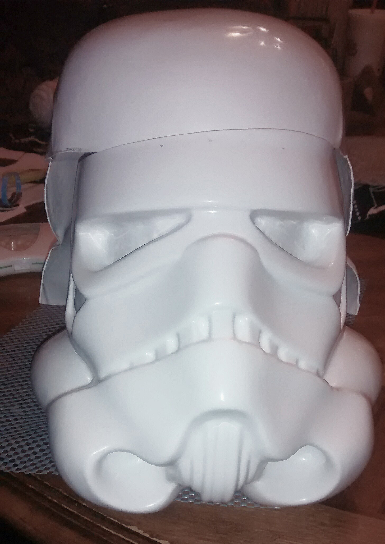

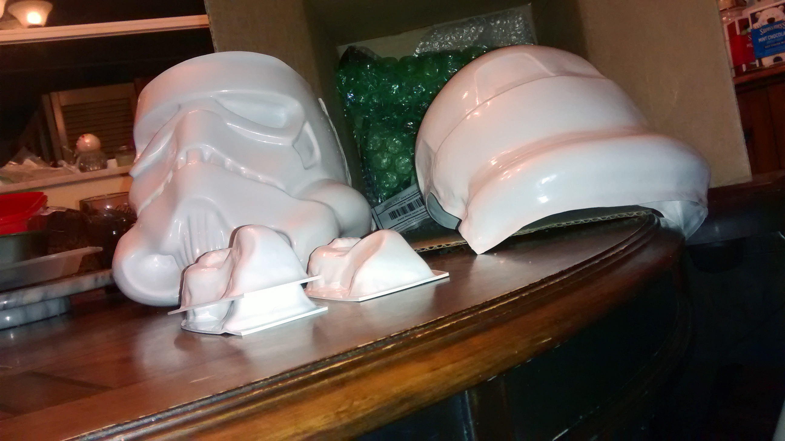

Some pictures of work on the helmet kit. Tell me what you think so far. Also, Is it a bad idea to use snaps instead of rivets to attach the front to the back?

Wouldn't use snaps for that. I'd clamp with neo magnets and roughly locate the ear piece to help placement of these fasteners/. You need to drill holes (size depends on your rivets, but usually 1/8"), and either use pop rivets or screws/washers/nuts. If you use rivets, makes sure you use a washer on the upset side of the rivet to prevent it from pulling thru the plastic. You only need one fastener per side for this part, and locate them where they will not interfere with the fasteners later for the ear pieces, and will be covered up by the ears. Tons more info on First Imperial Stormtrooper Detachment (FISD) if you need more info than I'm giving.
Looking good! now put that pup together brother!

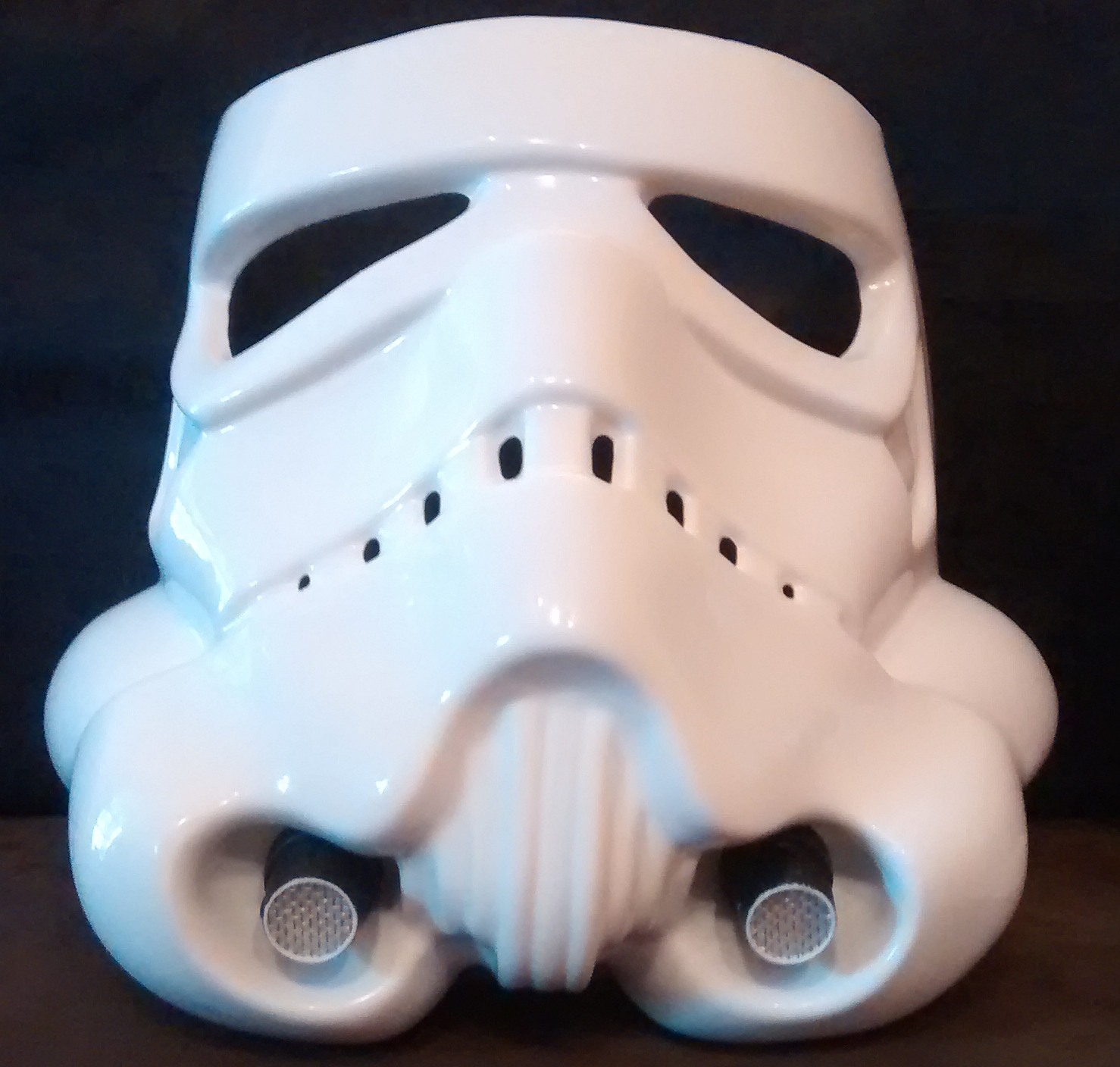

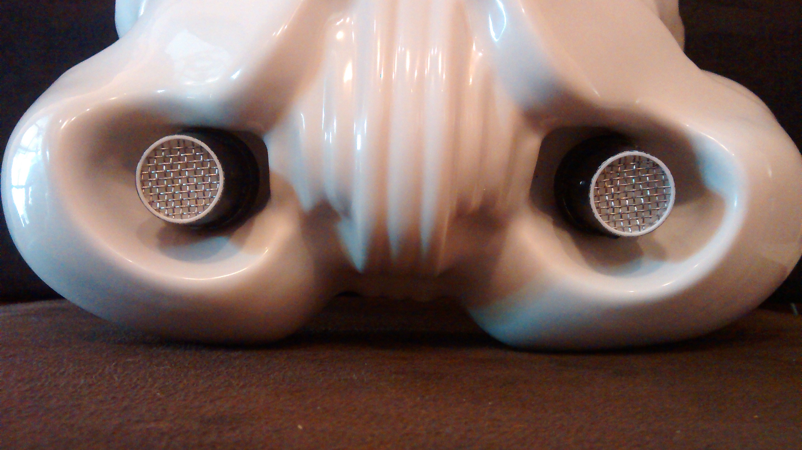

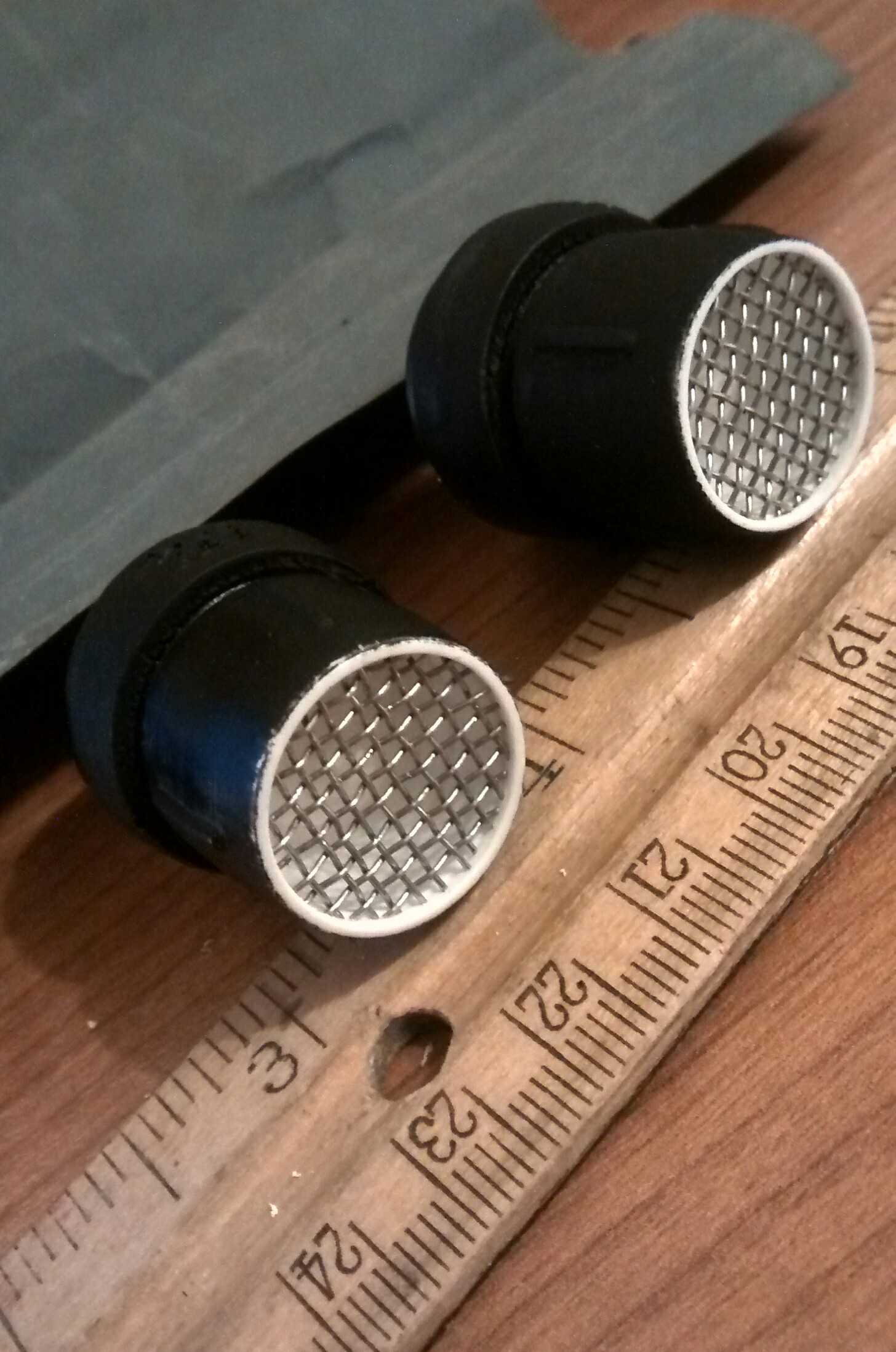

Thanks for the informative reply syllander. Today I installed the mic tips onto the helmet, does it look correct? (looking down the mic tips look strange to me, they also wont totally slide in, the back of the mic tip hits)
(Edit: When you drill the holes for the mic tips, i used an exacto knife and spin it like a drill, it will drill through, and not break the fragile plastic.)
Looks good brother. The screen used ones were all over the place.....I'd compare the teeth with some good screen shots. Looks like you still got a little trimming to do there, but no big deal there.
