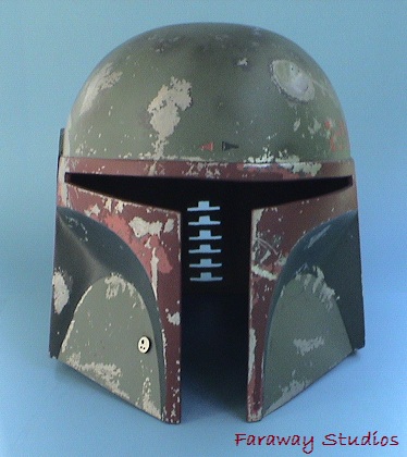

Look here, a photo from the session for the PP2 costume and the original prop photographed more recently. I see more blue in the original studio shot. That is what I like.
Boba Fett Second Prototype Helmet - The Dented Helmet Gallery
The PP2 dome/cheeks are more heavily misted with gray, so I think that's what is showing

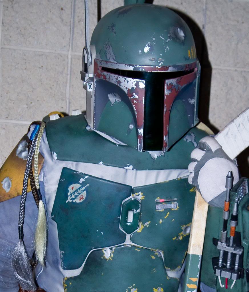

My right chestplate on my ESB may be close to the color you're gunning for. This was done using Rust-oleum Satin Spruce Green, Rust-oleum Hunt Club Green, Valspar Satin Indigo Streamer, and Rust-oleum Dark Gray Automobile Primer.
The two colors I used most were Spruce and Indigo Streamer. I misted them back and forth and kind of created a wet film for the colors to blend since the spray can mist wasn't fine enough to blend on its own. The rest of the colors were used sparingly for color variance and weathering. I didn't have any problems with mixing paint brands but you should try some swatches just to be sure.
Front Finished.JPGModel Master Intermediate Blue. That'll do the trick. That's the PP2 commission I did last year. I added a light misting of MM Intermediate blue to it. The blue background kinda washes the blue hue out, but it's there. You may want to go a little heavier to achieve the look of the photos.
View attachment 75682Model Master Intermediate Blue. That'll do the trick. That's the PP2 commission I did last year. I added a light misting of MM Intermediate blue to it. The blue background kinda washes the blue hue out, but it's there. You may want to go a little heavier to achieve the look of the photos.
Yep, very close to this. I guess I see so many paint ups that the green is way too bright and I want to stay away from that. That photo above with literally just a TOUCH more blue and I will be thrilled! After seeing the swatch for the intermediate blue, I think it will work perfect. It will grey it up slightly and has just a tone of blue in it.
