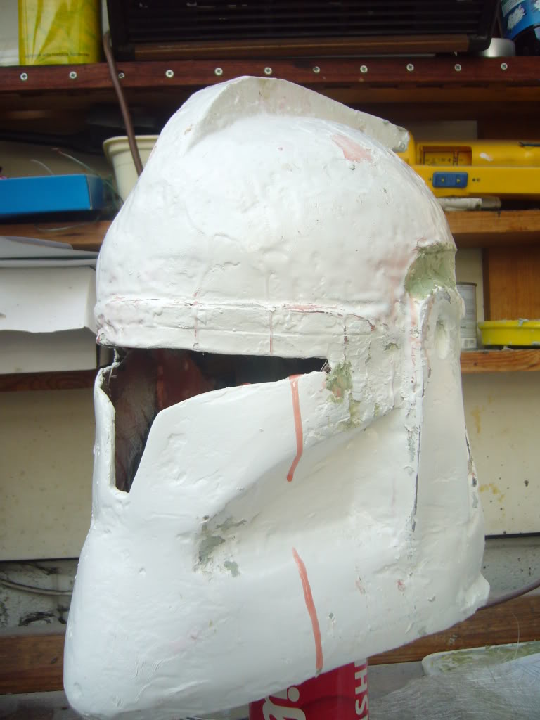

Have hand-sanded the bottom section(near the mouth) to try and see if all you guys were right.The answer was Yes.:Dpatience.The area is starting to appear shinier.But if i wanted a copy of it,i would have to make my own mould?

that makes sense,but what do the guys who sell armour on ebay use to make copies,silicon?
armor and helmets are usually different.
helmets you usually make a silicone mold then produce the helmets out of some sort of resin.
armor is usually vacuum formed plastic, pulled over a positive that you make out of something durable (plaster, wood, etc...)
in addition to the numbers above, there's a cost for resin too... around 20 - 25 US a helmet.
it's a LOT cheaper to buy a helmet than scratch build / mold / cast. the latter only makes sense when you plan to make a bunch of helmets.
Do you guys thik i should continue with the build or just save some coins and get an efx helmet.But are there any shops,sellers that sell their casted helmet.I was almost excited when i found star fotress,but now distrust them from comments.By the way,why don't everyone vacuum form their helmet?(sorry abt asking too much questions).Ayway,back to the main topic,should i continue,or is it to sh~~ to continue
You can't vacuum form clone helmets. vacuum forming doesn't grab hard angles, to do that you need to cast a liquid into a negative mould. There are a few people that sell copies of clone helmets. They usually start at around the 200 usd mark. If all you want is a clone helmet, just buy one and paint it. If you're interested in learning to make things, stick at it but bare in mind it can take years to learn. I've been messing around sculpting things for around 8 years, before my sculptures started looking right, I had a lot that looked aweful (not that there isn't still a lot of room for improvement)
you don't really vac clone helmets because you can't get the same level of detail as you can with silicone. plus, you can make it all in 1 piece, rather than several. i've seen some vac formed clone helmets and they all have looked a bit marshmallowy.
stormtroopers / tie / at-at and the like are vac formed in pieces, just like the originals. but they have softer features than the clones anyway.
as for whether it's worth doing... that's up to you. are you having fun? if so, keep at it.
