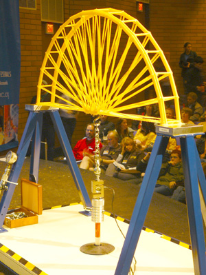

Here's a couple of good designs.
This one is a good representation of a lightweight structure with great strength.
This one is basically a hollow brick. If there are no rules about the amount of pasta, or weight of the structure, the brick is a good, simple one to go with.
