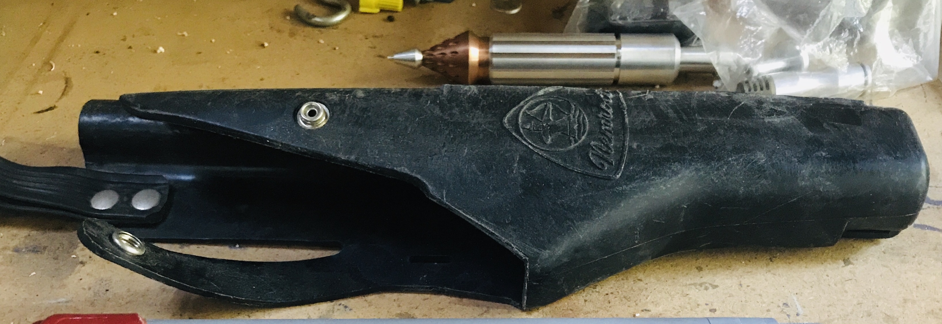

I just realized a year has passed since I started this thread on 3/25/20 with the conversion of my pulce 40. So it's appropriate that I put the final touch on that part of the costume this week. Although its always great to have a found part, my original Nemrod holster was looking pretty rough. It was maybe 20-30 years old or so when I bought it and it obviously saw many years of use. Which showed. Lots of scuffs and scratches all over. The screen-used holster looks pretty clean and spiffy from the few photos we have of it. The Nemrod holster might be one of those found parts where you're probably better off with an excellent replica that looks new and not so roughed up unless you're lucky to get a real one in excellent condition. I felt mine needed a make-over. The best solution I could come up with was to polish and buff with black shoe polish.
Before (a year ago):
And now:

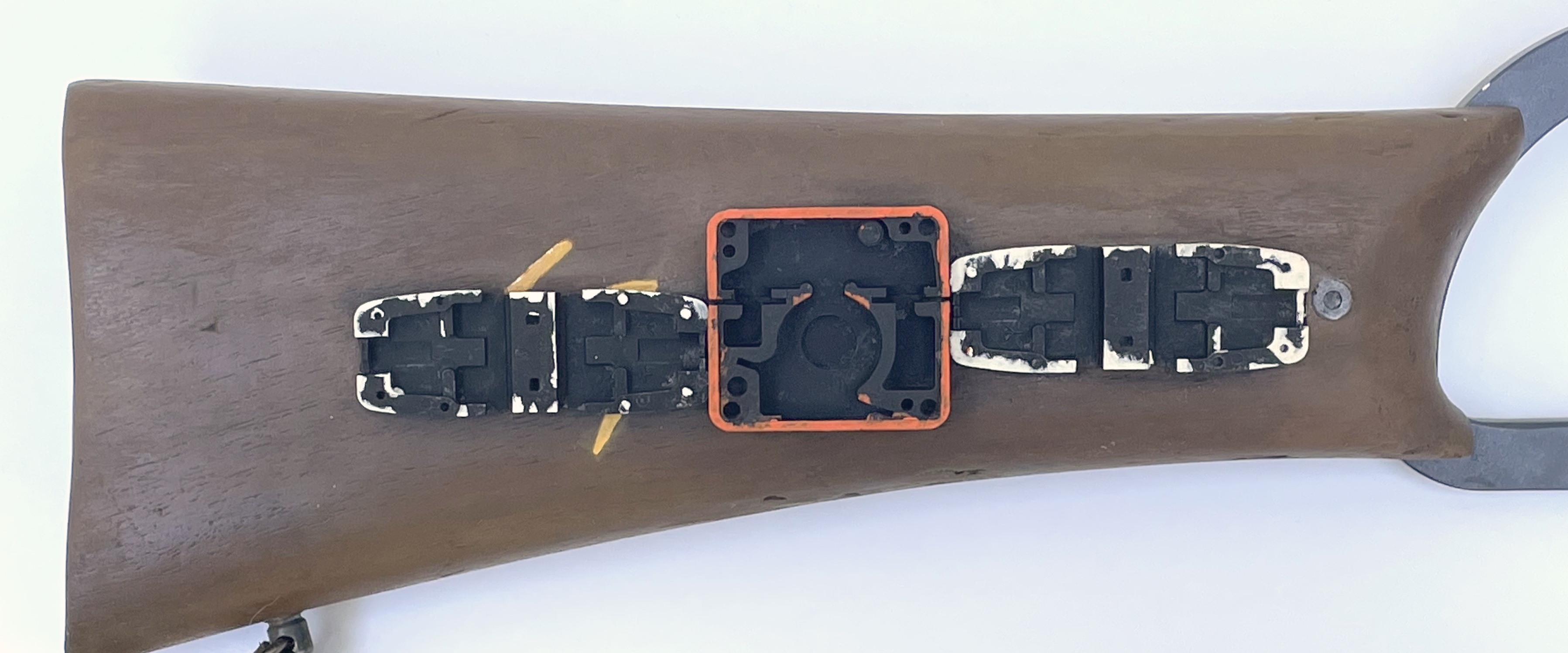

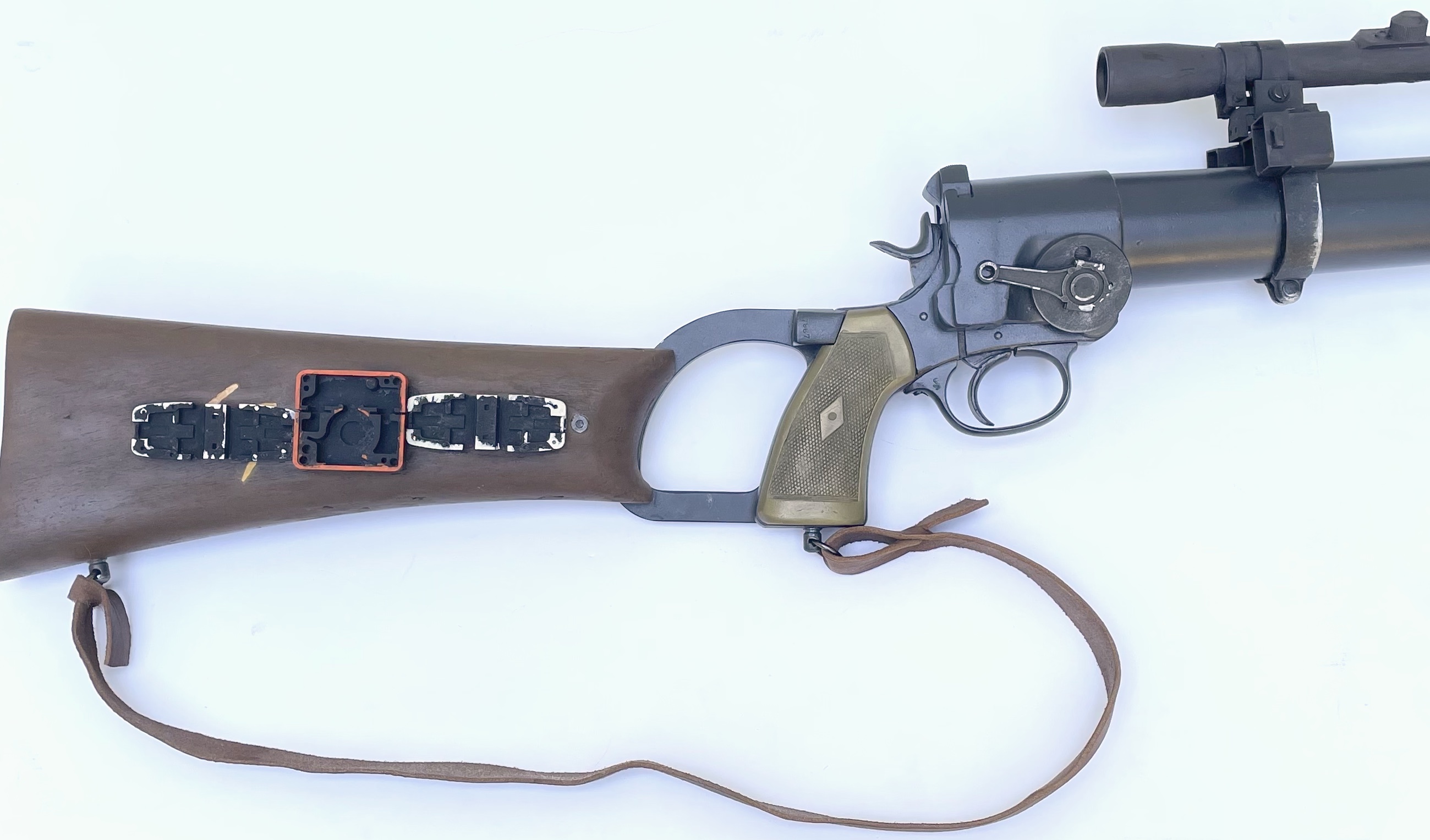

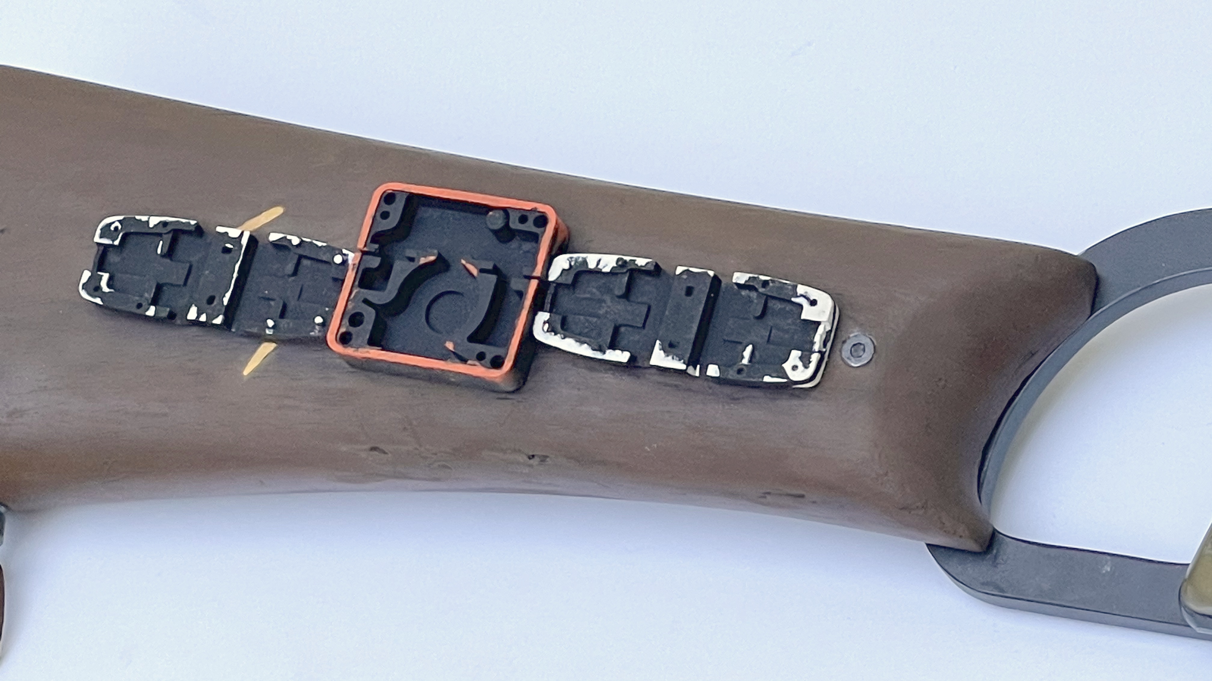

I finally got around to painting the "67" on the EE3 stock. Which is not a big deal, except the task list on this costume just seems never ending. o_O
I imagine most everybody knows about the '67' (or '69') little detail by now, if not this is a most excellent reference. I know this detail was first discussed many years ago, but I have no memory of who first pointed it out. I can't find any of the old discussions about it.
Anyway, as I was looking over this pic, I finally realized something ... and it hit me like a bolt of lightning. I know this is not news to many folks but I'll act as Captain Obvious for those like me who always thought the weathering on the aerial plugs on the EE3 stock was silver paint (unless, of course, I'm the only one!). It's not silver paint. In fact, it's not paint at all. Somehow I got it in my head a long time ago that it was silver dry brushing and never gave it a second thought. What I finally realized looking at a hi-res close-up, the weathering is just simply where the paint has rubbed off the plugs. It's just the color of the raw plastic. As soon as I realized that, I was like... "DUHHH." The orange/red on the unimax switch box is the same situation and I already knew that. Oh boy. What a genius. My only excuse is that the hi-res picture I was looking at wasn't available when I first formed my impressions of the EE3. :unsure:
Unfortunately I sold my real aerial plugs (above) last year at the same time I sold my webley. But I had them for ten years and remember how they looked. They're made of a generic off-white plastic. So I would have to replicate that color with paint. Not as good as scraping off the paint on a real one but perhaps someday I'll get some real plugs again and be able to do that. For now I just mixed up some Archive X Depot Buff with a little white and that looked good to me.

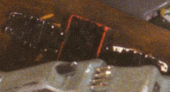

So I wanted to capture what the stock greeblies looked like during scene 371, and thankfully there is at least one decent photo showing them, albeit b&w. You can even see the '67' pretty clear, too. The weathering is a lot more than the early promo photos, which makes plenty of sense given that it's actual real weathering, not painted-on weathering.
I used Floquil TTX Yellow for the '67' marks.

cool! will use this info for my sidewinder kit!
100% with you on the Ariel Earth Plug weathering...Those 'scratches' I always thought were the white plastic too...
Its too bright to be Silver which is...debatable...because a lot of people have done it that way..never looks 'right' to me though.
There's also lot of debate as to what the 'silver' collar studs actually are too but they are clearly white if you look closely. They are believed to be the Super Trooper's raw white.
I too think it may have just been normal paint wear over filming, maybe not entirely but id say the majority.
I reckon that's simply from how Jeremy held the rifle. He usually covered the right gauntlet over the stock which would obviously cause a bit of friction. Doesn't seem to be any Primer applied either, looks to be the same jet black paint used for the gauntlets and laser.
Loving the progress so far, one of the most fun ESB builds I've ever had the joy of watching come together.
Agreed.

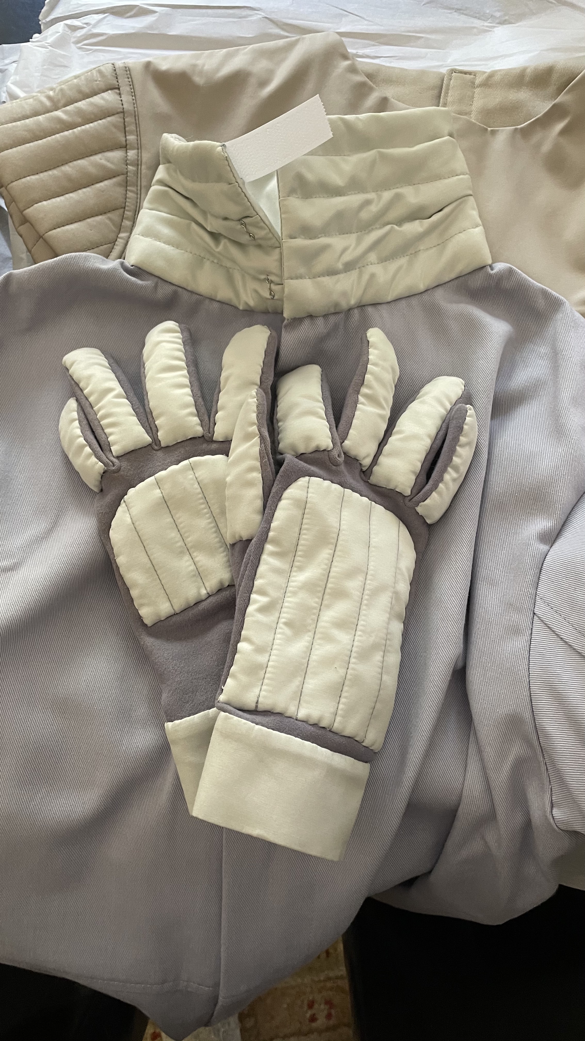

Excellent. Thanks. I've really enjoyed having this project during the pandemic. I probably should've been doing other things but I needed to do something with my hands for a change. The suit from Clothears is arriving soon, and I have some other new stuff to share soon that I think will be interesting.
Is this V1 or V2?
I don't know about the official version numbers. All I know is I spent several months going over changes and improvements I wanted before I gave the go ahead to proceed with the commission. They were wonderful to work with and accomodated me on pretty much everything. So this suit has a number of changes which has not been previously available. I'll post about the discussions we had and the changes that were made as soon as I get a chance.

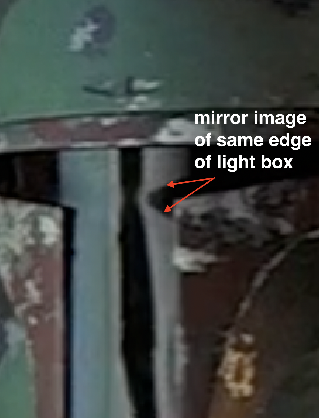

So one last thing for the helmet exterior before I send it out for paint. And that's to get the visor exactly the same shape and size as the real helmet. Or as much as possible. The purpose of this is to maintain the helmet's proper width, especially the 'flare', and to have light reflect off the visor as it would the real thing.

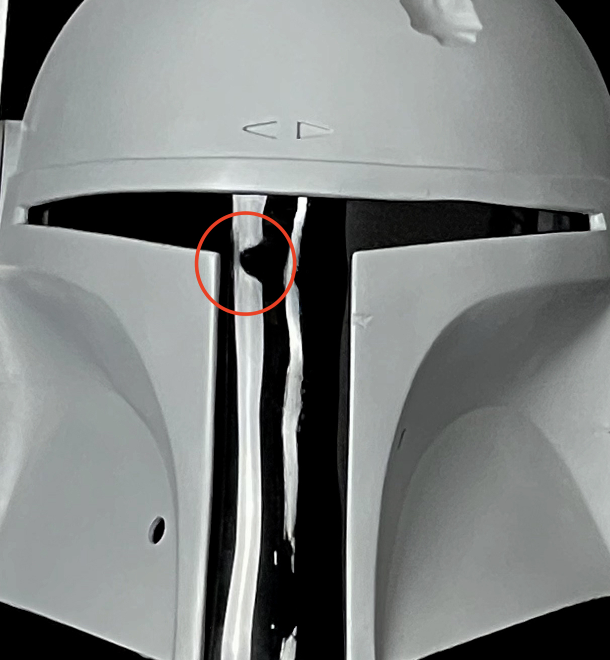

The ESB visor has a peculiar shape with a concavity near the top at eye level. This causes an up/down mirror image reflection in that area.

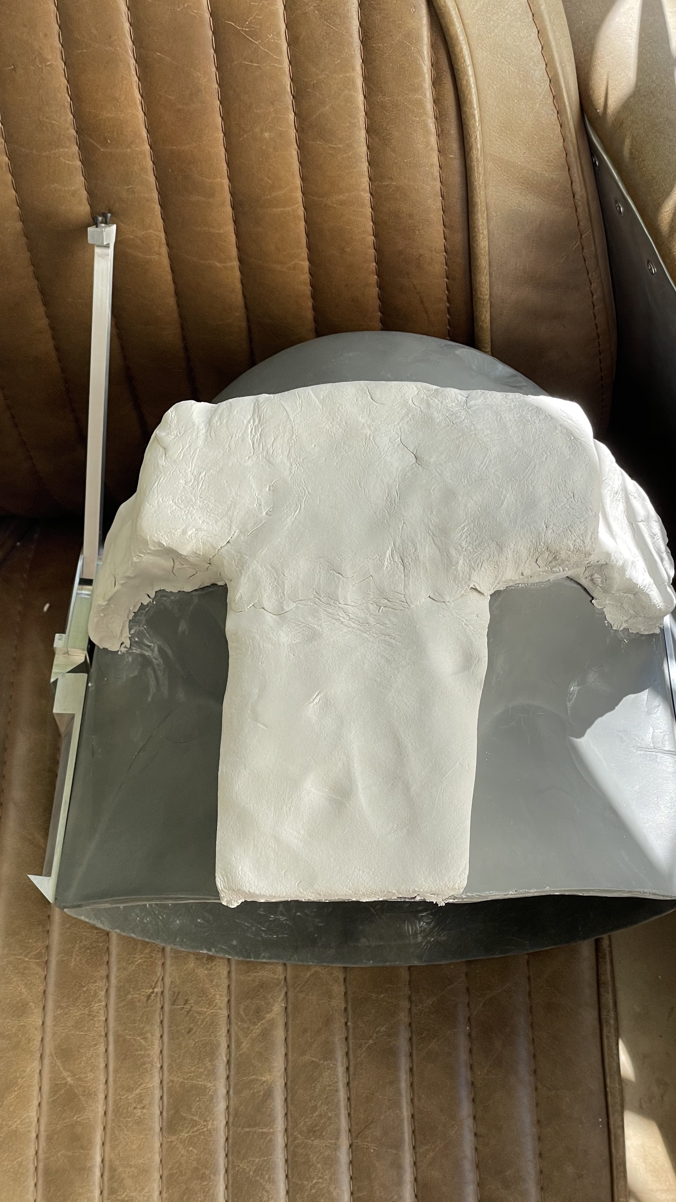

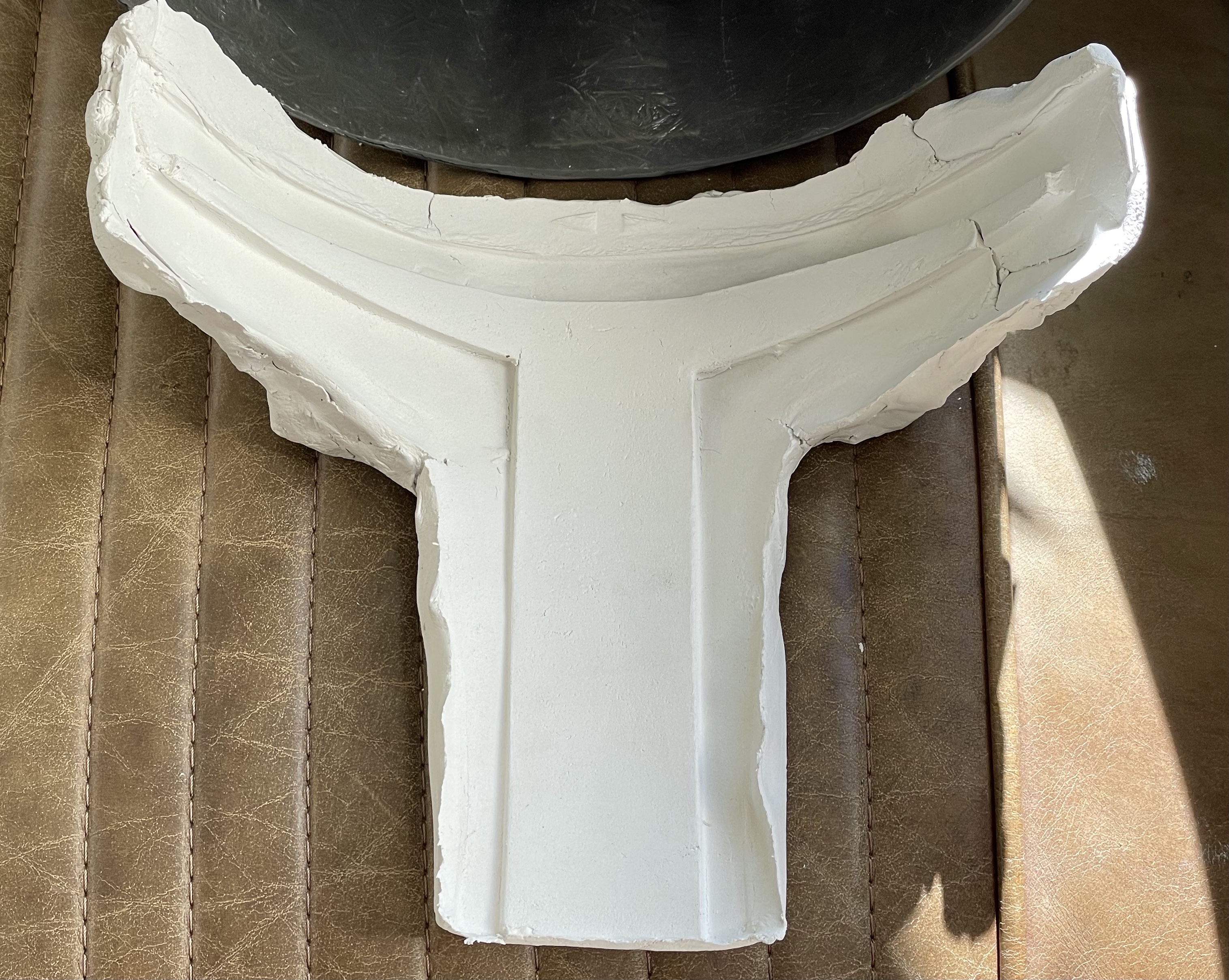

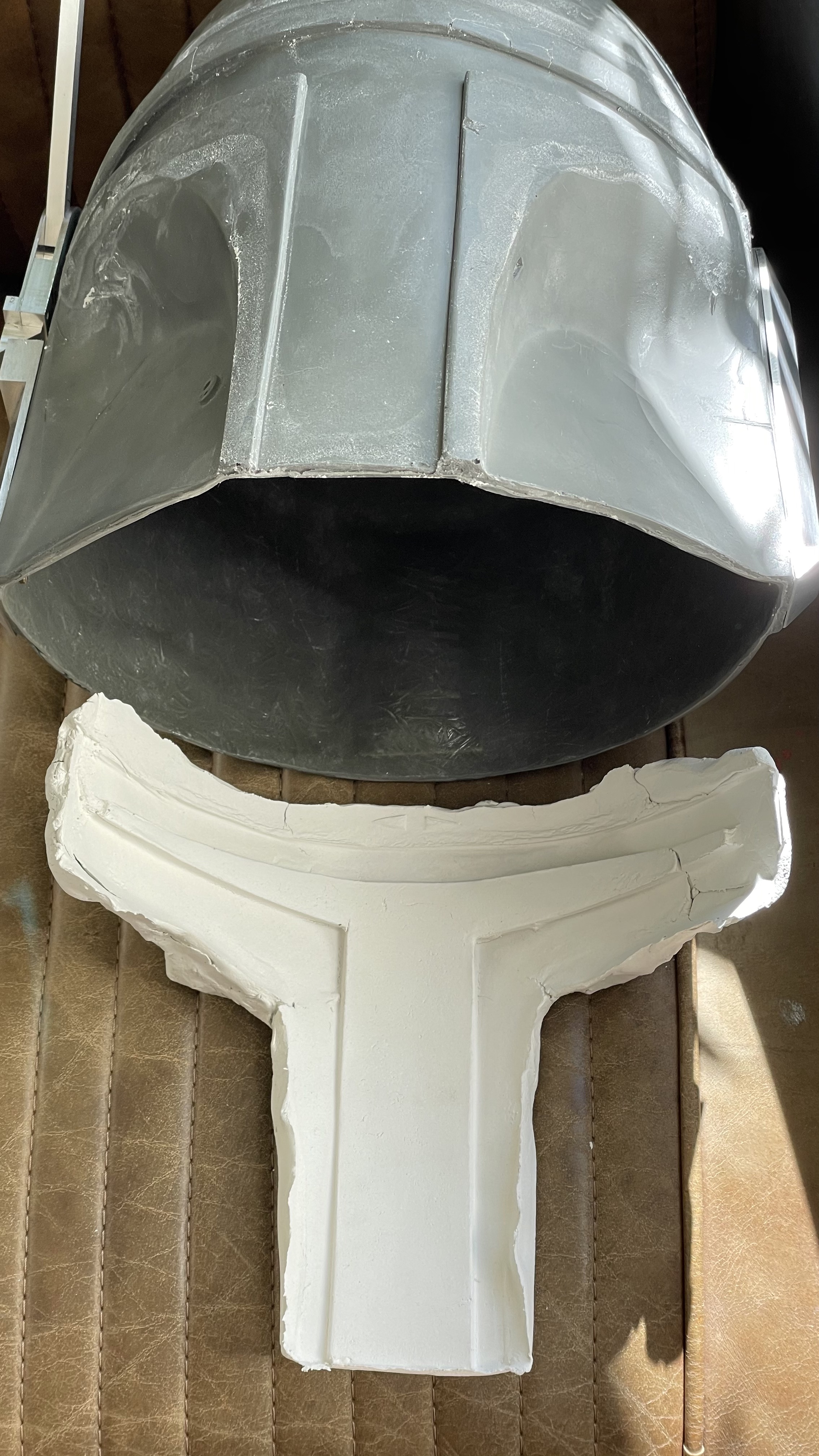

To copy this exactly required making a mold of the visor of an untouched G2. My first ever mold, in fact. It was simple to be sure, and I had fun learning. I tried two different approaches. The first was extremely simple. Just take an impression with self-hardening clay. The second, was to build a silicone and fiberglass impression. The first one actually resulted in a better mold for this particular purpose.
It didn't have to be perfect or record fine surface detail. It just had to capture the surface shape.

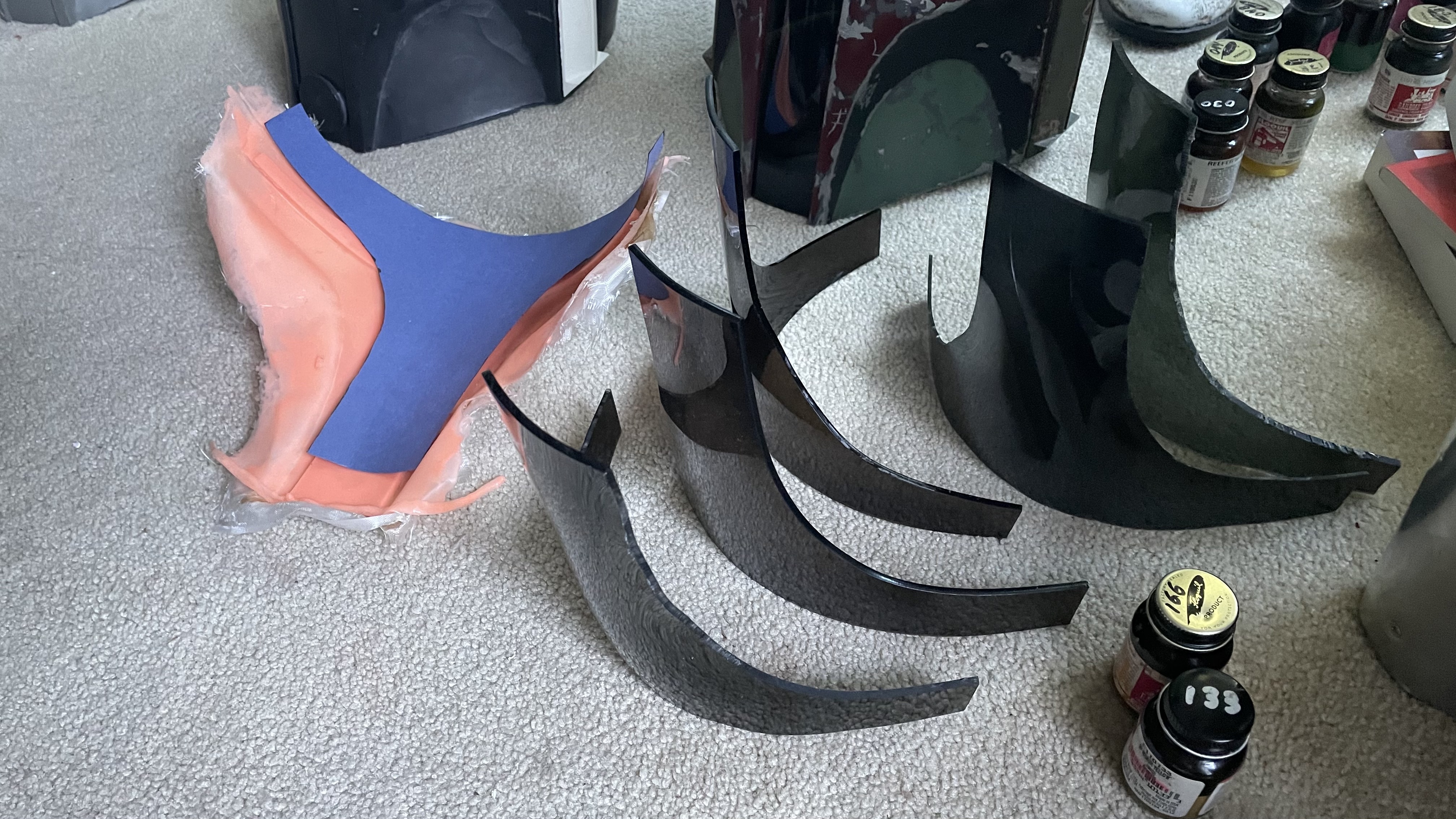

Since I still can't find 2mm smoked perspex/plexiglass I chose both 1/8" and 1/16" thickness of different brands to see which works best. **Both those sizes are wrong, too thick and too thin so I'd really like to find the 2mm stuff.** (**Another correction thanks to RafalFett. He has compelling evidence the visor is actually 1/8" or 3mm, but beveled at the bottom to be more like 2.5mm. So a 3mm or 1/8" visor should be close to accurate thickness afterall. Thanks again, Raf)
the mold needed the inside edge for it to work. I tried taking impressions of the inside of the helmet but what ended up working better was just sculpting the shape by hand.
visor recipe: bake at 375º for 5-10 minutes. Remove from heat. Using some hand protection, press down and rub the acrylic into the mold for a few minutes to make sure it's taking the shape. Gravity alone won't do an optimal job. Let it cool in the mold until it's rigid again.
Lots of tests. All of these got heated and molded multiple times. The 1/16" did best with taking the shape. (That's the silicone mold on the left)

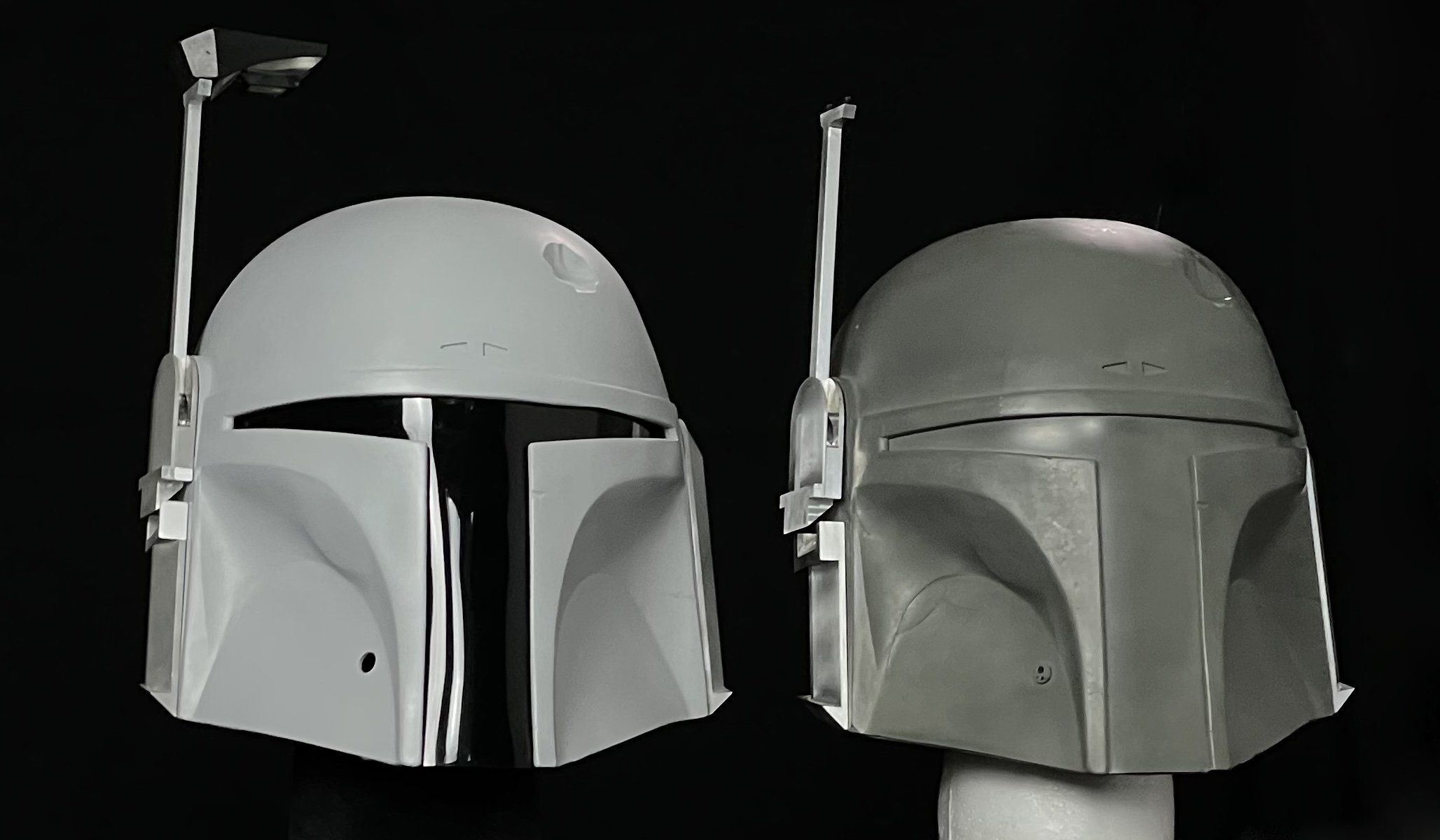

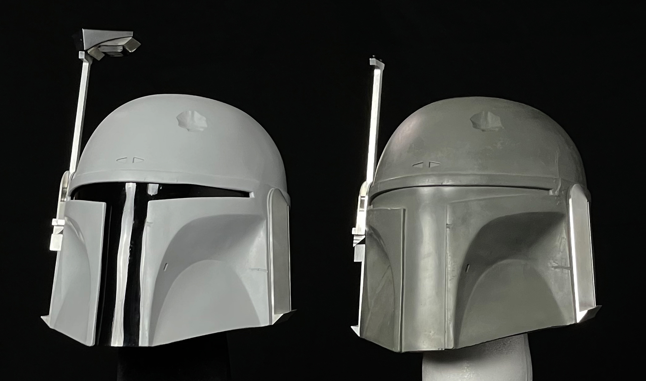

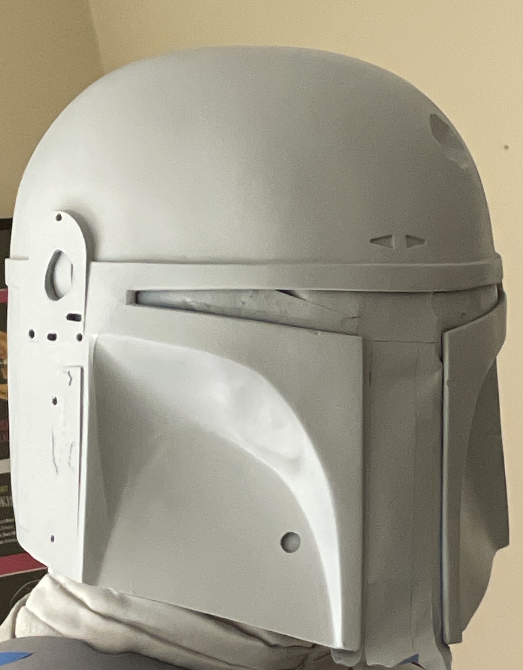

A long while back I re-primered my modified G2, and it's been waiting for its new visor.
New visor installed. This has the 1/16" in for now until I can find 2mm. Here is what I call my G2'79 next to my raw G2 for comparison. The '79 is wider at the base by 3/16" but the visible visor width is the same top to bottom.

Concavity causing mirror imaging of light source:
