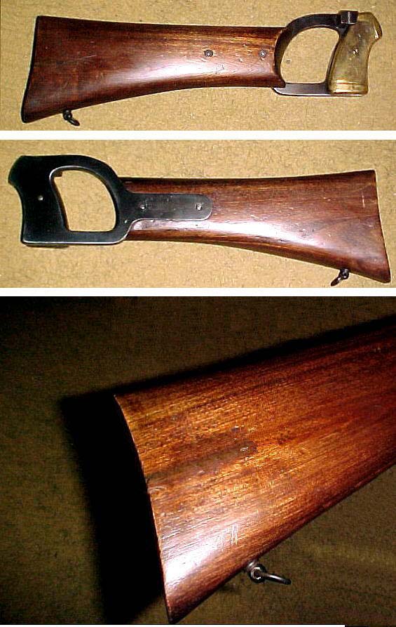

Would anyone have a clue to what the stock plates are to the ROTJ blaster?
I have really good pics of them but no clue as to what they actually are. They coul dbe virtually anything. I think the chance of finding the actual item is a VERY long shot. If you need some good reference shots, please let me know.
I've got two pictures of a very similar Webley stock (both sides). Anybody wanna post them here for me?
I will! Email them to me!
Thanks Brak's. They've been sent.
Here are pics of the stock from BobaFettish:

Great pic's of the stock!!!! But, what are the stock PLATES? I Quess it was something they just made out of some sheet metal. :confused
Ah, the SIDE PLATES on the stock. I spoke with Boba Debt on this very subject and he said he is having someone make a set for him (and possibly a set for me). They are being hand made. I really don't know the origin of the originals. If I am lucky enough to get a set, I would be willing to let someone cast them. I'll check back in with BD next week.

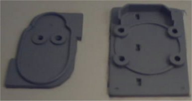

Hopefully this is what you were looking for:

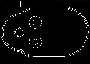

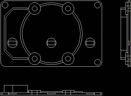

Here are two diagrams I drew up based on the above pics. I believe they are fairly accurate. Unfortunately I neevr finished the smaller one as I couldn't seem to get it exactly right...
Large Plate:
Small Plate:
The large plate looks a lot like the inside of one half of a film drying clip I used to have. It was made from plastic. It was used to clamp onto a wet developed roll of film, which you'd then hang from a wire to let the film dry.
Unfortunately, I gave all my old b&w photography supplies away years ago.
However, maybe this will give us a starting point...just a thought.
