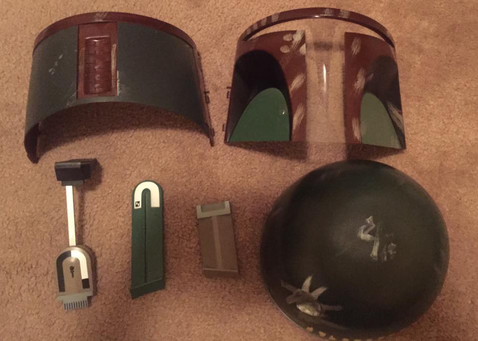

Easy.. it snaps right off. There are three screws holding the base of the stalk together and one holding the range finder itself together. The range finder also adjusts in height as well.
I just got finished removing the visor. That was a bitch. Had to dremel down the inside to get to the glass and snap it out and I'm not done yet. Gotta go back and sand it down by hand. Going to use a 3mm acrylic black welding screen as the new visor. It looks rough in there but once I smooth it out it will be nice. Don't know exactly what method I want to use to attach the visor and some suggestions are welcome. Going to be prepping it for paint and LED's here soon.

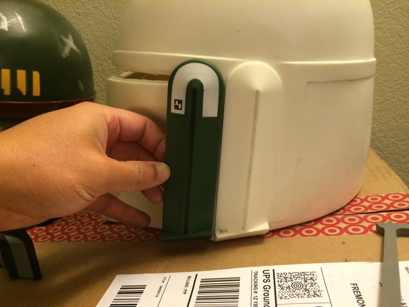

One of the better parts about this Target helmet is that it has almost no seams! Unlike the Hasbro, the dome is one piece, and the front and back plates clamp around the lip on the bottom of the dome. The seams between the front and back are then covered by the ears, so it's a really good beginner helmet!

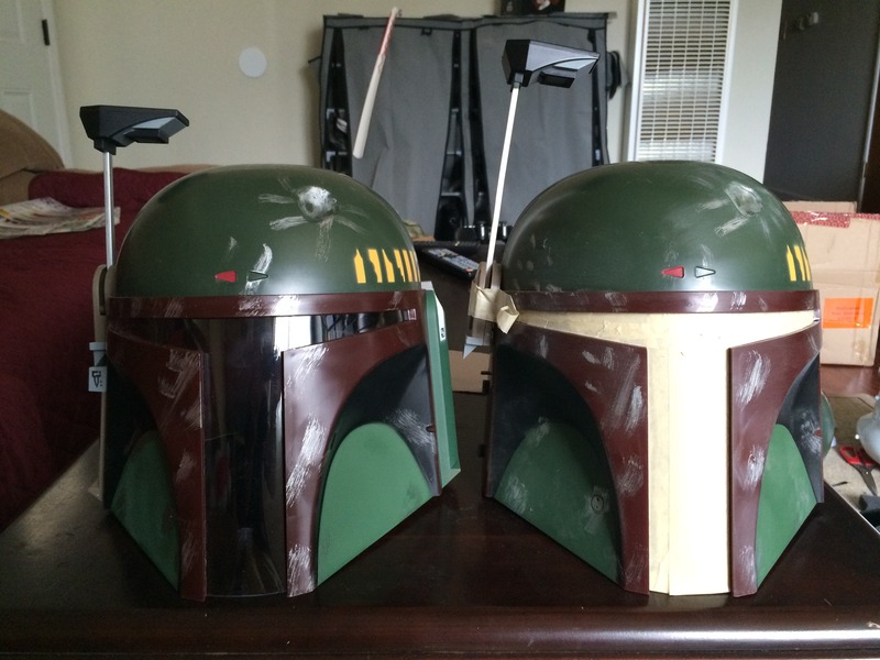

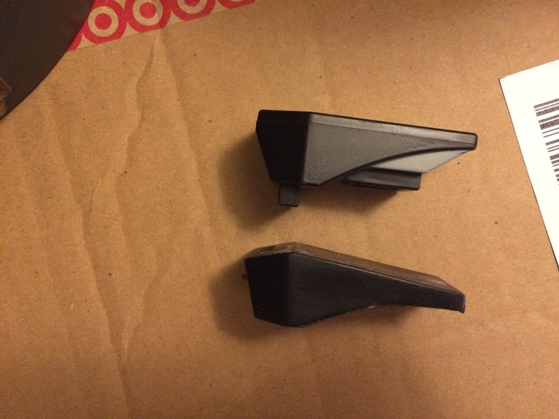

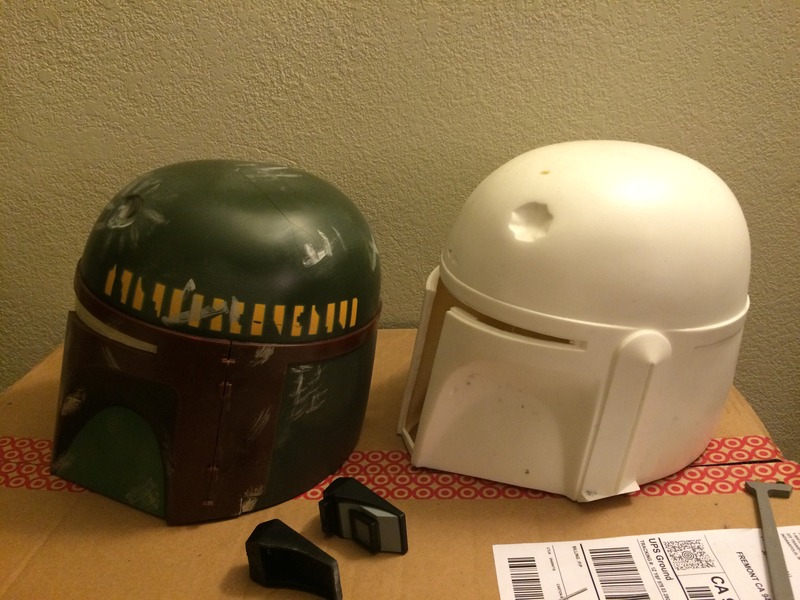

A bit of a size comparison as well for those who still aren't sure if the helmet is worth it. Shot is next to my animefan Fett helmet. The RF stalk extension cast I made and a size comparison of the ear and range finder piece. Ignore the warped mandibles on my animefan helmet, the recent heat wave did that and I'll be fixing it this coming weekend.

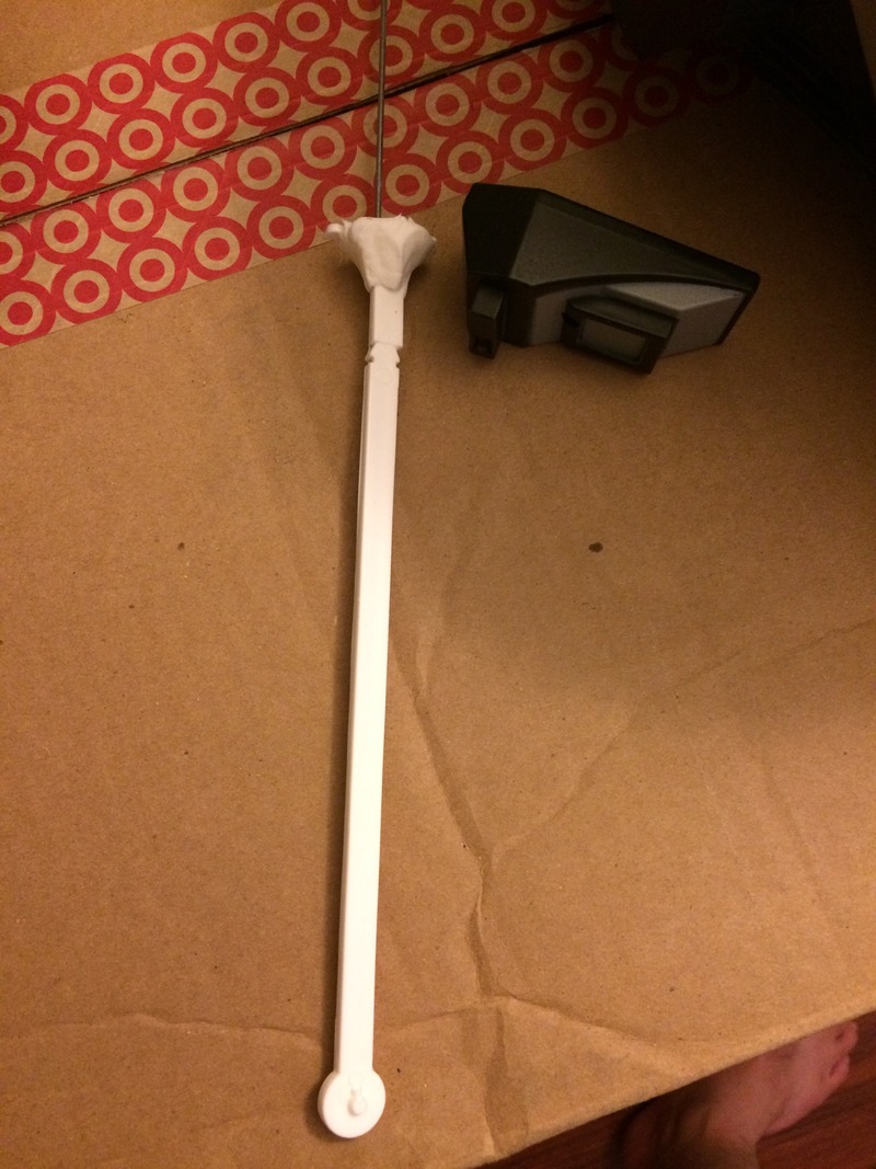

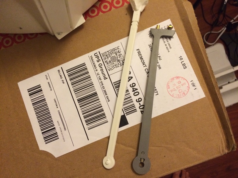

Here is the cast one piece new stalk with metal rod for a bit more support. The extended look definitely brings the entire look of the helmet a bit more to where I want it. A directly replacement for the standard one that comes with the helmet. If anyone is interested in one, feel free to let me know.
- - - Updated - - -

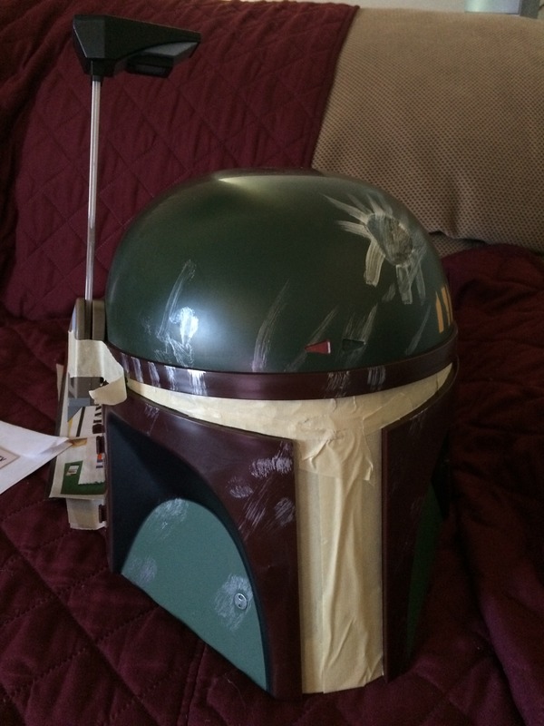

shot of it on the helmet, extended RF stalk.
