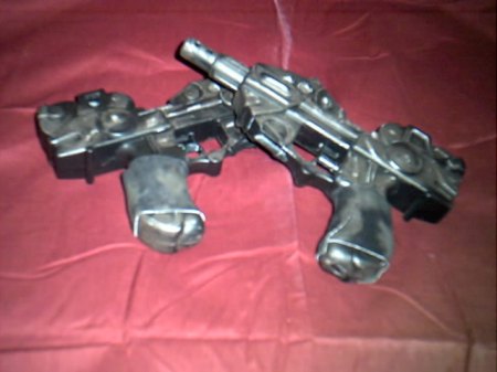

I'm sick of carrying waterguns around... yes waterguns.. (which actually are pretty good looking).. but anyway, I wanted to modify these blasters & cast them into Resin. I don't have the supplies to do so, I was thinking of maybe sending them to someone to have them casted into resin, or just learn the art are Resin & attempt it myself - can anyone help me out?

Thanks Schaub for your input, heres some stats about the blasters -
From barrel to back it's 8 1/2" from top to bottom handle it's a good 5 1/2"
Blufive: I live in PA, but any help would be great
Here's some pics of the Blasters

JM - those are pretty cool customs. Nice part is that you only need to mold one! It would be a pretty simple mold - just clay it up down the middle!
