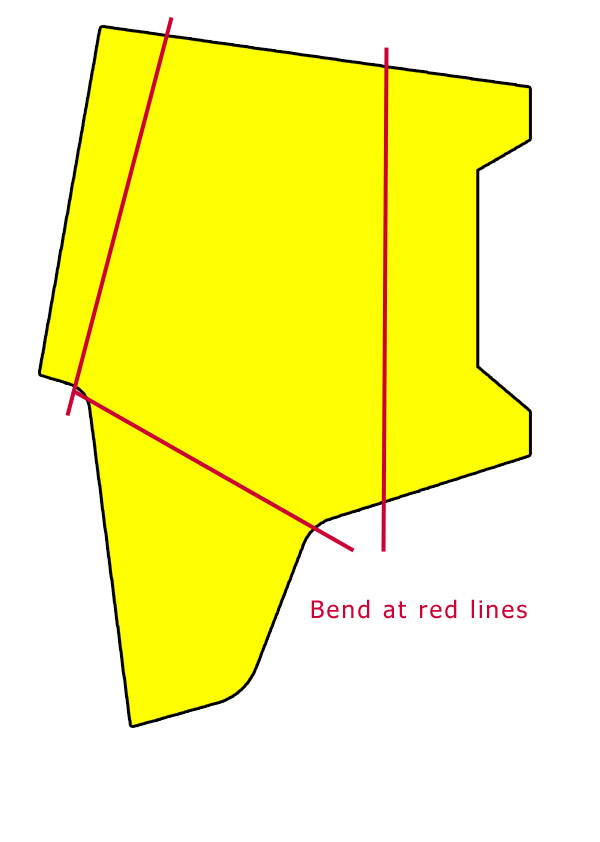

Plan your shaping, don't just freestyle it or you'll end up with asymmetrical armor that fits weird. The more times you heat and shape, the rougher the surface of the sintra will get. I find that instead of shaping it against myself, it's easier to take a long hard look at how the screen used armor is shaped, where it bends. Find a flat surface with an edge (like a table or countertop) and heat just the part to bend, then almost fold it over that edge (don't press down too hard or the line of the edge will press into the armor). Remember, you can't just curve it any way you want. You can't, for instance, make the top of the helmet dome. You can fold it like a piece of paper in one direction at a time.
Here's how I approach the chest armor:
