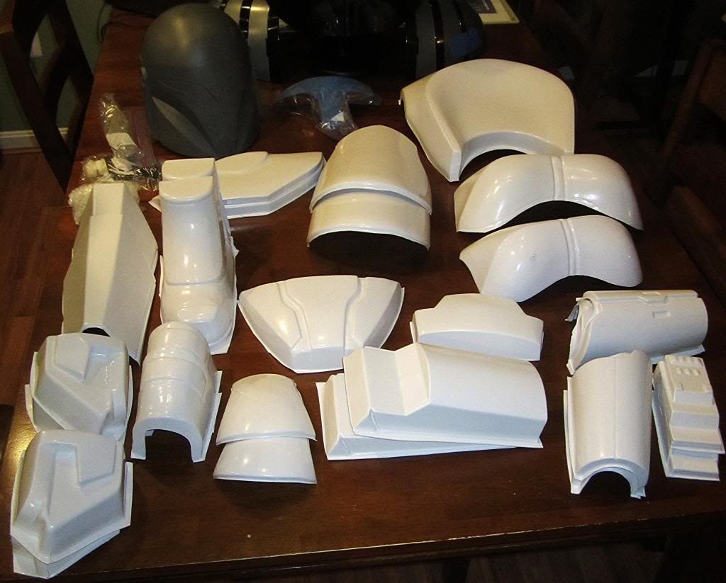

So this is my first real build and I am really excited about it. Over the past six months I have collected the costume parts below:

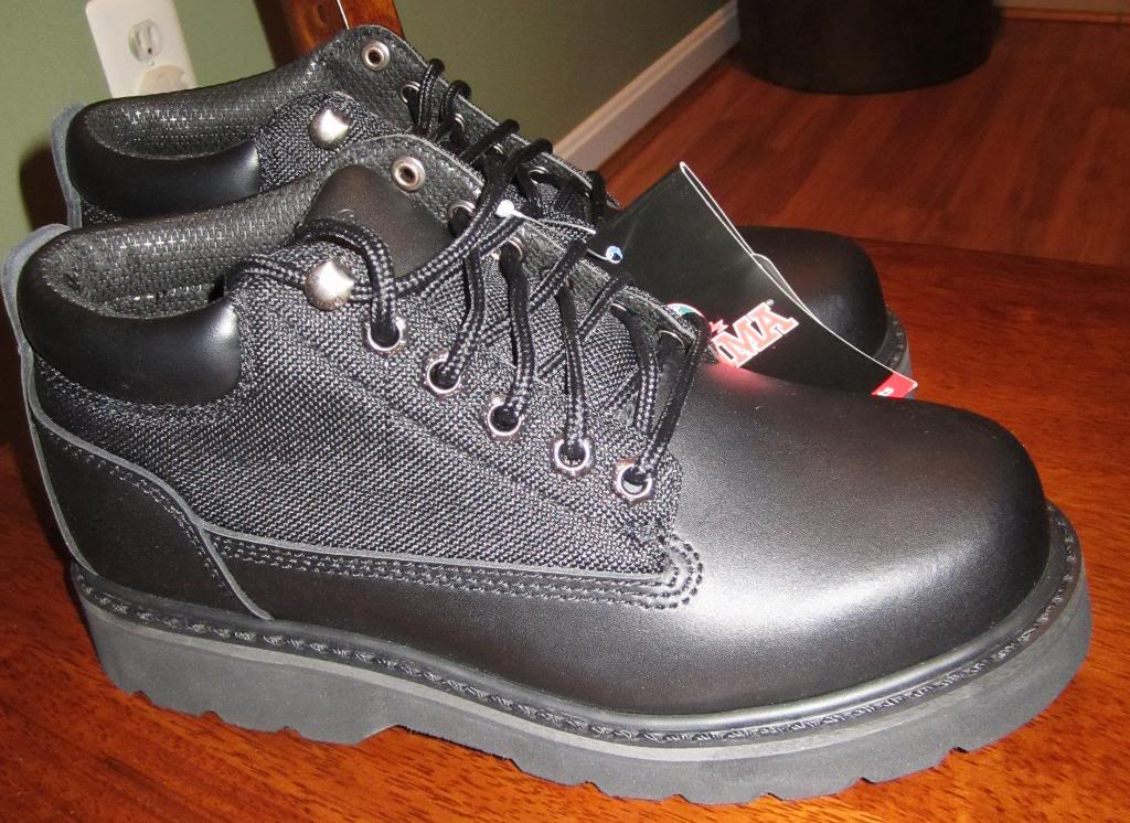

The helmet is from Cruzer, armor kit from KWD, and Brahma boots from Walmart.

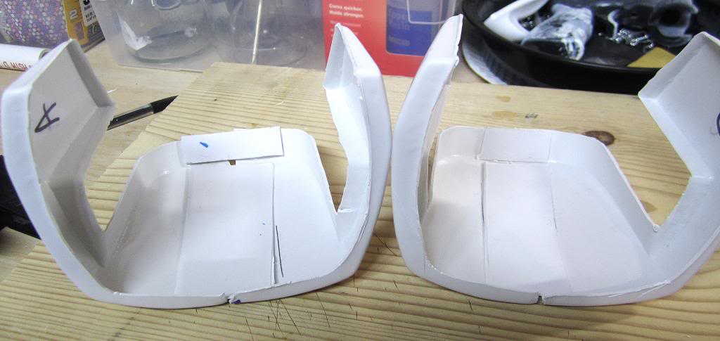

In the last few weeks I have worked hard to trim down the excess flashing on the armor pieces. To accomplish this, I use a cutting board, utility knife and pencil.
I then draw my cut lines, score them with the knife and then apply light to medium pressure until the plastic snaps in a nice neat line. Using a utility method is a quiet, dust free way of trimming armor kits. I do it at my kitchen table after I put the kiddos to bed. :)

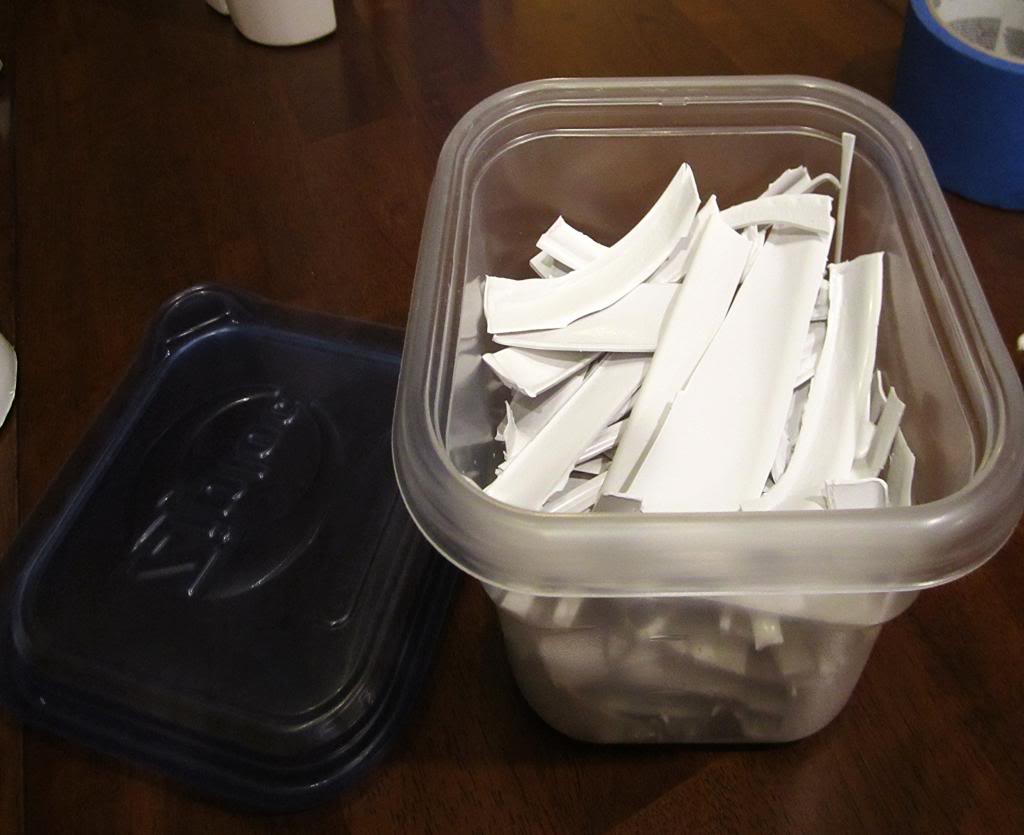

Don't forget to save your extra flashing. You can use the larger scraps for repairs and the smaller scraps are great for making sludge (a mixture acetone and abs scraps). I am sure most of you know this already, but I just thought I would mention it. I made some rookie mistakes when cutting the knees, so I will be using ABS scraps and sludge to restore the knees to their former glory. I plan on showing how I did this in a future post.

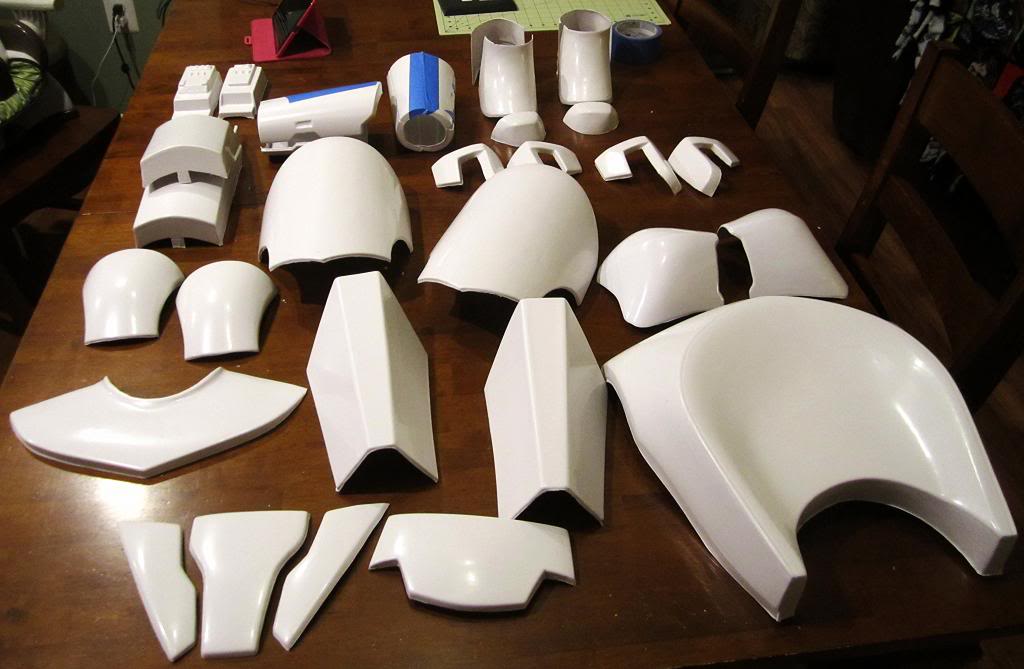

Here is my kit trimmed up. I haven't finished trimming the details on the gauntlets yet.

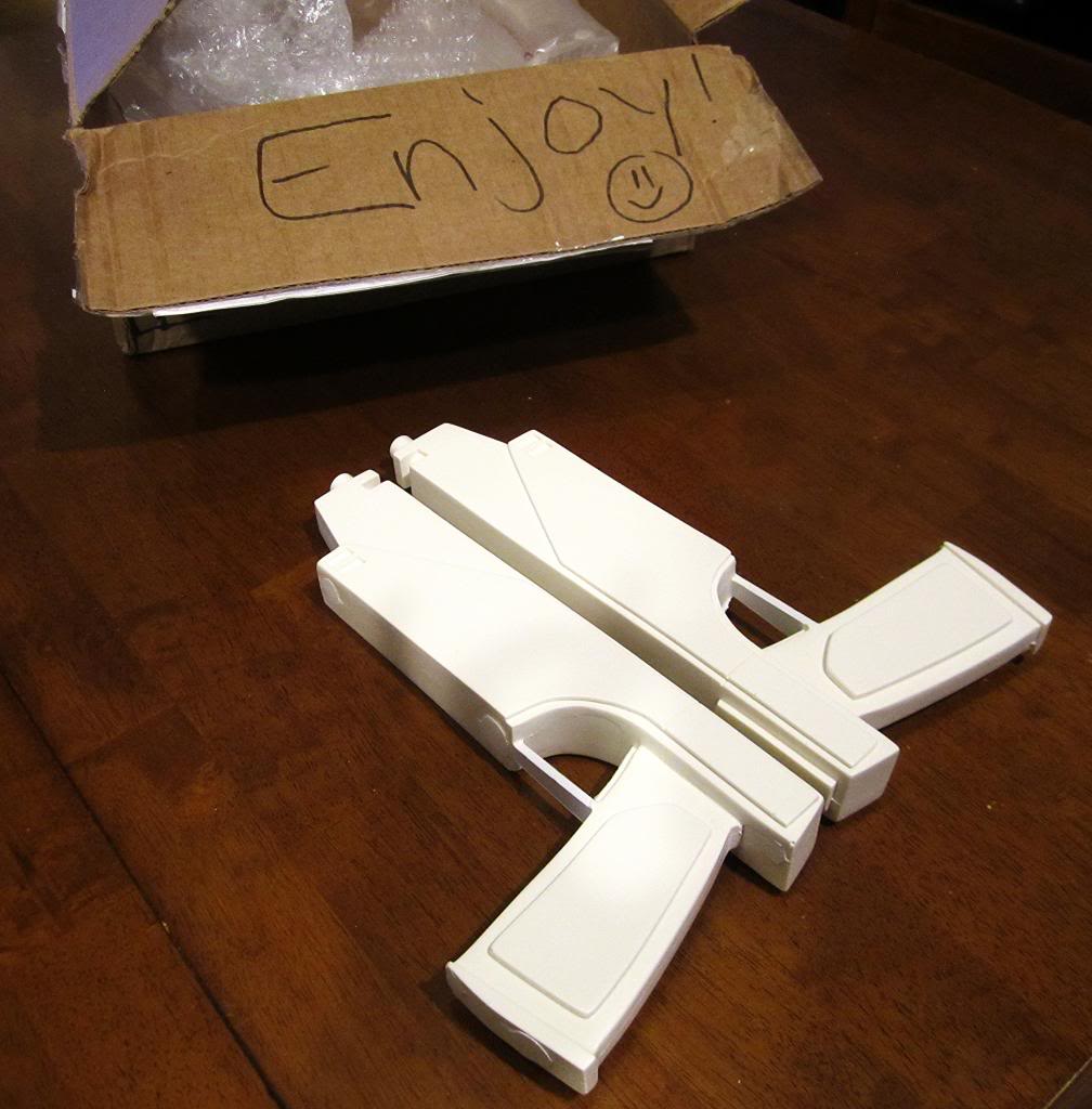

So, I received a belated Valentines Day present from my husband in the mail today!
I was never much for roses anyway! :)

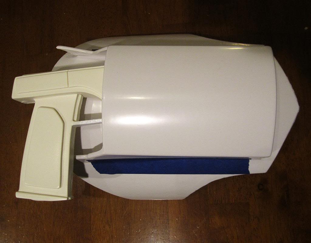

Took this last picture just for fun...
From this very basic mock up, I can see that I will have to trim down the holster, as well as create an insert for it so the blaster will sit properly inside. I will be sure to post up pics of how I do this when I get to this portion of the build.
The weekend weather looks good. I hope to get some decent work done. Thanks for reading!
It's the same way an arrow sits in a bow rest (It's called a "Whisper Biscuit"). I've made a similar apparatus for a prop sawed off shot gun for an Ash, from Army Of Darkness. I didn't like how it rattled around in the back sheath I made. I went to the dollar store, bought a bunch of cheap'o brushes, and Viola!
I may be misunderstanding your post, Novenas, But, That arrow rest wouldn't fit your gun.
Also, hot gluing some Foam in there would do the same thing, but you may risk it getting chewed up over time.
Weight may be a negligible variable, but it's a variable.
Brush one side, foam the other? In
either way, interested in how you fix it up!
You know, you basically made a whisker biscuit with the hair brushes! Pretty darn smart. I will definitely have to re-think the use if foam, I don't want to have to rip out old foam out of my holster because it is falling apart.
And yes to the soft bristles. If you can't find the hair brush you want at the dollar store be sure to take a look at a place like Sally Beauty Supply. They have TONS of brushes in different shapes and sizes and the prices are reasonable enough.

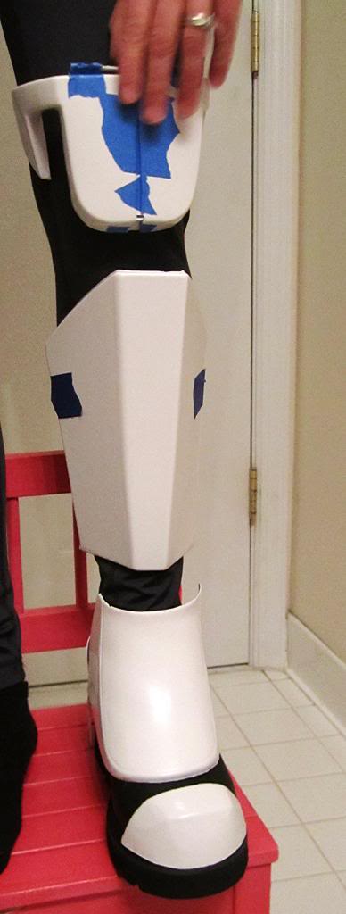

I have made some progress since my last post. I worked for quite a while on the fit and spacing of the armor. Here is a picture of the knees, shins and boots on me:
And on Bo:

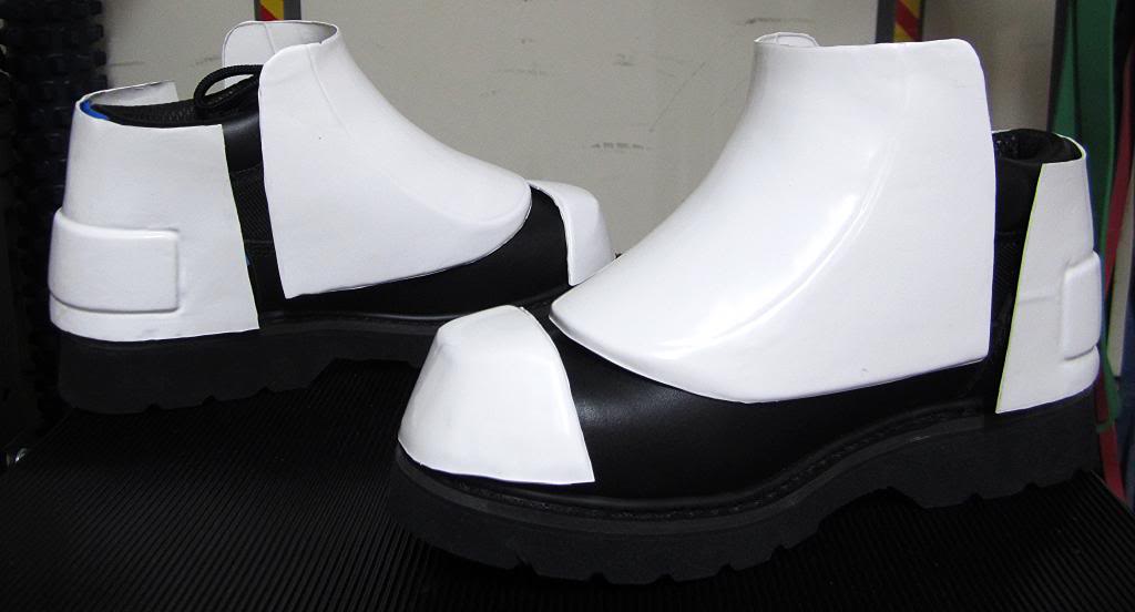

I am quite happy with the spacing. I also worked hard to get the armor to fit nicely on the boots.

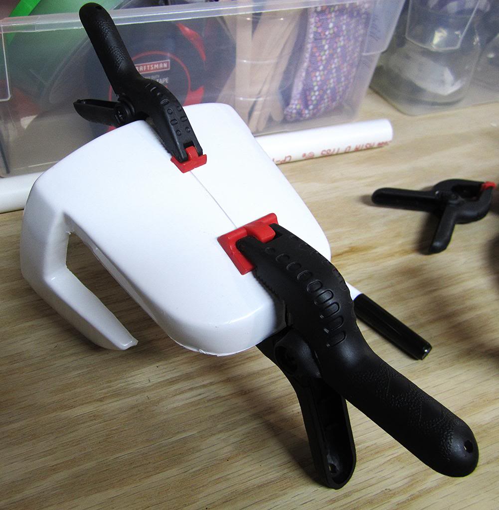

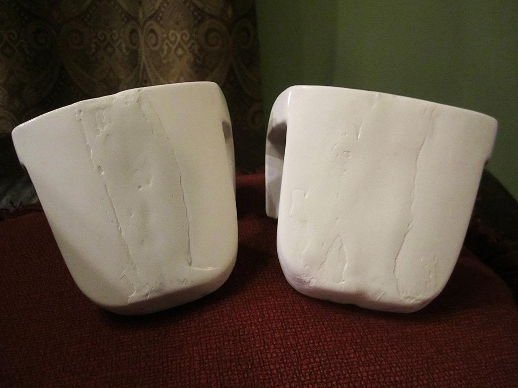

After sizing and fitting these pieces, I glued together the knees,

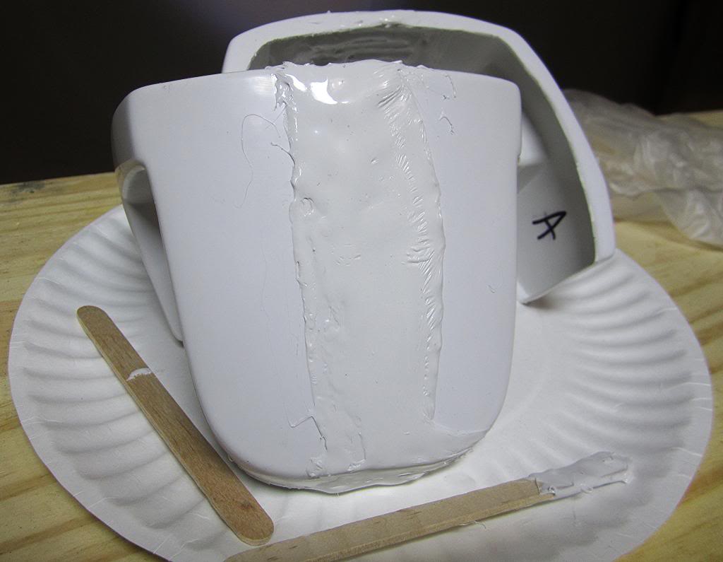

and used ABS on the seams.

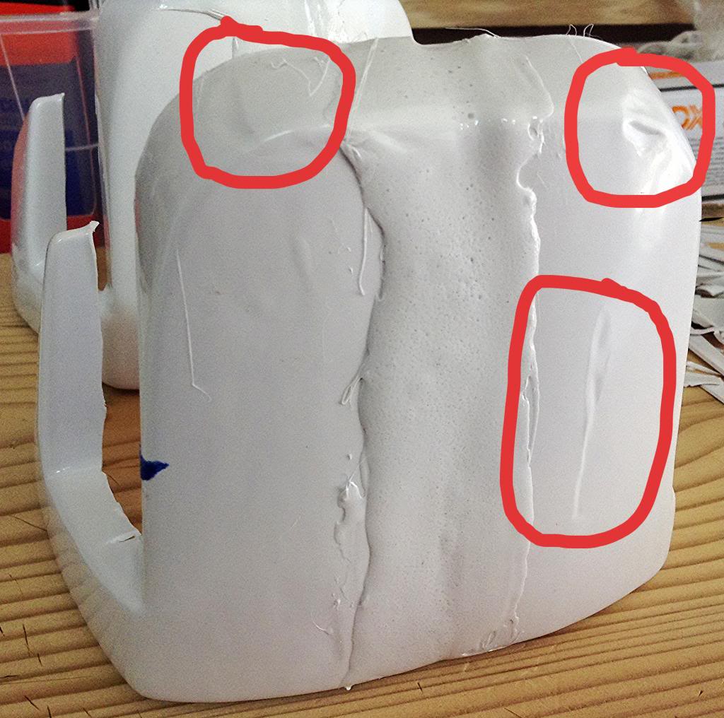

This is where things started to get a little hairy! I used way too much ABS on the knees and ended up with this:
YUCK! So I tried filling the dimples with more ABS.
I know, I know...awful. But...sanding the made it a little better.
But now my problem is that I have one nearly perfect knee (on the left) and one horribly misshapen knee (on the right). Do I use a heat gun to try and give it more curve to match the other knee? Or, do I saw the knee in half with a Dremmel and re-glue it?
