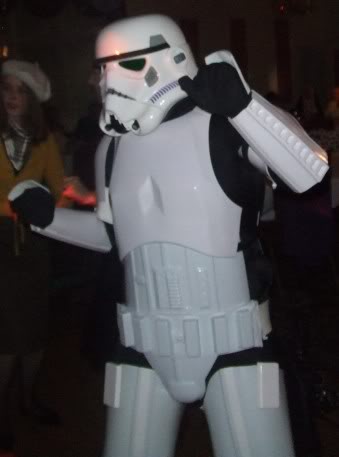

Eventually I got everything sorted, though at the party the belt fell off and it had to be taped to keep it from falling down and some kid attacked me as soon as I walked in and broke my gun... typical!
but here are the photos:

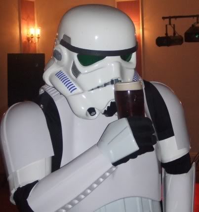

What every trooper needs, a pint of beer!

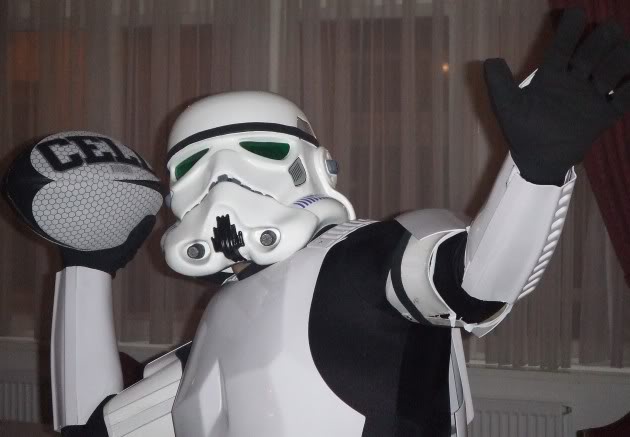

And perhaps a game of football?

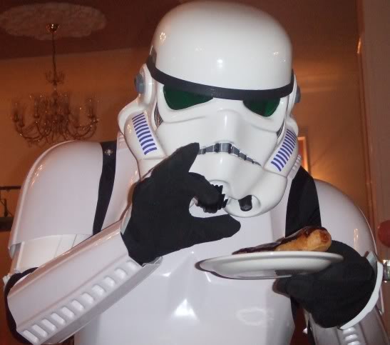

And some refreshment?
Look sir! Eclairs!

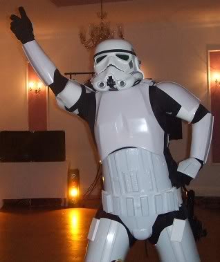

Ubiquitous Saturday night fever pose...
Proper dancing, yes it was pretty hot!

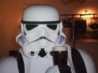

and then settled down with another pint... cheers!

Ah, the stormy! Always a favorite.
One suggestion I have is to paint the whole suit white... If you look at the pics, the upper and lower body are different temperatures... the top is a really warm white, and the bottom a very cool white.
A quick coat of paint will even them all out. Maybe the same white that's used on the helmet if possible?
Good luck on the Mando!!

Took me all the time to get it ready for the party. I have about 4 cans of Ford Diamond white (which is the colour the guy on Ebay told me he used for the lid) in a box somewhere, got a little nervous when I ruined a Scout helmet.
I need to replace a couple of pieces that didn't wear well under scrutiny, so I will need to buy those parts first and credit crunch means I need to make money before spending it :(
It will get done as it is one of the things that irritated me, though to be honest, I'm not a stickler for detail and the laymen (the other partygoers) didn't seem to notice :)
