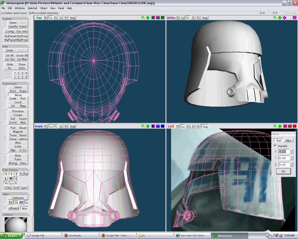

The illusion DOES apply to mine. ;) If you look at this face plate at different angles it changes the whole look! Trust me, I modelled this thing in 3D before starting a build. ;)
Because the face is curved AND slopes outward the angles change a whole lot just by altering your viewing angle slightly.

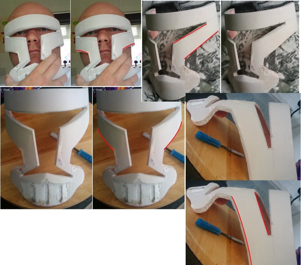

Look at these earlier pics of mine all taken from different angles. Please not, my visor and the cheek lines have not been altered at all during the build so what you see in this compliation is how the visor cutout still looks today.
I've highlighted how the lines can appear curved in one pic yet curved in another.
Look at the 3D wireframe pic. Straight lines from the front view, yet curved from the side.
Viewing angle and perspective distortion play a big part in how this faceplate looks. They are straight lines but wrapped around a curved object.

I still have to say its a curved visor, especially after seeing the last few pics that you posted.

I've been looking through my WIP pics here and even took a rubbing of the visor and cheeks and you ARE right. :) There are slight curves in the "T" on the visor. Gently sloping down towards the center. I even felt a little silly after the realisation because I was trying to prove the lines were straight but I just proved myself wrong. LOL!

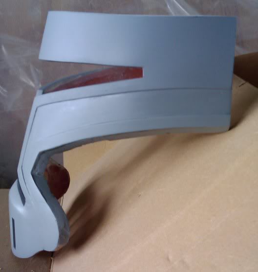

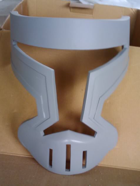

Just a little update guys. More tidying up after adding that trim. Fixed the three strips on the mouth too, they look much better now. Tomorrow I'm going to hopefully finish off the faceplate and try experimenting with the cowl!

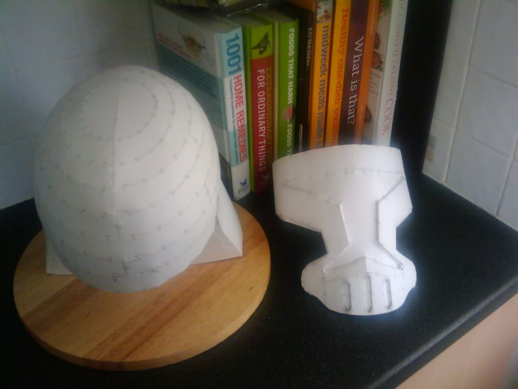

It started out as a Pepakura model that I designed for the project. I modelled the faceplate and dome in 3D, then unfolded it using Pepakura.
Though the card build wasn't bad, the lid has gone through many changes along the way to get it more accurate. Both the dome and faceplate have been modified along the way.
The last few days have been spent getting a rough pattern for the cowl. I think I've nailed it but I need to make a few more mods to the faceplate before I know for sure.
