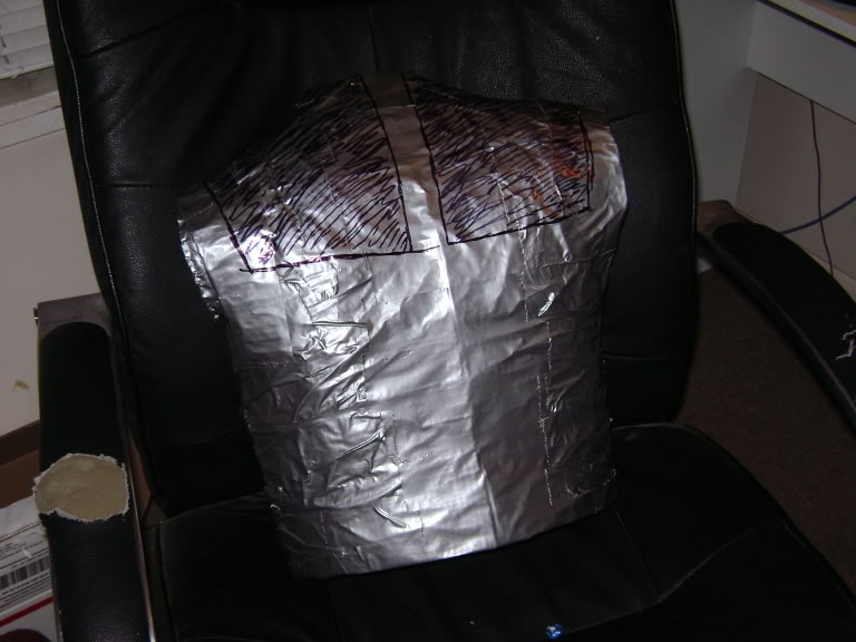

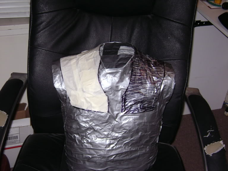

next up, the mold of rob without him in it. this makes it handy for me to work with since i don't have to feed the manniquin and i'm pretty sure i'd have to feed rob if i kept him around to build the armor onto. i've started scribbling in where the armor will have to go.
after looking carefully at plenty of pics, these armor plates are not very big at all and shouldn't weigh too much even if i made them out of solid resin (though i'm not planning on doing that, the idea of working with resin frightens me like a thunderstorm).

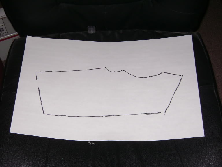

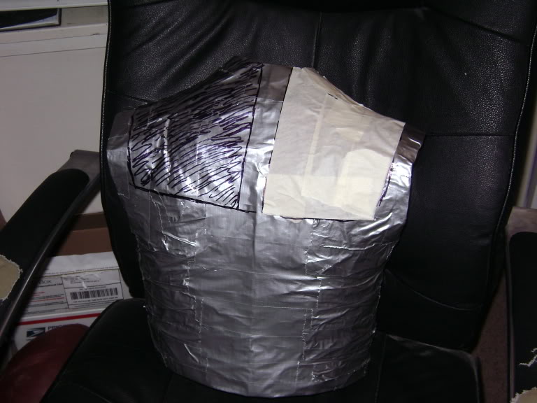

the next step had me making a removable template from what i drew onto the manniquin. so i made the right armor plate out of plain old masking tape, then i peeled it off and put it on a piece of 12x18 sketch paper and traced it out.

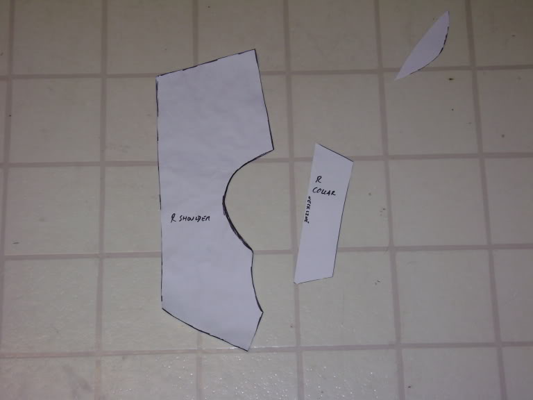

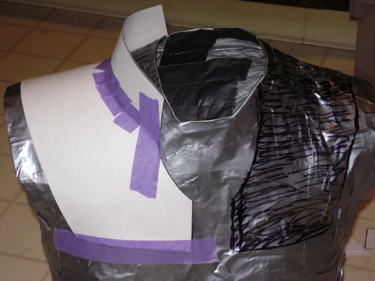

after trying to fit the paper template back on i realized that i needed to cut the collar piece seperately.

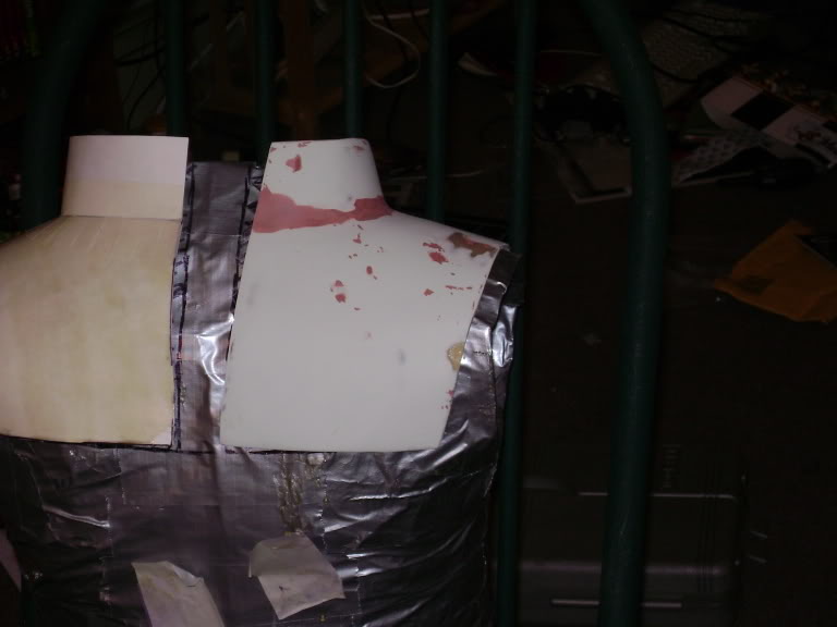

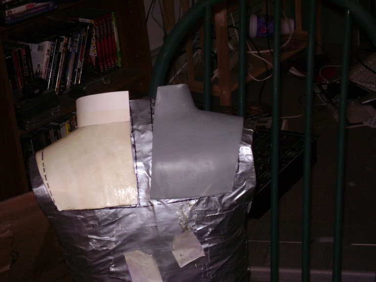

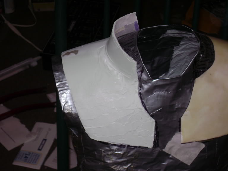

i then transferred the paper templates onto a heavier poster/cardstock paper, got it to drape nicely with a little bit of mist from a spray bottle, taped everything into place, and this is where i'm at with the project right now because i'm too tired to keep working on it, but still awake enough to be able to post about it.
once everything is dried i'm going to carefully re-tape the two pieces together then coat it as light as possible with fiberglass resin, fill the low even it all out with bondo, then 'glass over it all agian with fg cloth instead of mat. i've never tried the cloth before, but it looks like it will give me a much better finish than using mat.

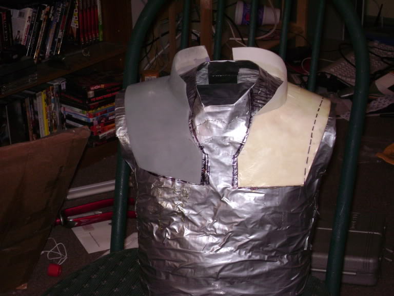

havn't gotten too far, but here's what i got. the right shoulder is coming along pretty nicely, and i've started on the left. i tried simply mirroring the templates, but that didn't work out too well, so i went with the star wars tradition and made a seperate template to keep things nice and asymmetrical.

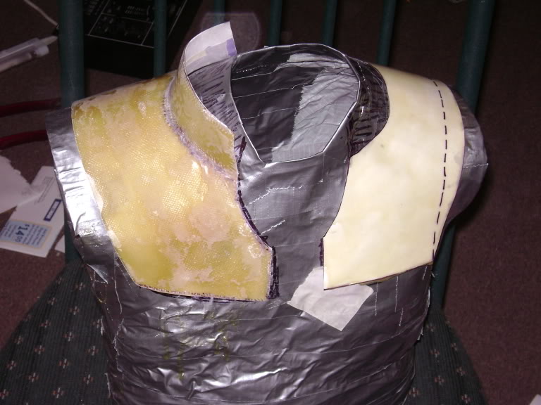

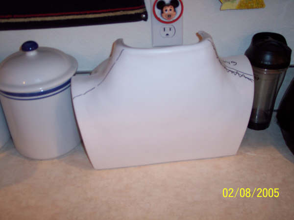

i took the paper-form pauldron and fiberglassed it. two layers, the first one was done with 'glass mat strips for strength, and the second was done with 'glass cloth cut to the templates because i really like the finish that gives. i took a little time with the mouse sander and some 220 grit between the layers making sure things weren't so bumpy and pointy.
after that it was bondo body filler time. i love how bondo is so much like toxic cake frosting; mmmm.... frosting.....
then that got all sanded down to a pretty good finish with the mouse. but there were a few spots that still needed some love, so i got out the red spot putty and filled in a little more and sanded it all down with the 220. but i did leave some nicks, bumps, and scratches in the finish; looking at the apprentice, it would be hard to believe that his pauldrons would be pristine when the rest of him looks like a hobo.
after that it was time for some hand sanding with the 320 (cuz i don't have the velcro paper for the mouse in 320), and primer time. i personally like the finish 320 gives for priming onto. but my primer kinda sucks and is awesome at the same time. i was using kilz spray primer from walmart, and it takes like 5 passes to get decent coverage (that's the suck part), but it doesn't run (the awesome part). and then i gave it another quick go with 800 grit.
through the process you can see the left side getting built up a bit. the paper form, then i gave it a coat of resin, added the collar piece a little later. i just need to make the time for it and it'll be done and ready for the restraining bolt by saturday.
