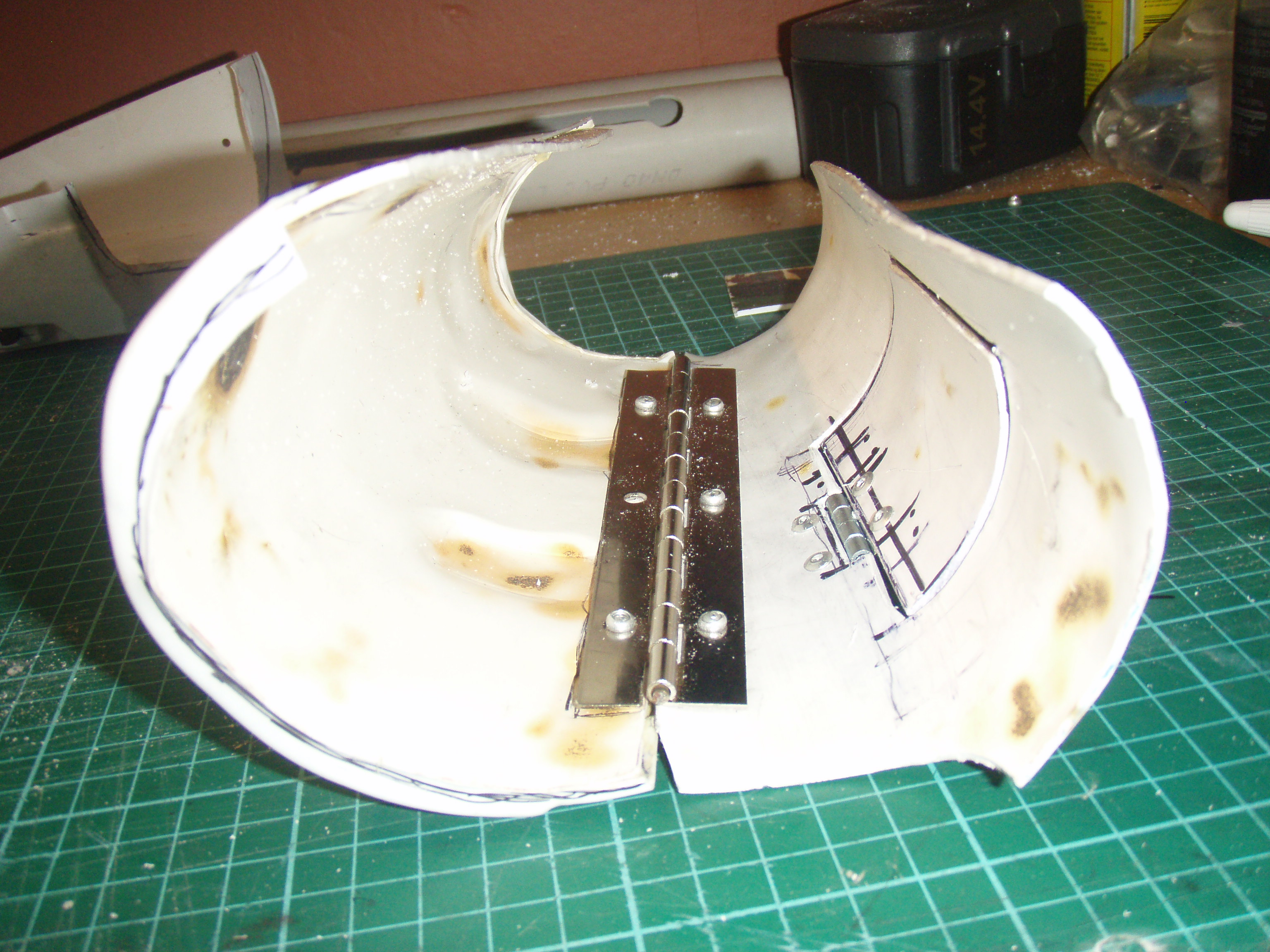

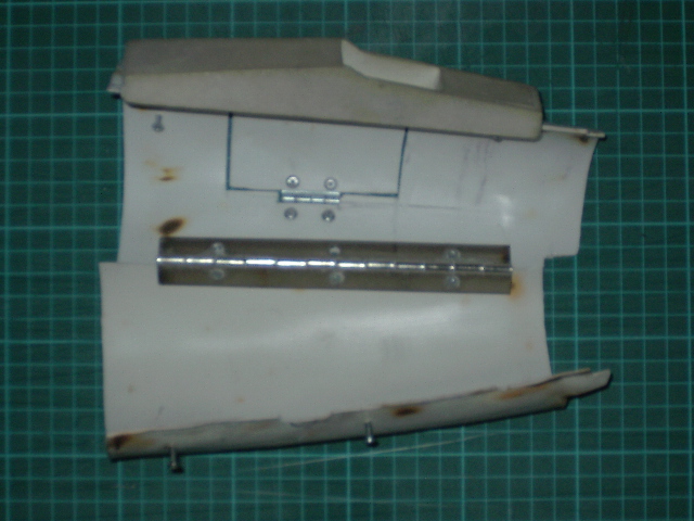

So taking into account the hinge I cut into each side of the newly formed PVC gaunt/pipe, each cut being half the diameter of the hinge and the cut being on the inside of the arm ( this being the least visible area ).
I then riveted the hinge to each side of the pipe, so I now had a opening and closing inner.

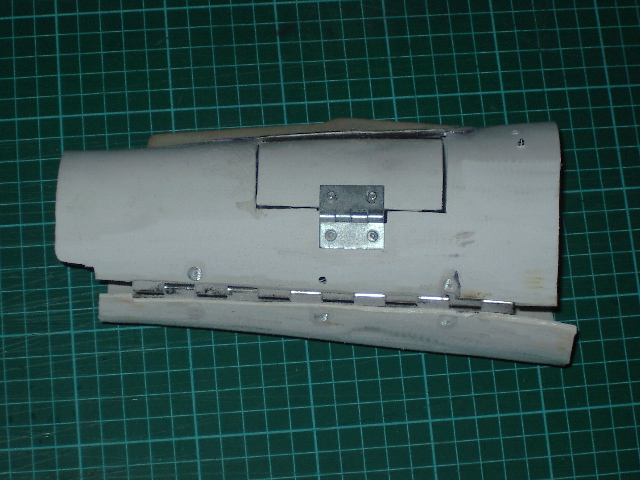

next came attaching to the Rufkin outer. The first to be attached was the bottom, as the tops would have electronic parts and that is another kettle of fish... To accommodate the electronics I added a door to the top half, so I can have a way of changing the batteries..
As you can see, to hide the hinge I mounted it with the pin facing in rather than towards the outside like other ways I have seen.

It looks like you have a little trap door on one of your gauntlets, what's it for?

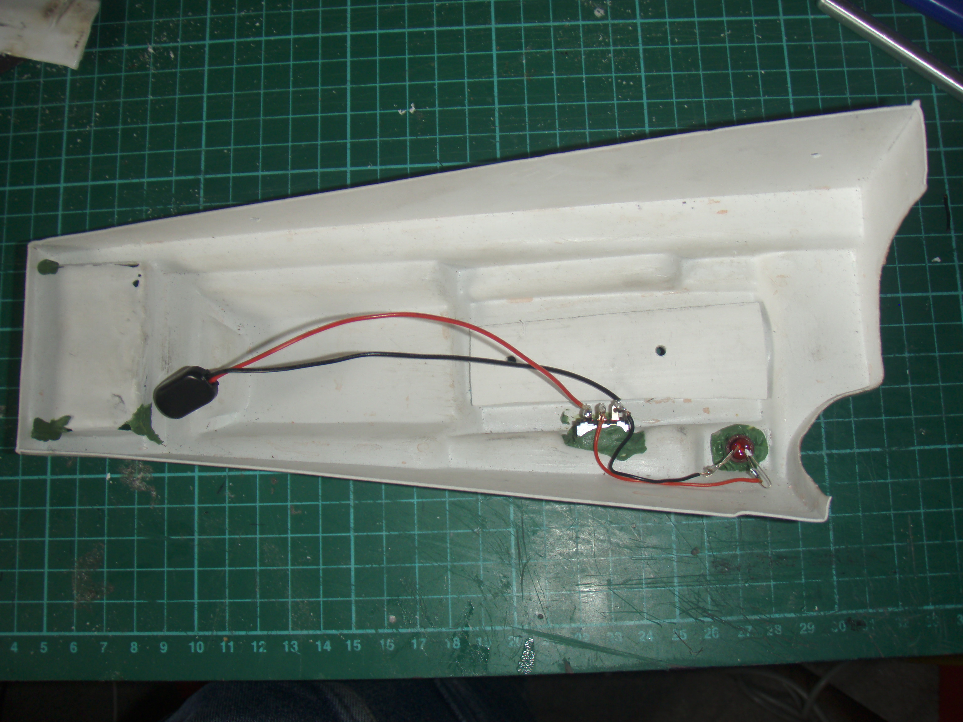

Like most here I wanted my gauntlets to be more than just decorative pieces. I want to have a little bit of function, even if it was just a light that blinks:lol:
So first thing I did was go and find a self blinking LED and cover for the left gauntlet. The mounting of the light is self explanatory, as it was just a hole drilled and the cover mounted with two part epoxy (I used "Green stuff" as I had it lying around).
I also mounted a a two stage switch in the sided of the gauntlet.
This shows the basics of the set-up:)

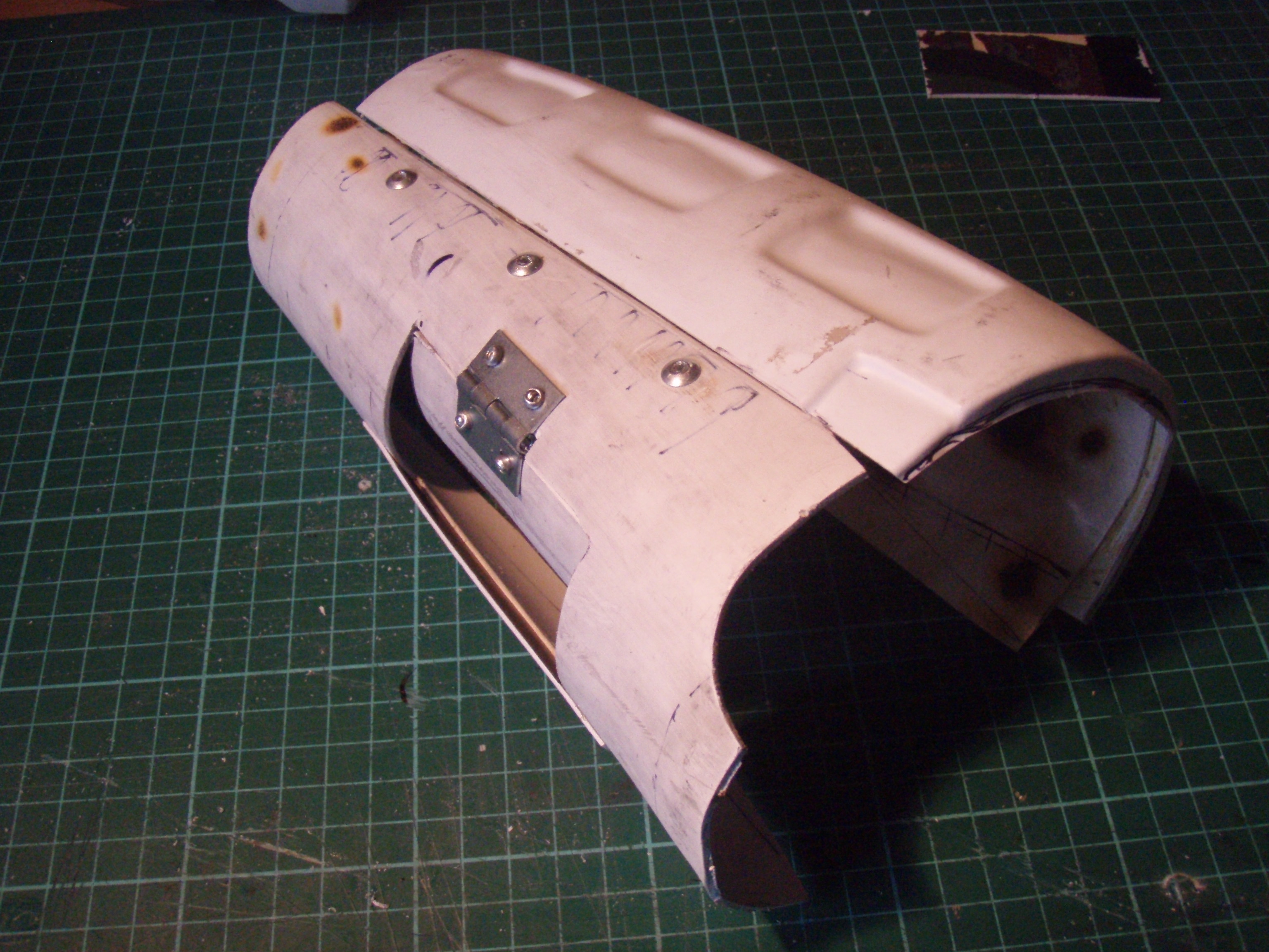

Next I need to make supports for the inner core, which I did with stick two part epoxy. I mixed up enough for two corners at a time.
Using latex gloves I mixed the epoxy, this stops the mess on your hands and also there is some nasty chemicals in the epoxy that can be absorbed into your skin, which is not good!
I used Plasticine on the other corners to make temp supports so that the epoxy ones would sit right. I covered the epoxy ( and plasticine ) with cello-wrap so it wouldn't stick and then pressed the inner into the top of the gauntlet until it sat snugly into place. This process I repeated with the corners and sides until I was happy that the inner would be secure enough.
I also strengthened a few areas on the inside with epoxy, mainly in the corners that I felt were too flimsy..
