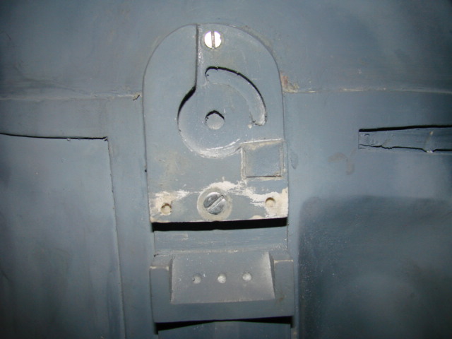

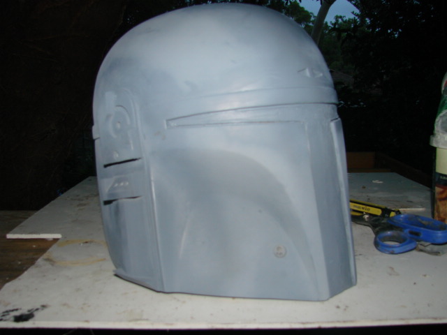

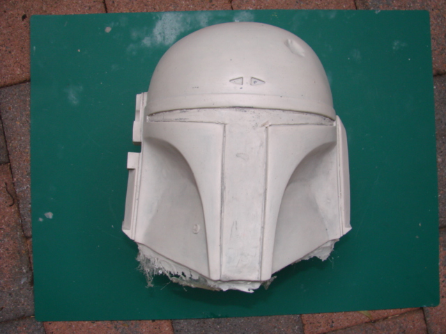

Im working on a new mold , using my previous one iv done s few mods to get it looking what i think is closer to the real thing , and also made a few asdjustments for easyer mold relaese,
Im making this cast with the ears atached and a corect borden (all 3 holes difrent size i seamed to get luky witth this , when i cut my real bordens up the 3 hole was larger then the second i dont know if they all are like this but it was my understanding they wernt , but 4 out of 4 seams as if that is the way they come )in place,
Werew the micro switch cut out is ive filled it but made an indent i was going to but a micro in there and fill it to look like the pre pro but thort better of it:lol:

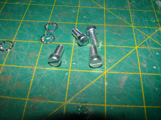

All so used cortec cheese head skrews to mount the inner ear cap ,

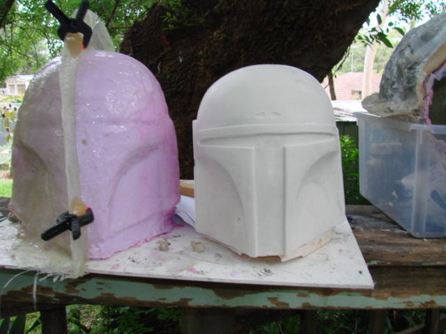

and ive started to pour sillicon on it,,
The pics are of it a a ruf stage b4 final clean up but i didnt take any b4 i pourd sil on it
DSC04206.JPG This is what cheese screw look like
A asume they are called that coz the head looks like a barrel of cheese

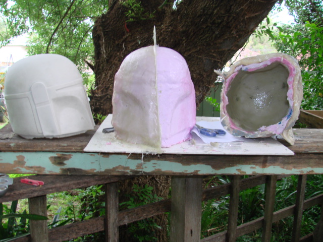

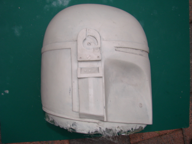

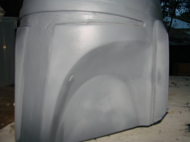

Ive pourd like 12 layers of sillicon over the lid im reraly trying to get thhe outer of the sillicon realy smooth as to avoid any lumps in the casting , and im realy taking my time to get this mold perfet so i dont have any problems .
so far so good but the proof is in the pudin, so ill see how it turns out
iv realy tryed to refine the prosses of mold making,
Ive coated the bukl in many thin layers of sillicon to get it as smooth as possible , and a nice smooth layer of FG over it to enshore a clean pull no lumps of vallys.
DSC04275.JPGDSC04276.JPGiv realy tryed to refine the prosses of mold making,

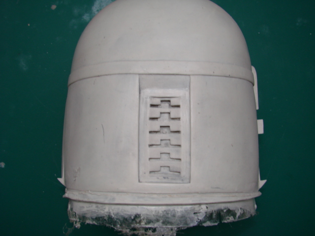

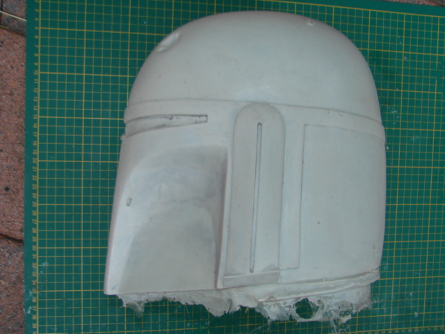

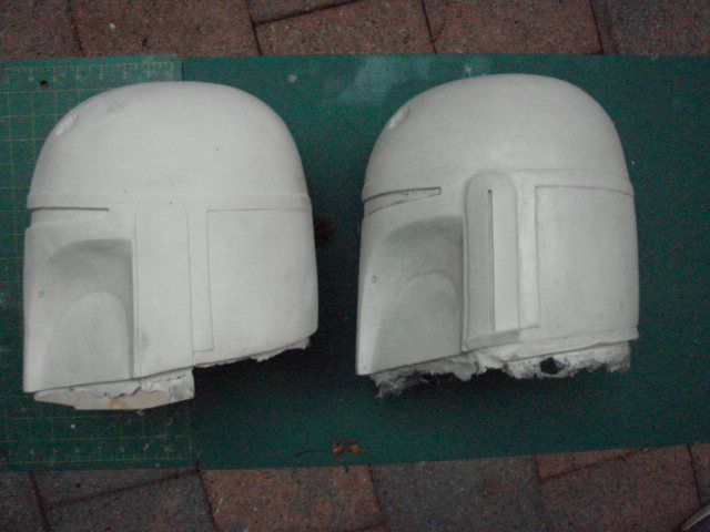

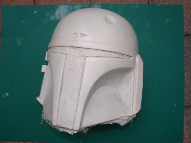

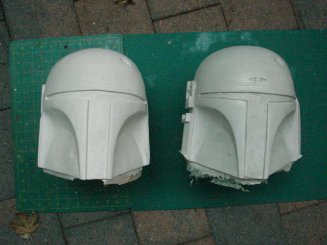

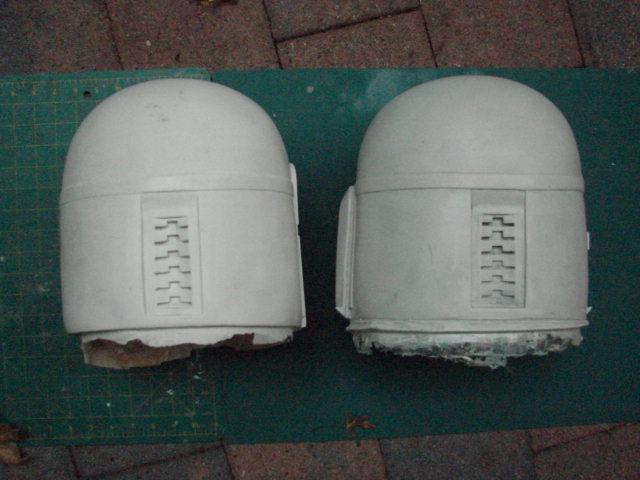

Well ive managed to get a helmet layed and pulled today (amongst a pull on my other mold and a few other peices)
Im really stoked with how this has come out the extra work on the mold realy pays of , the cast is flawless best ive ever done ,

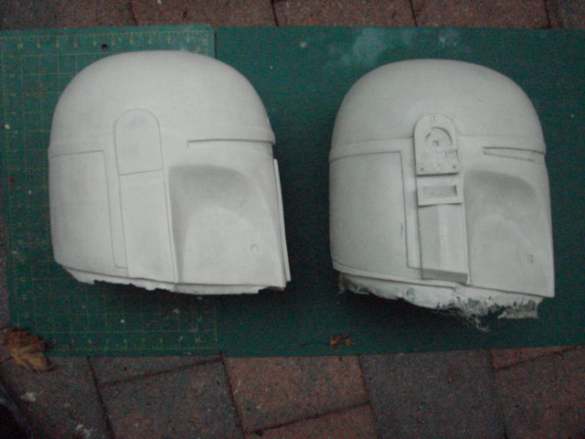

Here are a few comparisons with a cast from my other mold with out the ears and borden.
i did change the buk a bit but throught the difrent molds the shape seams to change
IM really really happy with the look of it
Let me know what you guys think?

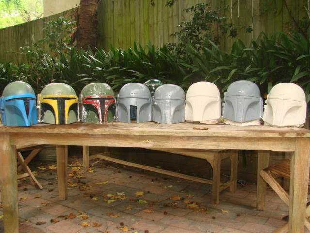

DSC04318.JPGJust thort id show a little (not all of em as ive given a few away between the yellow and red one there is 2 missing and another between the 2 grey ones there is another one not to mention my none fett mando's ) bit of my build history , the fist one, god bless it , i did long b4 i new about TDH, around 2003 and b4 i was awere any one else was in to Fett helmets let alone build them
