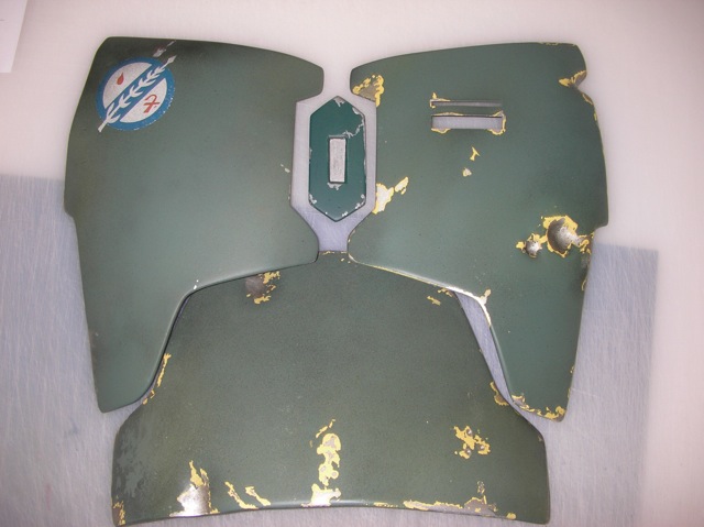

I've made a couple costumes for my boys, but this is the first set of armor for myself. I used Sintra and rattle cans except for the final weathering, which I used my new Harbor Freight special airbrush to mist the black on.
I have some knees that are almost ready for primer. Then onto the rest...
Thanks to everyone for all the research that allowed me to pull this off...

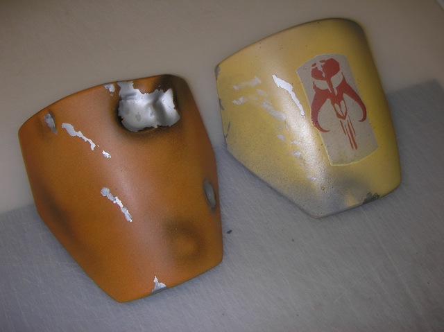

On the left shoulder bell, I used Summer squash, which again, is a little too "creamy" so I paled it up with some random white I had laying around. Very light misting from a couple feet back, just to tone it down. Again, I used the random black for the weathering, but this time, I used an airbrush that I just bought. ($9 from Harbor Freight - seems to do the trick)
The right bell was a little trickier. I started off with Krylon Ruddy Brown Primer and gave it a few coats of the Krylon Bauhaus Gold until it looked about right. It was a little on the brown side, so I put on a few light coats of Krylon Pumpkin Orange.
