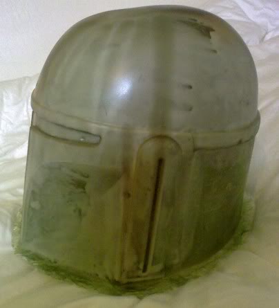

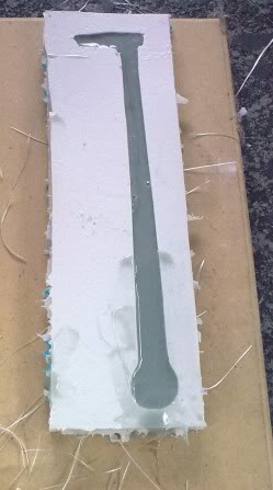

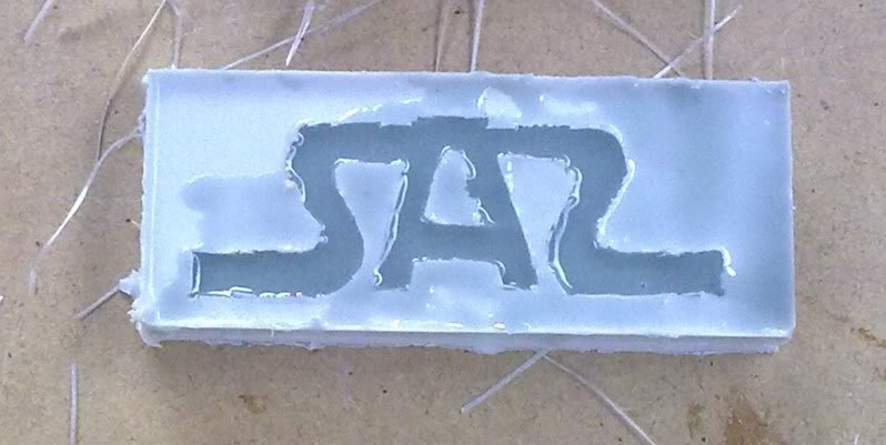

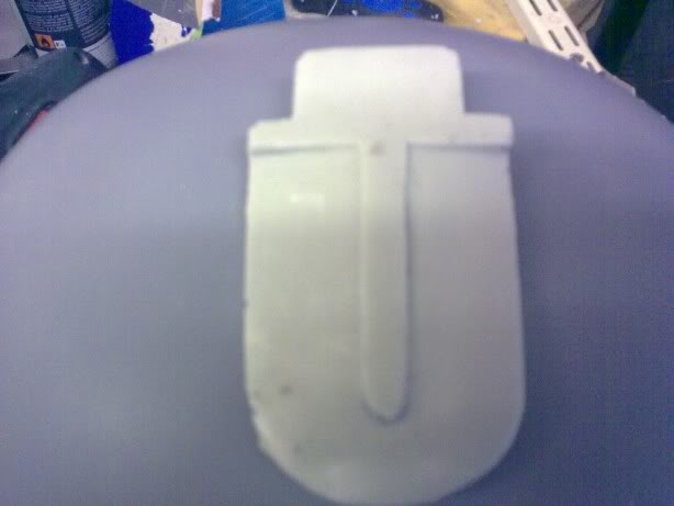

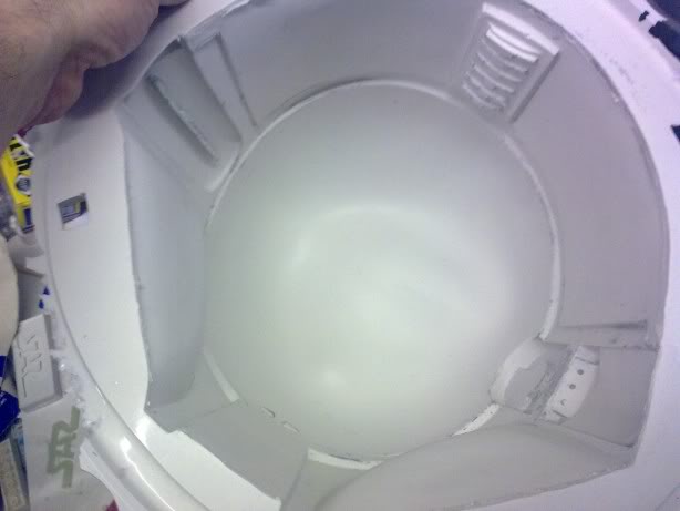

Ok, well I got a bit of nice weather yesterday and I managed to do the front half jacket and cast an RF stalk.
Can't show you the pictures atm as photobucket is having a wobbly, but will get them up as soon as I am able.
My only concern really is the stalk, it's a little flimsy, so I will have to find something to add to it to give it a little bit more sturdyness.
Right, now Photobucket is playing ball, here are the photies :)
Don't ask me why my resin has turned green, I have absolutely no clue.
Once I had done the jacket, I had enough to do the tests on the extras, including a fun little bit I made to use if I had a little bit of resin left over :)
Pouring with rain today, so went out an bought more matting and some fiberglass tissue to see what that is like for reinforcing the rf stalk.

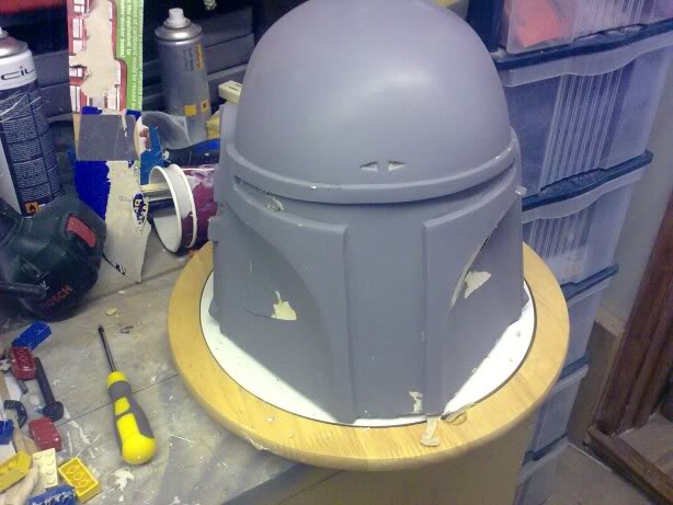

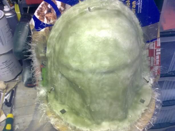

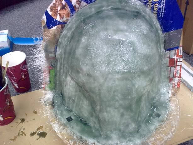

Ok, are you ready?

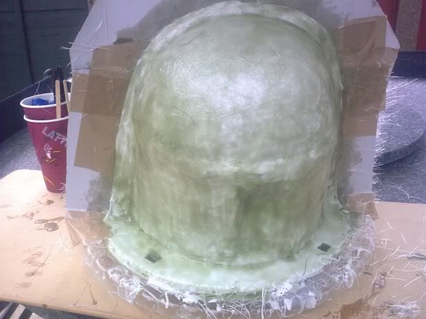

Second jacket is applied:
Placement screws are drilled in:

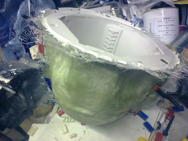

Mold is removed, which has left a damaged model, but not as bad as last time, I could fix this up pretty quickly.
And here we go, TDH meet Mold version 2, mold version 2 this is TDH
By the way, that mold is being held by my left hand and it still keeps its shape!
I've reconstructed the mold pieces together ready for a test cast:
Also, the two part mold went horribly wrong, the mold release did not keep the two halves from sticking together, so I reckon that a wax should be used instead to keep the mold surface watertight.
However, with a scapel and a lot of patience I managed to create a slit from the sprue which meant I was able to cast with what I had and slip the model out of the mold.
The hood test casting didn't go as well, so I will probably re-mold it using the paint on method.

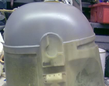

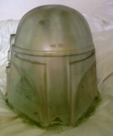

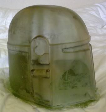

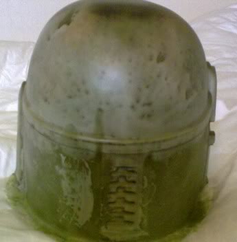

Ok guys and gals!
I've worked on making a cast and here is version 1.2 :)
It's in its basic cast form, which means that it's multicoloured due to the layer of resin mud that is used to reinforce it.

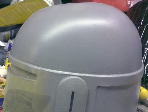

I was also a bit concerned about the dome warping again, as it looks like it is in the above picture, so I decided to give it a quick spray:
So it's looking acceptable :)
Enjoy! I'm going to take a nice long break and work on trimming the lip off now the weather has improved again.

No, not clay, I started with a cycle helmet made a basic card frame/shape and then worked card onto it covered by car body filler.
