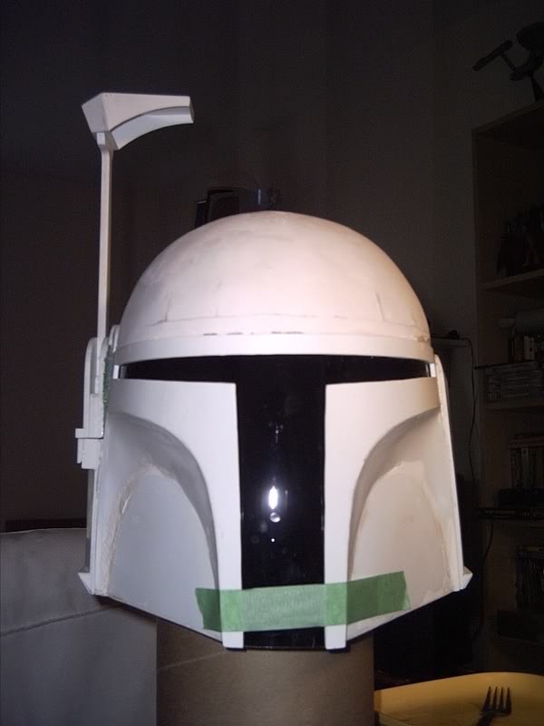

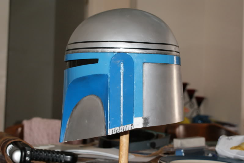

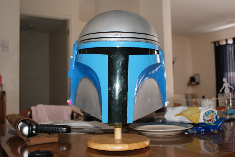

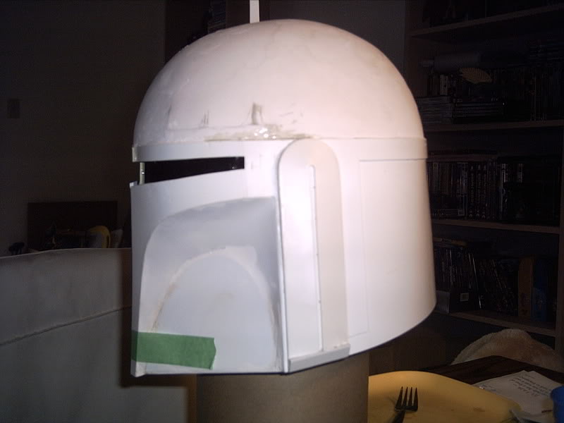

Now on to the pictures...
before...
after...
before...
after...

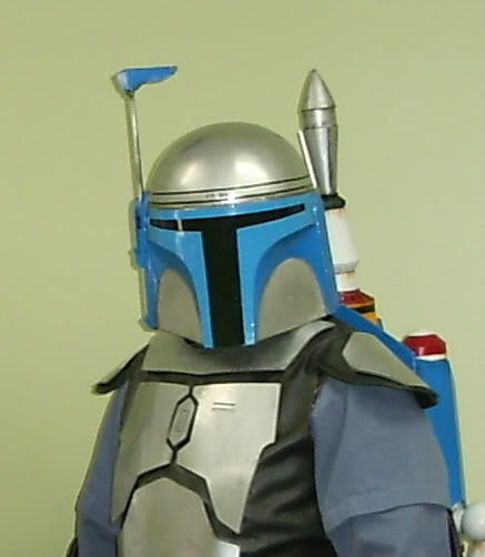

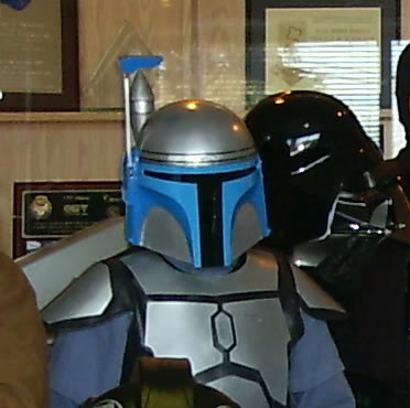

And now for the in costume comparison...
before...
after...
