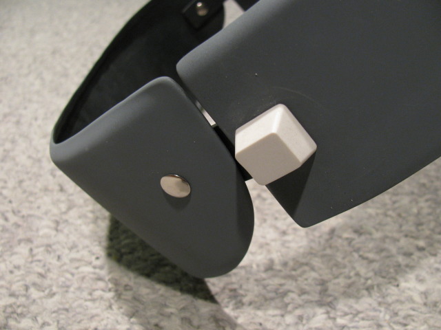

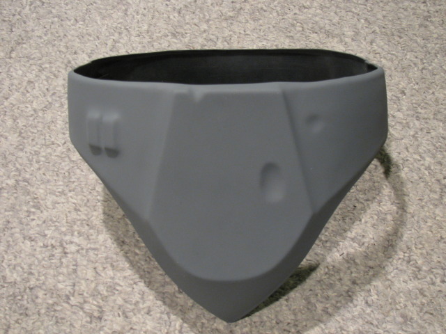

Got the cod all prepped for paint. I had to get a little creative because of the way RKD makes his butt plate.
That's just some plastic bolted between the two halves. It seems to work pretty well!
I really like what you did with the butt plate....yeah yeah I know I need to go back and resculpt that piece lol...'nother notch to add to my growing list hehe.
I love your collar/cod studs too, those look perfect! Would you mind sharing where you got them? The rest of the build looks great so far, keep up the good work bro.

Thanks brother! The studs are just computer keys that I modded a little bit. I found that the number row looked the best so I went with that. Then I sanded down the tops and glued threaded inserts inside. There is one side that's kind of flat (not as sloped as the other three). This makes them somewhat less than perfect but I just turn that side to the back ;).

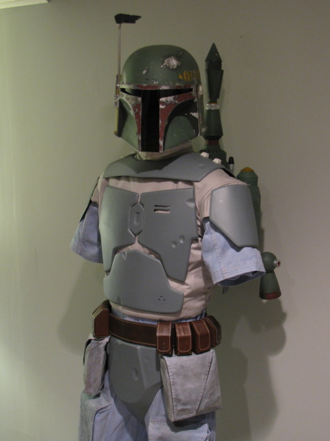

Current progress. He's going to be armless for a little while longer. :D

Dang Matt! You are really doing this armor some justice. I love the way you have it all set up on the mannequin. Even in primer it looks good already. Can't wait to see your paint bro. Thanks for sharing this wip

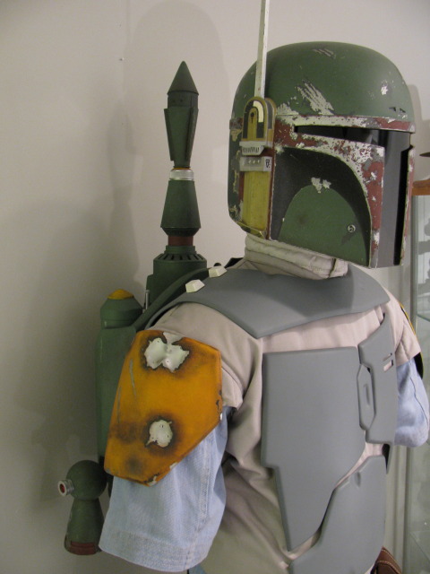

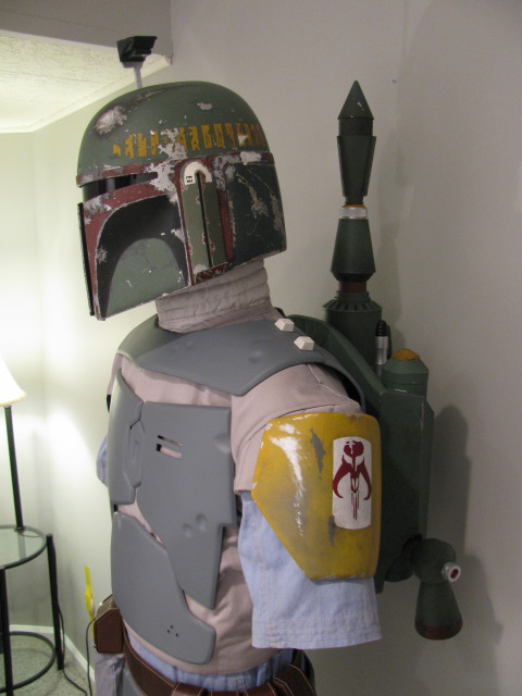

Well I got some paint on the shoulders. Thanks to Lucksy for the decal. Great stuff.

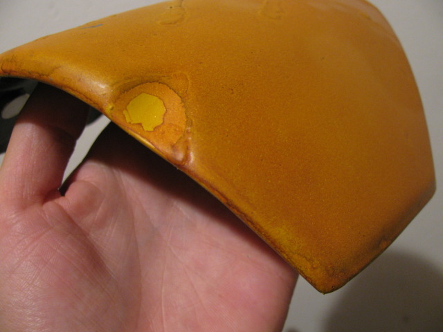

Here are the different layers of the right shoulder. Silver first (still masked), followed by a coat of bright yellow, then an orange/red glaze, then a dirty acrylic wash.
I think I'm pretty happy with them. I'll probably mess around with some more weathering and stuff as I progress.
Shoulders look great! :thumbsup:
Thanks!
Awesome as always. Which yellows did you use?
The yellow was American Accents Marigold. It's not too far off from Up Armor Yellow, but a little darker. But after dirtying everything up it all evens out anyway lol. I used it for both shoulders.

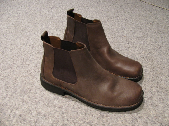

My $20 boots that I got from Target a couple years ago. Once again, not perfect but easy to upgrade later. I still have to make the spikes.
For $20, you've made and excellent set of boots mate! once you put the toe spikes on and cover the tops with the ESB ankle ties, you're golden. Also love your layering technique; it looks natural!

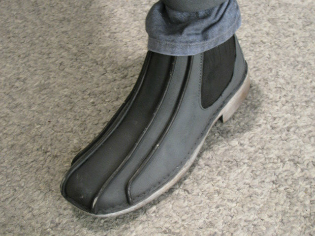

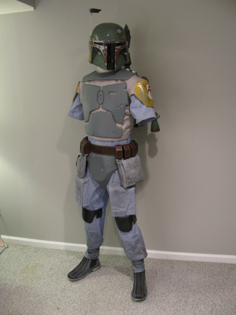

Thank you for the compliments guys. Here's a full length shot. The knees are just stuck on there. Haven't done any work on them yet.
Here were the boots when I started.

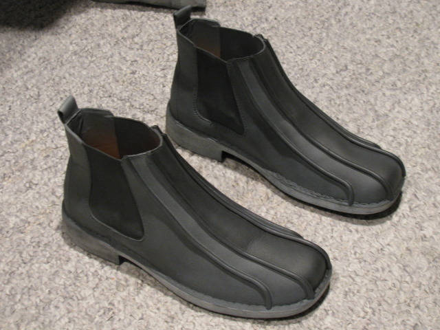

And here they are now. A little more weathered than before. Still have to make those spikes.
Boots are great. Love the duct tape dummy, I need to build one. I figured he would've needed a little help standing up but your pic would indicate otherwise. This is my fav build thread right now
